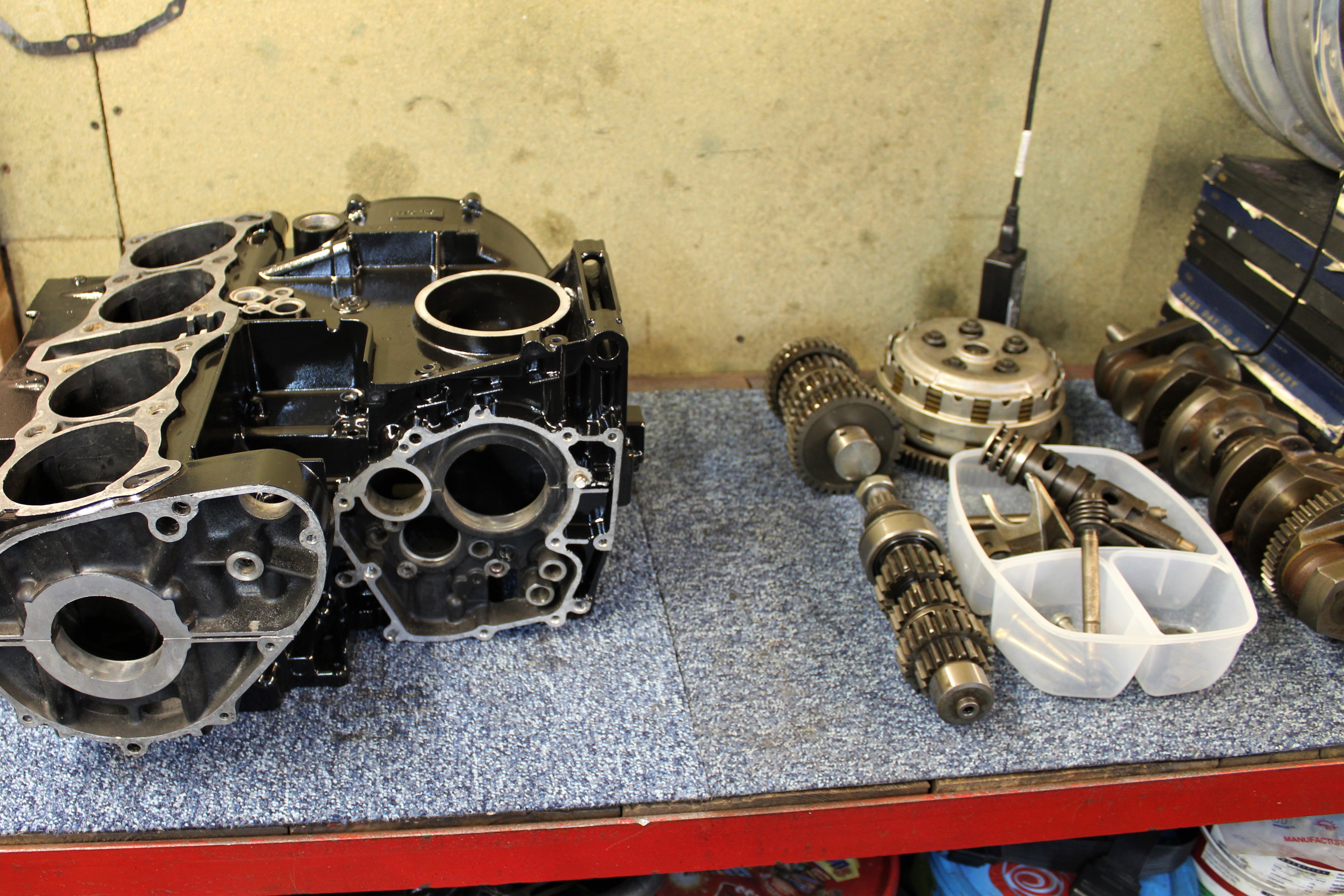

Finally collected the cases and block with their new ceramic gloss black finish. Not a cheap option (£360), and the finish isn't as smooth as paint or powder coat, but it is supposed to be very tough. There are still many engine parts that I need, such as a cam chain, cylinder studs, carbs, ignition and so on, but I took what I had to my mate who will be building the engine for me.

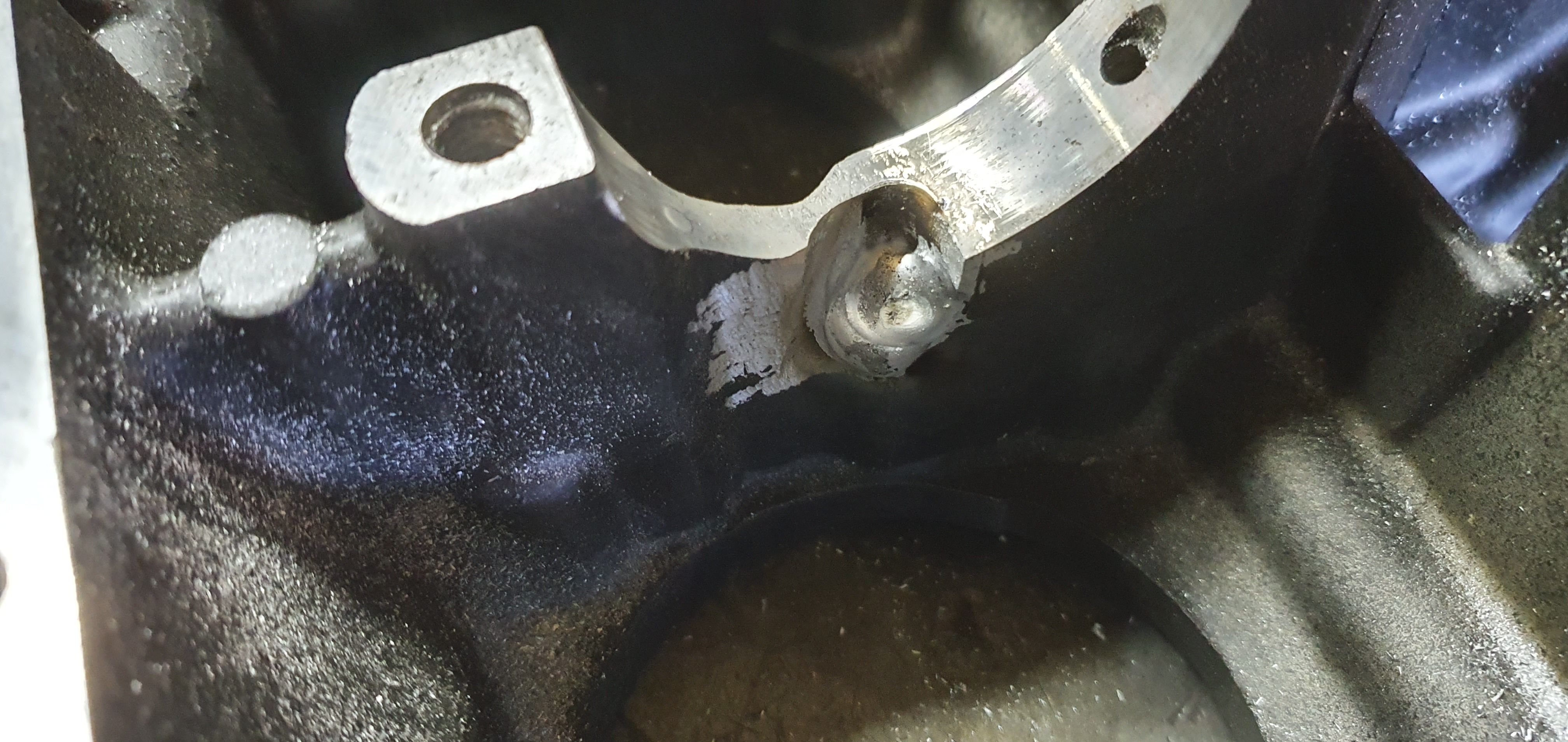

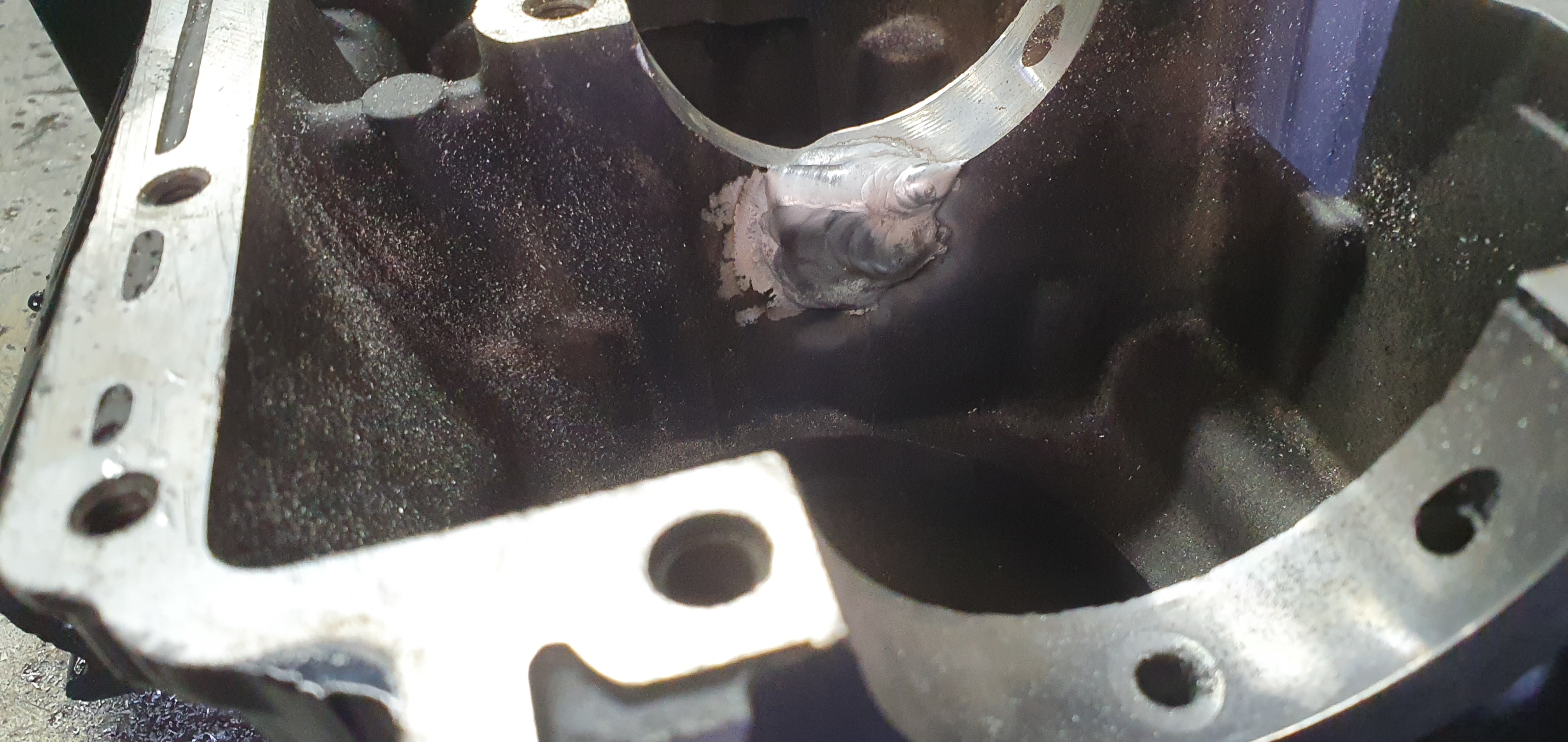

After careful inspection, he found a problem with the upper engine case.. it had a tiny crack around one of the bearing locating pins, not something that could be ignored.. sigh..
But (fingers crossed) it can be welded and machined to fix the problem..

#48 PostAuthor: Bevelhead » Sat May 02, 2020 9:54 pm
Got a txt from the welder today to say the case is now ready for collection, long with another job I gave him for a different project. Will collect it on Monday. He did send me some pics of the case too... He had to grind away the damaged alloy, then rebuild the area with weld.. That done, I now need to have it machined and drilled, something I'm told 'wont be a problem' ..we'll see next week, just hope the case can be saved.

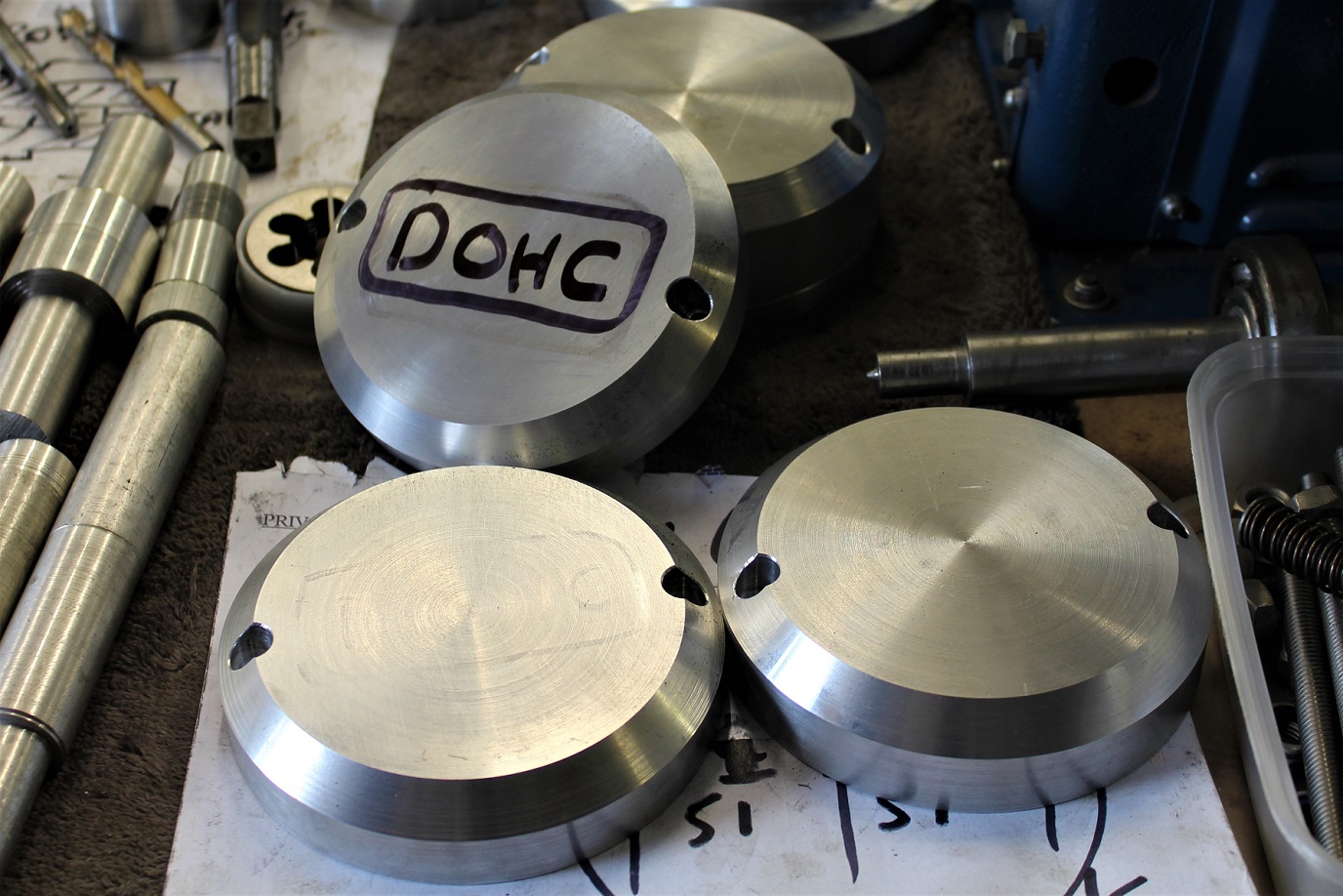

In the meantime, I set about the tedious job of polishing the engine covers.. Only to find the points cover was cracked, and the clutch cover had a weird shallow dent in it. No idea how it got there as there's no other damage on the cover. Someone thought the original bike had crash bars fitted and in a crash the bars bent and hit the cover.

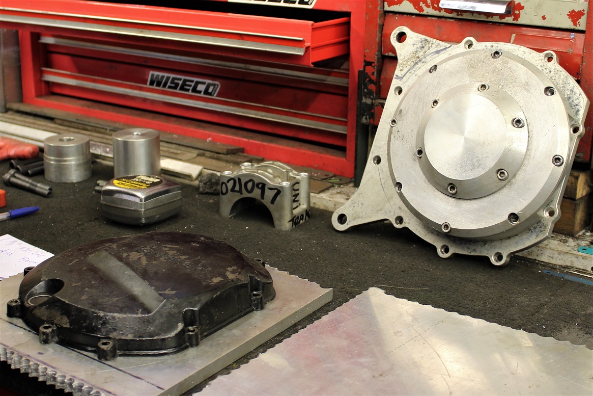

I decided against using these covers, and instead of hitting Ebay for used covers, or buying some cool aftermarket version, I'd have Jeff Hill make them for me. I liked the one I'd seen on one of his projects, so mine will be similar, but not quite the same. Just ordered all the alloy plate to make them. The alternator cover would be harder to replicate, so for now the engine will be getting a standard cover. So I guess I cant avoid polishing that one.

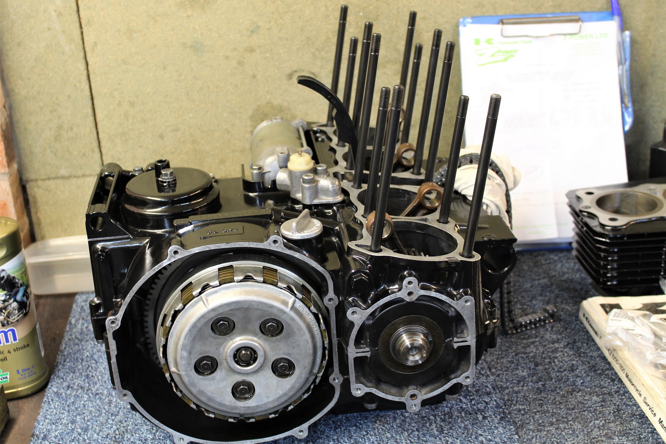

#50 PostAuthor: Bevelhead » Sat Jun 06, 2020 11:58 am

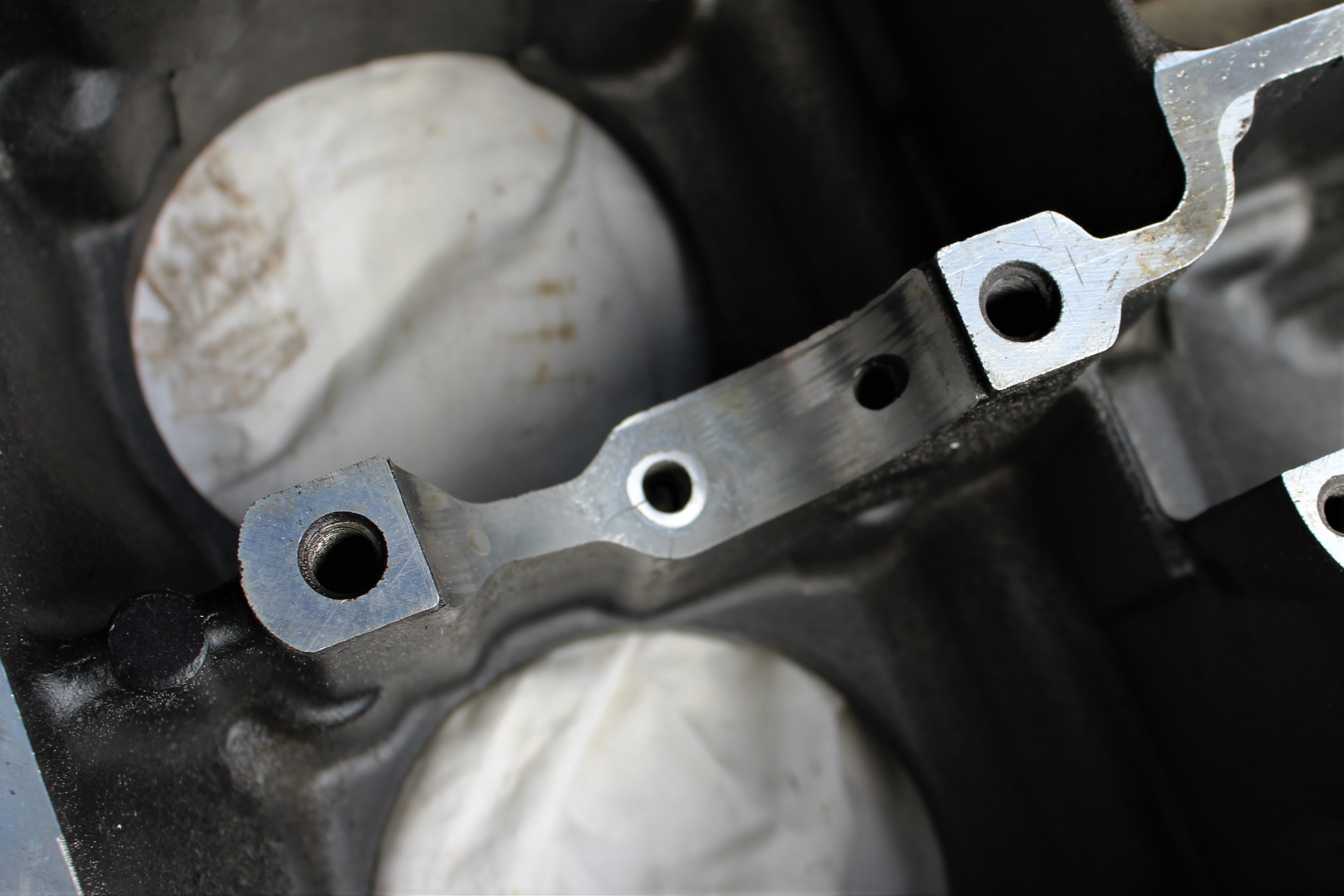

With most of the parts arrived, the bottom end could go together, and with the heavy duty APE cylinder studs in place, the block could go on next. In the pic that was about to happen. With that done, attention turned to the head.. and more headaches..

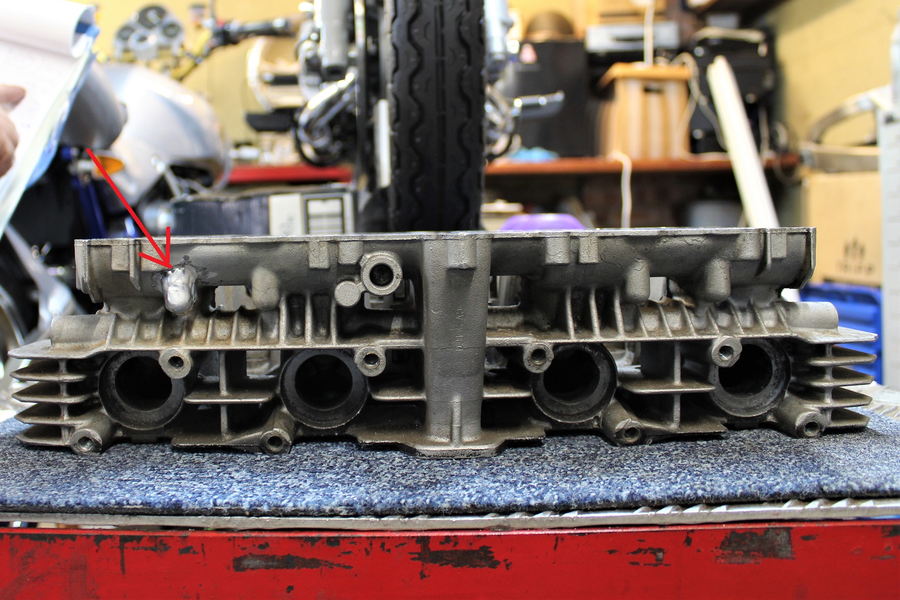

The head is from a bike imported from the US, and its had a hard life. Some idiot in the past had used a too long bolt in one of the cam caps, which cracked the head immediately below the bolt. Once again, the damage had to be ground away and weld used to build up the area, before being shaped back to original (still not finished), see the pic with the arrow below. In addition a couple of the cam cap threads were damaged... a common problem it seems, so all sixteen threads will be heli-coiled.
But the problems don't end there... all the valves, valve guides are worn, and so will need replacing. While the valve seats will need to be recut too. Its all turning into an expensive rebuild. Though compared to Ducatis and Harleys the parts prices aren't to bad. Given the engine parts are around 40 years old, its not really a surprise they need so much work.

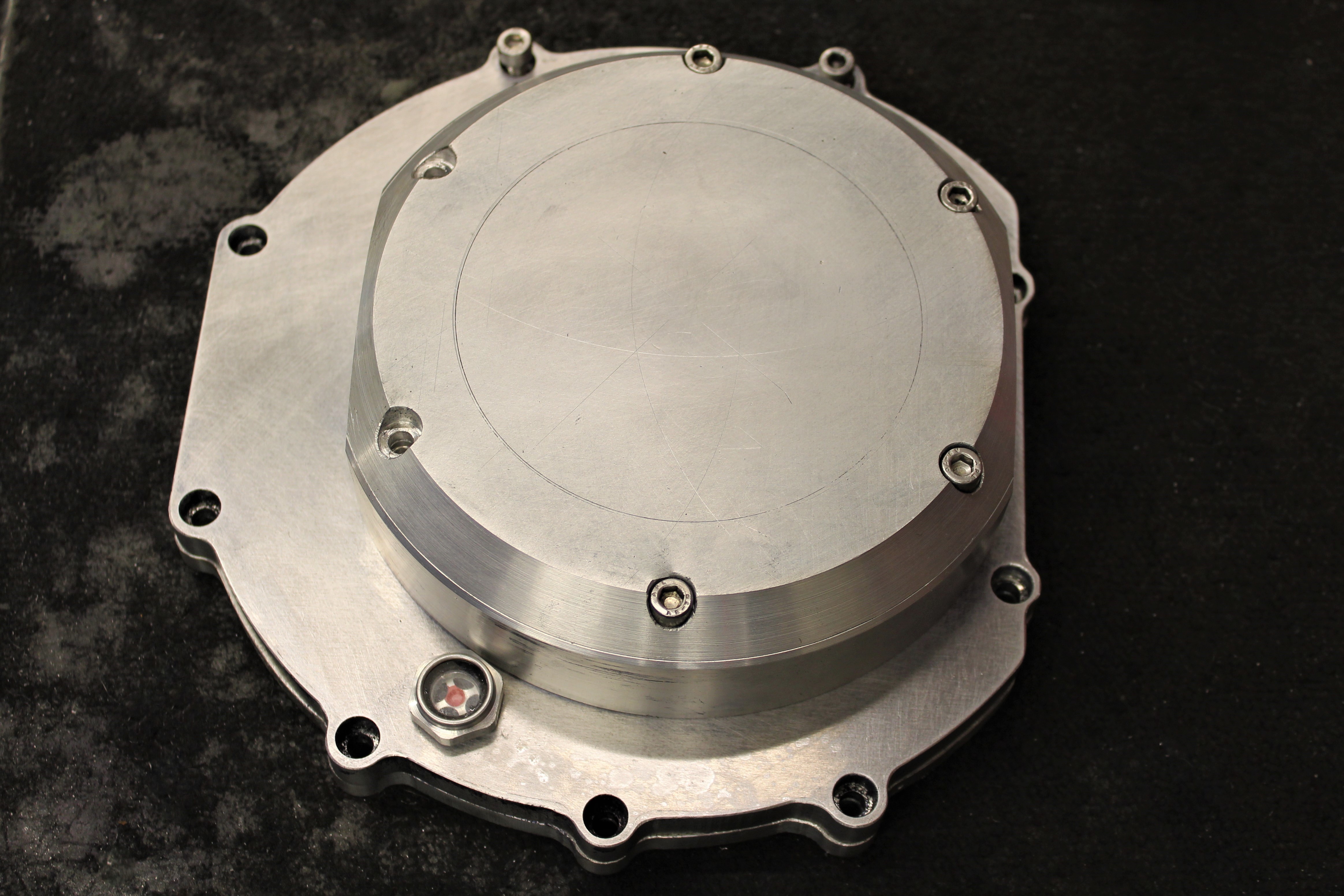

The head has been repaired, welded and all cam bolt holes helicoiled. Its now off having new valve guides, valves and seats recut. Meanwhile the billet clutch and points cover are almost done. Need to find way to engrave DOHC ab maybe Kawasaki into them. And the swingarm is currently being powder coated at Triple S. Cant do the frame yet, as its far from ready.

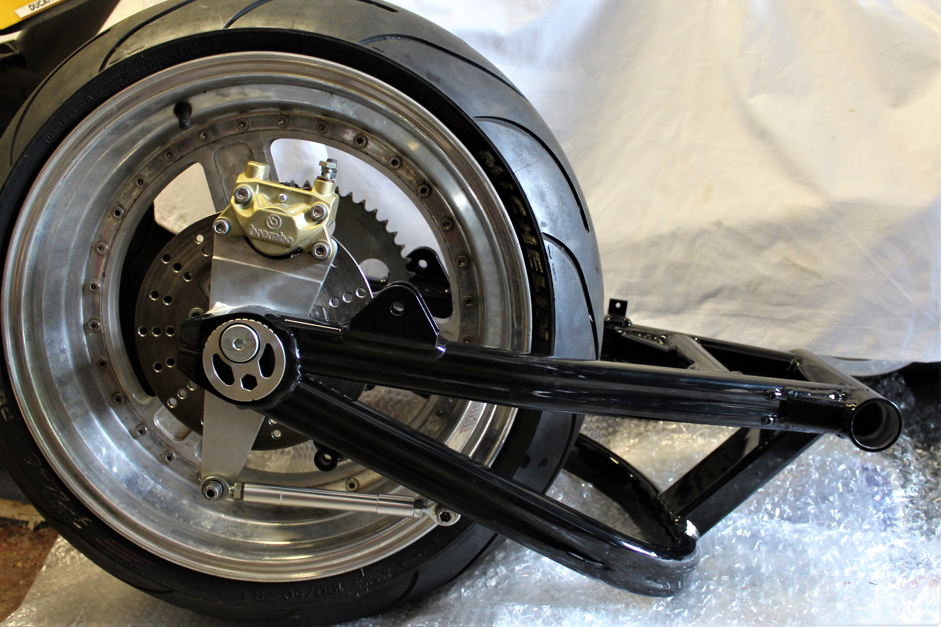

#54 PostAuthor: Bevelhead » Tue Jul 28, 2020 5:47 pm
Got the swing arm back from Triple S, so couldn't resist mocking up the back end. Have to be careful not to scratch the inside of the arm, as it doesn't have any wheel spacers yet. Now need to decide what colour to paint the 'spokes'.. probably satin black or gold, not sure yet..

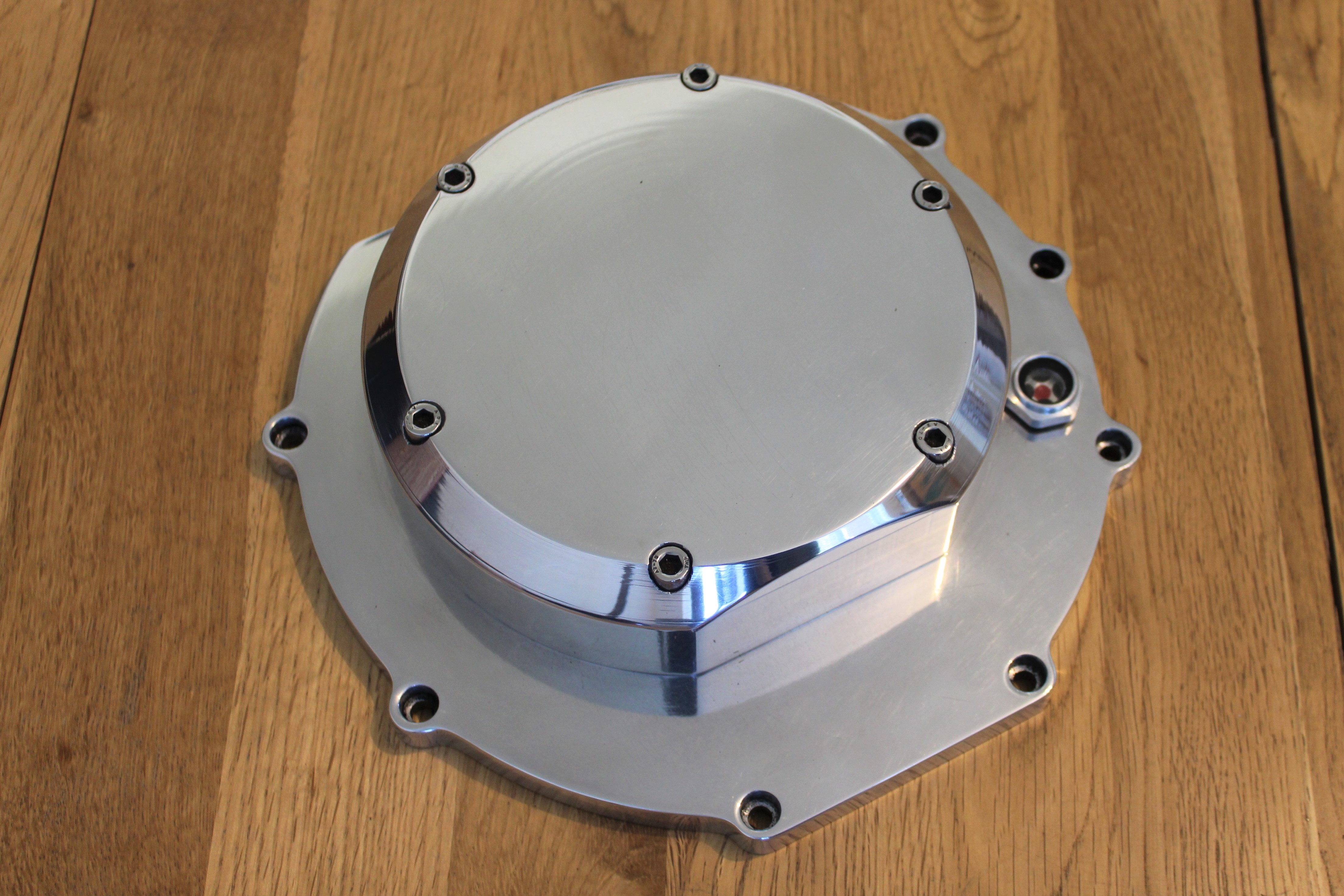

Another small piece of the jigsaw done, the billet clutch cover is polished (I hate polishing!) and ready to go on the engine .

#58 PostAuthor: Bevelhead » Tue Sep 01, 2020 1:40 pm

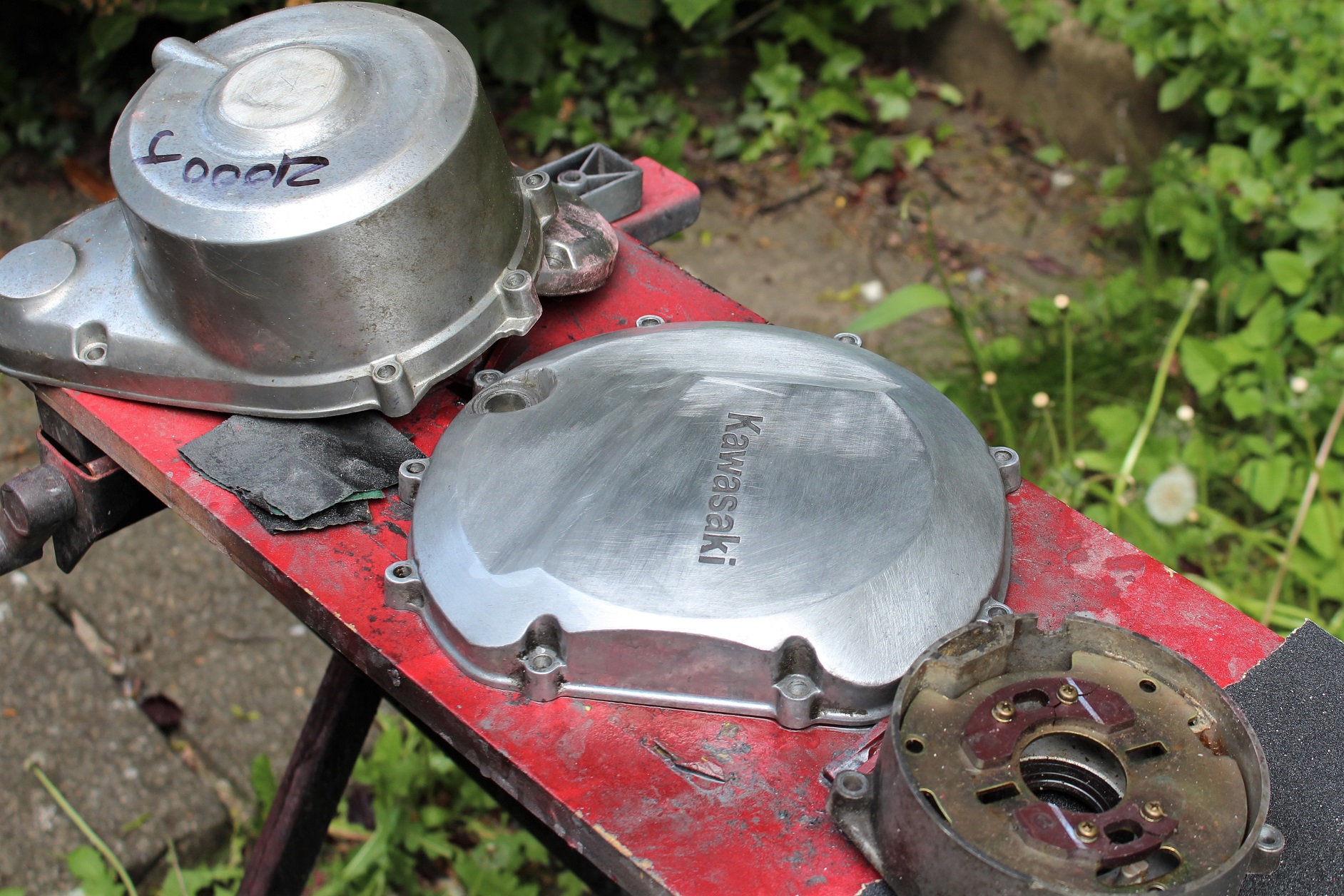

I still want to have the points cover engraved with the DOHC logo, but that can wait. After a few tedious hours of work, got the alternator cover cleaned up and polished. Took so long as it had some deep scratches where the bike must've gone down.
