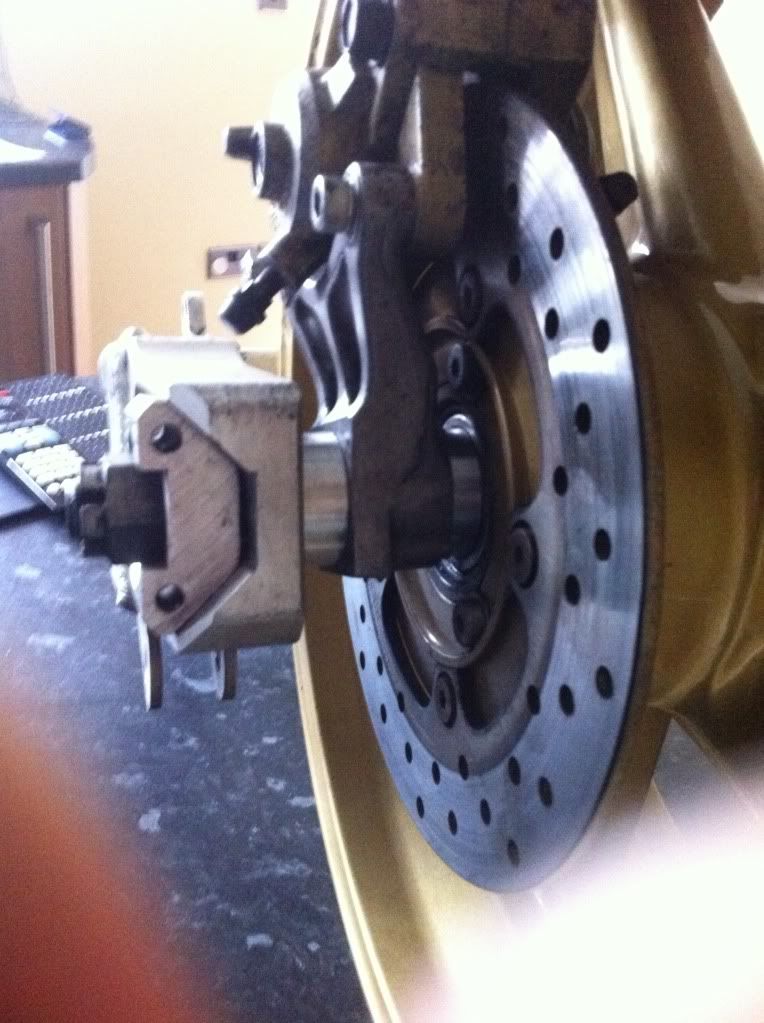

#12 PostAuthor: KWACKERZ1 » Fri Sep 13, 2013 7:24 pm
Started on this again and piecing stuff together,
Backend in,
zx12r dymag 5 spokes 6" rim with gsxr 750 caliper.
Thought the front end would be a doddle,
zx11r yokes (straight fit with a bearing change, also missed the tank with the existing (non standard) lock stops.
so far so good!
ZX12R SPINDLE IN ZX11R FORKS no probs,
Then the wheel wont fit, the discs are spaced to wide, so took off the disc carrier spacers to get the disc aligned in the calipers, Bugger the zx12r disc are 320mm and zx11r ones 310/5mm I thought they were the same and this would be straightforward.
I now have a few choices,
Sell the bloody lot and fit standard stuff, TEMPTING!!!!
Machine the disc outers, (but I'll still need spacers machining to change the offset!!!)
Spend a load of dosh and get custom ISR discs made. :evil: :evil: :evil:
Nothing is ever straightforward.
Oh and the battery box wont fit as it hits the bracing !!!!
And need new shock mounts to get the shocks in straight!!!!!
