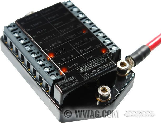

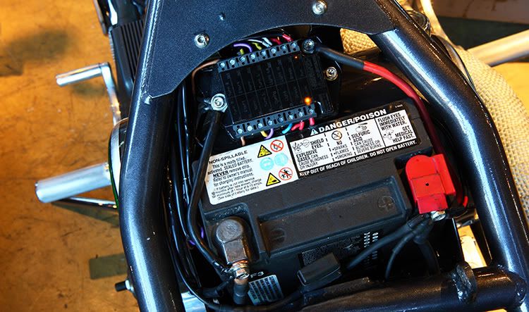

I don't wish to replace the Standard Kawasaki one as such but this thing shown below has a built in Starter relay which can take up to 30A and if the Starter Draw is less than that - well, bye bye relay.

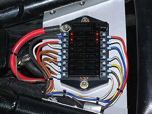

are you sure that this unit has a built in relay for the starter? i have looked at various wiring diagrams for this + it shows a separate relay if you expand the photo of the Suzuki that the unit is fitted to you will see the the starter wires are not connected to the unit

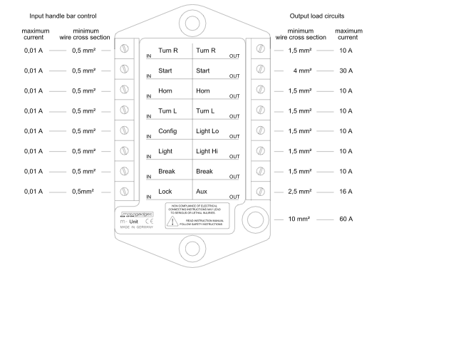

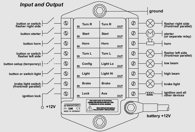

I was looking to before I bought it but this diagram out of the manual shows some options:
also recommended SWG sizes & Current limits:
It has overload protection built in so I'll try it and see. Failing that I get hold of a Loop Ammeter and see just what the current draw is.
