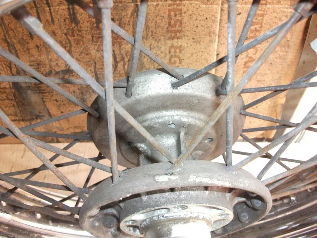

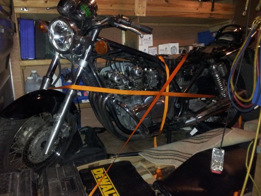

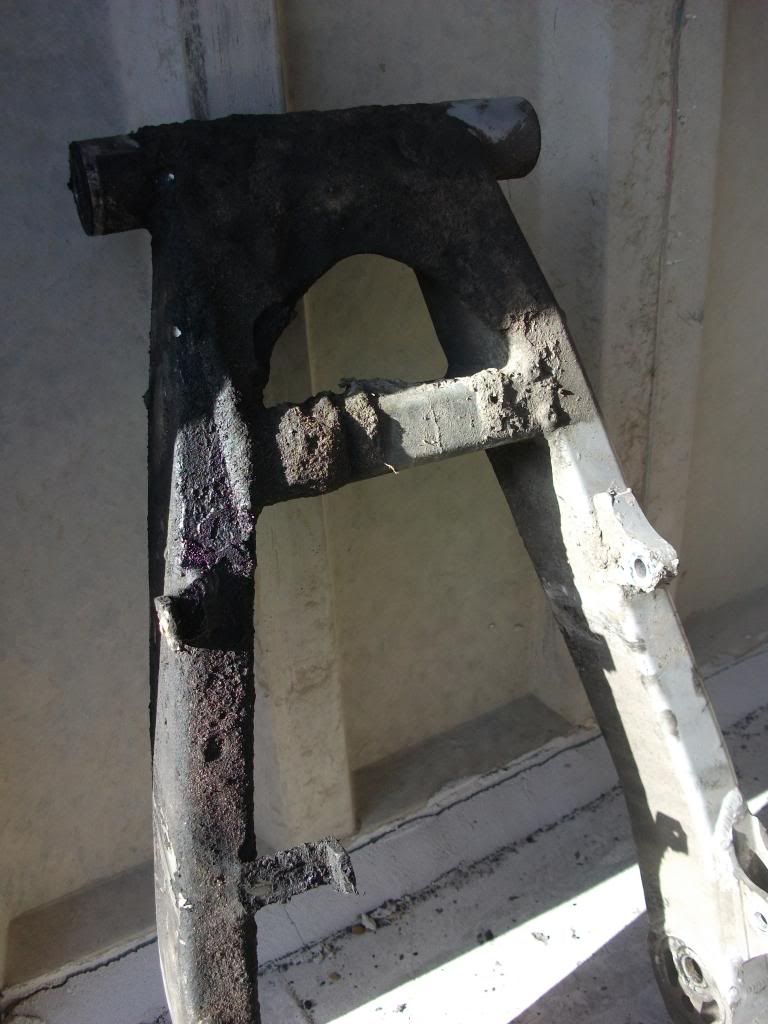

What originally started off as a strip and tidy of my 750 has turned in to a major strip down as the frame is rusty and needs blasting and powder coating, the pictures just dont show how filthy, oily, rusty and neglected this bike is.
In transit.
Loads of rust where mud has collected.

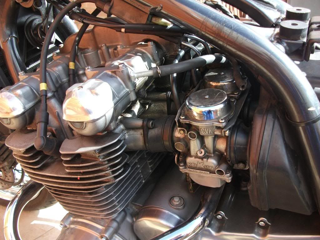

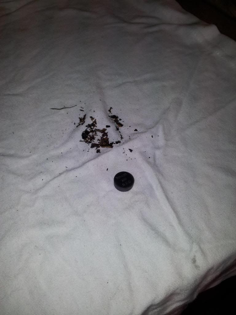

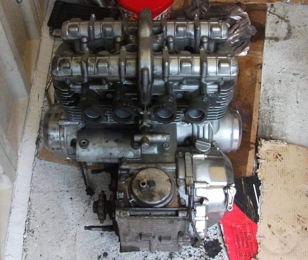

When I took off the tank, something was rattling inside, I thought it would of been something broke off the fuel level float, instead it was a AEG Trovan 300 which after searching appears to be a transponder possibly off the data tag.

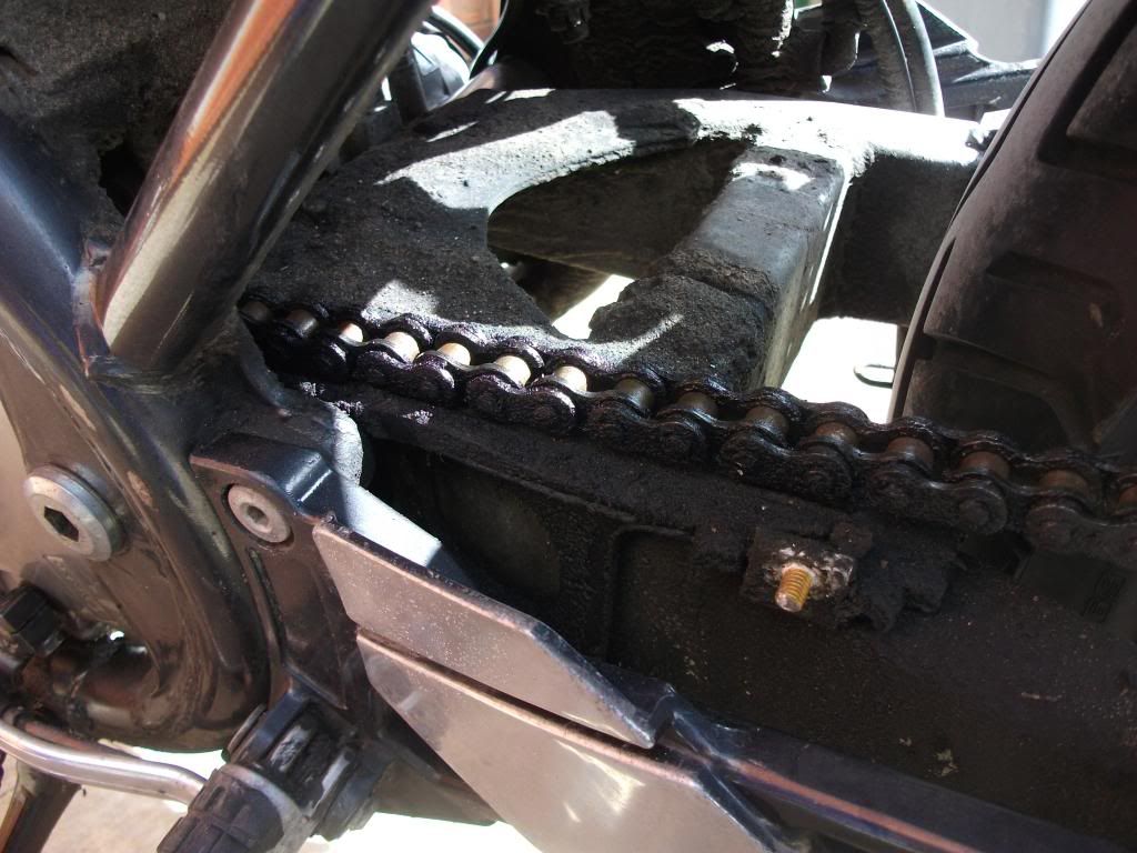

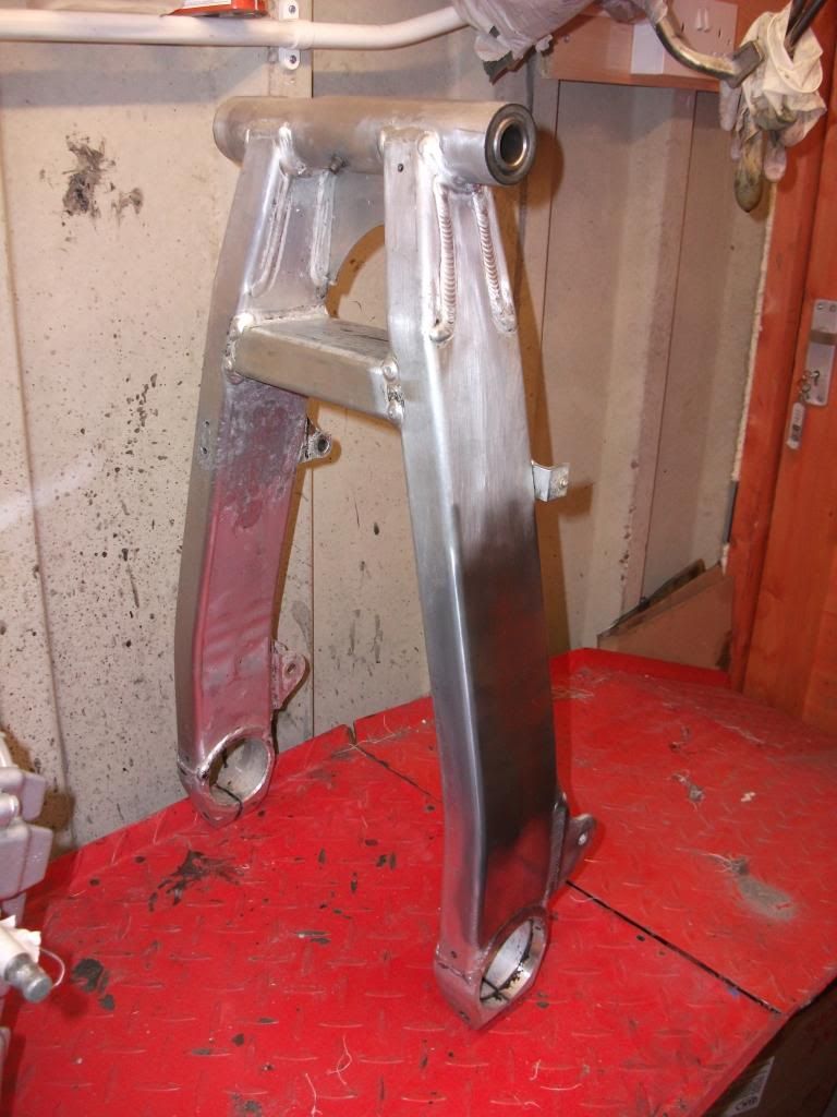

The swinging arm and underside of the frame andengine is covered in 17 years of mud and oil.

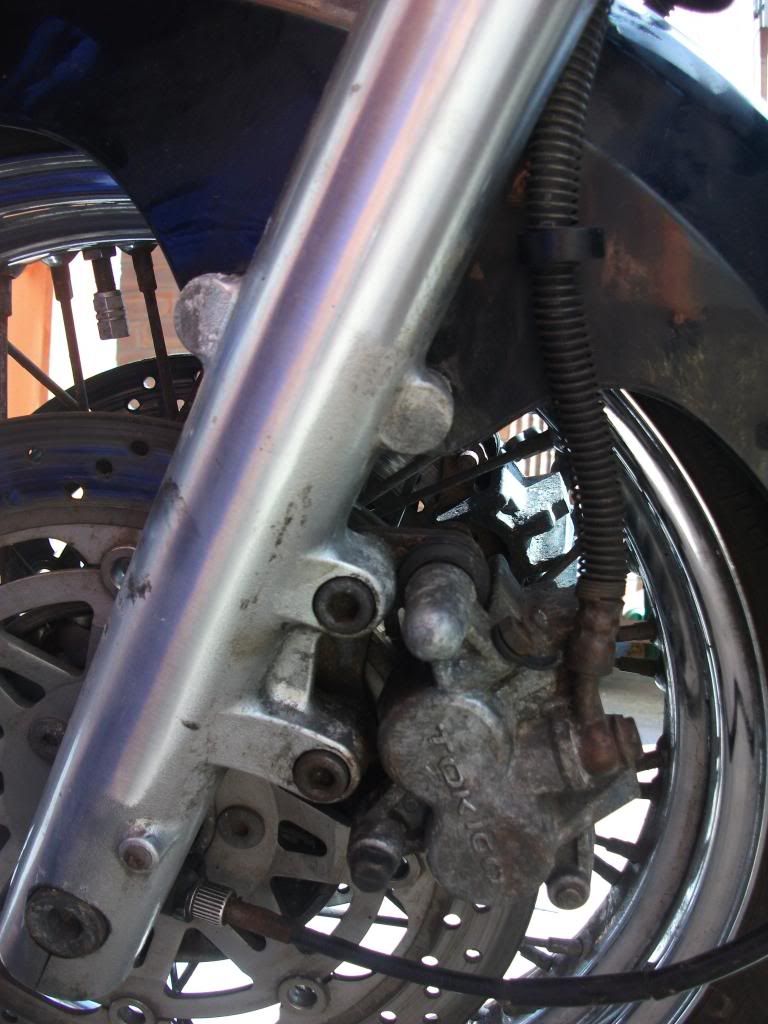

The calipers were seized solid with rust, I had to remove the calipers to push the bike.

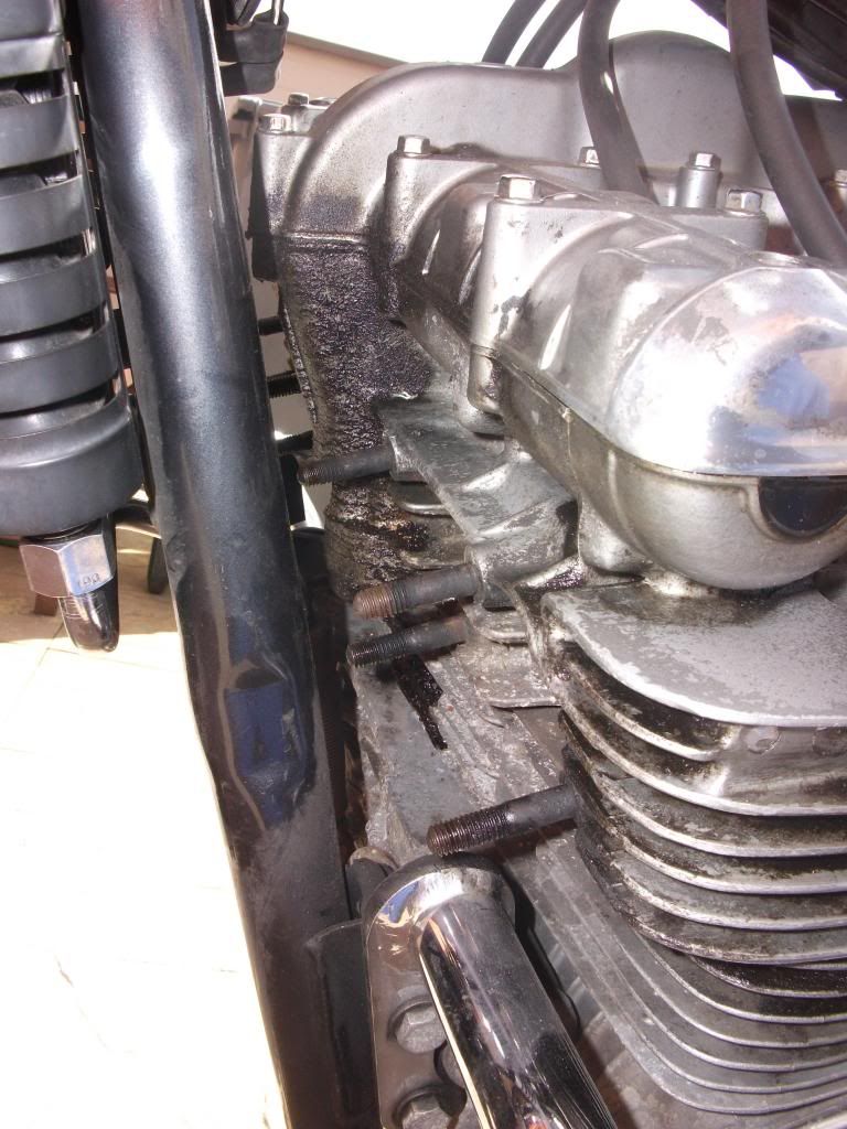

Rocker cover gasket has definately been leaking.

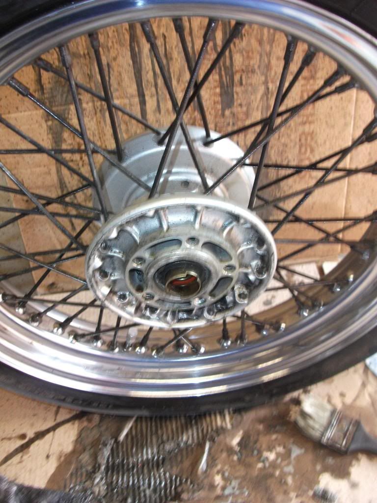

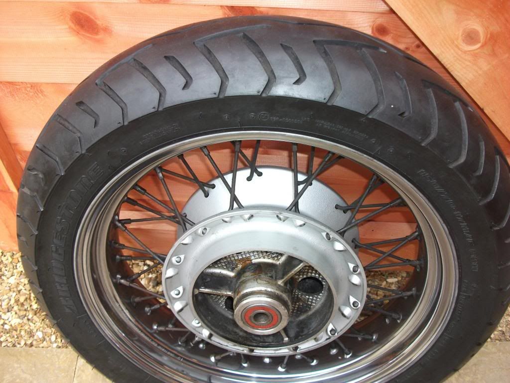

I would love to get the wheels rebuilt with stainless spokes as I think the spokes will let the bike down when it has new paint etc but I guess it would cost too much.

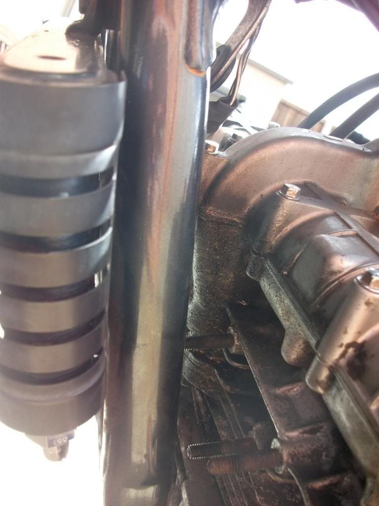

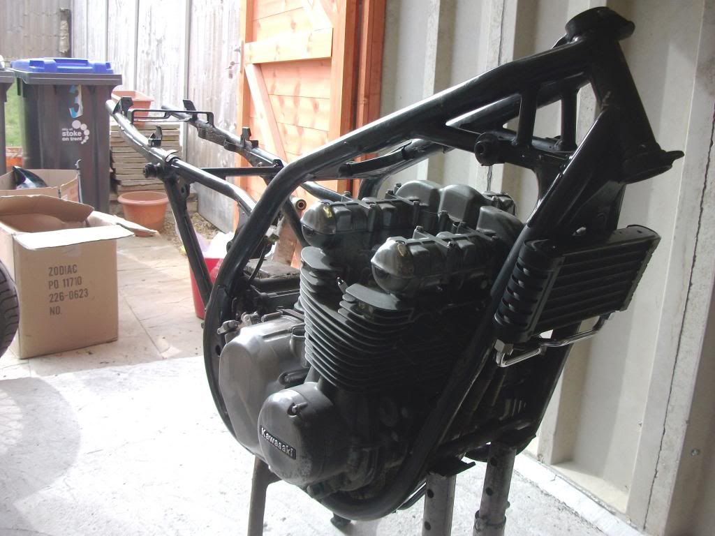

#5 PostAuthor: oldtimer » Wed Apr 17, 2013 4:05 pm

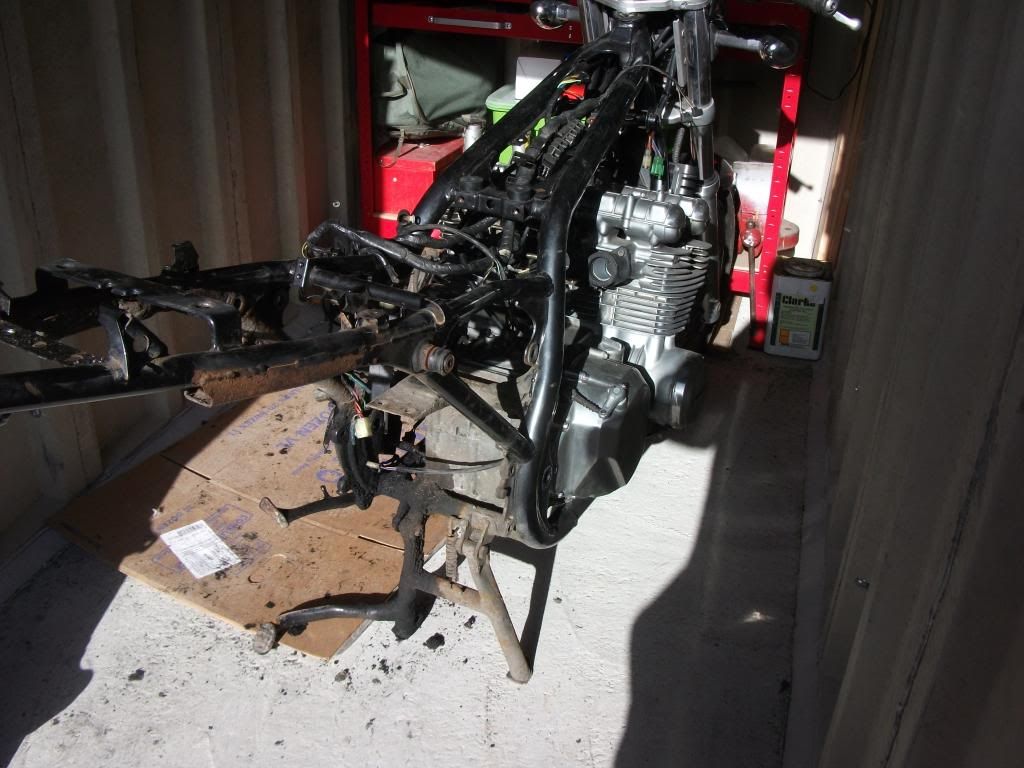

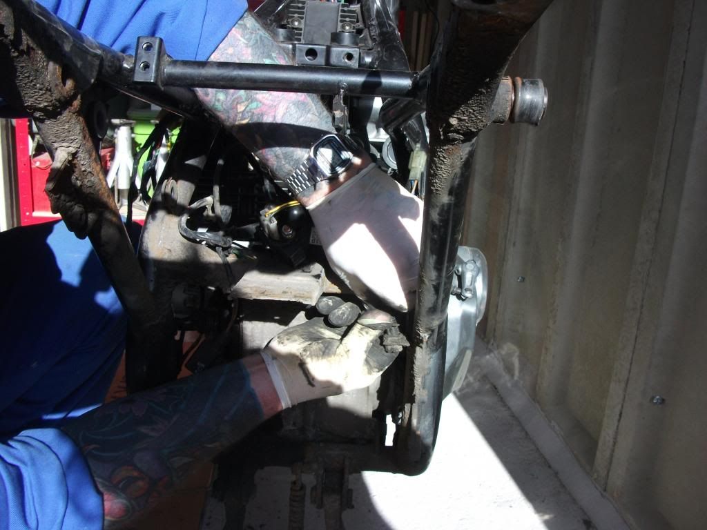

Todays progress, just need to remove the oil cooler and then I can remove the engine, not sure if to lay the frame on its side or as the manual suggests to leave it on main stand and use a trolley jack under the engine, seems a bit fiddly to me, what do you guys suggest?
Whilst removing the forks I noticed how notchy the head bearing is, it rotates freely and then hits a tight spot before becoming free again, not sure if top or bottom bearing so will change both to be on the safe side.
Posts: 2152
Joined: 3rd Apr 2009
Location: leverington UK
#6 PostAuthor: kev edwards » Wed Apr 17, 2013 6:46 pm
Take the rocker cover off first and cover with clean rag, i done my brothers last year using the jack method it's still a bit of a wriggle but i got there, had to have help putting it back, getting up on the bench on my own was haemaroid moment almost.
I done his with the front and back ends on though you will probably find it easier to lay it over as you have stripped it all to just frame and engine.
oldtimer
Posts: 217
Joined: 2nd Mar 2013
Location: stoke on trent

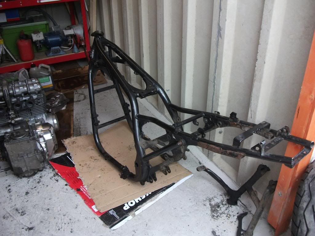

#7 PostAuthor: oldtimer » Thu Apr 18, 2013 5:56 pm
Took the engine out tonight, laid the frame down and removed it that way, came out quite easy, I then replaced the frame over the engine a couple of times to see how it would go back on again, when I do reinstall the engine I will remove the rocker cover as that little bit of extra room will prevent the frame from getting scratched and may make my life a little easier.
I need to sort out all the bits I need blasting and coating and get them up http://www.wilkinsonspowdercoating.co.uk/
I will post again when I get the frame back.

#8 PostAuthor: oldtimer » Sat Apr 27, 2013 12:23 pm

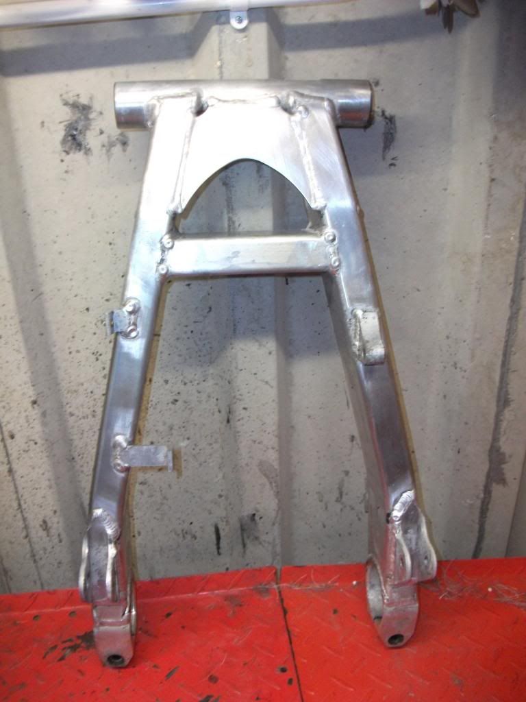

Quick update, just a bit of cleaning and polishing whilst waiting for the frame to come back from the powder coaters.
Cant wait for the frame to come back so I can start reassembling.

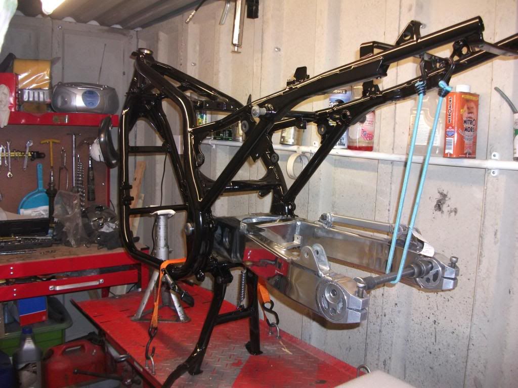

#9 PostAuthor: oldtimer » Sat May 11, 2013 3:47 pm

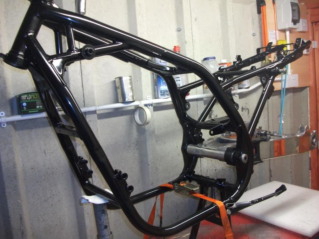

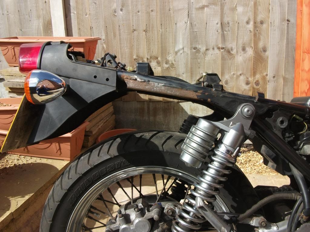

Frame back today, could not resist putting a few bits on, cant do a lot until I get the engine back in but waiting for a dry day so I can have a go at soda blasting.

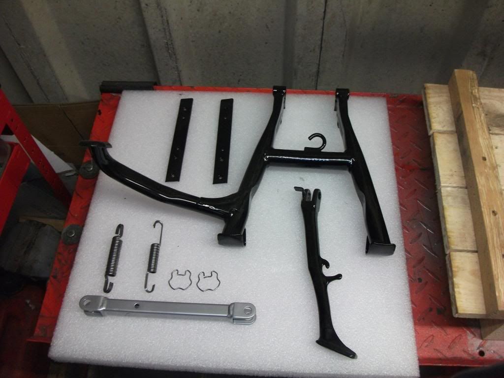

The stand springs and axle clips were cleaned up on my polishing wheel and came up far better than I ever expected.

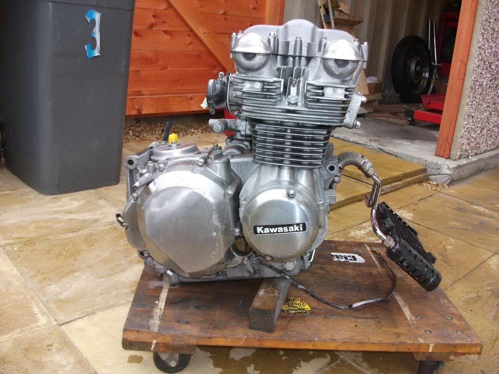

#15 PostAuthor: oldtimer » Sun May 19, 2013 12:08 pm

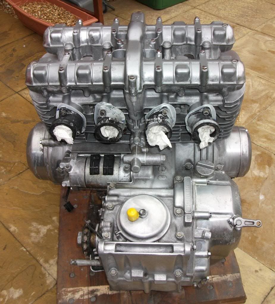

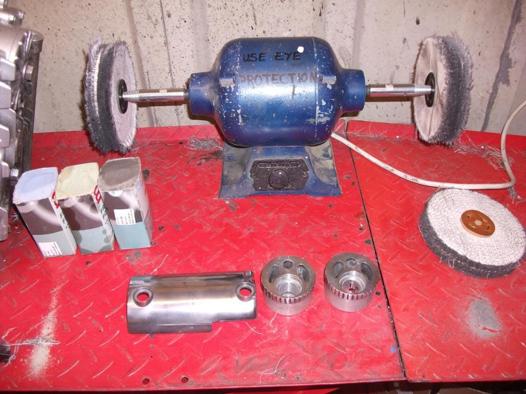

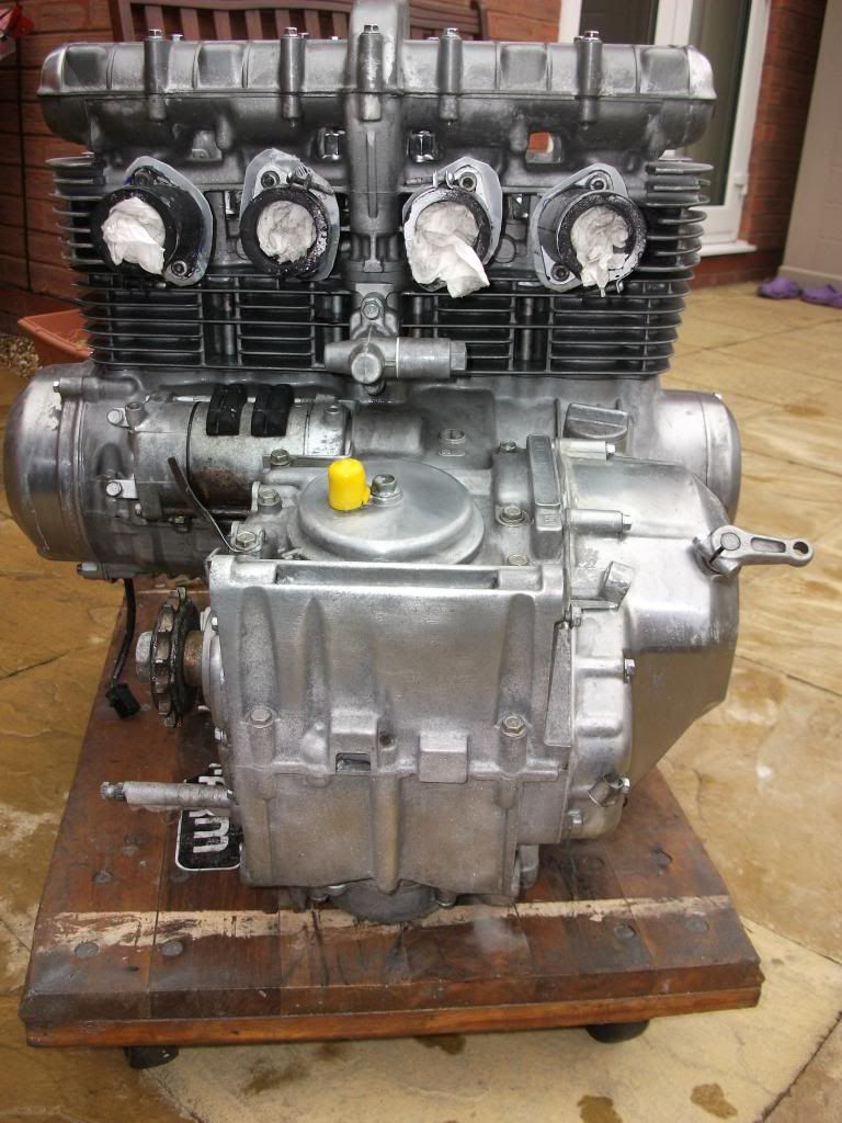

A little more progress, I tested my new soda blaster, dusty job but it had to be done, just need to polish the engine then can get it back in the frame.
