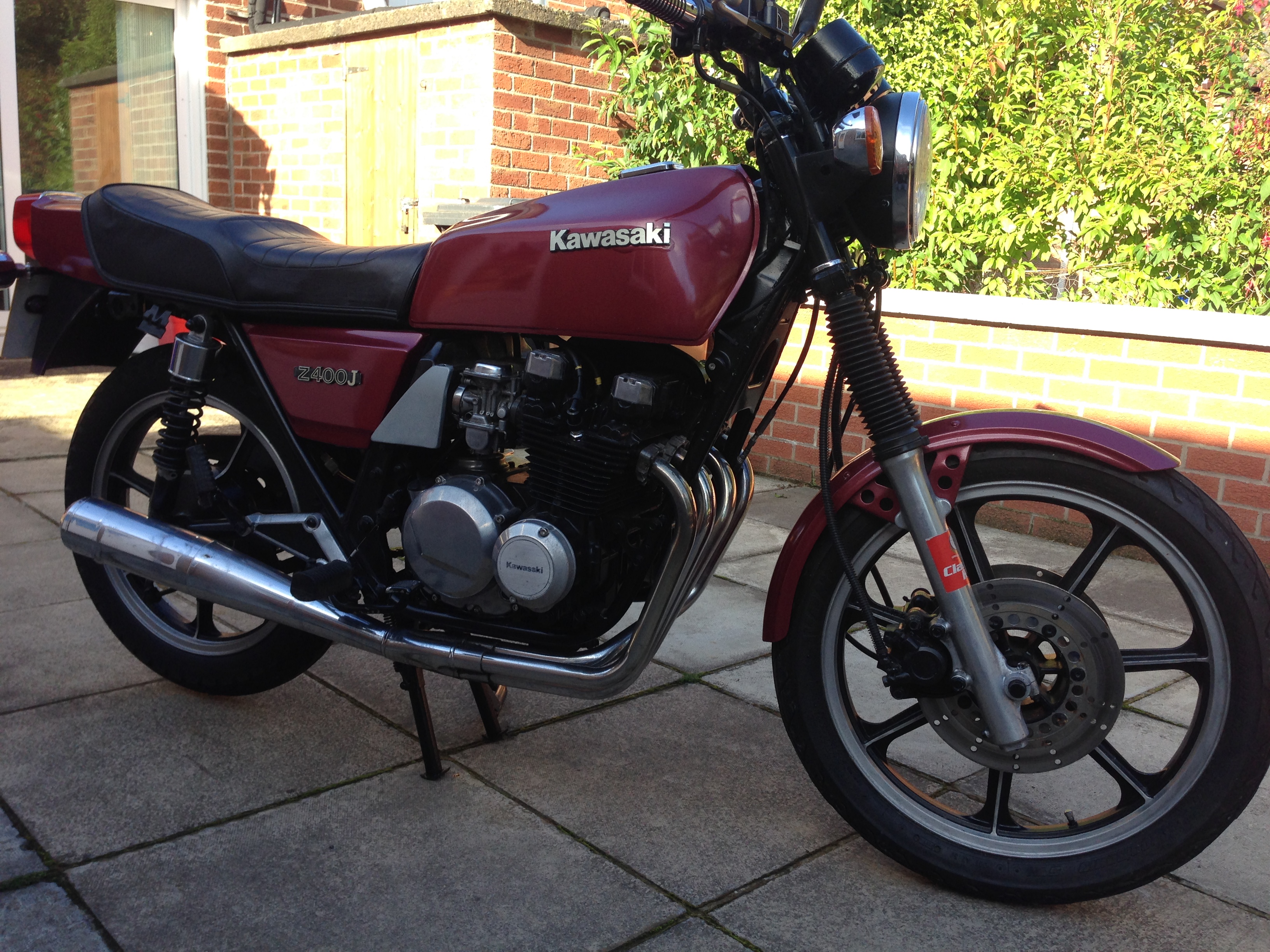

My new toy, and my first project.
The photo flatters the bike, but it's a great start.
I had one back in the early 80s, loved it.
It's a Z400J, pretty certain it's a J3 model.

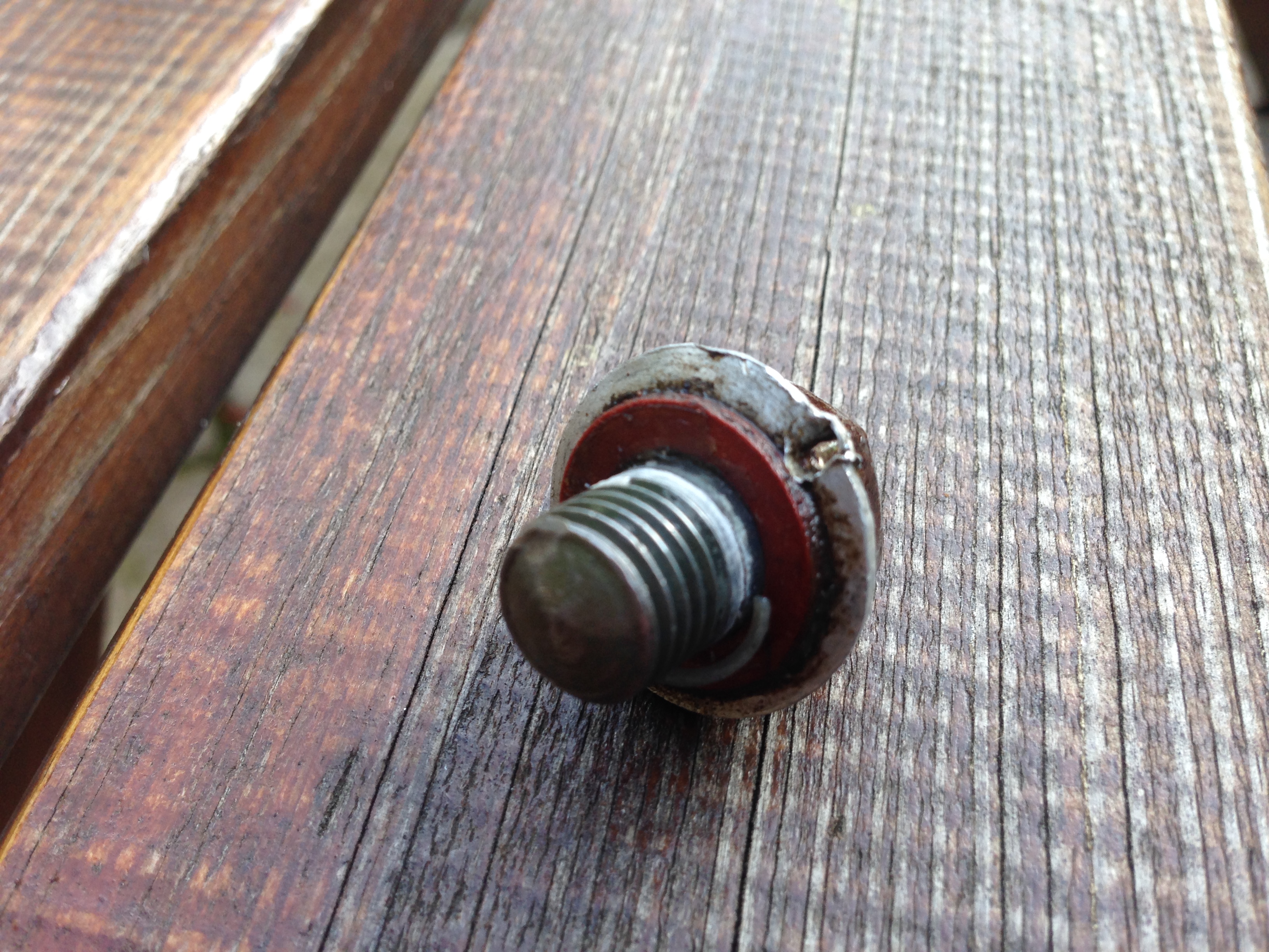

Oil leak, seems from around filter housing, but noticed the sump bolt wasn't tight- tried to tighten but it won't. So, I'm getting the sump off at least.

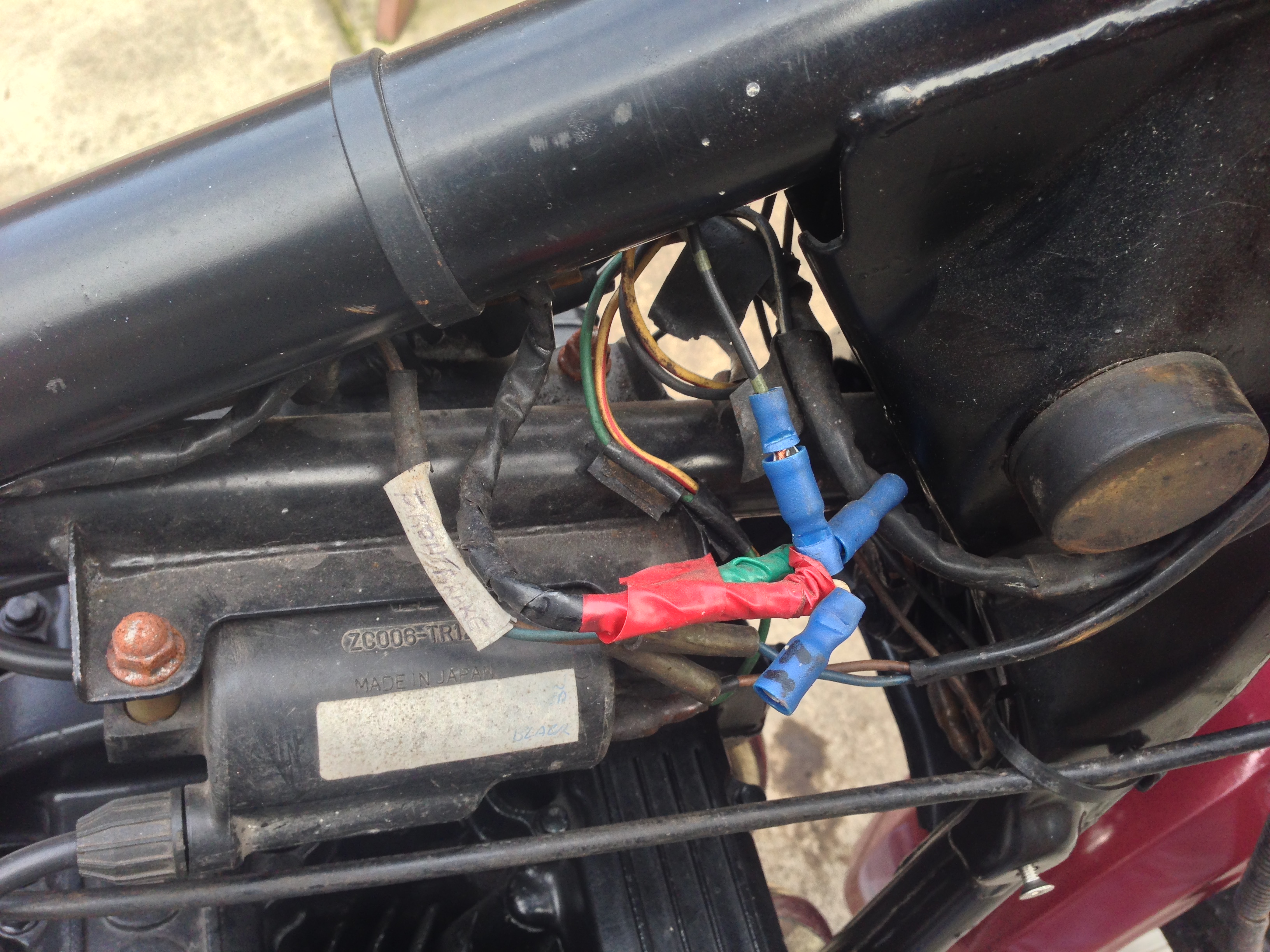

The wiring is interesting in places too.

The wiring in this one is not inspiring, think I'm going to try to make up a new loom, what could possibly go wrong.....

Sump bolt- time for a new one?!
Wiring is interesting.

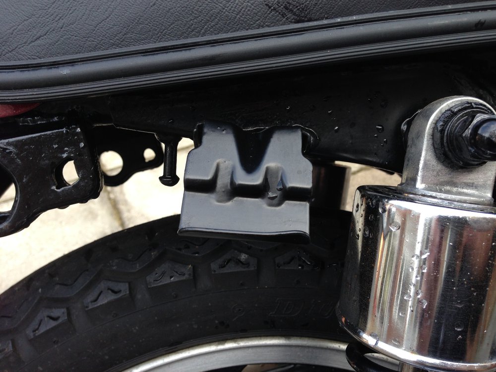

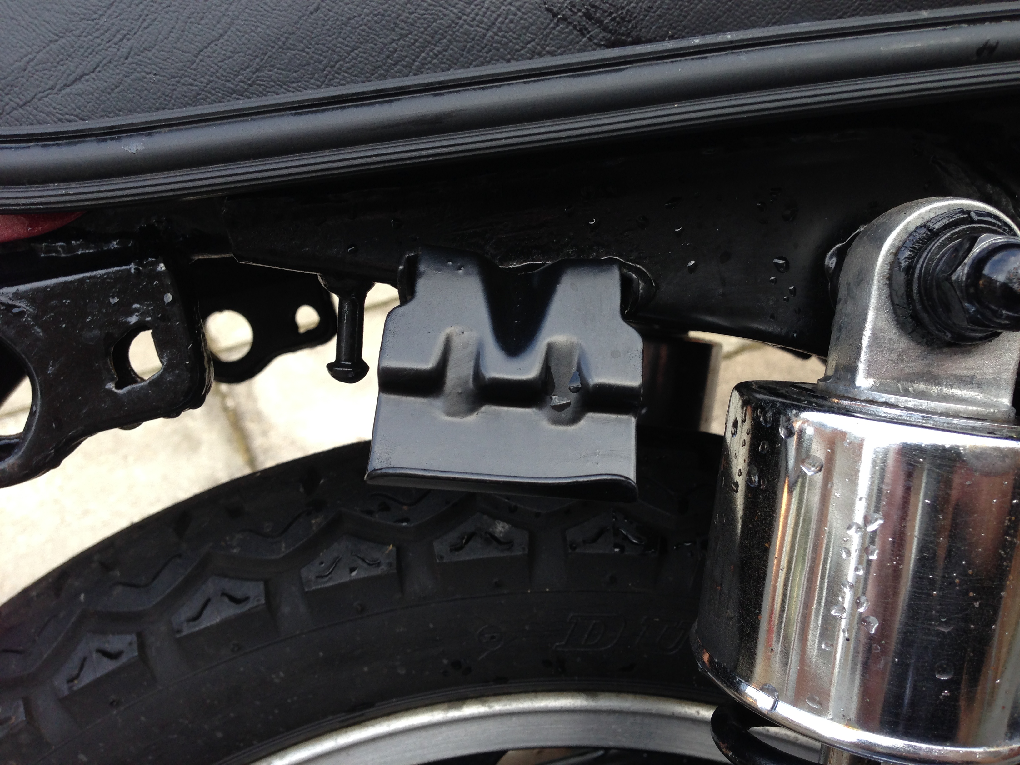

And what is this bracket below for? I know the grab rail is missing, but I don't think this has to do with it.
