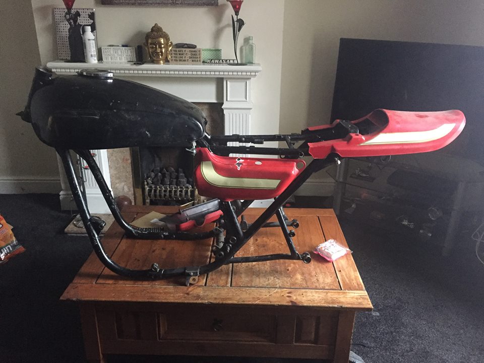

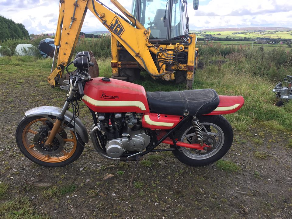

A few months ago I was told of an old kwak that had been in a garage in Manchester for 30 years .... had to have a look as the guy said it was a 21B .... mmmm ...... maybe he means Z1B ?
A few days later this arrived home complete with gs1000 rear end and Z1000 front , Z1r tank and assorted bolted on bits

Clocks are z650 , seat is z1000 the more I got into it the more depressing it got but then I sold all the bits I didn't need for more than the purchase price so things started to look up

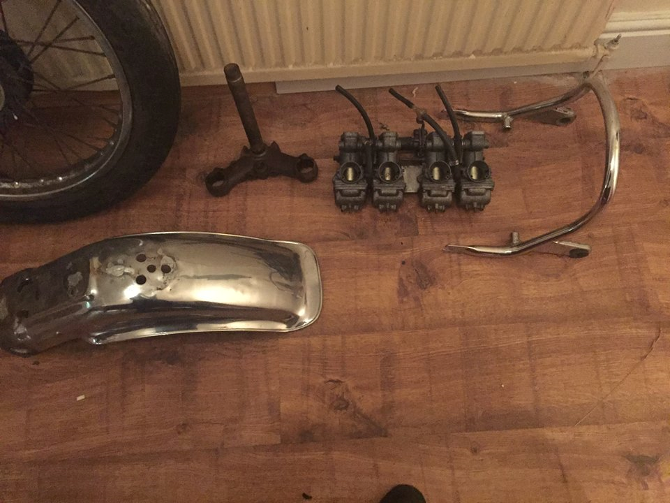

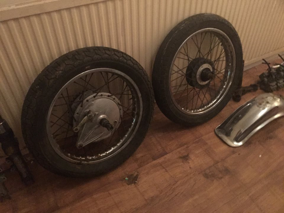

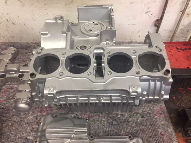

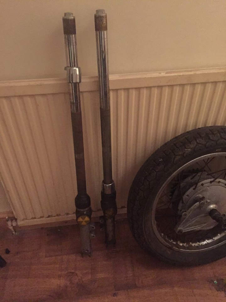

went shopping for parts and found some forks , wheels , tank etc , had some vapour blasting done and sent the frame off for checking ....... spent a fortune at ZPower but wont bore you with the parts list .....suffice to say it was extensive and expensive
Got the frame back from Triple S powder coaters yesterday and I have a spare day tomorrow to start putting it back together ;)

As the bike had been sitting since at least 1989 in the same garage Im assuming its a UK bike so I will try and get as close as I can to Uk / Euro spec

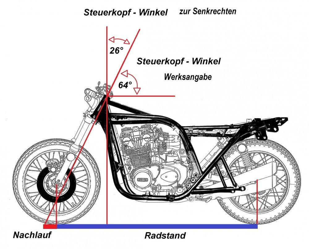

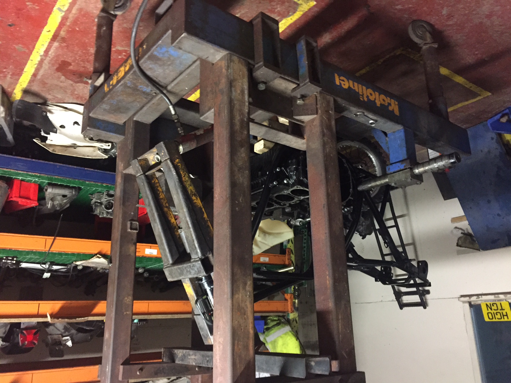

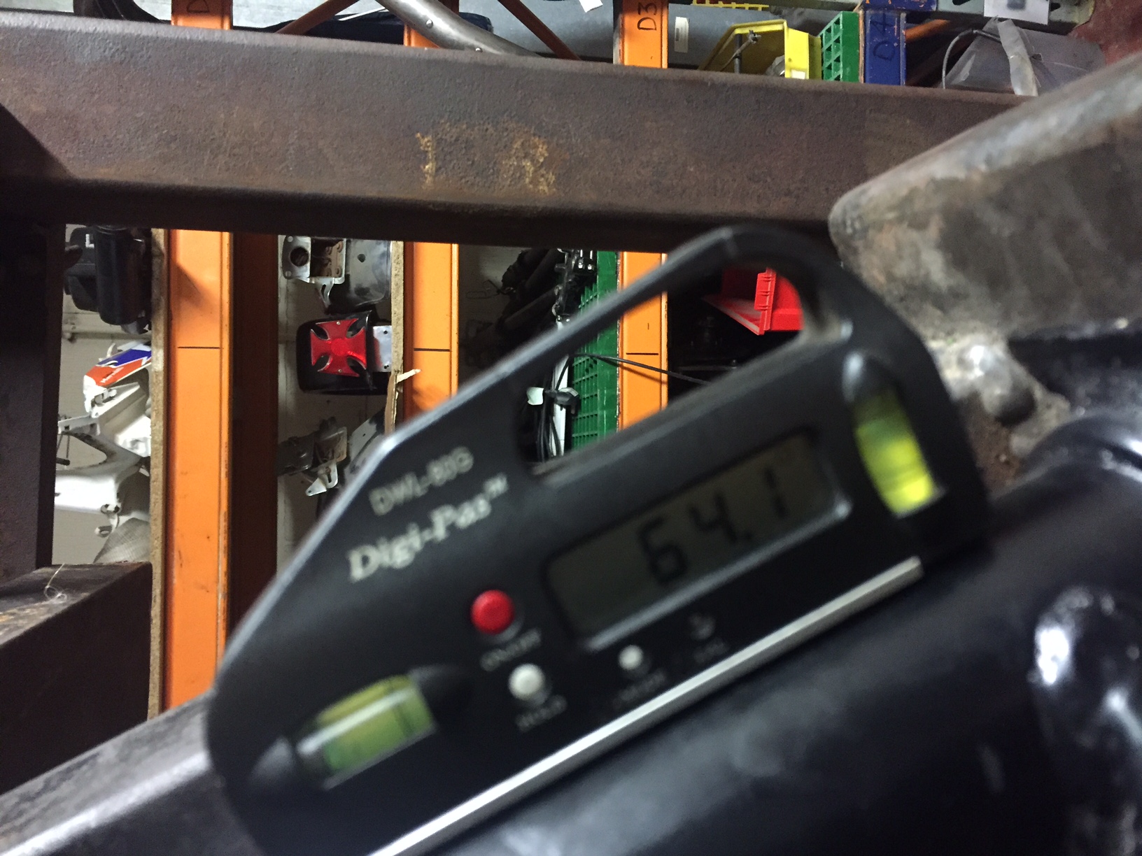

frame was 3 degrees out from vertical .....now back to stock spec ...
