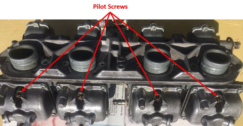

1. The 4 pilot screws do not have a "limiter" - is that a problem?

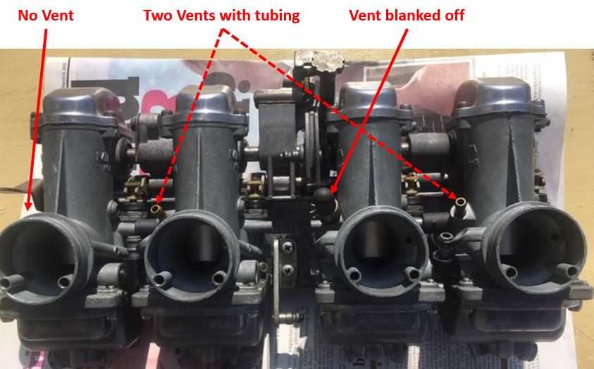

2. There are what look like vent pipes on three of the carbs. The left number 1 carb has no vent pipe, the second and fourth carbs have vent pipes with rubber hoses and carb 3 has a vent pipe that is blanked off. Is that how things should be?

no problem with the limiters being missing, just a ploy to hide them from American owners as far as I've ever understood them. the spigots on carbs 2+4 are overflows (1 for 1+2,1 for 3+4) the one on carb 3 is a vacuum take-off for a vacuum tap n should be blanked if one isn't fitted. speak to Rob z1015 if you are changing from the air box to pod filters. he makes and supplies the air correction jets required for smooth running, for the engine vent you can add a length of suitable hose (high as possible about 12-15") with a mini k/n type filter cable-tied to the frame rails.or?: keep it standard, your ears are probably not as good as they were! :lol:

The mixture screws were pre-set slightly lean on the US models due to emissions and fitted with anti tamper caps..

the tubes on number 2 and 4 carb are vent tubes, not overflow. They admit air to come out of the float chambers so don't blank them off!

I put a length of pipe on the vent tubes up towards airbox and z900 one has two nice little clips for them next
to lid i seem to remember :)
