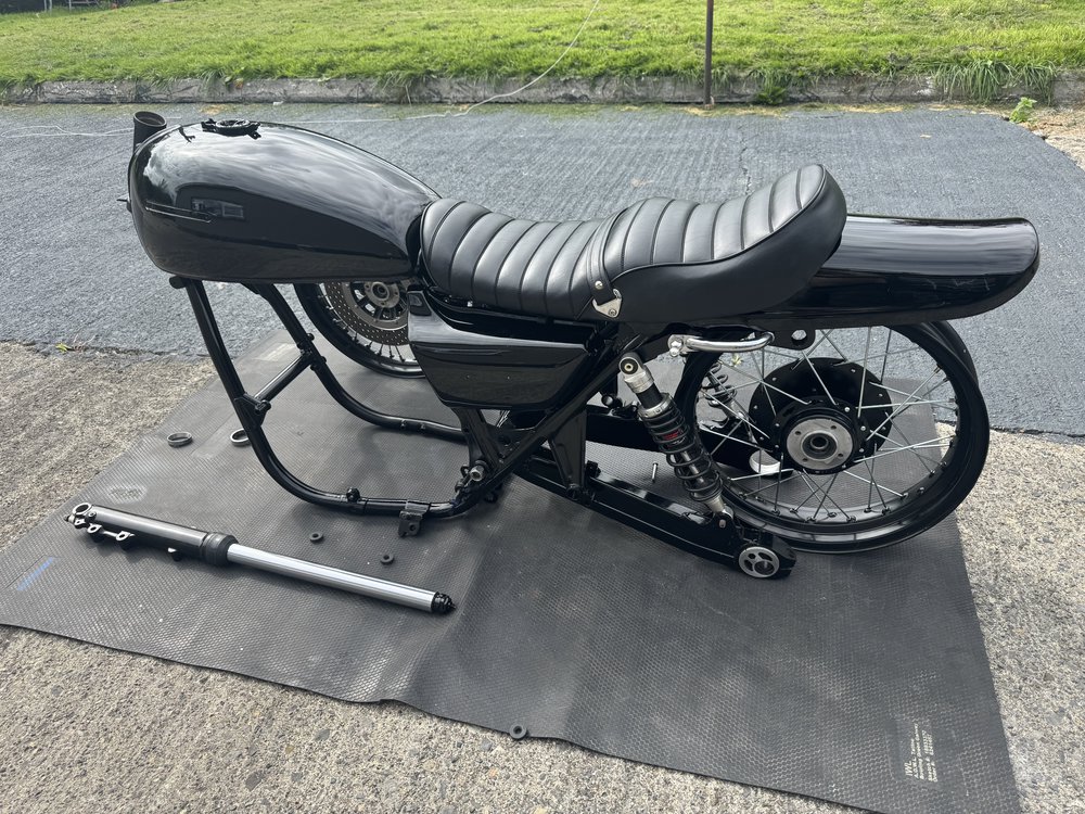

Having the wheels rebuilt and wondering about increasing the width of rear. Has anyone done this to fit into a Metmachex swingarm. I realise that this means a new rim but best choice please allowing for chain run as well. Thanks.

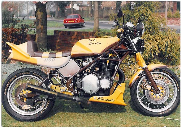

Yes I have to agree, I ran a 4.5" Akront rim with a 160 tyre, but I also matched it with a slightly larger width rim in the front too. Handles brilliantly too. Mind you it was a Moto-Martin :D
