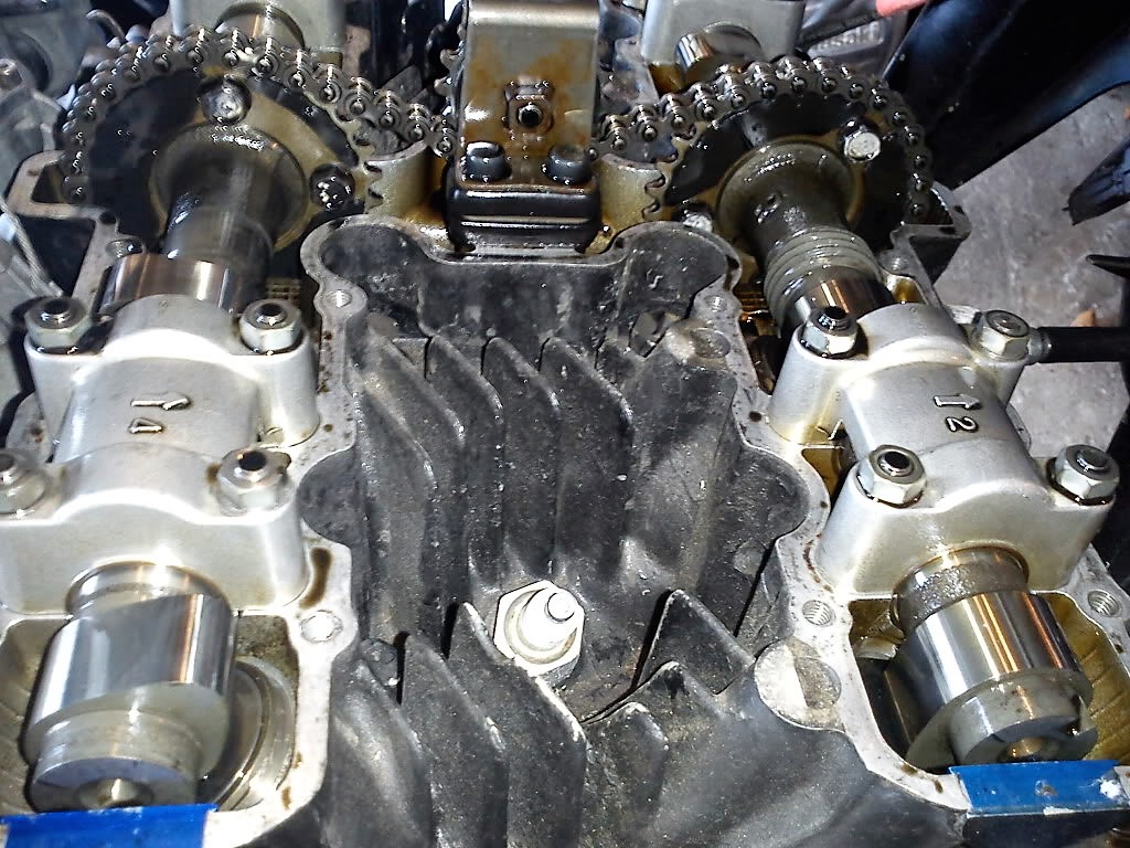

Ordered up some helicoils with various lengths. The ones that were in were 8mm long and I'm thinking you can get something a little longer in which may help as well. Just noticed I cracked a bit of the webbing on number 2 cap as well.. Eek! Anyway reading some previous threads it seems that's likely not a huge problem so I think ok to continue Vs swapping. Hopefully!

I was initially looking at Timeserts, which due to their nature are significantly stronger than helicoils, but may cause an interference problem with the buckets in the same manner as Al has suggested if tapped to M8 as they're a larger diameter. I would seriously consider M7 bolts
Quite a few people have used M8 timeserts on here to repair J threads but i suspect that its only OK if they are set high up immediately under the counterbore for the dowels.
On that subject; 7mm bolts may not fit through the dowels!
If it was caps 1 or 3 it would be an issue because the webbing there has another function but the webbing of 2 and 4 make no contribution to the security of the cams or integrity of the make up of the two piece bearing arrangement.
Does the crack extend from the webbing into the bolted on tower section?

No no cracks on the actual cap, Jair on the side of the webbing. So hopefully all is ok.. Now just hoping the new helicoils will hold ok :)

Photograph it well and in 1000 / 1500 miles when you go to check for tight clearances have a good look and compare.
Bloodied but not bowed! Looks like you may be OK after all.
