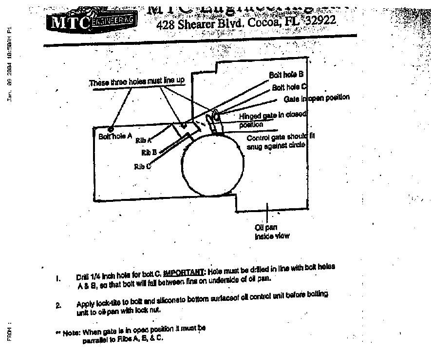

WOW.....I've FOUND THE ANSWER on this Awsome Forum of yours !
One of your Guys...BIG FLUFF your a legend !!!!
I was trolling through the forum & found his reply post from a while back. I'd heard about this Hole drilling mod but dismissed it thinking ....that sounds dodgy ! but HEY it's for real ...his factory bullentin is a winner ...WELL DONE & thankyou Big Fluff.

The oil pan gate is not a waste of time and a good and easy mod to have if you ride with a heavy wrist or have a tuned motor.
I fit one to all of mine.

Glad to be of assistance, and like Rob (Zed1015) says, a worthwhile mod on any sump.

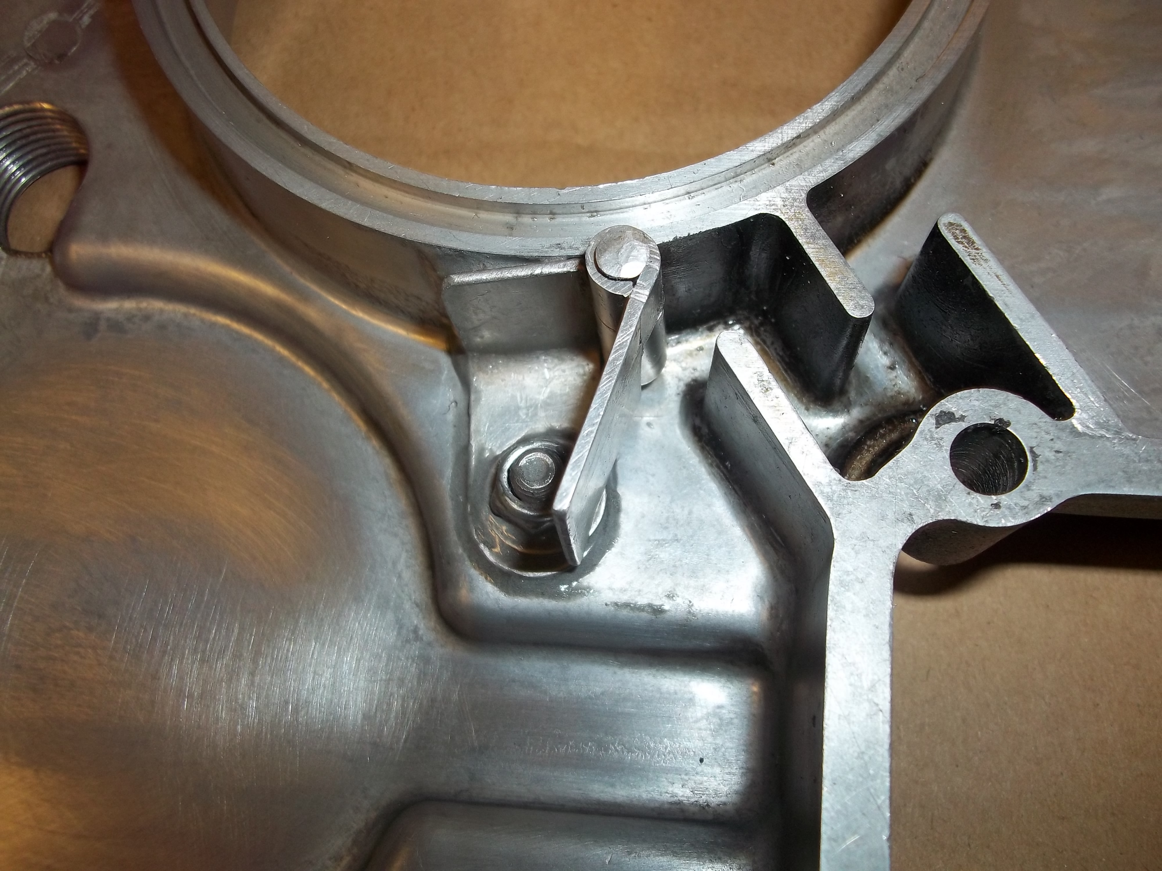

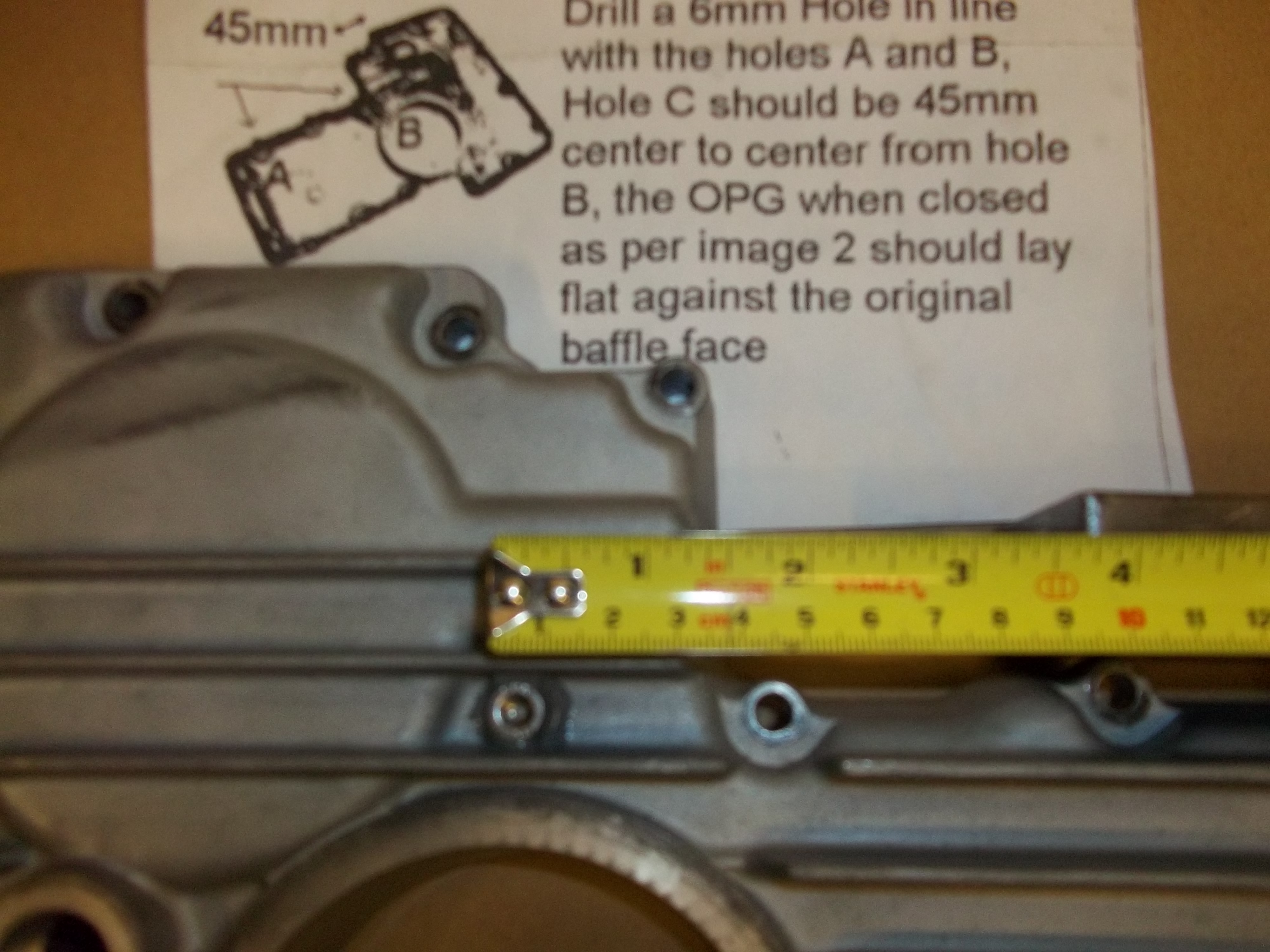

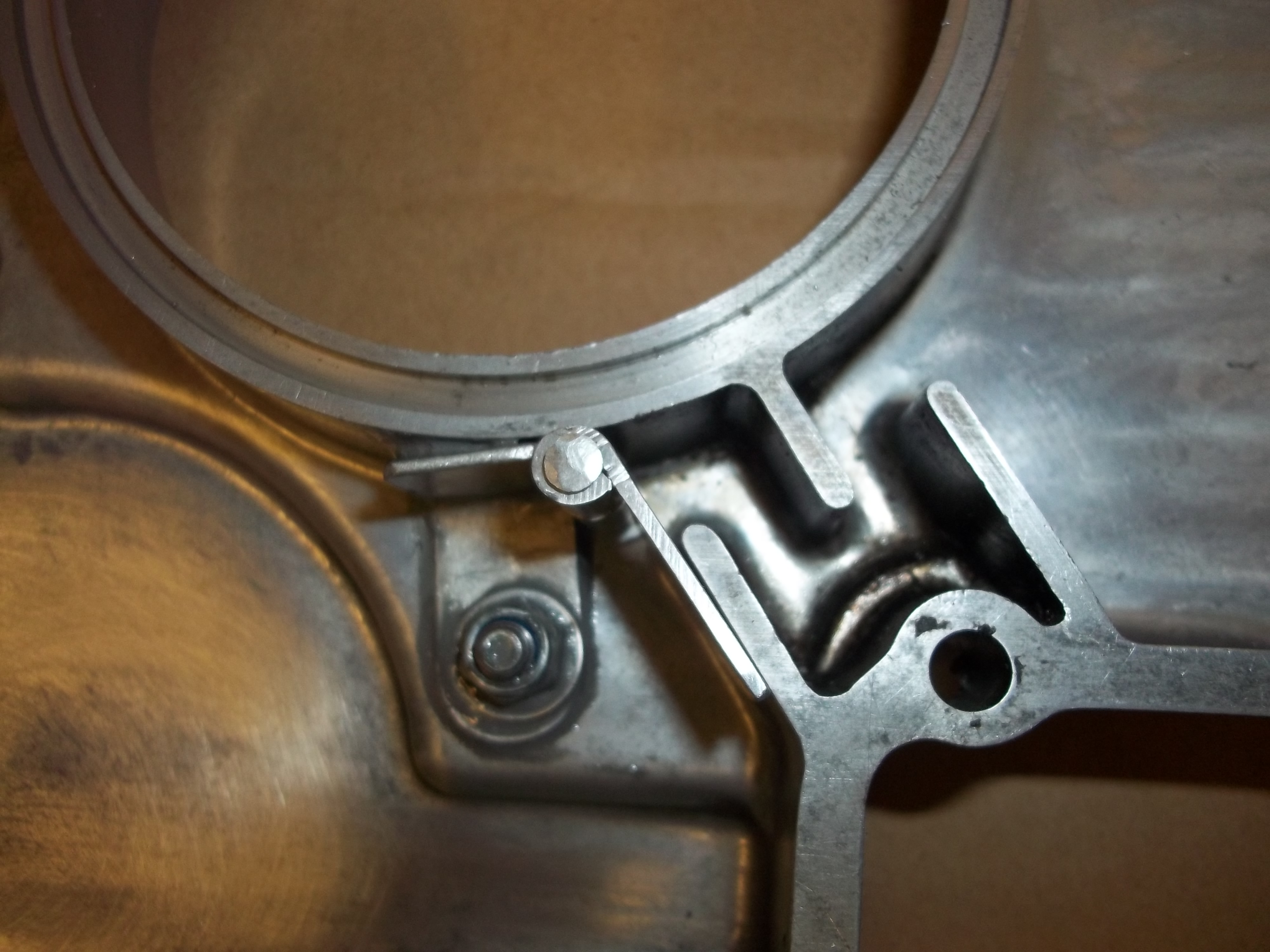

#8 PostAuthor: sanderz » Mon Sep 30, 2013 4:44 pm
Hope this helps if you go ahead with the mod - well worth it in my opinion
