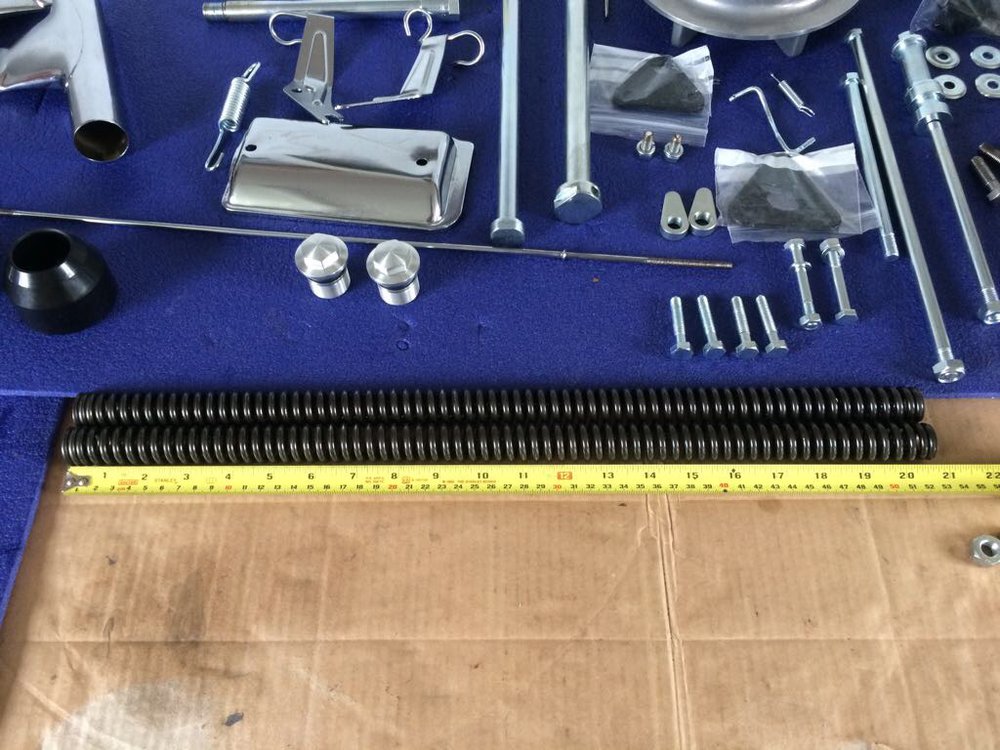

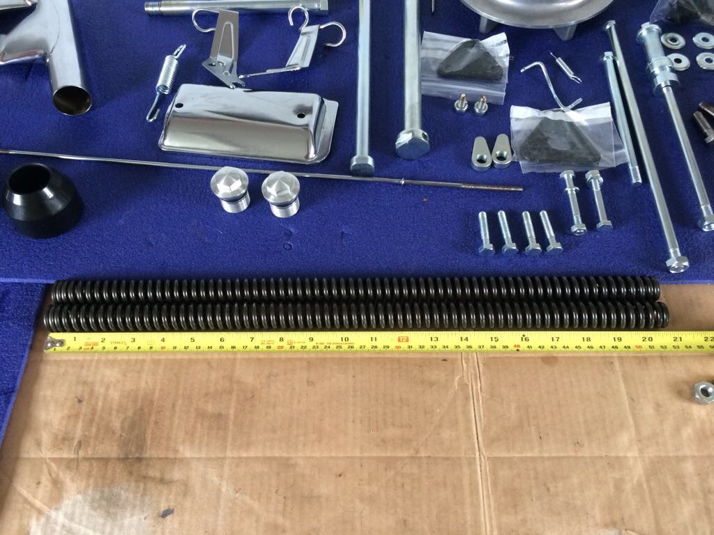

Attached photo's are the springs from my Z1a.
Manual says replace if under 496mm but does not say what they should actually be ?
Mine measure 523mm, this seems a bit excessive ?

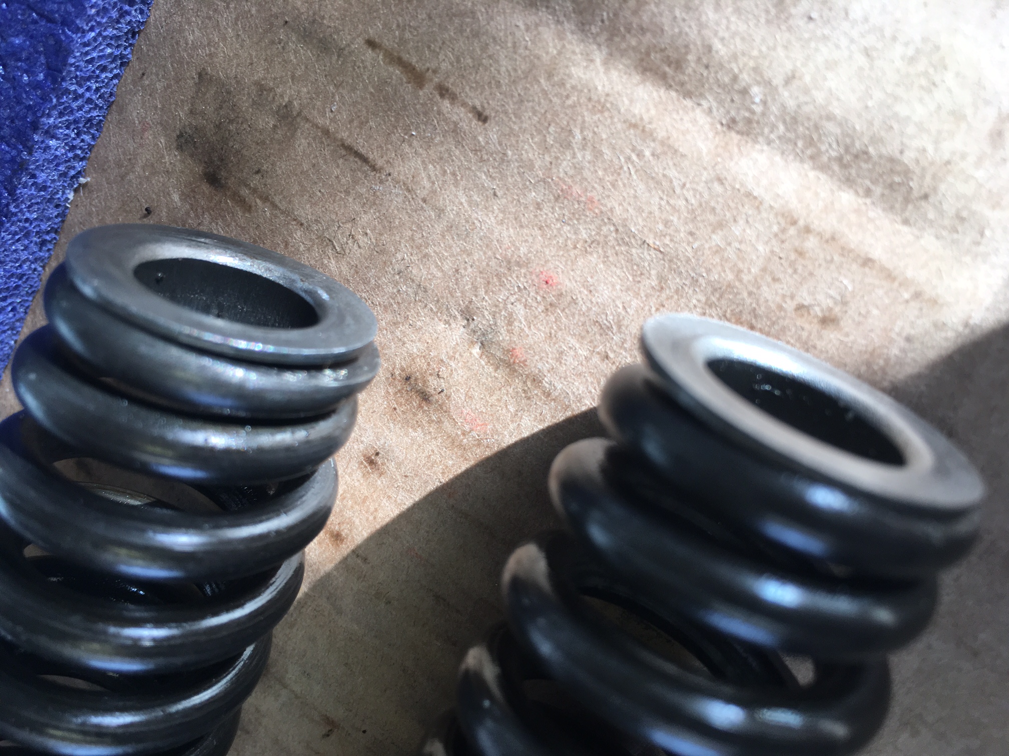

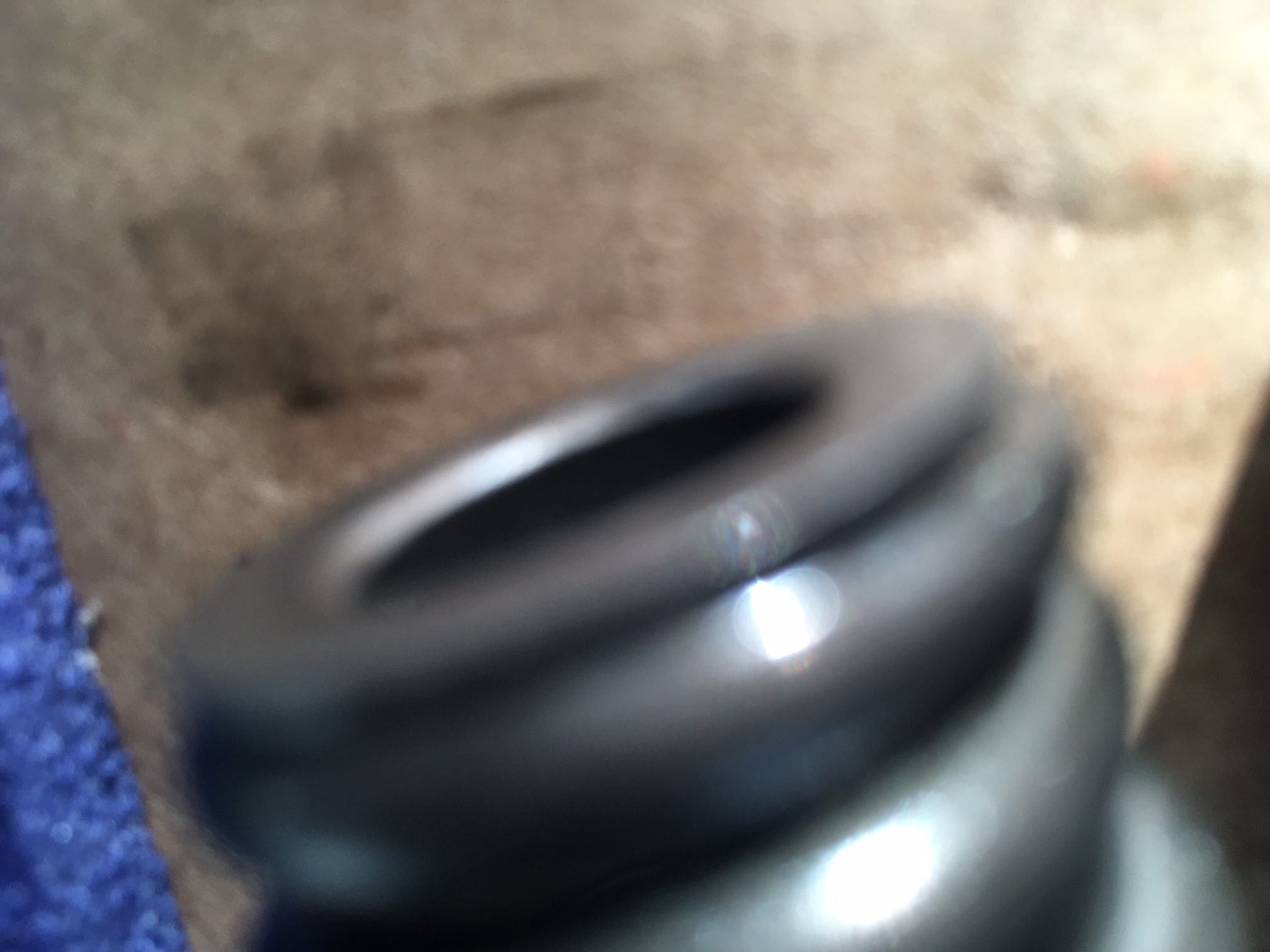

Also I have caps in the ends but can find no reference to these for a Z1a.
If I load springs without caps they stick out of the tubes by 15mm, if I leave the caps on they stick out 25mm because the caps do not slide over the innards (maybe).
The opening at the other end of spring is larger so caps would not be gripped.
Any body out there come across this ?

standard length 495.5mm service limit 485mm

That's strange, both Haynes and Clymer both agree for 73, Z1 but say service limit 496mm 74 / 75, Z1a & z1b ?
Have to know for sure and will cut down :??

taken from the genuine kawasaki manual . your fork springs are not the original they are after market heavy duty springs

if you are going to cut them you will have to use a slitting disc on a angle grinder then the end of the spring will need to be ground flat then you can still use the capped washers

They are HD springs and I would leave them in.
The stock suspension is soft as shit and these springs help the handling.
If you really want stock springs then buy some or trade with another member.
Cutting these springs won't soften them up but just reduce the preload and increase the static sag.
The spring rate will remain the same.
