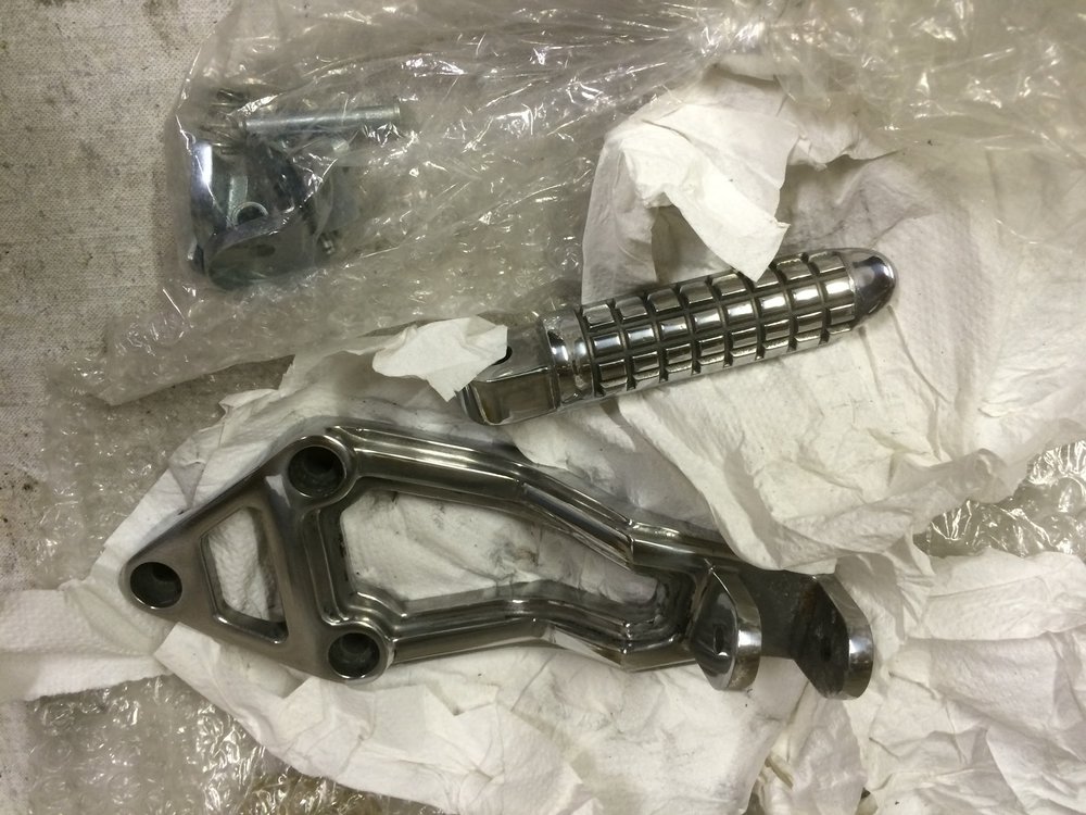

#10 PostAuthor: Gus » Fri Jan 04, 2019 10:47 am
chrisNI wrote:I flogged a set of Tarozzis a couple of weeks ago with rear pegs to go with them. Not much help to you but if you look for the For Sale post you’ll see the setup. On a 1000R but would be the same.
These are the rear pegs Chris had.
They could be an option if we knew what they were off.
If anybody recognises them that would be a great help as I could do with some also.
I'm a tight git and would prefer the buy this type off ebay option :lol:
Gus

#15 PostAuthor: Ginger Bear » Fri Jan 04, 2019 5:57 pm
Gus
A lot of sportbike pegs can be easily adapted, either by welding a tab under the downtube or drilling and welding in a sleeve. Pictured are early R1 pegs.
