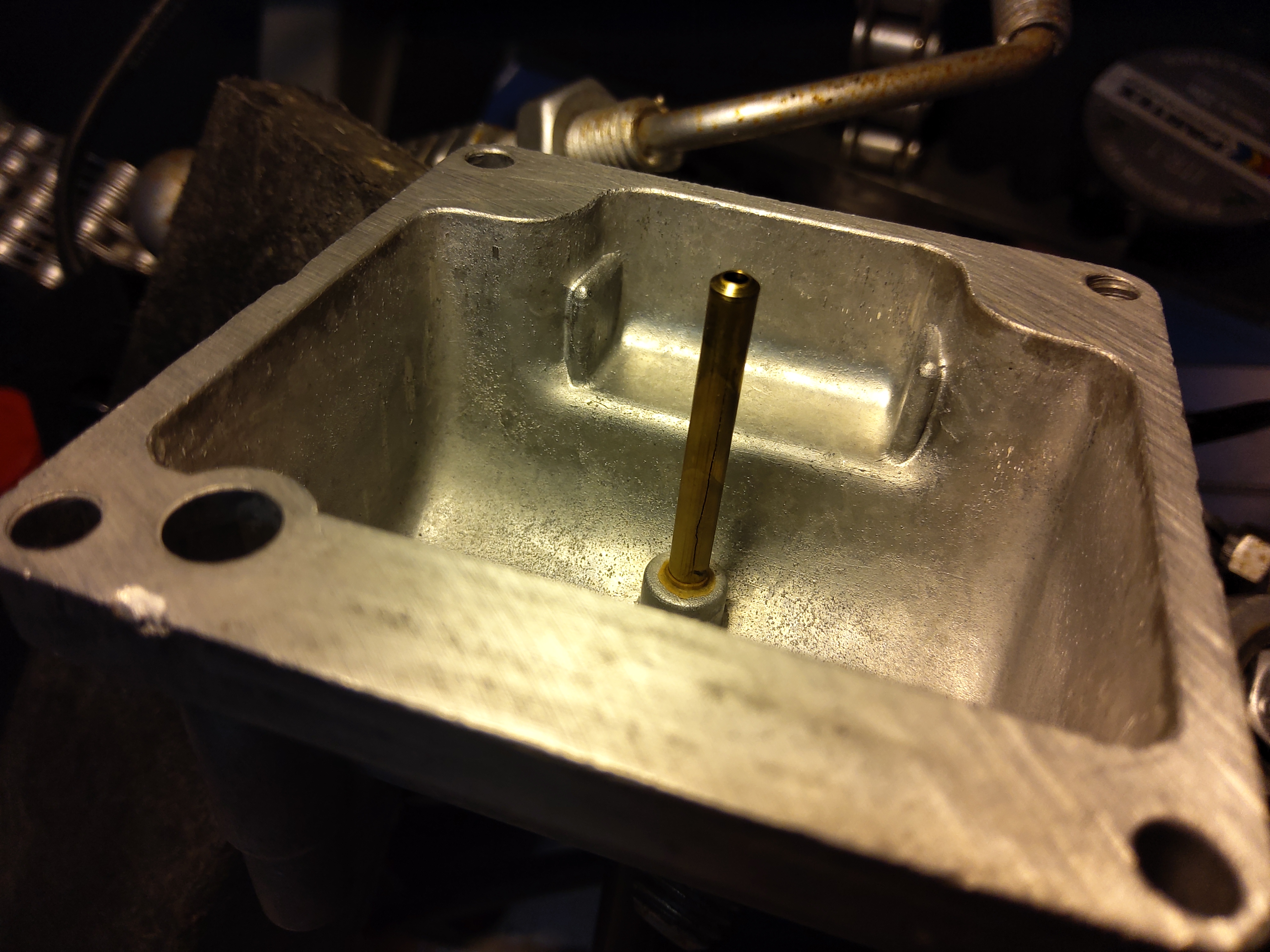

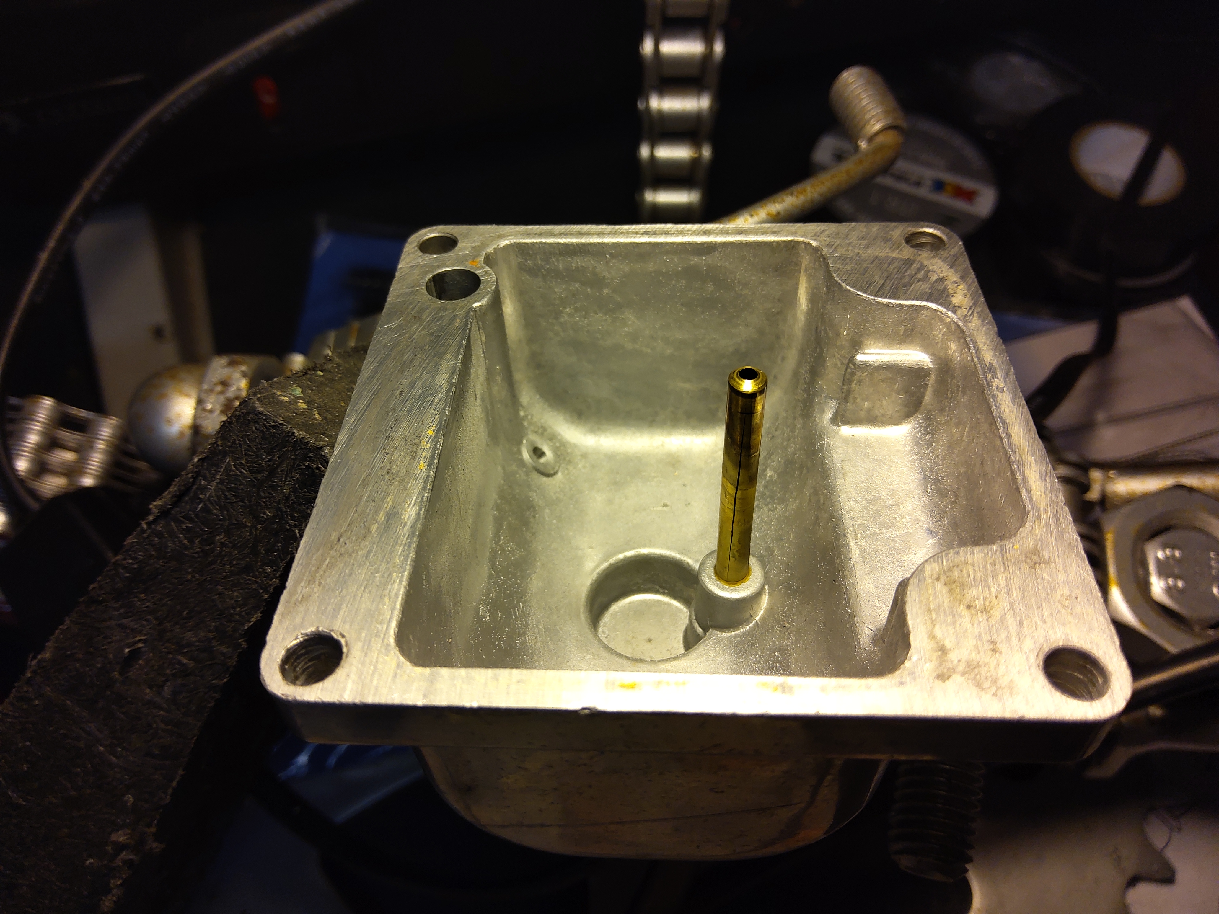

As you guys can see from the pics, I discovered why the overflow pipes were pissing fuel on carbs #1 & 2. I actually got the carbs off the bike and adjusted the float on carb #1 to spec with the clear pipe tool but the overflow still leaked. Then I checked the brass overflow tube in the float bowl itself, and this is what I found on both #1 and #2. Checking #3 and #4 I found that they were, fortunately, both OK. I have a spare carb set and the #1 and #2 float bowls on those look OK so I will do the fuel fill/bubble test tomorrow.
Does anyone know if it's possible to repair the hairline splits in these overflow tubes or is it possible to remove them and get new brass tubes fitted?

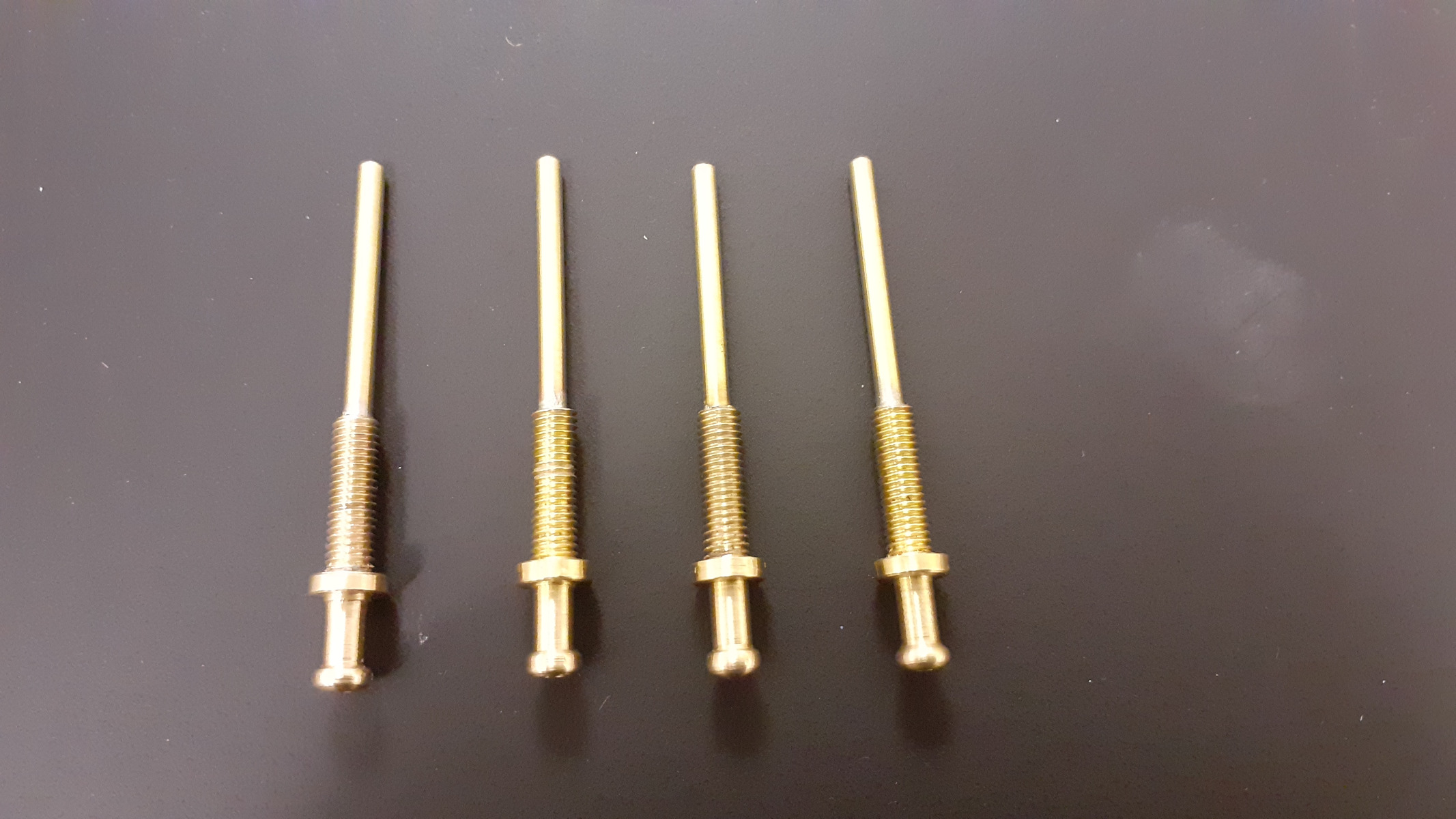

#9 PostAuthor: kev edwards » Tue Oct 20, 2020 7:13 pm
This is what i done.

#11 PostAuthor: kev edwards » Wed Oct 21, 2020 6:37 am
I made them.

1) How are the genuine ones fitted. Are they a press fit or threaded like yours?
2) How do you stop the fuel leaking along the threads?
3) Can you make some for me? If so...
...4) (sitting down) how much?

#13 PostAuthor: walshyco » Wed Oct 21, 2020 12:16 pm
You could just solder them up and then pass a drill bit through by hand to clean them out.

#14 PostAuthor: kev edwards » Wed Oct 21, 2020 12:30 pm
Genuine are push fit, inner and outer are separate pieces, I use a twist of ptfe tape to keep them sealed, they are made in two parts, never thought about making them for others, I guess I could make the odd one or two.

#15 PostAuthor: steve452 » Wed Oct 21, 2020 1:13 pm
I think you could be onto a winner there Kev considering 2 out of my 4 carbs had split overflow tubes. I'll hang fire for the moment and go with Walshyco's option first.
