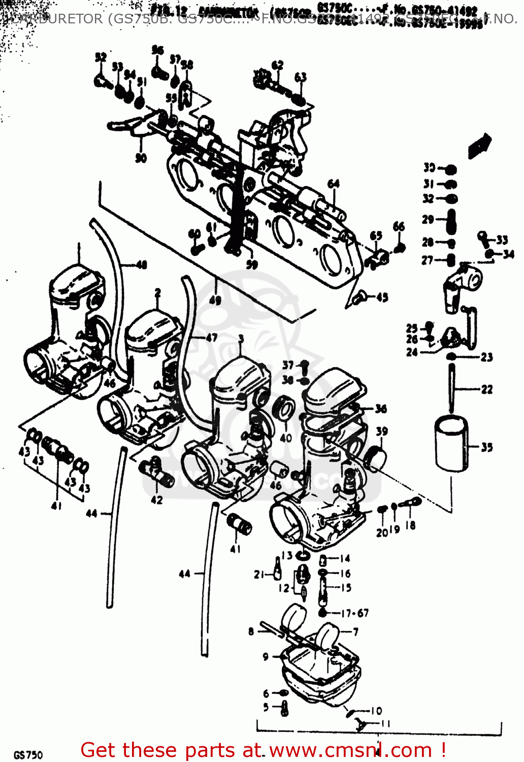

kawasaki never made them with a seperate o ring fitted it was moulded to have the same effect as an o ring someone has probably fitted suzuki gs750b fittings that have seperate o rings & are available to buy seperate & are the same size as the kawasaki

i worked at cradley for over thirty years as a mechanic & have stripped many of these carbs & have never seen them with removable o rings if they had removable o rings they would be shown in the parts diagrams or parts microfiche. contact dave marsden at z power if you want more confirmation
gs 750b
suzuki-gs750-1977-b-usa-e03-carburetor-gs750b-gs750cfnogs750-41492-gs750ecfno_big3IMG00903056_33a7.gif
