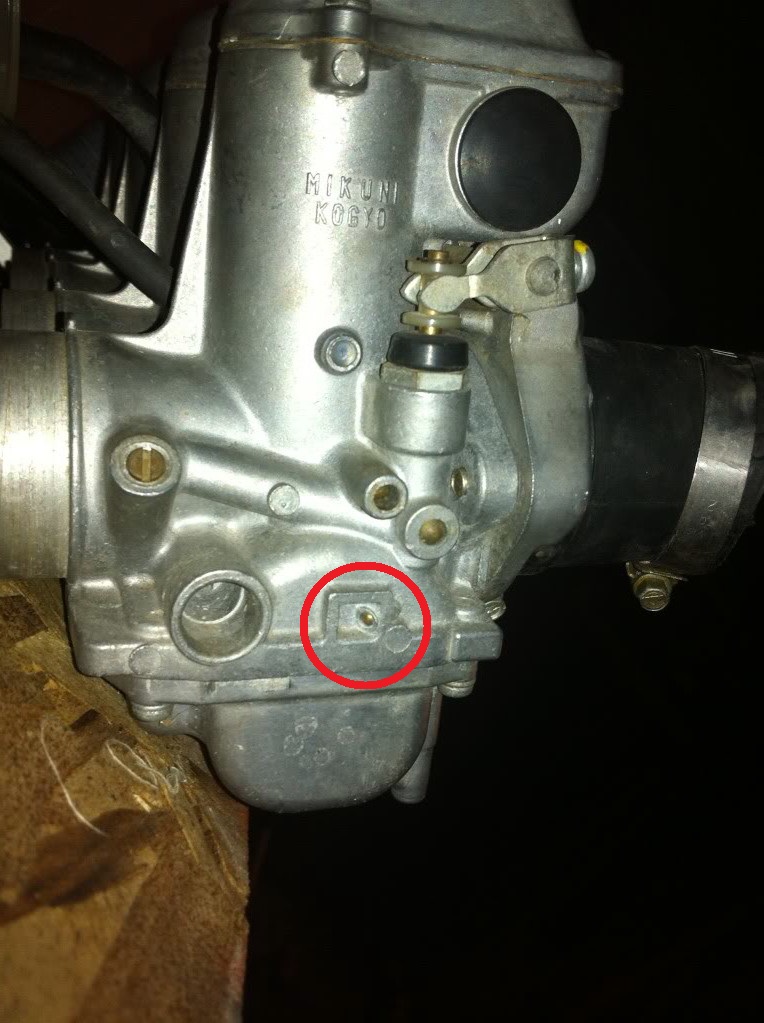

#7 PostAuthor: zed1015 » Sat Apr 17, 2021 8:13 pm
JWO261N wrote:
When I had the carbs apart there is jet in the bottom front of each carb. There wasn’t a replacement for them in the kit. I’ve just screwed them back in. Any idea what they are?
If the jets are the same as the ones highlighted in the pic they are air correctors for running pods or open carbs.
If you have the airbox fitted they must be removed otherwise they will cause over fuelling and bogging.
I also recommend that unless damaged you should re-fit any original Mikuni brass components as most aftermarket kits ( except Keyster) are poor quality and cause more problems than they solve.
The only wear parts that should be replaced are 'O' rings , gaskets and the float valves.

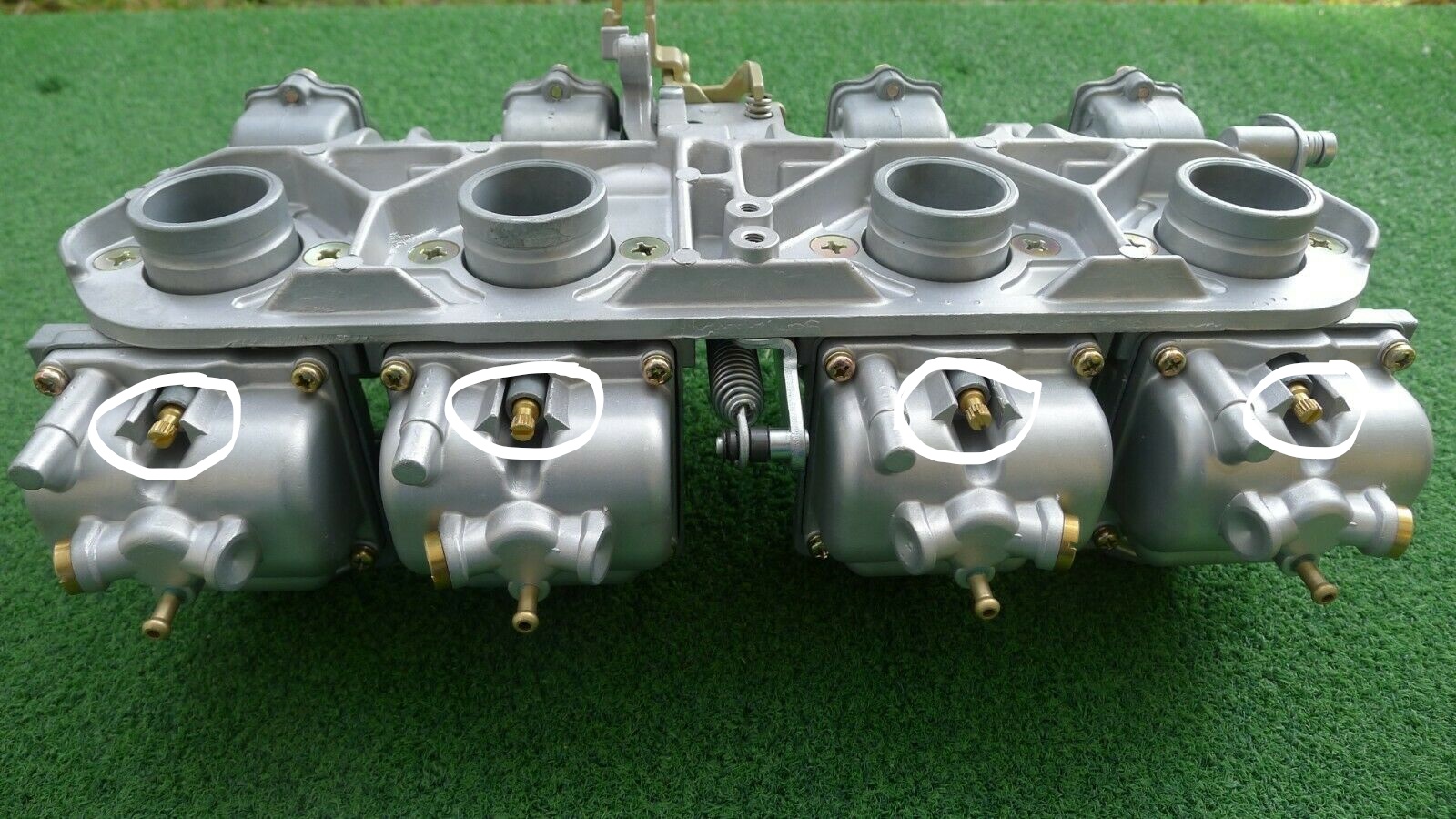

#8 PostAuthor: kev edwards » Sat Apr 17, 2021 8:34 pm
Would the screws in the white circles be the ones you have screwed right in, if so then you then have stopped fuel supply at low end of running, these should be around 1 and 1/4 turns out, the ones on the sides which are your air screws around 1 and 1/8 turns out, it does sound like you have fuel starvation, the Haynes manuals are far from the best to use, a factory manual is by far the best, not cheap but worth every penny.

#9 PostAuthor: JWO261N » Sat Apr 17, 2021 8:38 pm
zed1015 wrote:
If you have the airbox fitted they must be removed otherwise they will cause over fuelling.
I don’t have those in my carbs, but I have the stock air box so that’s ok I guess (phew).
In your picture at the bottom of the carb go forward from the overflow outlet and there’s another jet?
I used 4 keyster refurb kits btw :wink
Interestingly, you have 2 fuel feeds?
My set has just one fuel feed in middle, but my tap only has one outlet so ....

#10 PostAuthor: JWO261N » Sat Apr 17, 2021 8:45 pm
kev edwards wrote:Would the screws in the white circles be the ones you have screwed right in, if so then you then have stopped fuel supply at low end of running, these should be around 1 and 1/4 turns out, the ones on the sides which are your air screws around 1 and 1/8 turns out, it does sound like you have fuel starvation, the Haynes manuals are far from the best to use, a factory manual is by far the best, not cheap but worth every penny.s-l1600 (1)_LI.jpg
Yep, those ore the ones I’ve been wondering about.
That looks like job #1 tomorrow then :roll:
I’ll start looking for the factory manual, if I keep this bike I think I’ll need it ....

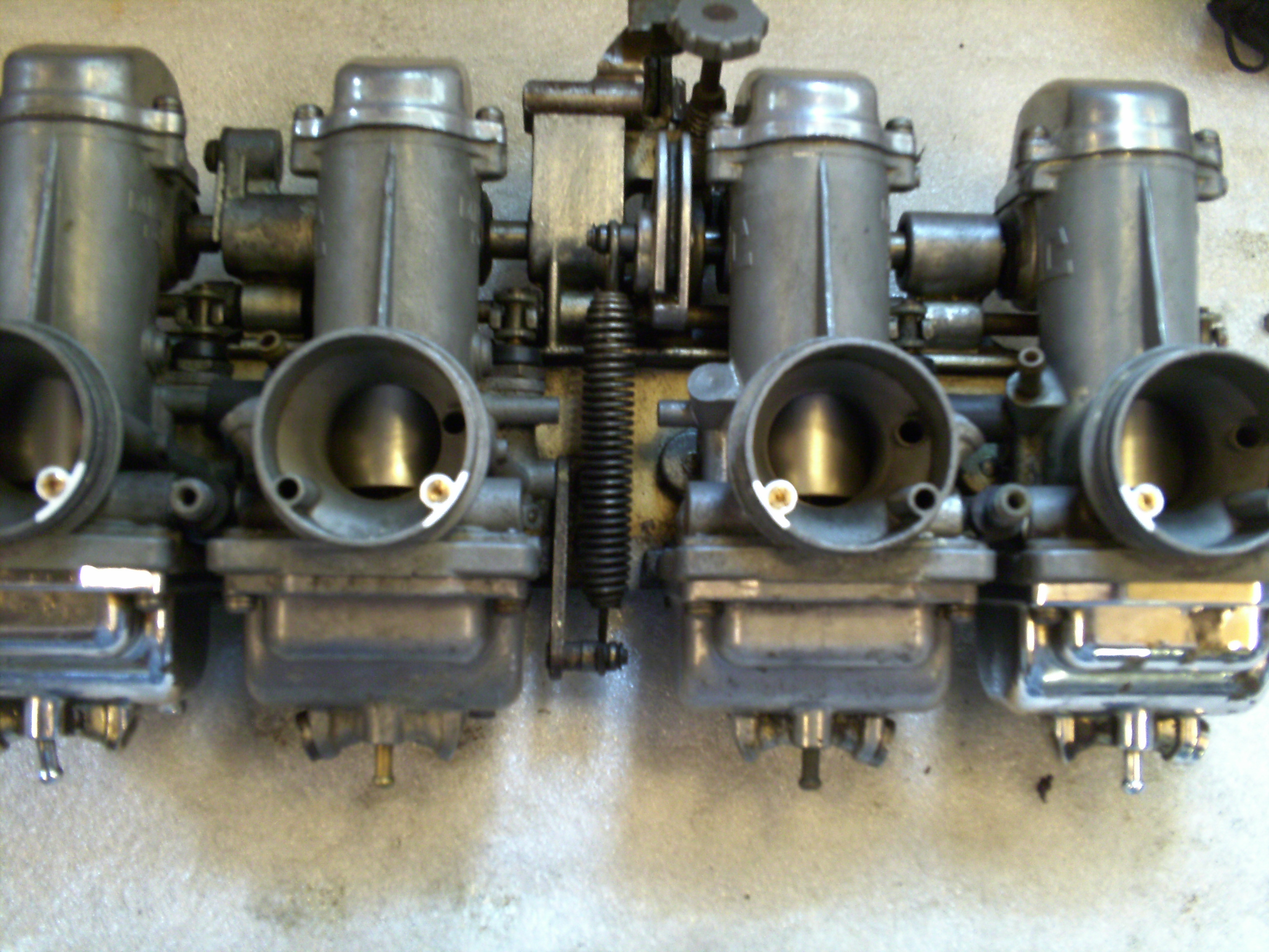

#11 PostAuthor: zed1015 » Sat Apr 17, 2021 8:46 pm
Depending on model they have either one or two fuel tees.
A pic of your carbs would be better but they wouldn't happen to look like these from the front would they ?
And have this square casting on the side ?

#12 PostAuthor: kev edwards » Sat Apr 17, 2021 8:53 pm
Turn them out 1 an 1/4 turns and I bet she plays ball, then it will be fine tuning needed, and Rob zed1015 knows tons on this . Keep us posted.
