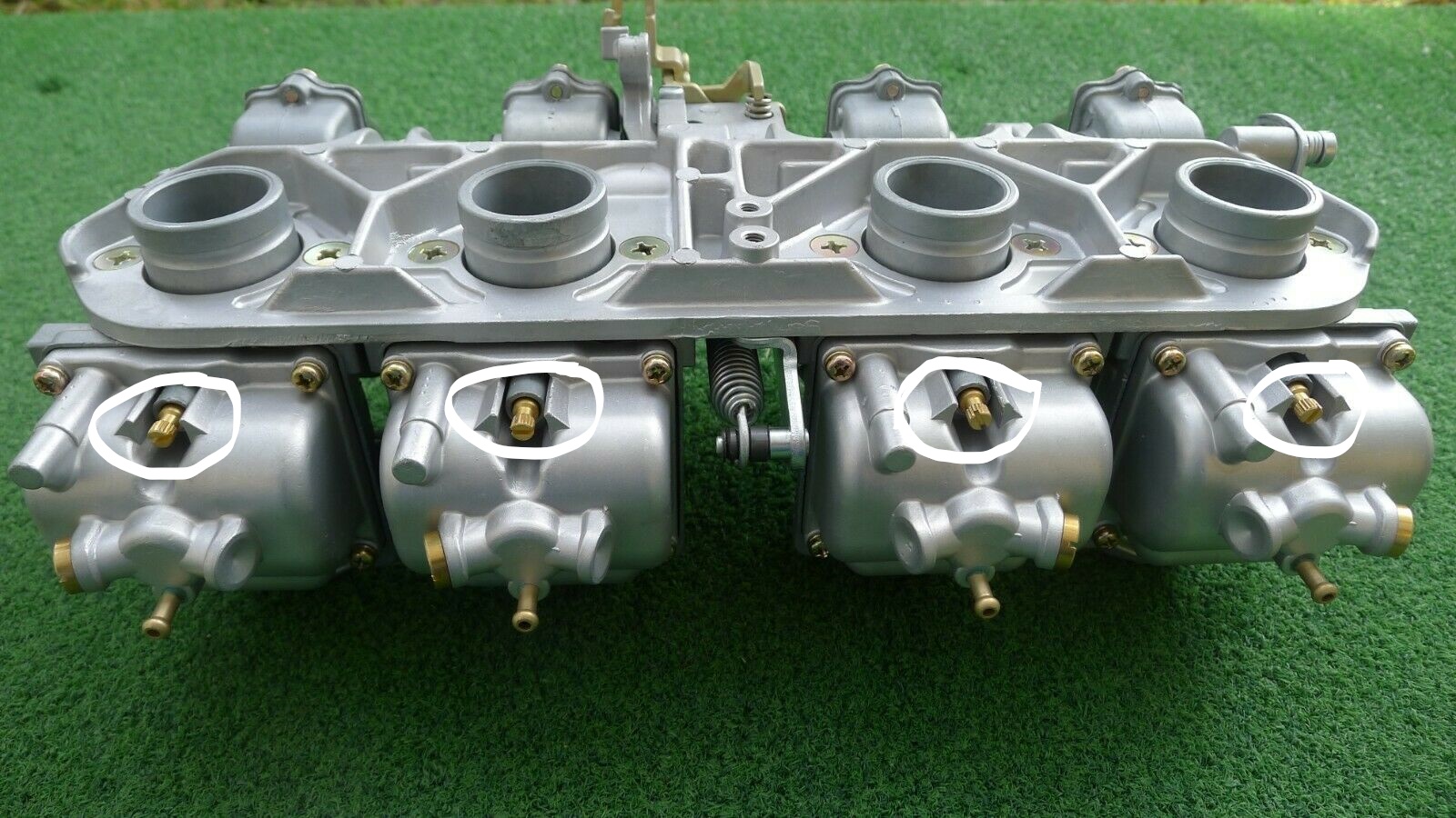

#8 PostAuthor: kev edwards » Sat Apr 17, 2021 8:34 pm
Would the screws in the white circles be the ones you have screwed right in, if so then you then have stopped fuel supply at low end of running, these should be around 1 and 1/4 turns out, the ones on the sides which are your air screws around 1 and 1/8 turns out, it does sound like you have fuel starvation, the Haynes manuals are far from the best to use, a factory manual is by far the best, not cheap but worth every penny.

#10 PostAuthor: JWO261N » Sat Apr 17, 2021 8:45 pm
kev edwards wrote:Would the screws in the white circles be the ones you have screwed right in, if so then you then have stopped fuel supply at low end of running, these should be around 1 and 1/4 turns out, the ones on the sides which are your air screws around 1 and 1/8 turns out, it does sound like you have fuel starvation, the Haynes manuals are far from the best to use, a factory manual is by far the best, not cheap but worth every penny.s-l1600 (1)_LI.jpg
Yep, those ore the ones I’ve been wondering about.
That looks like job #1 tomorrow then :roll:
I’ll start looking for the factory manual, if I keep this bike I think I’ll need it ....

#12 PostAuthor: kev edwards » Sat Apr 17, 2021 8:53 pm
Turn them out 1 an 1/4 turns and I bet she plays ball, then it will be fine tuning needed, and Rob zed1015 knows tons on this . Keep us posted.
