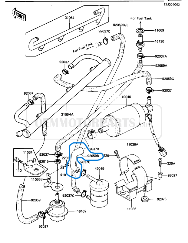

Hi.
Whilst putting my B2 back together noticed that the short moulded fuel feed pipe from the filter to pump had a split in it. Looking for a replacement or an alternative I can adapt. Pt No. 92059-1165.
Alan
GPZ B1-B2 _FUEL PUMP HOSE.png (121.87 KiB) Viewed 3510 times

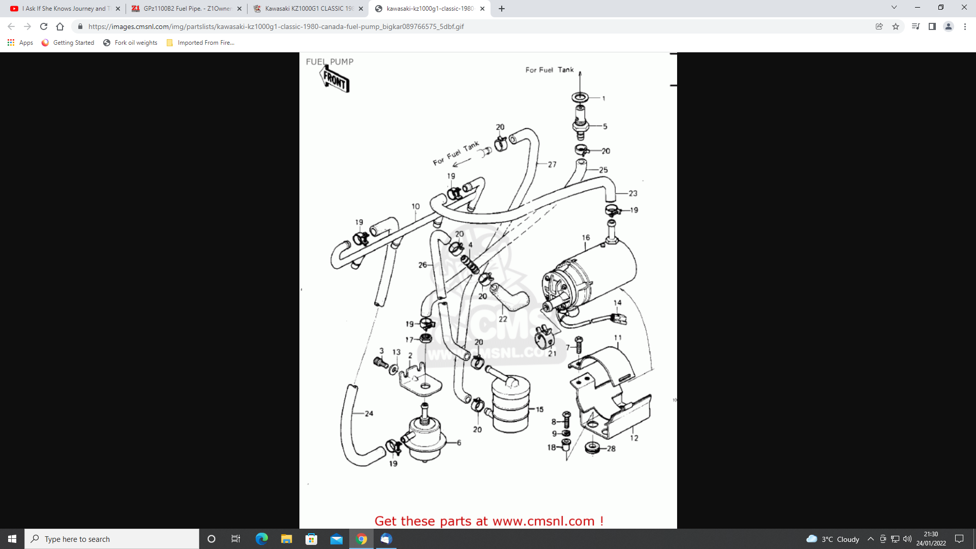

#6 PostAuthor: Al » Mon Jan 24, 2022 9:38 pm
As a temp solution til something more permanent comes along; something like the one on the G1 which is similar but made in two parts with a ferrule joiner in between.

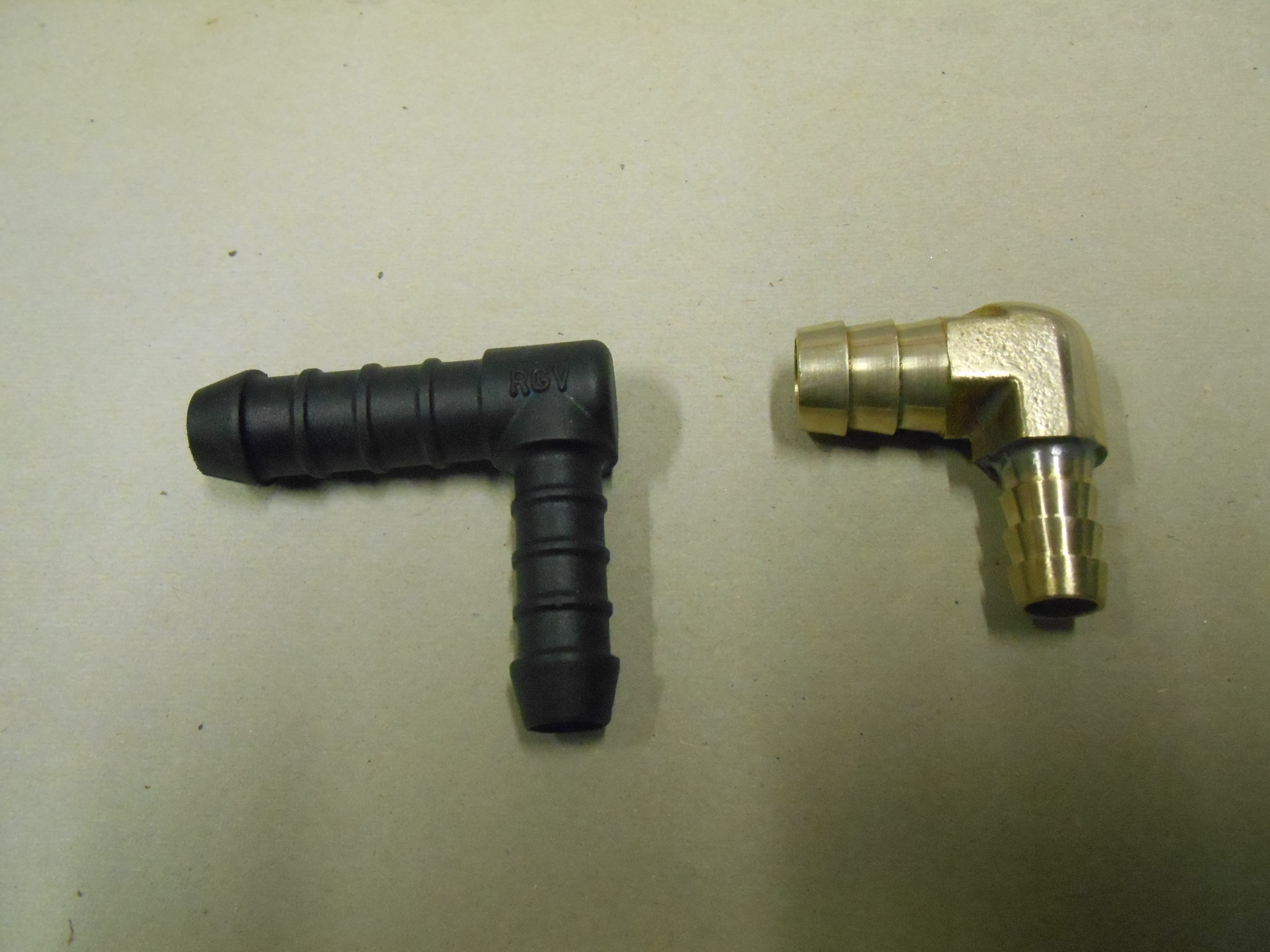

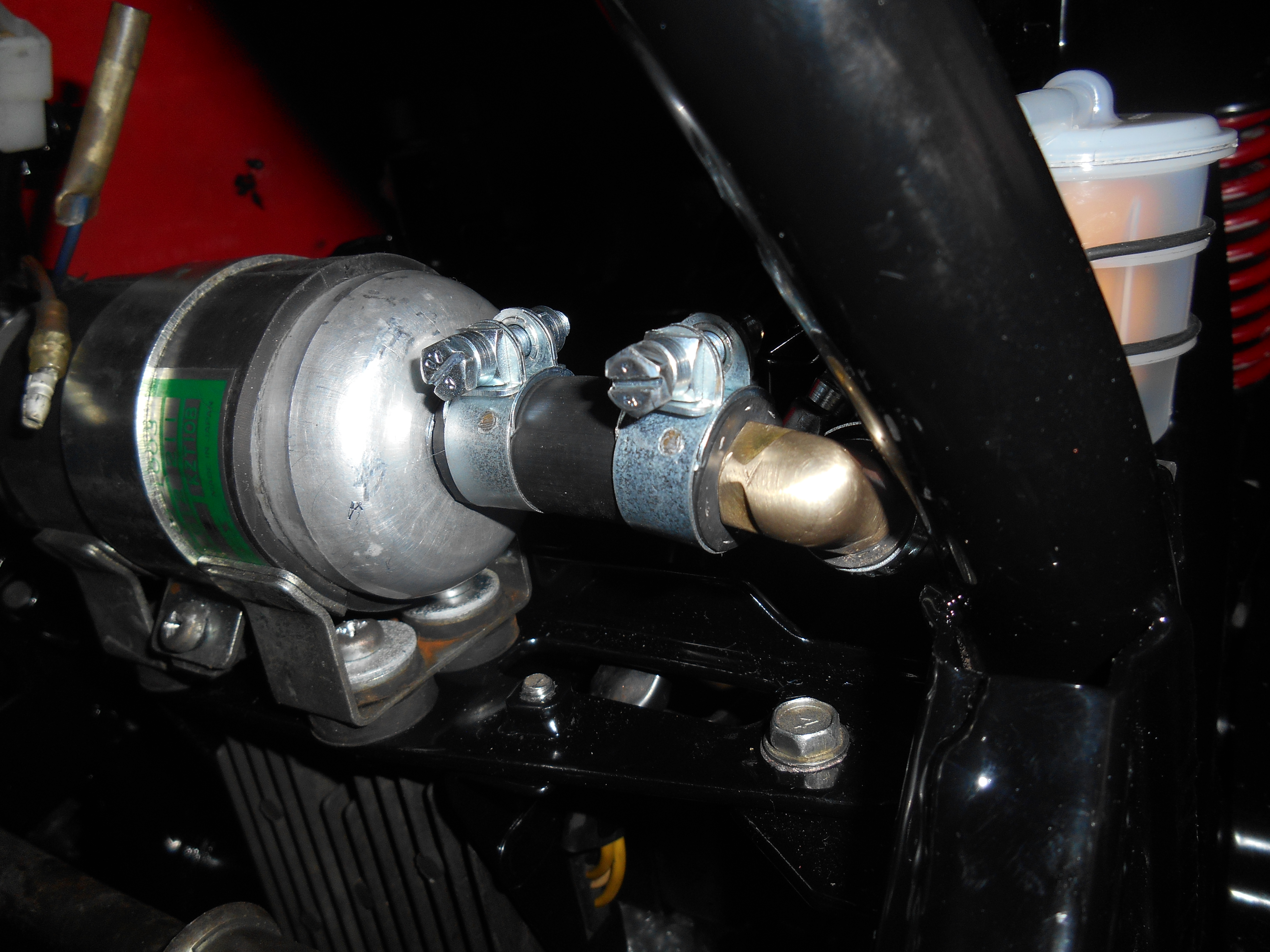

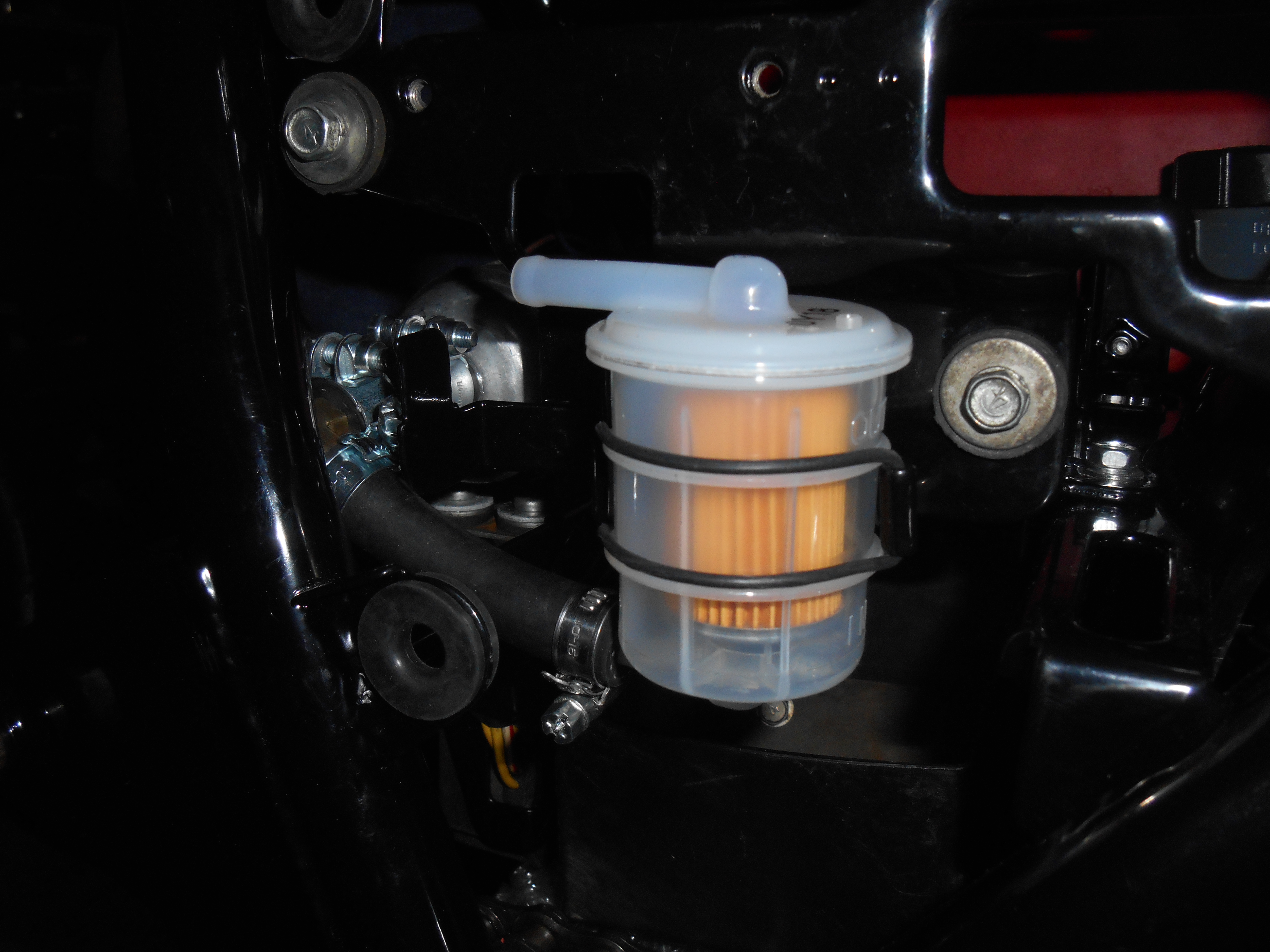

Hi.
Came up with a solution for or the pump supply pipe replacement. Nothing like original but perfectly acceptable.
Space is a bit tight there so looked for some thing short to fit in that would step up from 8mm to 10. Acquired a plastic 90 degree elbow but that was bit long and plastic for my liking.
Ended buying a pair 8 and 10mm stumpy brass 90 degree fittings and adapted/soldered them together to make the very short step up. See pics. [ I know the filters upside down. ] Easy fix at a cost of a tenner.

#12 PostAuthor: Simonic » Sun Feb 06, 2022 7:03 pm
Nice bit of work there mate
Tony
Posts: 105
Joined: 28th Sep 2019
Location: Manchester
Re: GPz1100B2 Fuel Pipe.
#13 PostAuthor: Tony » Sun Feb 06, 2022 10:08 pm
Very nice simple but effective 10 out of 10 for effort and back in buisnes
