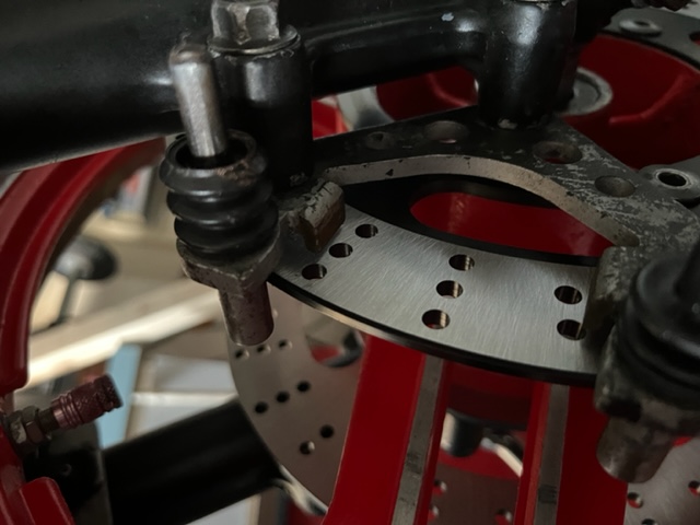

Been having a nightmare with trying to fit the brake callipers on the gpz11 I am beginning to suspect that either the callipers are gpz750 or the fork legs are gpz750. The problem is when I trying to fit the callipers they are binding on the disk on the top edge, I thought the disk may be warped hence I bought new ones but that was when I discovered that it was the top edge that was catching. Can anyone tell me if the 750 and 1100 for legs are different

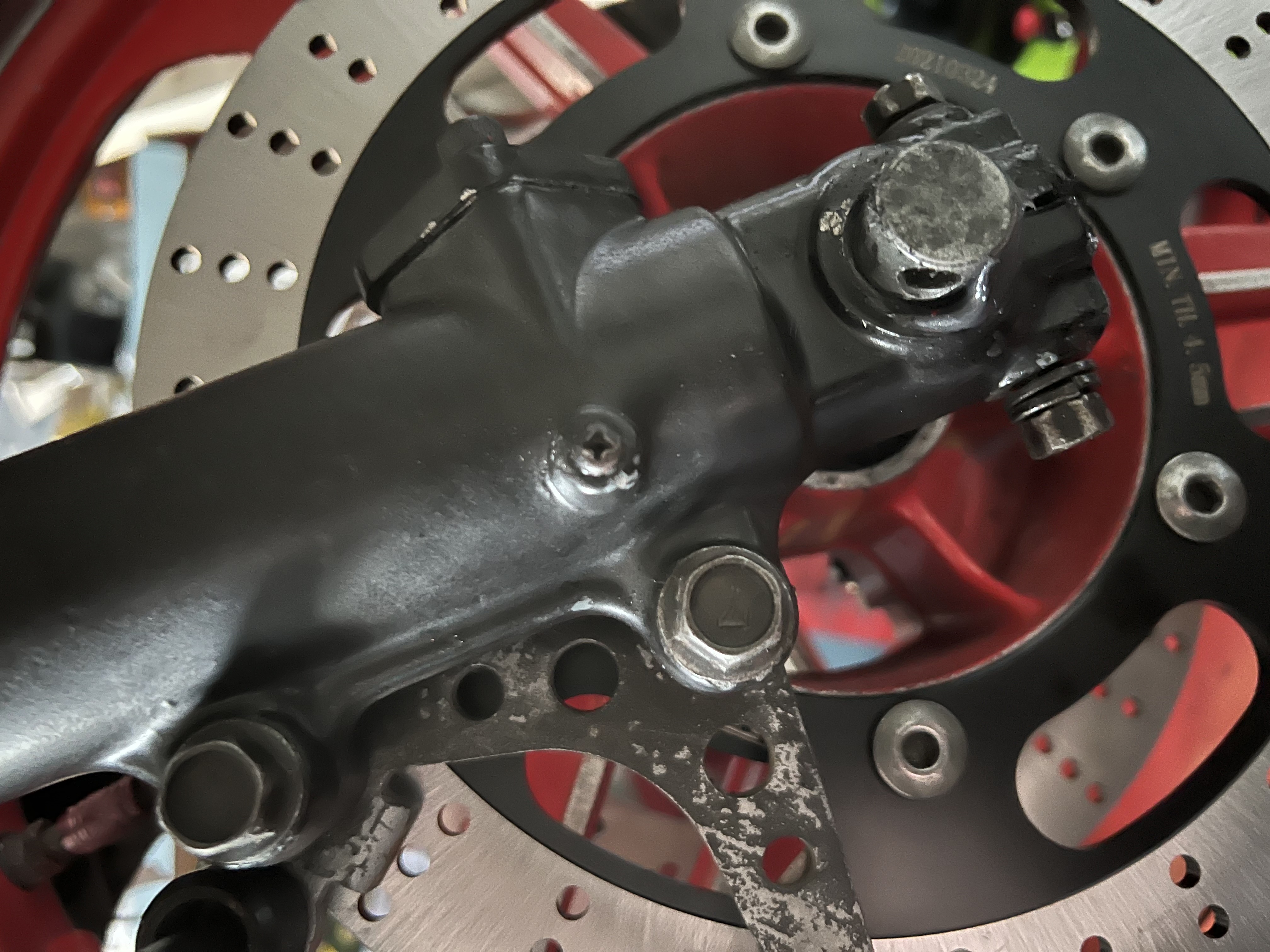

#4 PostAuthor: deka » Tue Feb 22, 2022 2:30 pm
Hi
Its the leading edge of the disc so not the part where the pads sit but the top see pic the black bit
scott

Looks like the disc is 10mm bigger. I had a similar issue. Ended up getting discs made to suit.

according to CMS.NL the fork legs of a Gpz1100 and those of a Gpz750 are the same...
I think the problem may be that the disks you have are too big like scott replied.

gpz1100 a1/ a2 280mm front discs
gpz750 a1/ a2 270mm front discs
750 & 1100 brake calipers are identical & have the same part numbers

gpz1100 a1/a2 & gpz750e1/e2 turbo use the same lower fork legs & front brake discs & brake calipers. gpz750a1 /a2 have different lower fork legs & smaller diameter brake discs but use the same calipers
