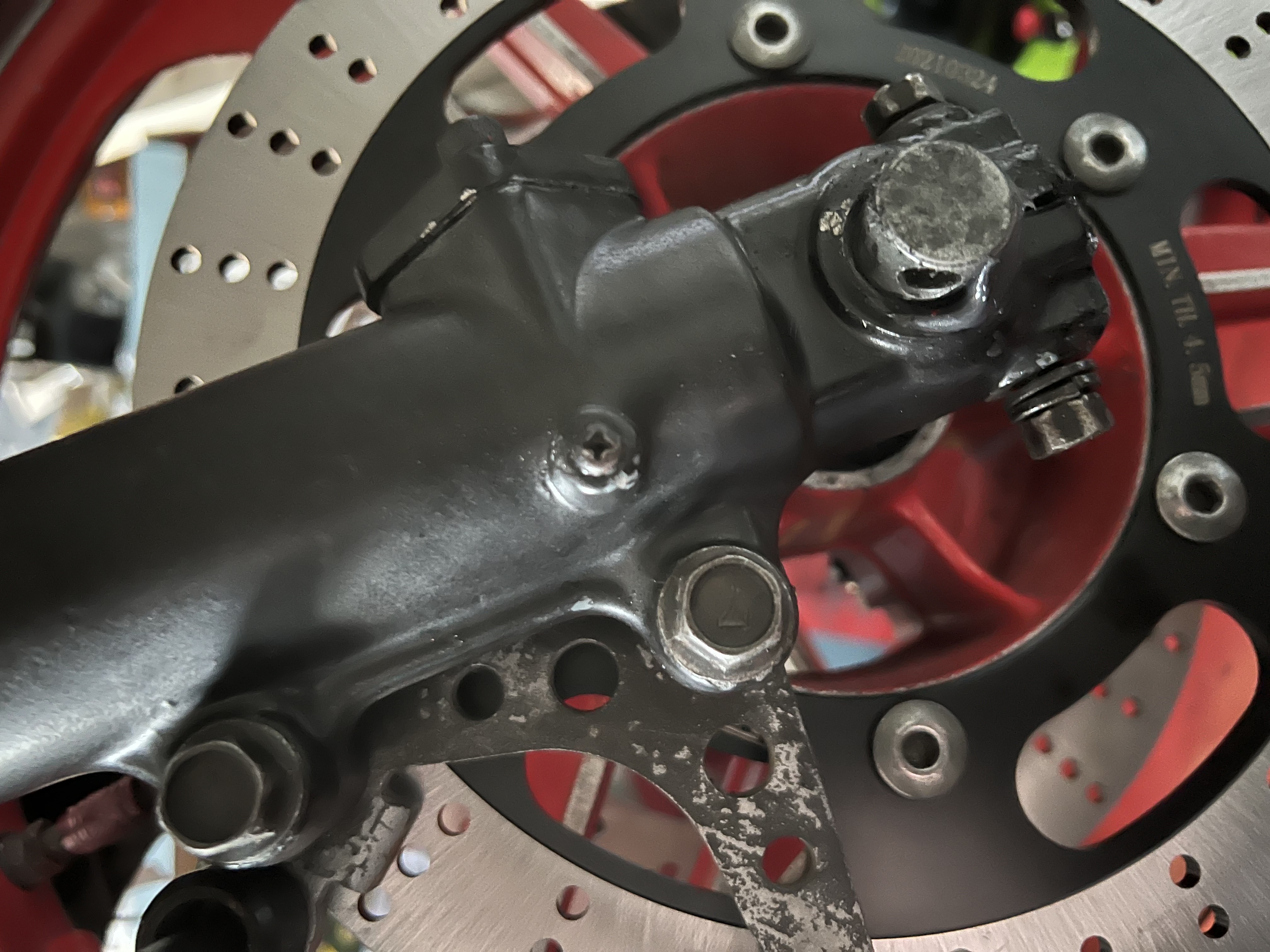

#4 PostAuthor: deka » Tue Feb 22, 2022 2:30 pm
Hi
Its the leading edge of the disc so not the part where the pads sit but the top see pic the black bit
scott

#5 PostAuthor: scott » Tue Feb 22, 2022 3:04 pm
Looks like the disc is 10mm bigger. I had a similar issue. Ended up getting discs made to suit.
Re: Gpz1100 caliper
#6 PostAuthor: Philippe » Tue Feb 22, 2022 4:27 pm
Hi Derek
according to CMS.NL the fork legs of a Gpz1100 and those of a Gpz750 are the same...
I think the problem may be that the disks you have are too big like scott replied.
I'll measure the diameter of the disks and the dimensions of the calipers on my Gpz1100 and I'll let you know.
There has to be an explanation and a solution for your problem!

gpz1100 a1/ a2 280mm front discs
gpz750 a1/ a2 270mm front discs
750 & 1100 brake calipers are identical & have the same part numbers

#11 PostAuthor: z1bman » Wed Feb 23, 2022 1:24 pm
gpz1100 a1/a2 & gpz750e1/e2 turbo use the same lower fork legs & front brake discs & brake calipers. gpz750a1 /a2 have different lower fork legs & smaller diameter brake discs but use the same calipers

#14 PostAuthor: deka » Thu Feb 24, 2022 1:31 pm
it look like i may have the bottom fork legs off a gpz750 and caliper brackets from a 1100 and the discs i think i may have some lower fork legs for the GPZ so will have a look at swapping one over and trying again that's if the internals are the same

#15 PostAuthor: z1bman » Thu Feb 24, 2022 7:46 pm
the GPZ1100 A1/A2 calipers are the same as GPZ550 A1/ a2 & GPZ750 A1/A2 & GPZ750 turbo E1/E1
