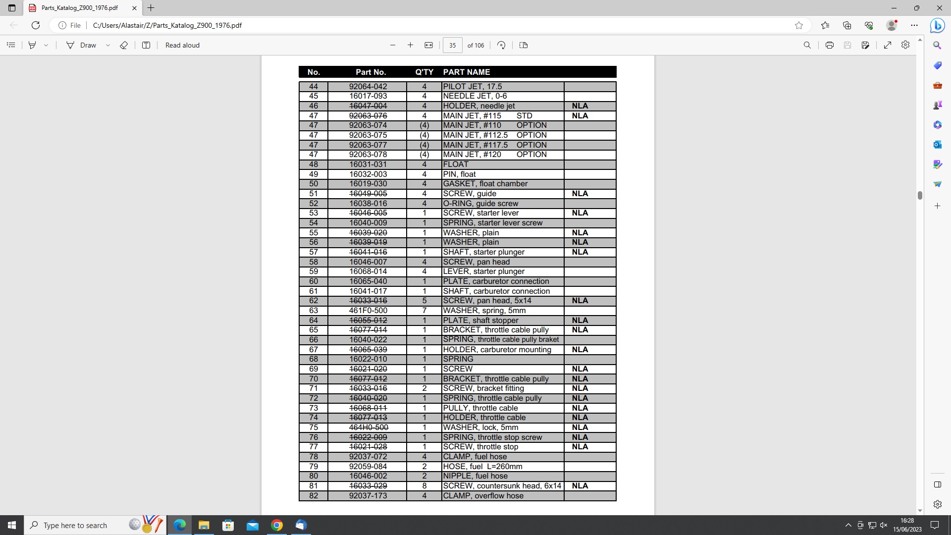

1. 113 instead of 115 main jet fitted. Strange that its rich with smaller mains? Pilots are correct though

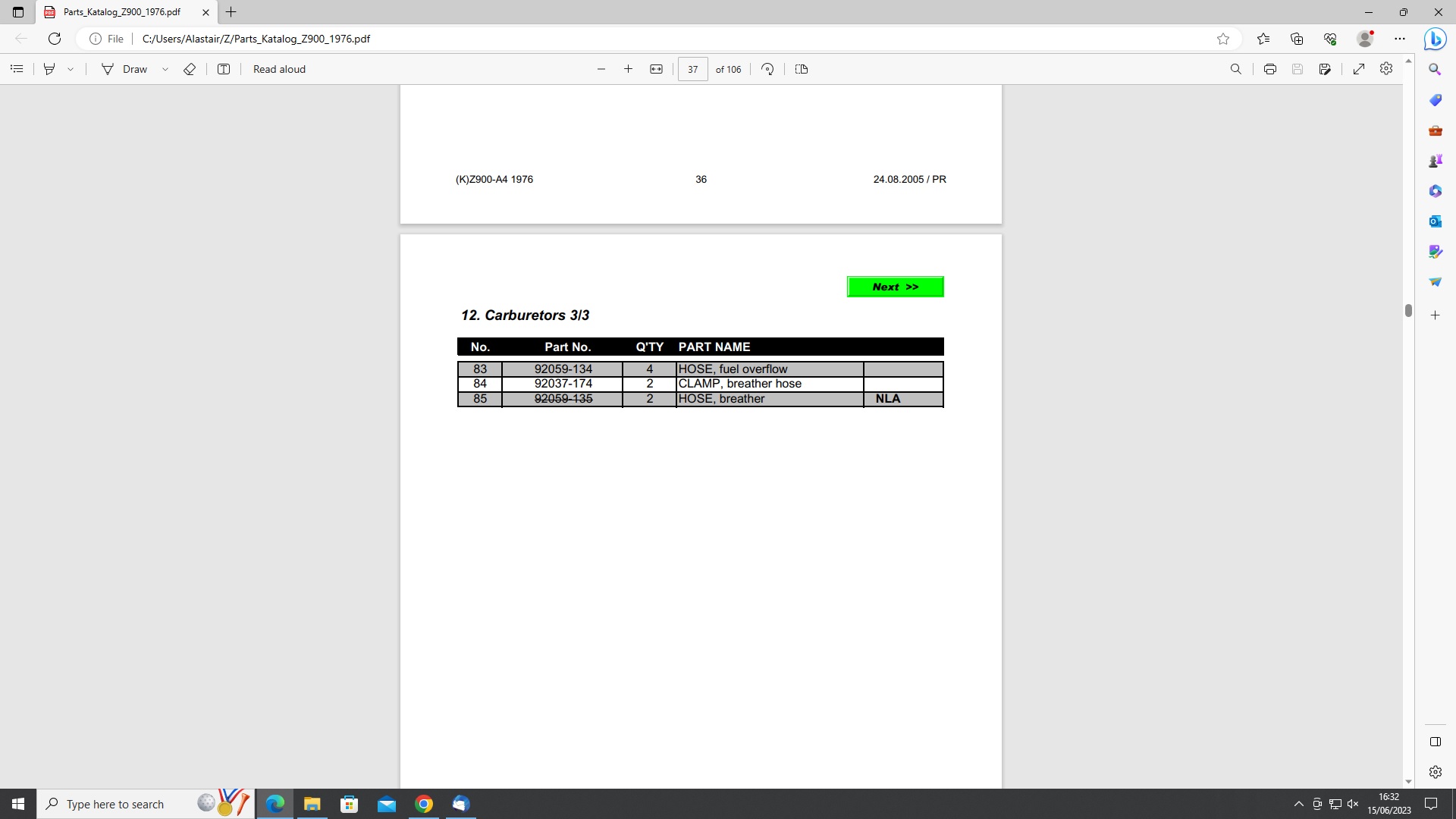

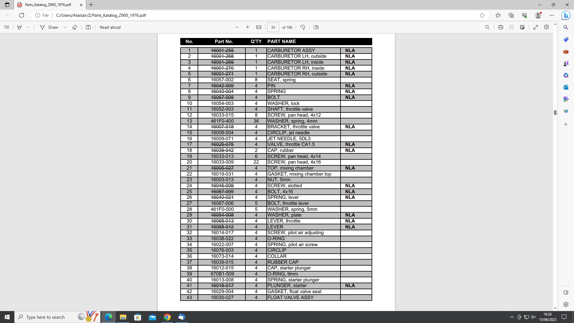

I believe that fuel height gauges (plug and tube) for some models are readily available (ZPower etc.)
Later https://www.z-power.co.uk/carb-float-height-tool
Early https://www.z-power.co.uk/carb-float-height-tool-z1z1a
