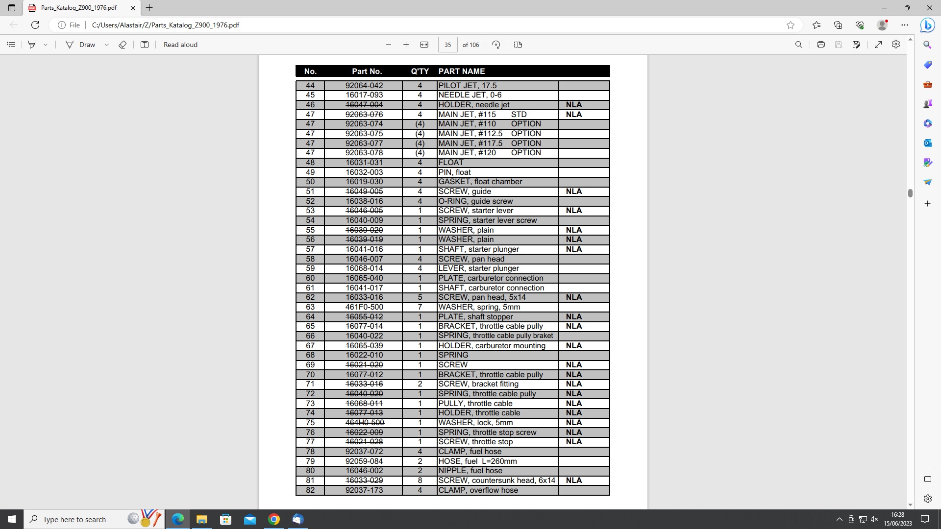

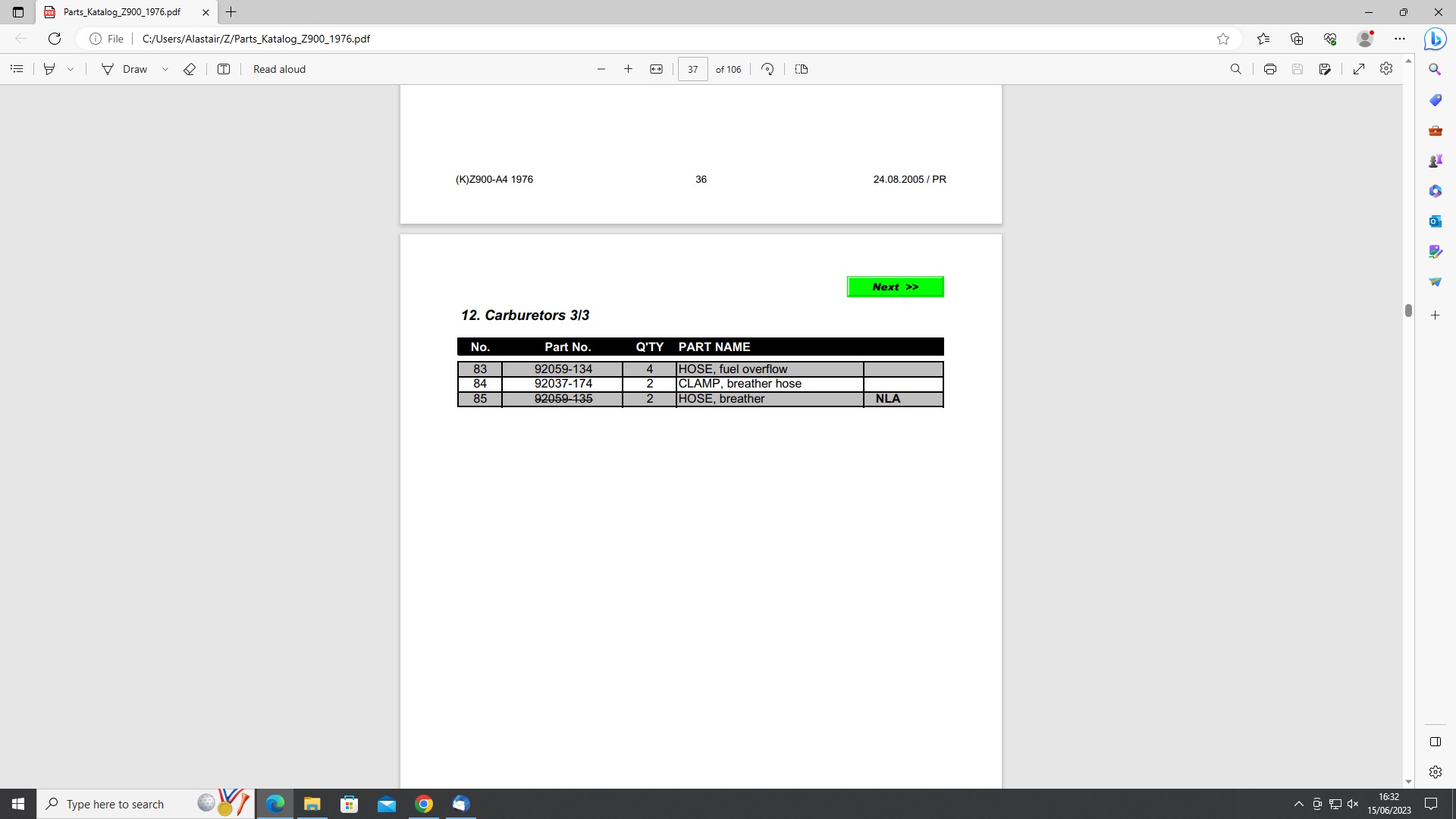

#5 PostAuthor: Al » Thu Jun 15, 2023 3:35 pm
From the Kawasaki parts catalogue
