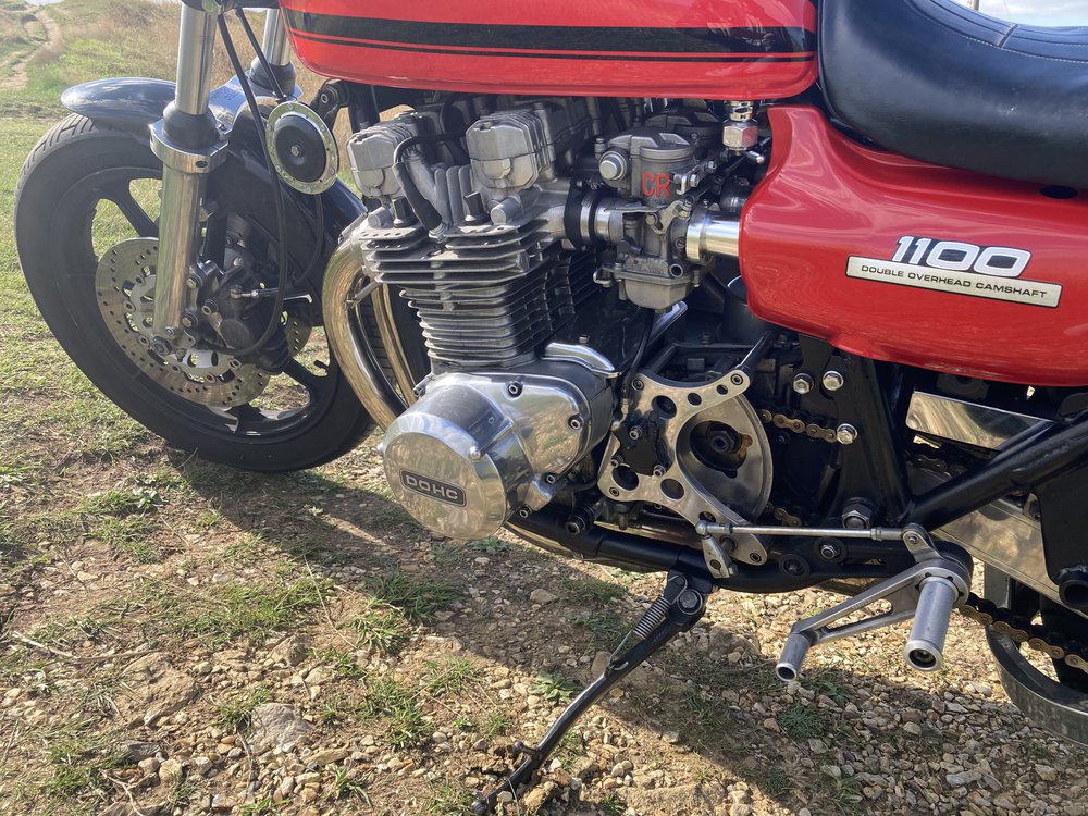

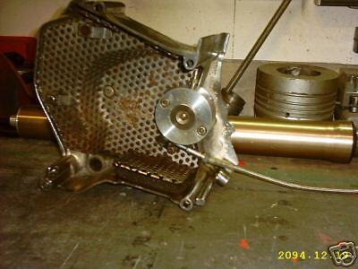

I've done loads using ZXR type slave cylinders on outrigger plates etc but if you want an invisible conversion then there a chap called Falk Stumm in Germany who makes one that fits out of sight in the stock sprocket cover.

Like Zed said there i used an out riggger plate and a gsf1200 slave as i had one on my Bandit 12 i bought a Nissin master from Webike. Getting the distance in spacing and the length of the push rod right was a chore but works a charm now.

ZX12-R slave and master cylinder on home made cover plate.

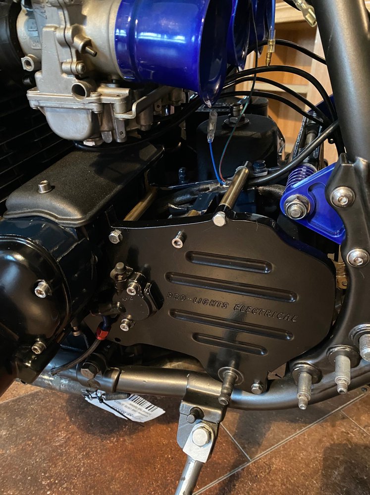

Z1streetfighter71 wrote:Like Zed said there i used an out riggger plate and a gsf1200 slave as i had one on my Bandit 12 i bought a Nissin master from Webike. Getting the distance in spacing and the length of the push rod right was a chore but works a charm now.IMG_2718.jpg
I have a very similar Plate made by Spectra Engineering but using an Oberon Slave Cylinder
