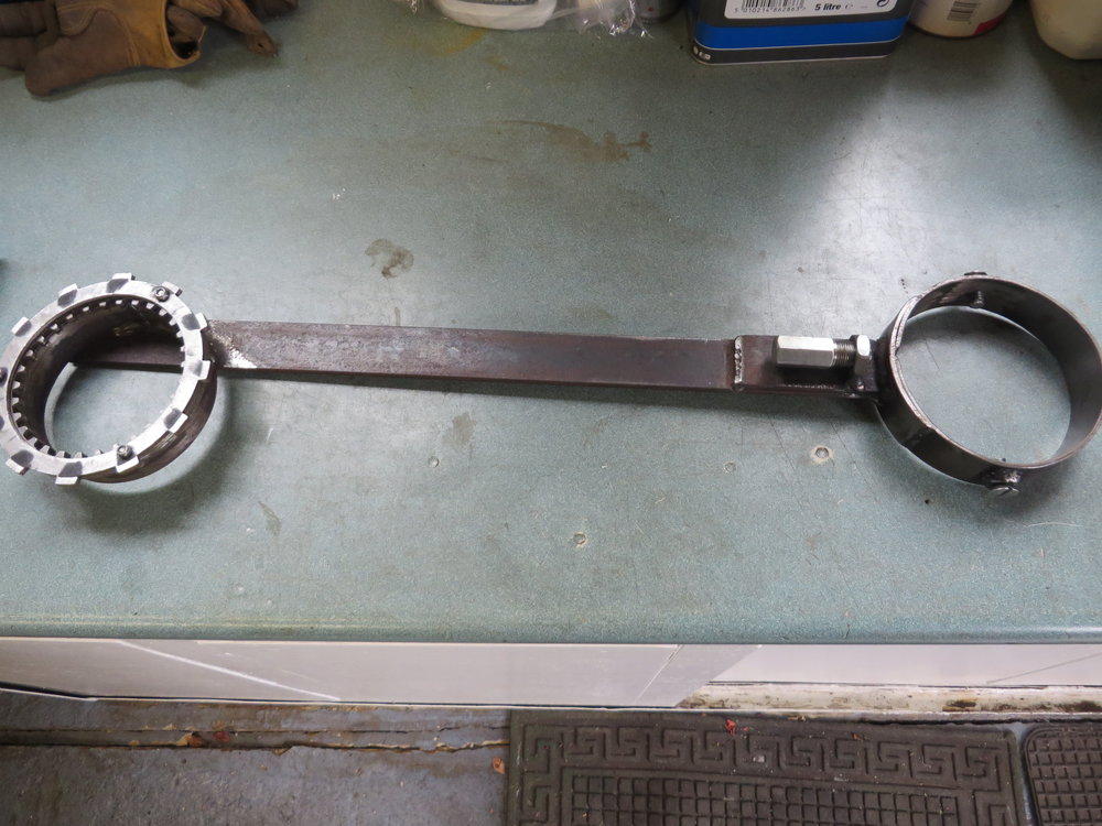

Here is an alternative to the factory rotor holder tool if you have access to workshop facilities etc.
Again, if you do 'make' something it needs to have the correct depth to the 'pins' or they will dislodge the magnets!!!!!!

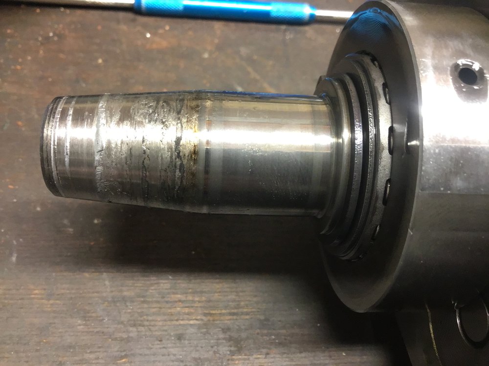

Got the flywheel off I actually think the acetone worked but i did use a borrowed milliwaki impact gun but i did come off easily,thats the good news the bad news is the taper is scrap

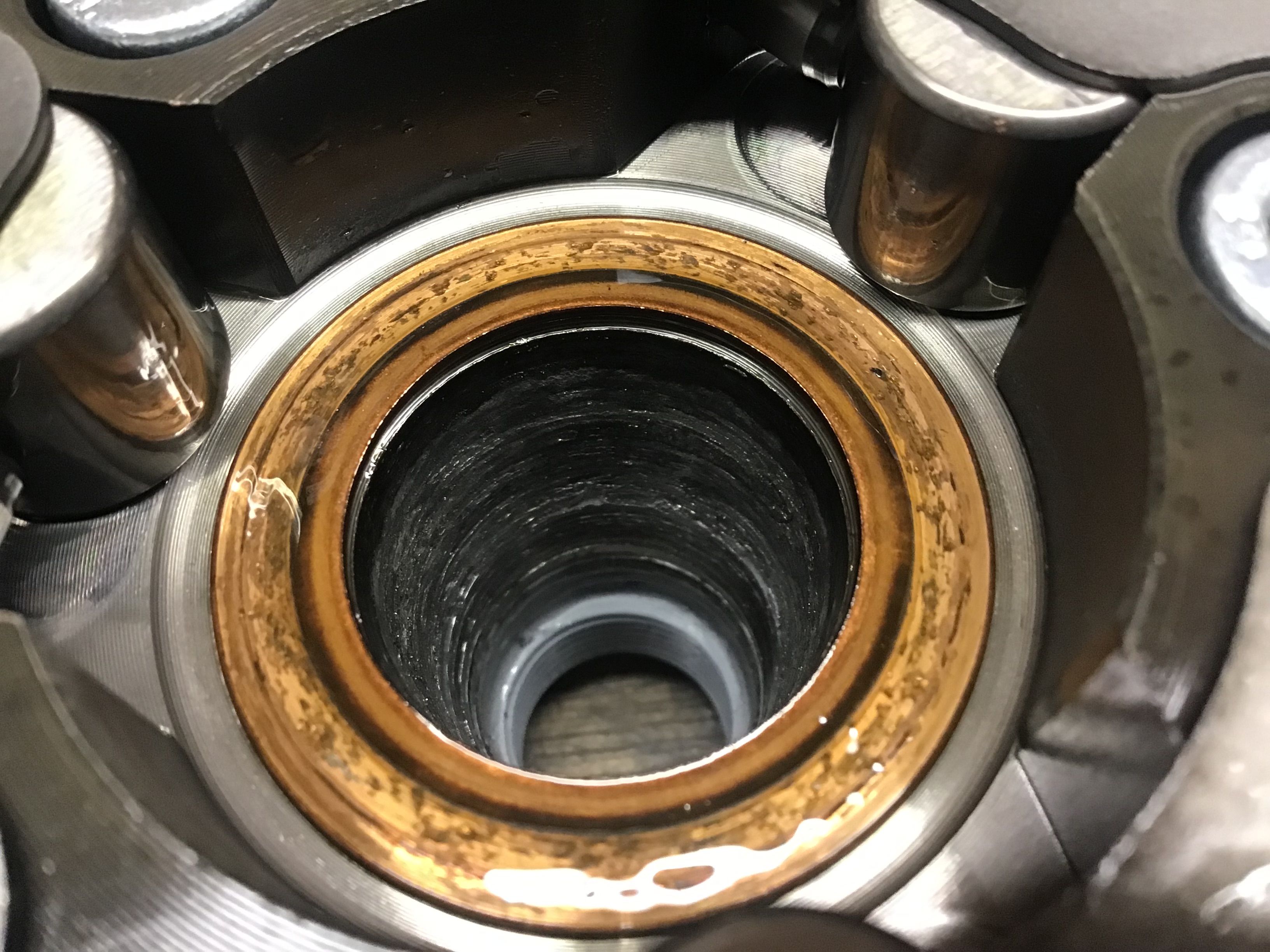

I have been told (so not me then) that at 116 ft/lbs you cant achieve taper lock and it just splits the rotor core along the key way.

I need to find one mine is beyond lapping in, is there any aftermarket generator kit ? The crank is going to grumpy 1260 for refurb so that should sort that taper

That crank taper looks pretty good really. I wouldnt be surpried if it cleaned up by lapping on another std rotor without any machining.
