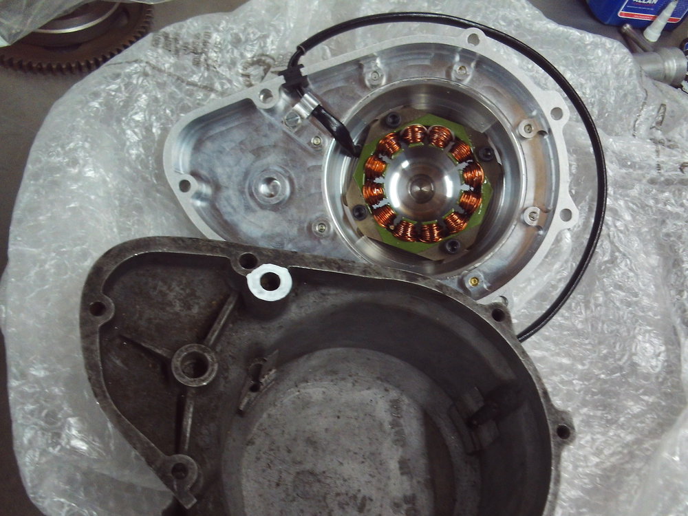

I recently bought the same kit from Electrex knowing of the faults and expecting no changes to the flawed design.
I wasn't disappointed :roll:
They haven't changed a thing which is a bit gobsmacking considering they know full well of the design fault.
Still no block off for the main gallery as can be seen in the pic but as said, i was prepared for that and will make a bung..

He's used the exact same Electrex race alt and fitted it without spotting the faults.
If you are on that forum you should tell him not to run it until the open end of the main oil gallery is plugged otherwise he will destroy the head through lack of oil.
If you've seen my latest build thread you will see the faults that need rectifying..
