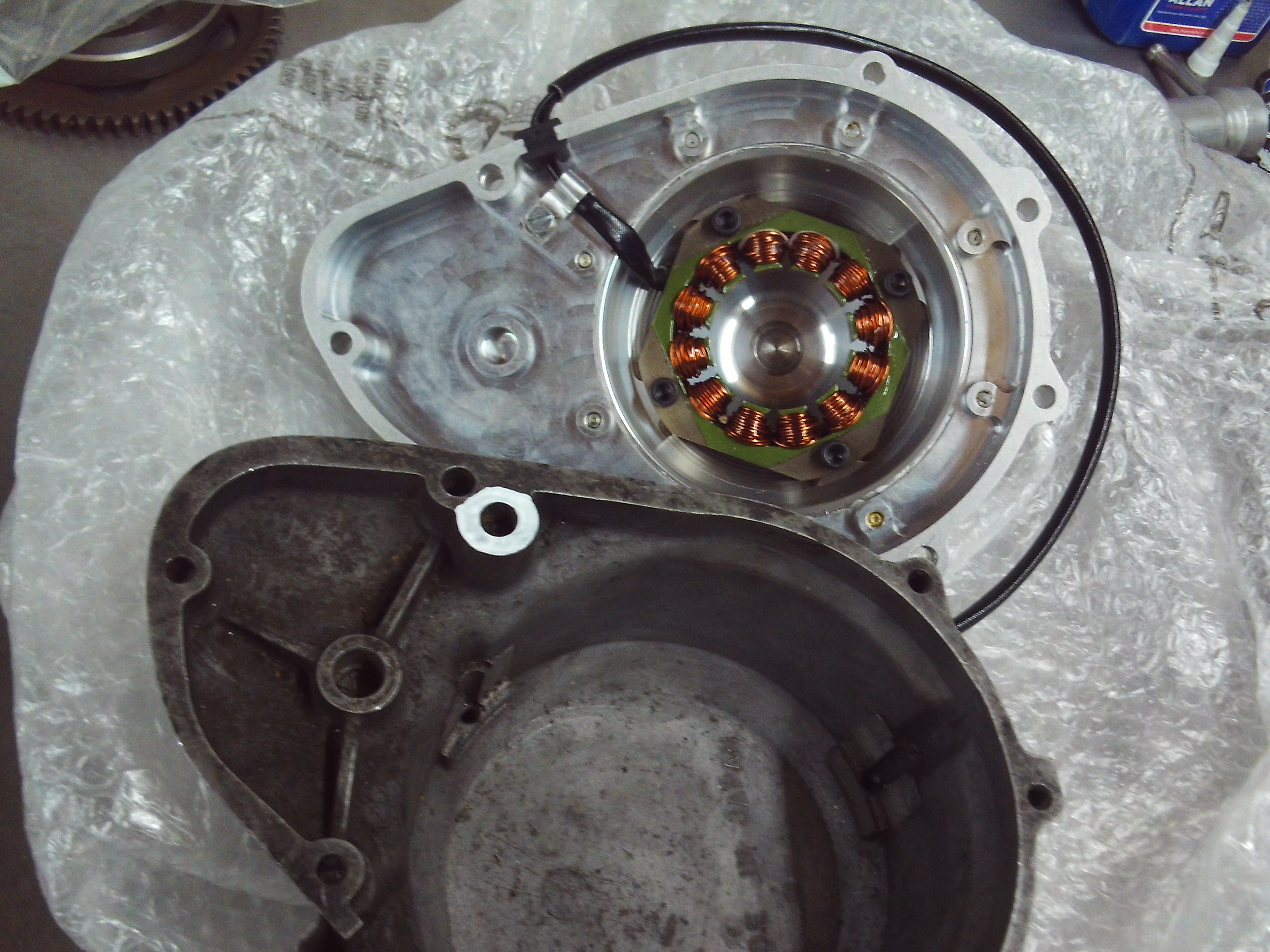

I recently bought the same kit from Electrex knowing of the faults and expecting no changes to the flawed design.
I wasn't disappointed :roll:
They haven't changed a thing which is a bit gobsmacking considering they know full well of the design fault.
Still no block off for the main gallery as can be seen in the pic but as said, i was prepared for that and will make a bung..

Nobody does a similar off the shelf kit with starter motor function so unfortunatly the Electrex offering is the only choice.
I only buy them because the cost of the component parts and making my own backplate etc is uneconomical compared to just correcting the faults.
It's no big deal really once you know about the oil gallery and it's likely that all electrex would do is include a bung with the kit ( which probably wouldn't fit ) if they could be bothered to address the issue.
