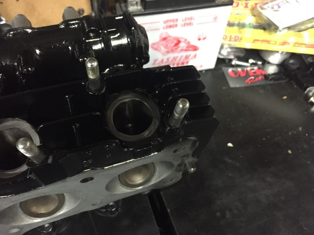

Some goodies arrived today. Most important is the repairs head with all 8 studs now intact :)
I ended up sending it back to Debben's and Ray fixed it for free, got a cracking deal on the new gaskets etc and around 2 weeks from leaving France to being back in my garage. Can't ask for more than that..

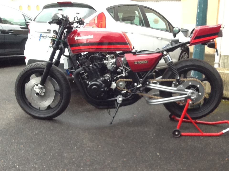

Hoorah! So finally I have got back to where I was a couple of months ago... It's alive and Ticking!! The ticking noise was there last time I fired it up and I thought it was leaky header, but still there... Any ideas??

Getting there.. Just completed second run in session as per Rays advice, still ticking loudly from the left side which needs further investigation!

#162 PostAuthor: Coose » Fri Apr 21, 2017 6:42 am
That look grand Lee - is it staying red?
As well as the random cam knocking (new shells will be fitted at some point) mine has an intermittent tick too. I haven't yet pinned down from exactly where or what is causing it, but it only seems to happen when the motor is neither cold nor up to temp. Did you run yours until it was warm?

#163 PostAuthor: LeeJackson » Fri Apr 21, 2017 7:41 am
Hi Coose,
Yeah it was fully warmed up, I'm swaying towards it being electrical as Al had suspected but not had time to look at it this week as I've been on the road, next weekend will have time for a proper investigation.
On the Colours I have not finally decided. Originally I was going to go Lawson colours, but now the red is growing on me a lot and tempted to keep the standard colour scheme. I'm putting a bikini fairing on it but maybe that will look nice enough in original colours. Need to make my mind up soon as will have to get the bodywork dropped off for paint. Just waiting on fairing mountings and mudguard to arrive to test for everything first.
