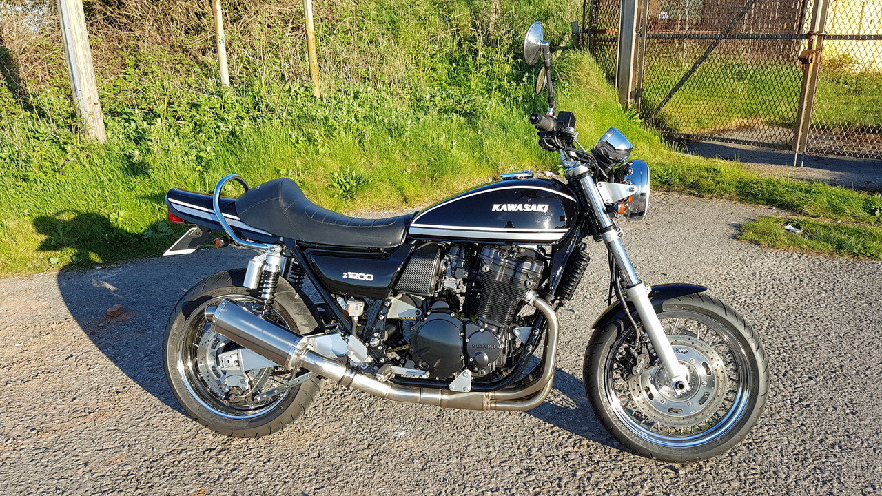

I think the second Zed I built was the best but like an idiot I sold it :roll:
this one.

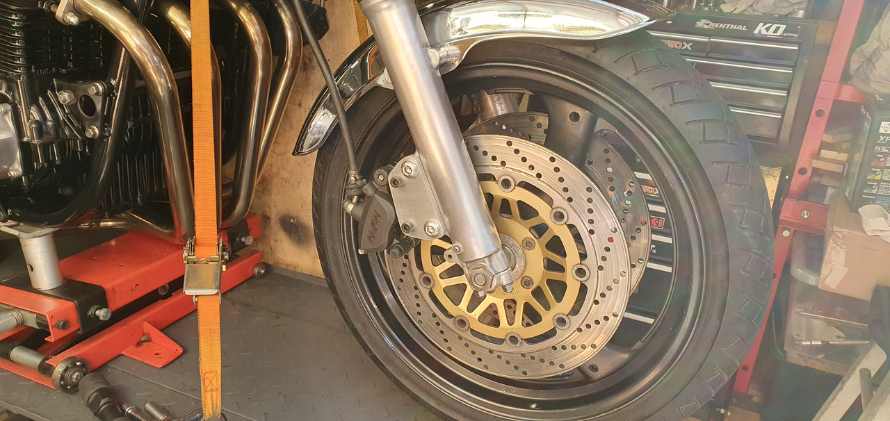

wheel finally turned up (fecking Evri) B12 disc's fitted and cardboard template made for calliper mounts, just waiting for some 10mm ally plate. still need to sort out some sort of speedo drive !!!! will try and reduce a B6 one down enough to fit ?? then its practically done. happy with the look so far. :)

one calliper mount bracket made, just need to copy it for the other side, job for tomorrow. also modified the B6 speedo drive to fit, so pretty much done.

on its new wheels :) happy with it, just needs a road test but its still very wet and salty where I am :( looks much better :wink:

give it a little run round the block, everything seems ok, but one BIG difference is the front brakes, the pads are not bedded into the disc's yet but they work soooooo well :D 2 finger braking, and they'll only get better :mrgreen:
