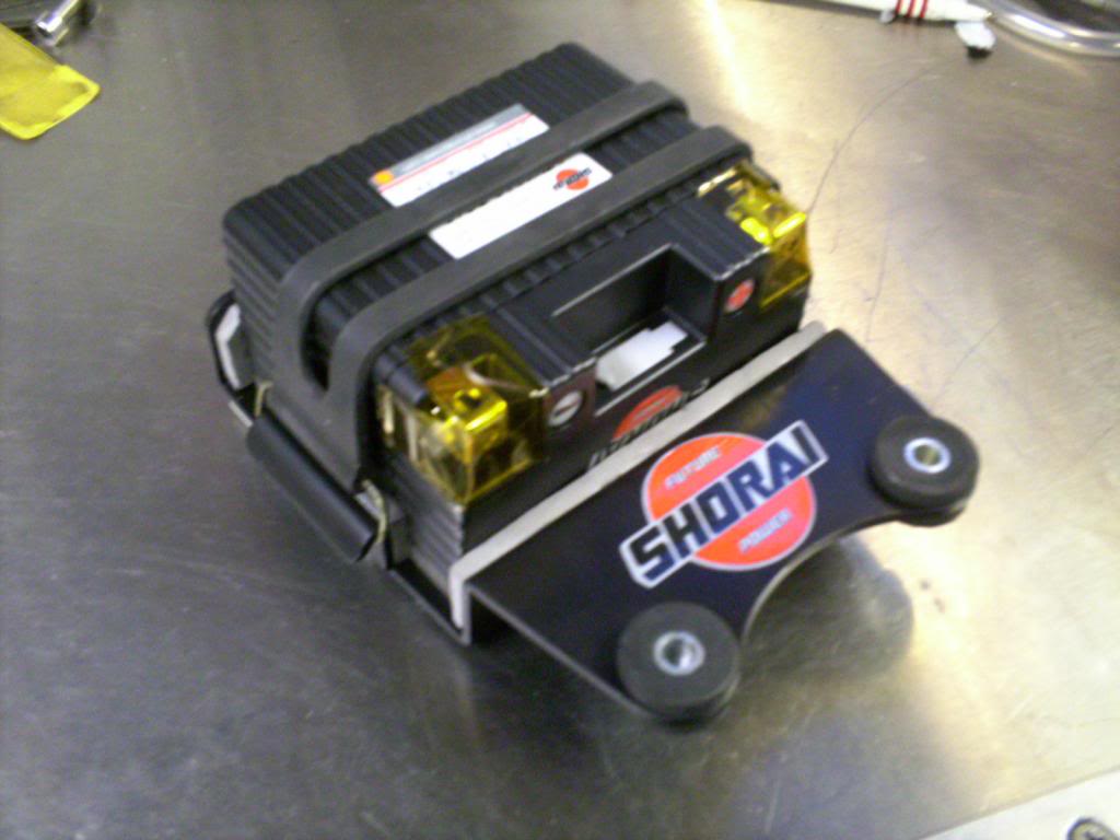

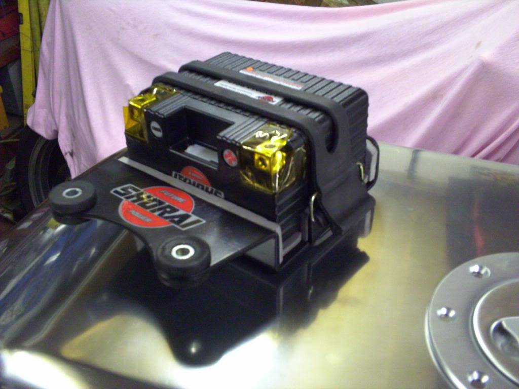

Pigford wrote:Why does the ALT need an 8 amp battery :?: Me no comprendy :??
Well! I asked Peter at Electrex if there was a minimum limit on the size of battery I could run with the race alt as i wanted the smallest i could get away with to cover the demands of the Dyna and brake light and he said he wouldn't use anything less that 8 amp. Simples.
Maybe there's a risk of frying anything smaller with the alternator/regulator combo he supplies i don't know.

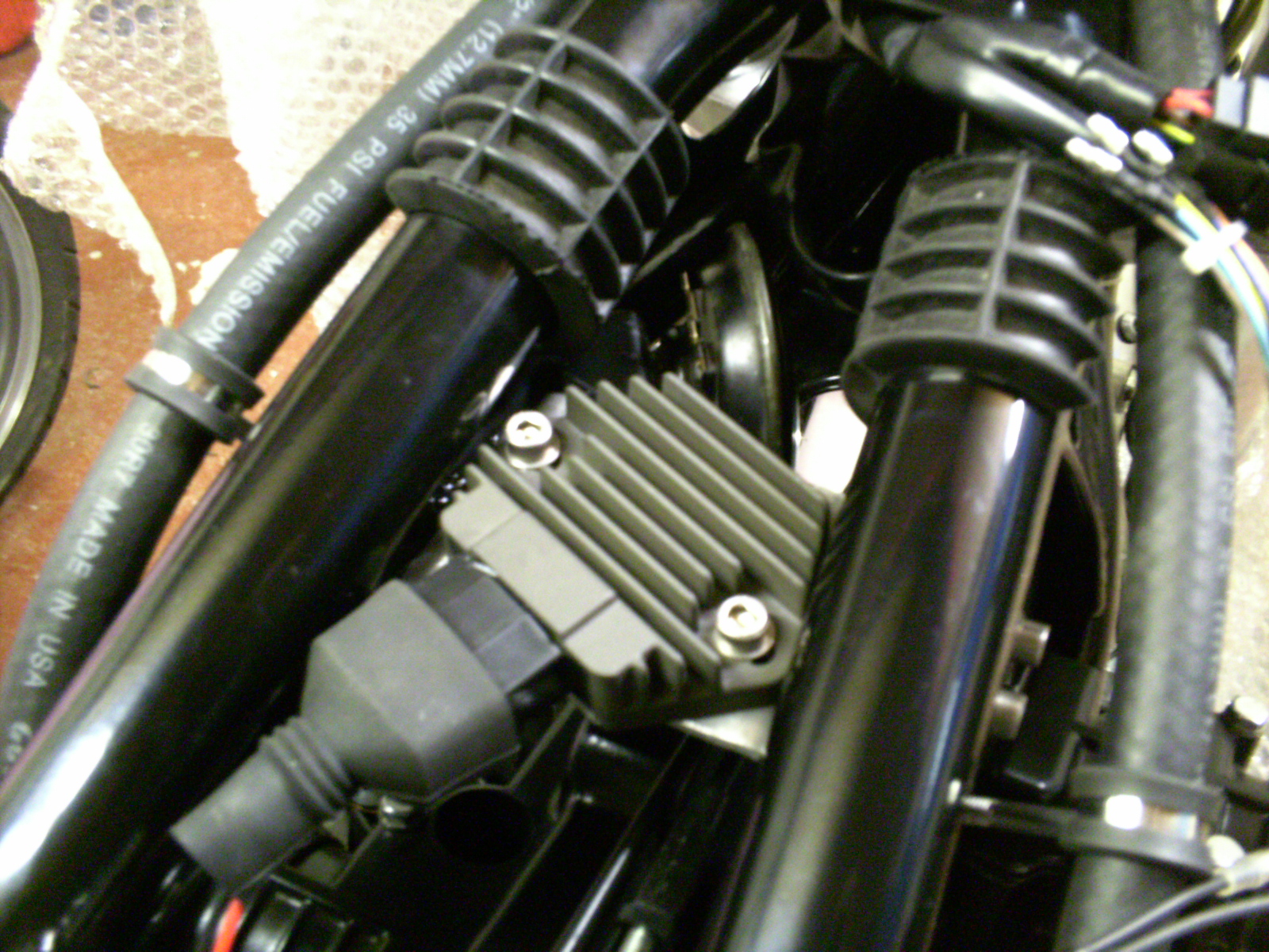

Posts: 4040

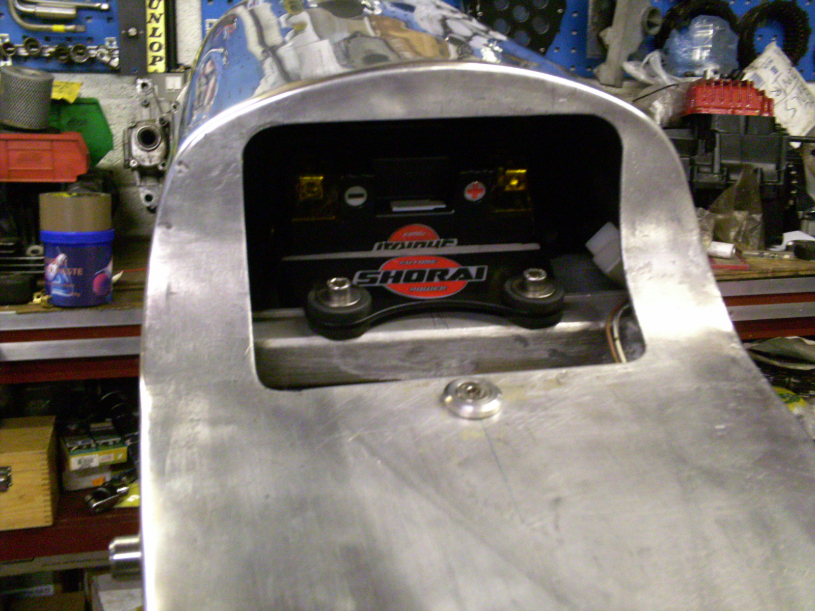

#319 PostAuthor: zed1015 » Fri Jan 17, 2014 7:58 pm
Battery tray made .
And fitted
Plus the reg/rec and horn now takes the place of the CDI's under the tank.

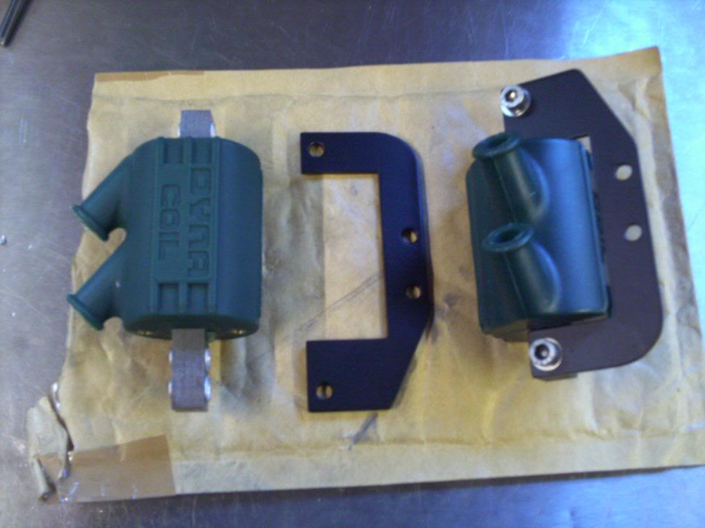

[b]Just need to make mounts for the Dyna coils and I can start on the wiring.

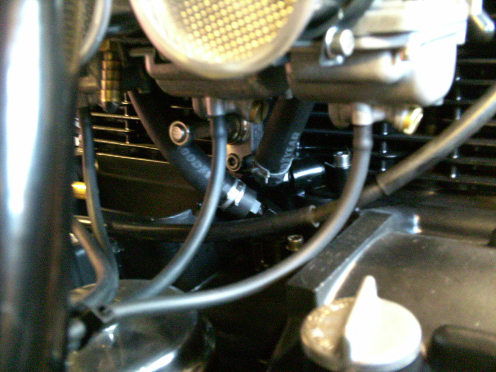

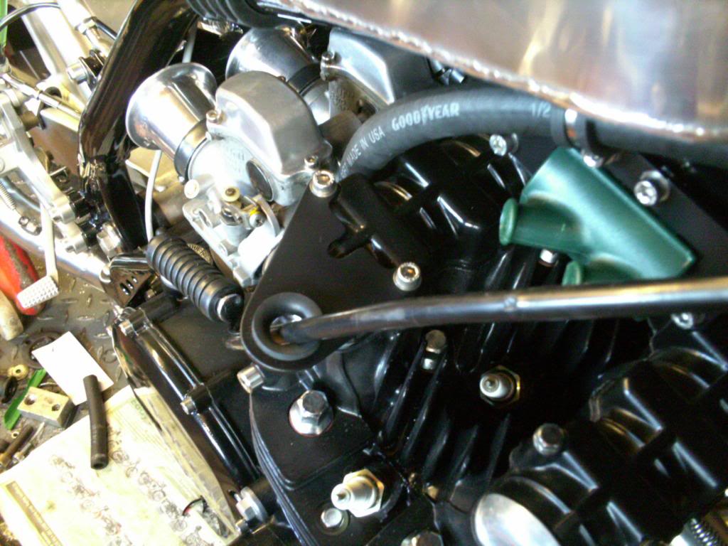

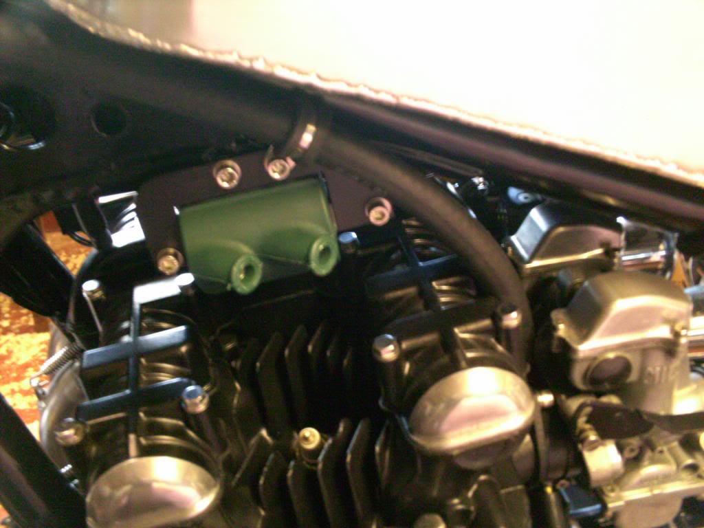

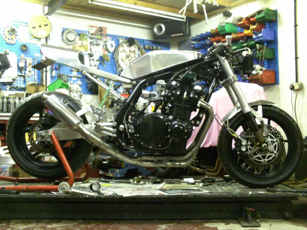

#323 PostAuthor: zed1015 » Sun Jan 19, 2014 5:17 pm
Busy day today
Mounts for Dyna coils done
And fitted

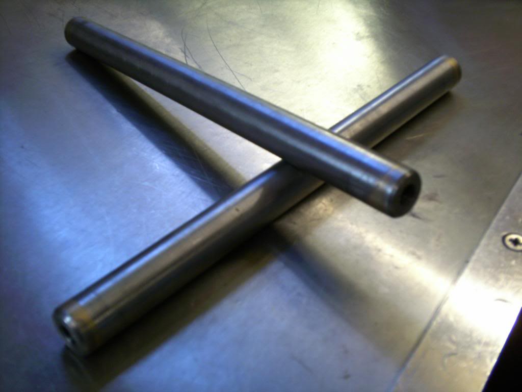

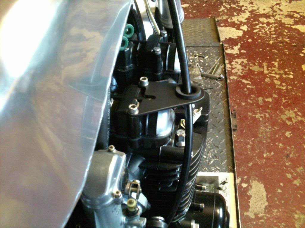

Made a guide for the clutch cable to stop it flopping about and rubbing on the head

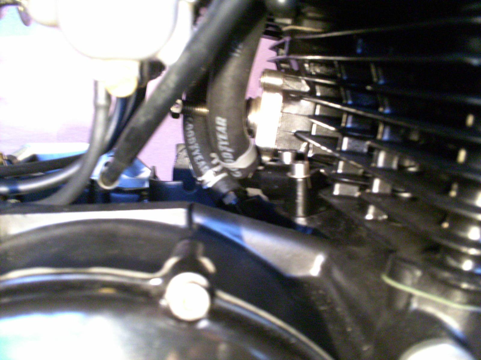

Re-jigged the oil cooler fittings so that the oil pipes now route between the inlet rubbers and the carbs can easily be removed without disturbing them.
As a bonus I also lost about a foot of hose length in the process so the oil will circulate quicker

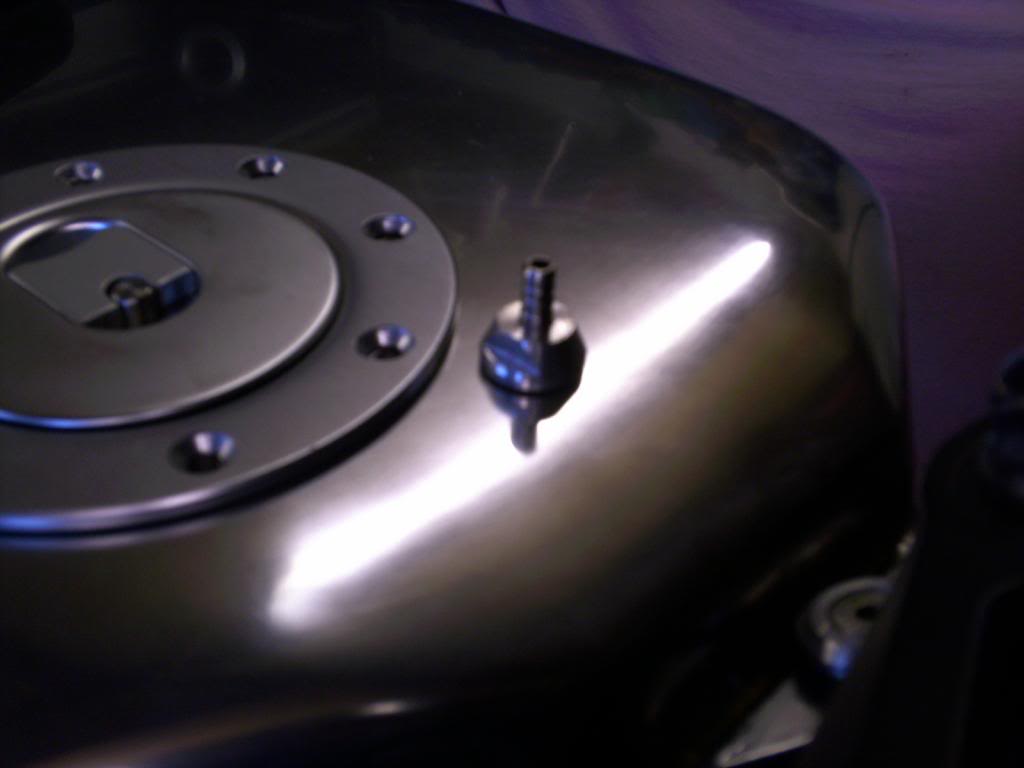

And then made a fitting for the tank breather hose
Also re-done the subframe struts in steel tube with brazed in threaded ends as I've gone off the ally ones I made.
The steel ones are as strong but lighter and are going to be powder coated black along with the subframe to blend in with the main loop and give some contrast against the alloy seat etc.

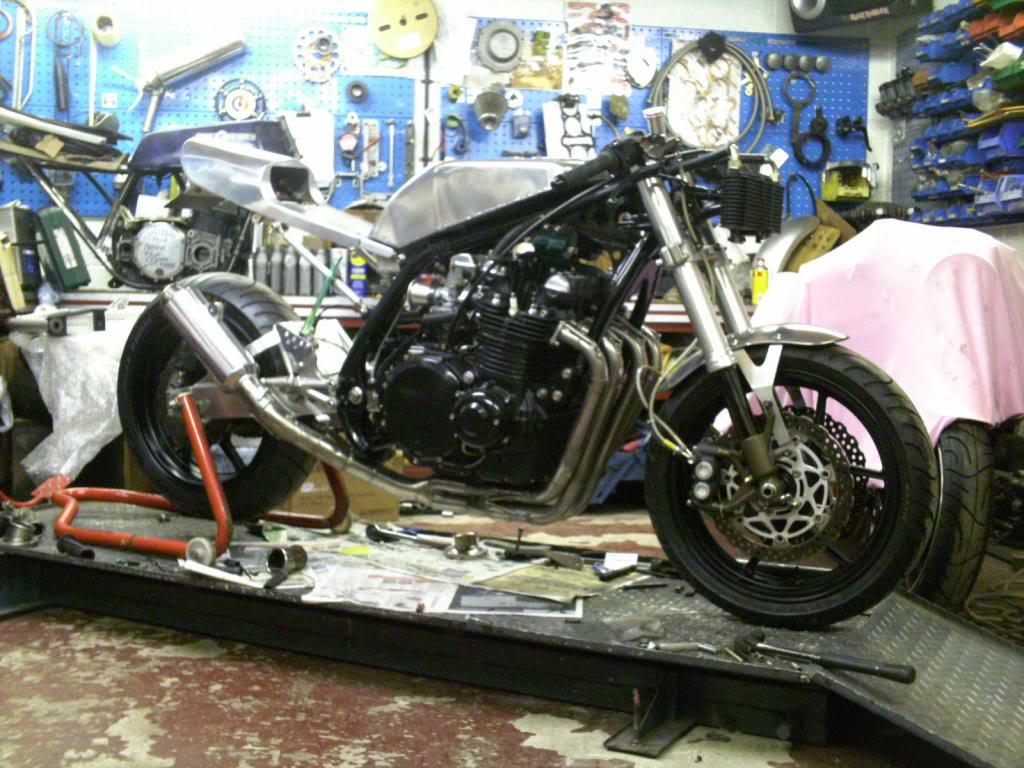

As it stands so far.

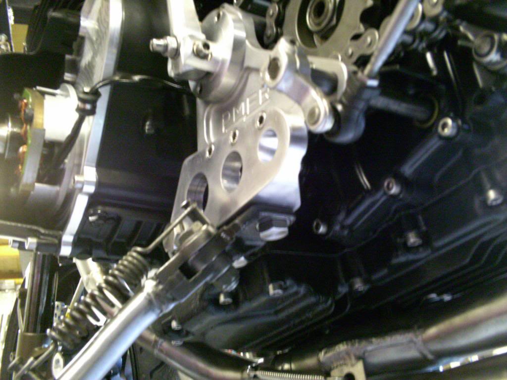

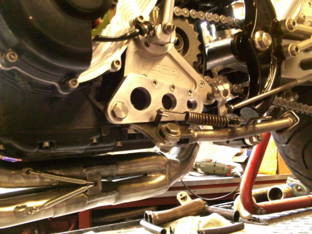

#325 PostAuthor: zed1015 » Sat Jan 25, 2014 1:08 pm

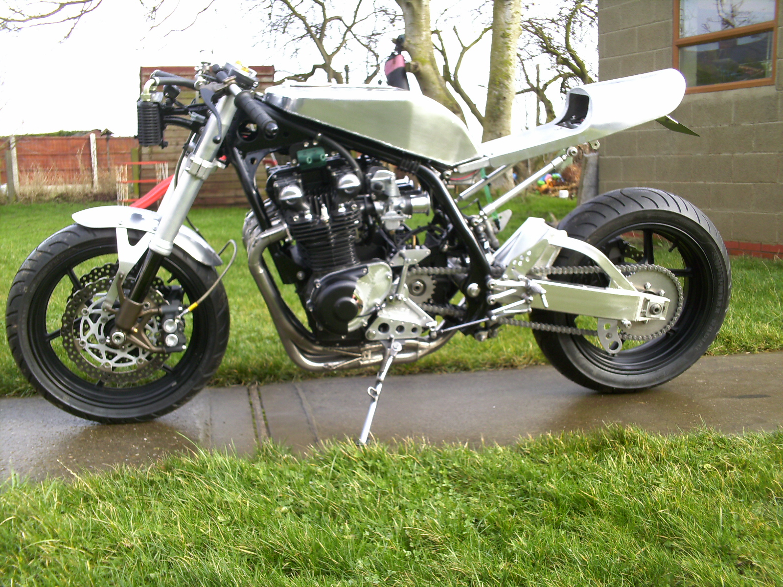

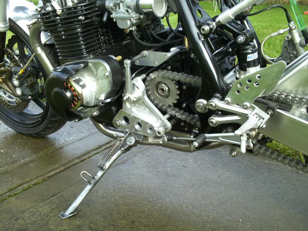

Finally figured out a mount for a side stand.
1/2" section alloy angle whittled into an appropriate shape.
Bolted to the lower engine mount and tied in to the sprocket cover.
Mixture of bent (Oop's! I mean adjusted angle :D ) and modified Buell XB and SRAD side stands with a Zed spring bolts to the underneath.
Not much to do now :D

#326 PostAuthor: andyb1962 » Sat Jan 25, 2014 1:16 pm
Some fantastic innovative skills on display there
Top job :up

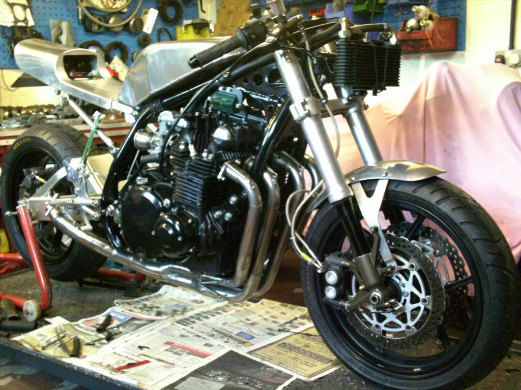

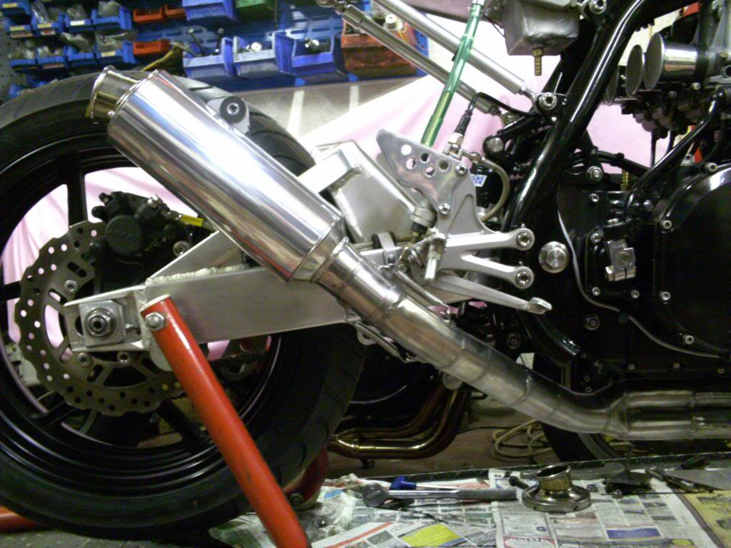

#327 PostAuthor: zed1015 » Sat Jan 25, 2014 9:02 pm
Some things just HAVE to be done and after weeks trying to ignore the fact that the end can I made for the Drouin looked to be perfect for the Café I finally gave in and did the deed.
After a couple of hours with the saw,grinder and welder the transplant was complete.
I think I made the right decision and the Drouin is getting a fatter link pipe and Devil can in compensation.
