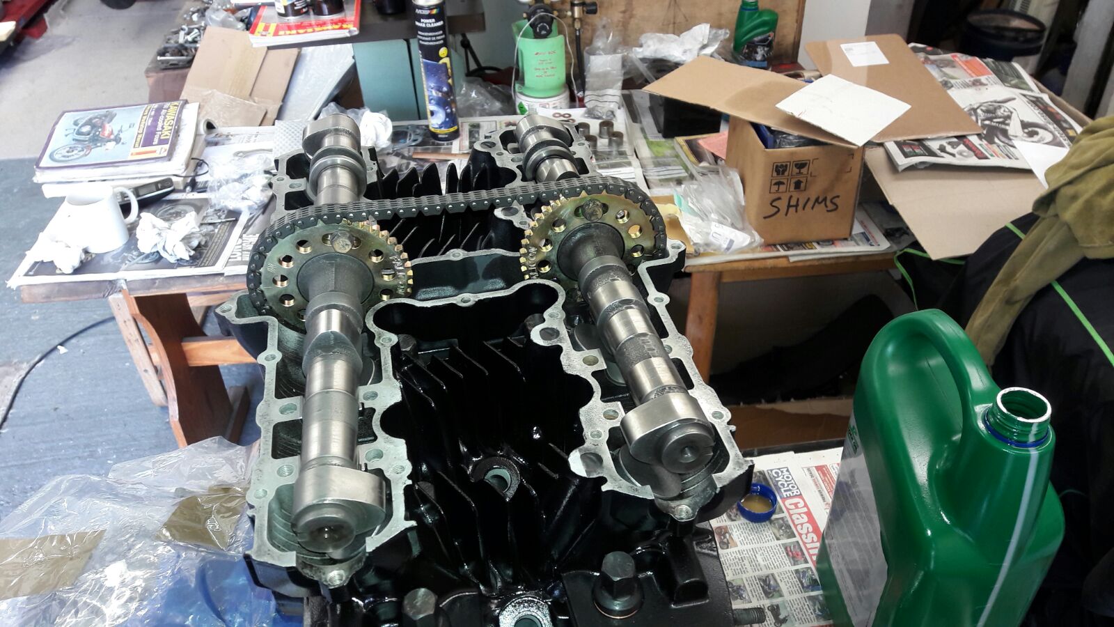

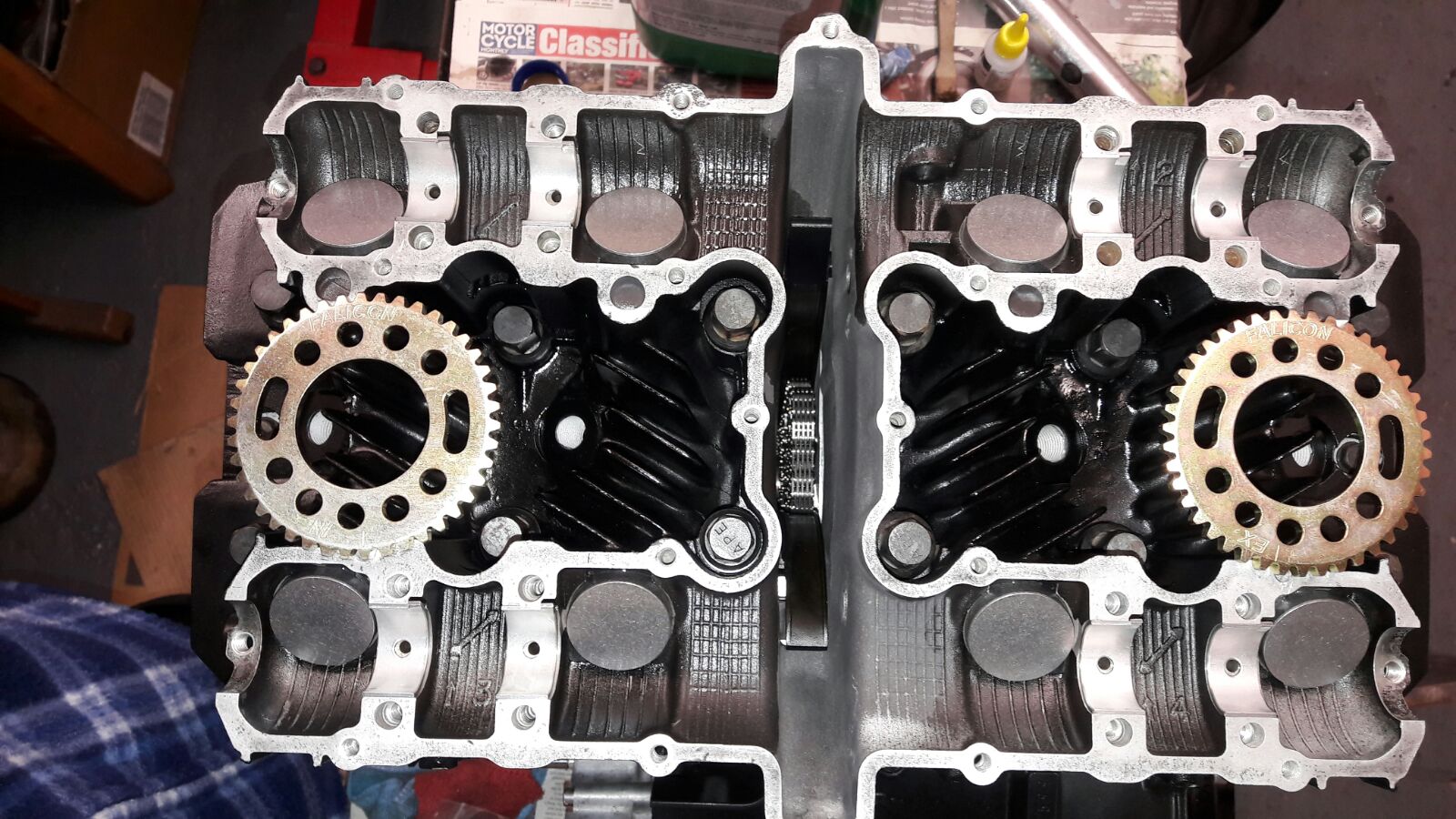

#98 PostAuthor: swampy » Thu Mar 02, 2017 10:12 am
ok quick up date head has had new seats cut, vale guides installed and had ports matched/stage 1 flowed all done by Roger Upperton. new valves, springs, followers fitted along with slotted sprockets new cam shells and the cleaned up and deburred cam. head bolted on with hd studs and nuts
