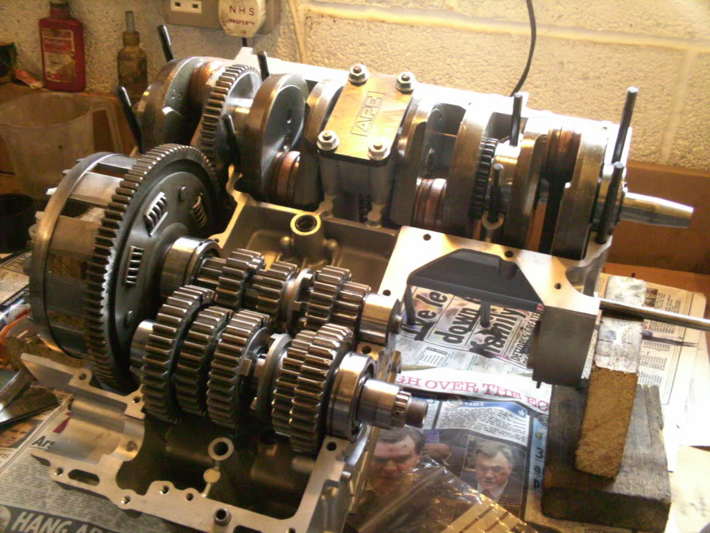

Main bearing cap has been machined for the support plate so the bottom end can be finally rebuilt.

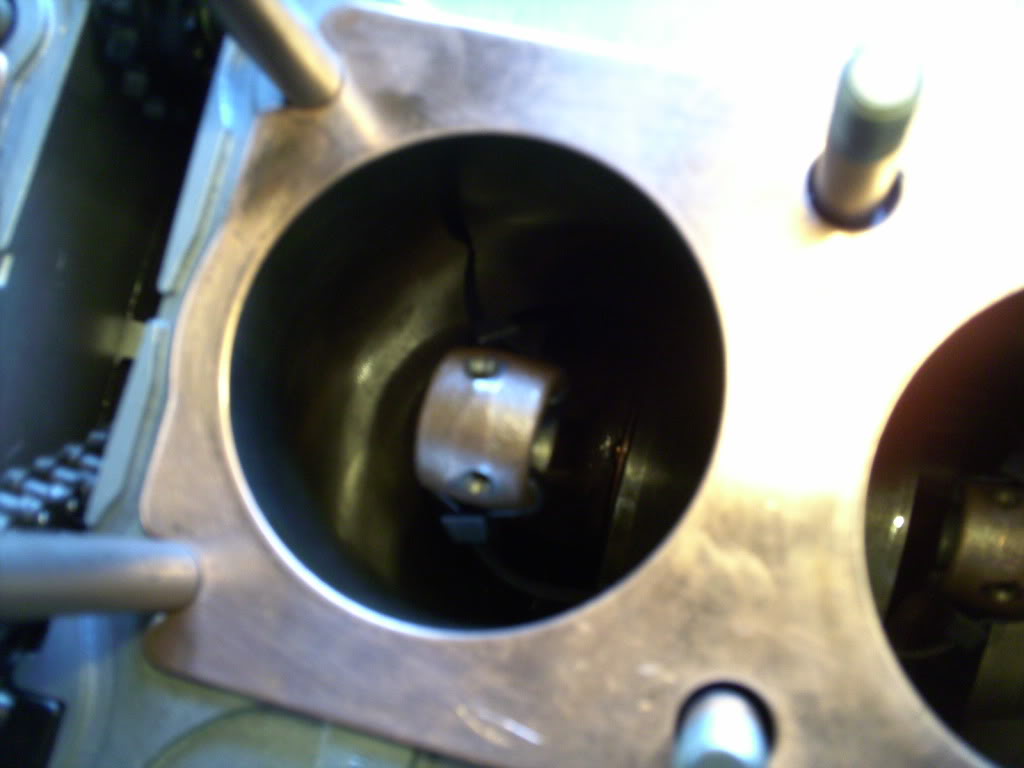

Barrels bored to take the 72mm MTC turbo pistons, rings have been gapped and fitted to all except no-4 piston which will be used for deck height and valve clearance checking on the dry built top end.
Liner tops have been piano wired and i've 'O'ringed the outer stud holes to help reduce oil seepage from the copper head gasket.
The holes for the rear outer studs on the original cast barrels tend to taper towards the center from each end and can become restrictive for the top end oil supply when fitting the larger hd studs so these have been bored out to a constant diameter throughout their length.
A couple of zip ties on each little end stops the 3 loose rods running on their bores

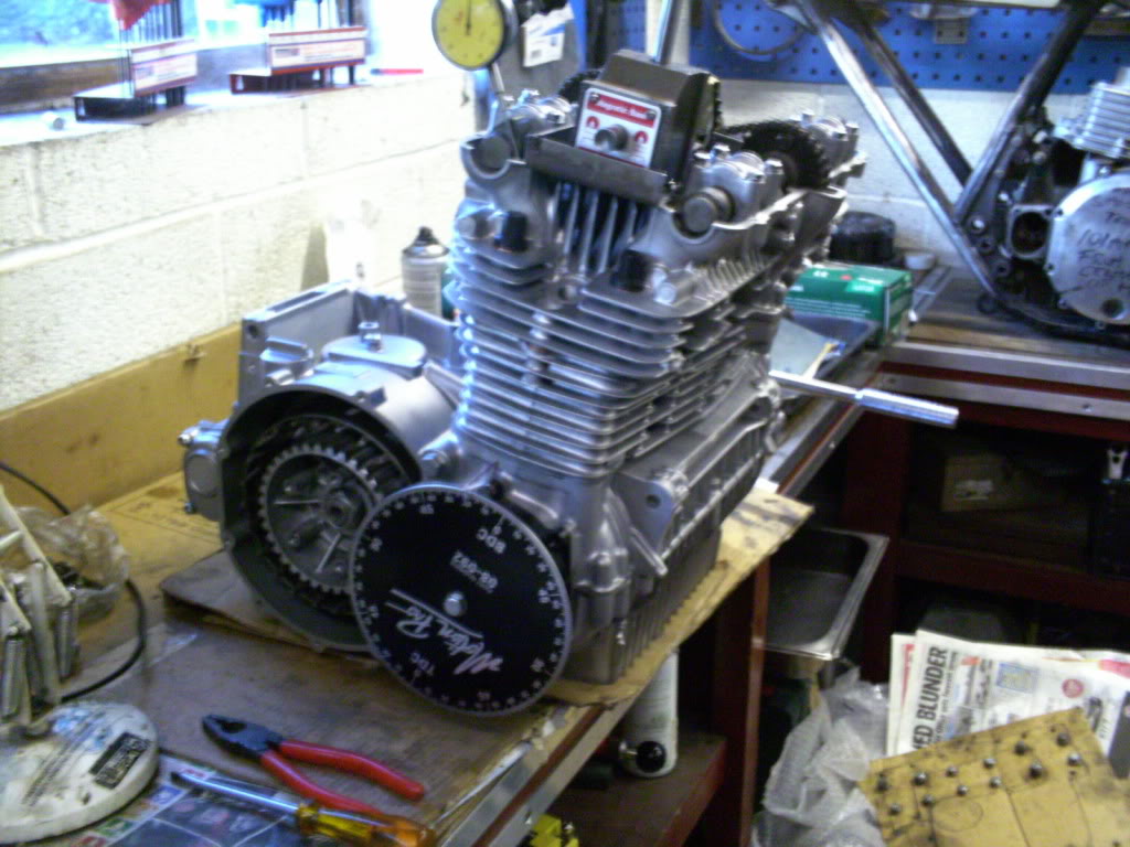

Then test assemble the top end and degree in the cams
Haven't got any timing figures for these cams as there's no id on them so will have to settle on something like 109 in /113 ex lobe centers which is in the usual turbo setting range.
This will have to do for checking valve to valve clearance and squish (the valve to valve clearance will change with the cam timing so i'm going to have to check it at different LC's to see what the safe range is.
A piece of soft solder squashed beween the valve heads on overlap and measured with the vernier will tell how close things are.

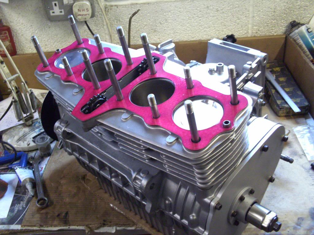

With all the clearances sorted out it's time to put the top end on permanently.
Camchain 'O' ring filled with rtv, sliced flush with the cylinder top and outer oil stud 'O'rings installed ready for head gasket.
Hd cylinder studs are plain unplated steel (pre APE) so the 8 exposed ones get the heatshrink trick
Copper headgasket gets a coat of spray-on sealer both sides and goes on after fitting the Liska idlers and tensioner.
Holes in headgasket were to small to go over the heatshrink so that was trimmed flush with the barrel face too.
A not so short while later the head is on courtesy of some APE nuts and copper washers throughout.
Cams run in new bearings with Liska top idler and APE billet mounting blocks completing the ensemble.
After some research i've identified the cams as Megacycle race turbo cams and found the timing figures to suit.
110 degrees inlet and 114 exhaust which make me very happy as my 109/113 guess couldn't have been any closer :D
Nearly done. just waiting for the cam cover , a few nuts and bolts and an oilseal to finish it off.

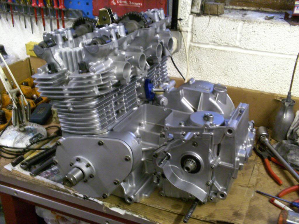

Next pic's should see it finished and then on to the turbo and carb,
