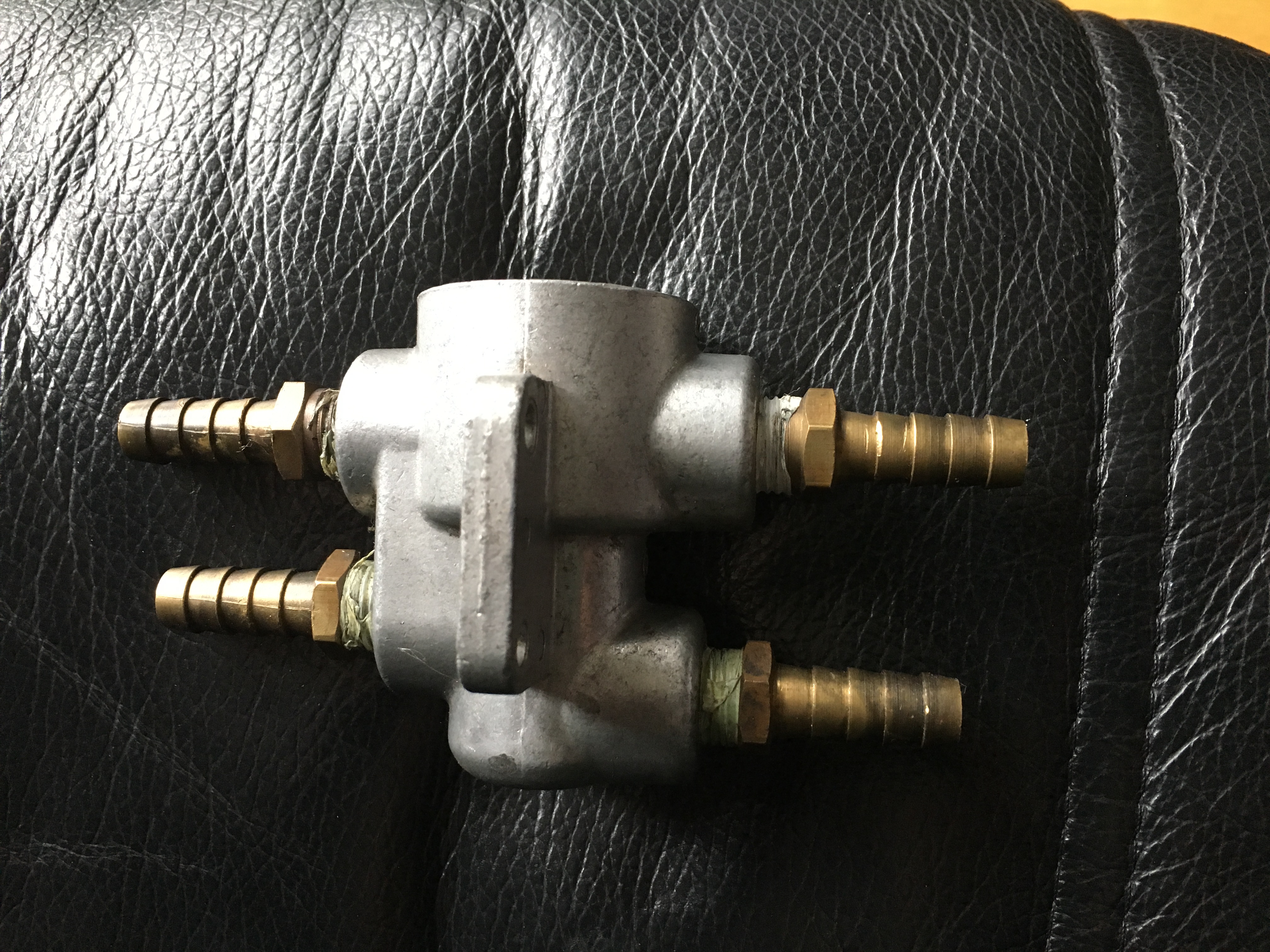

I have a Kerker thermostat (oil cooler) and not 100% sure how to connect it correctly?
The take-off's are labelled:
E1 and E2 one side - C1 and C2 the other side (the "C" connections are wider apart).
I think the "E" connections (on left in last photo) are from the engine and the "C" are to the cooler :?:
Posts: 4027
Re: Oil Cooler THERMOSTAT
#2 PostAuthor: zed1015 » Mon Dec 04, 2017 12:09 pm
Yep! E1 feed from engine ... E2 return to engine.... C1 feed to cooler .... C2 return from cooler.
#3 PostAuthor: Pigford » Mon Dec 04, 2017 12:25 pm
Cheers Rob - you is da man :up
