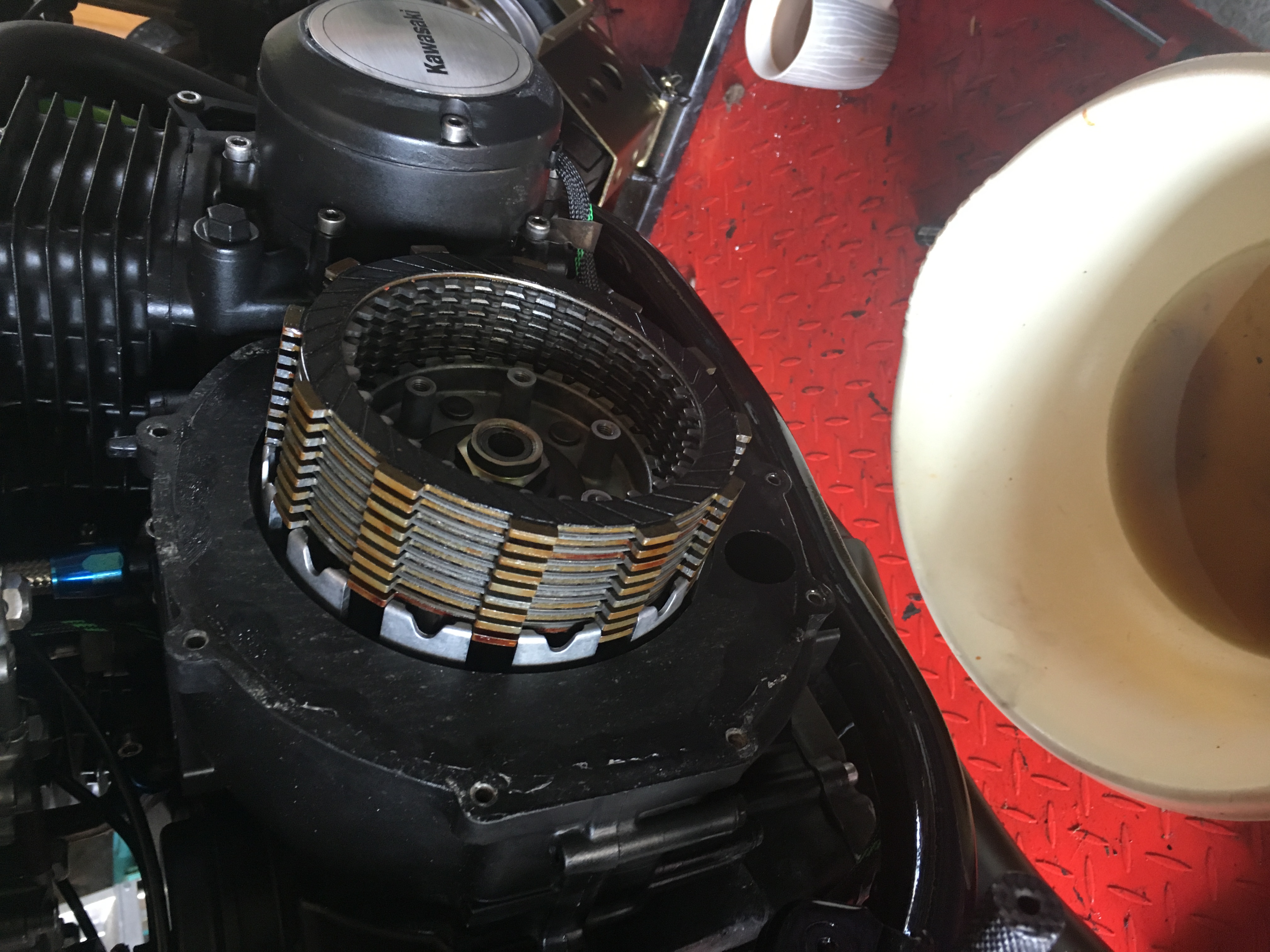

I was bleeding the hydraulic clutch today (PMC kit.)
When I put it in 1st gear, without the engine running, & with the clutch lever pull in, the back wheel still locked ??
The engine has been sitting a while, so I’m thinking that maybe the clutch plates are sticking ??
Take it into neutral & wheel is free.
Any pointers guys ?

#64 PostAuthor: neilbarrett » Sun Apr 15, 2018 8:45 am
id remove the clutch cover and remove the plates one at a time
give rm a slight wipe with some fresh oil and renstsll em .also if youve in stalled a pmc kit you could check its fully working when you remove the cover if the plates arnt stuck

#66 PostAuthor: z1000puddin » Sun Apr 15, 2018 10:57 am
Looks like the issue is sticky plates :D

#67 PostAuthor: ADRIAN H » Sun Apr 15, 2018 11:46 am
I think you’re supposed to soak clutch plates in engine oil for 24 hours before you fit them ?
Posts: 2933
Re: Lawson Jigsaw Project
#68 PostAuthor: Al » Sun Apr 15, 2018 2:45 pm
That will be the clutch plates stuck then. The helical grooves in the friction plates need to be facing the other way! They remove oil from the spinning clutch pack so as not to pressurise it and theoretically force it open. Looks fantastic by the way.

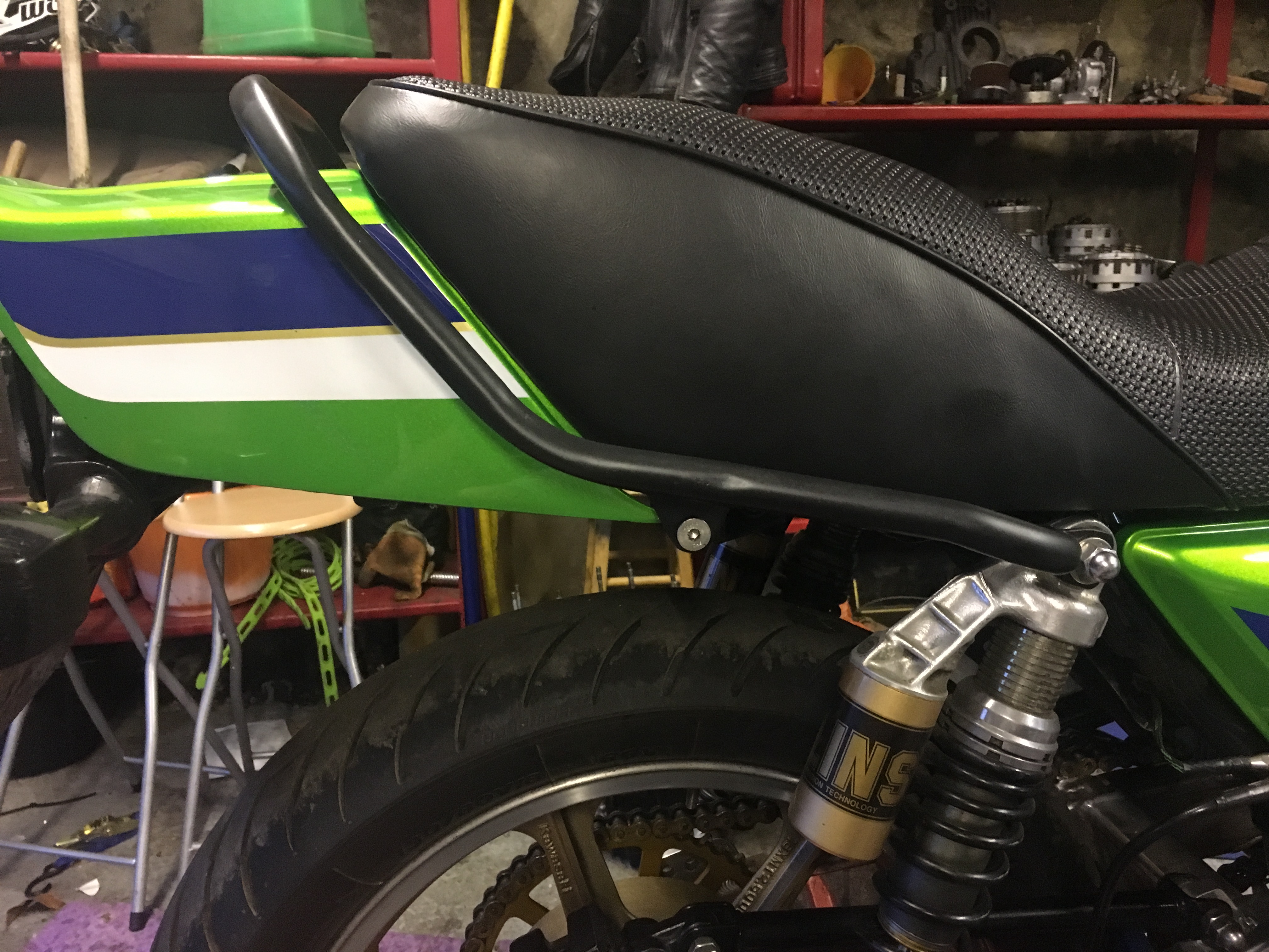

#69 PostAuthor: z1000puddin » Thu May 10, 2018 10:43 pm
Got my grabrail back from xylan coting, looks very similar to the black chrome, but more of a satin finish
