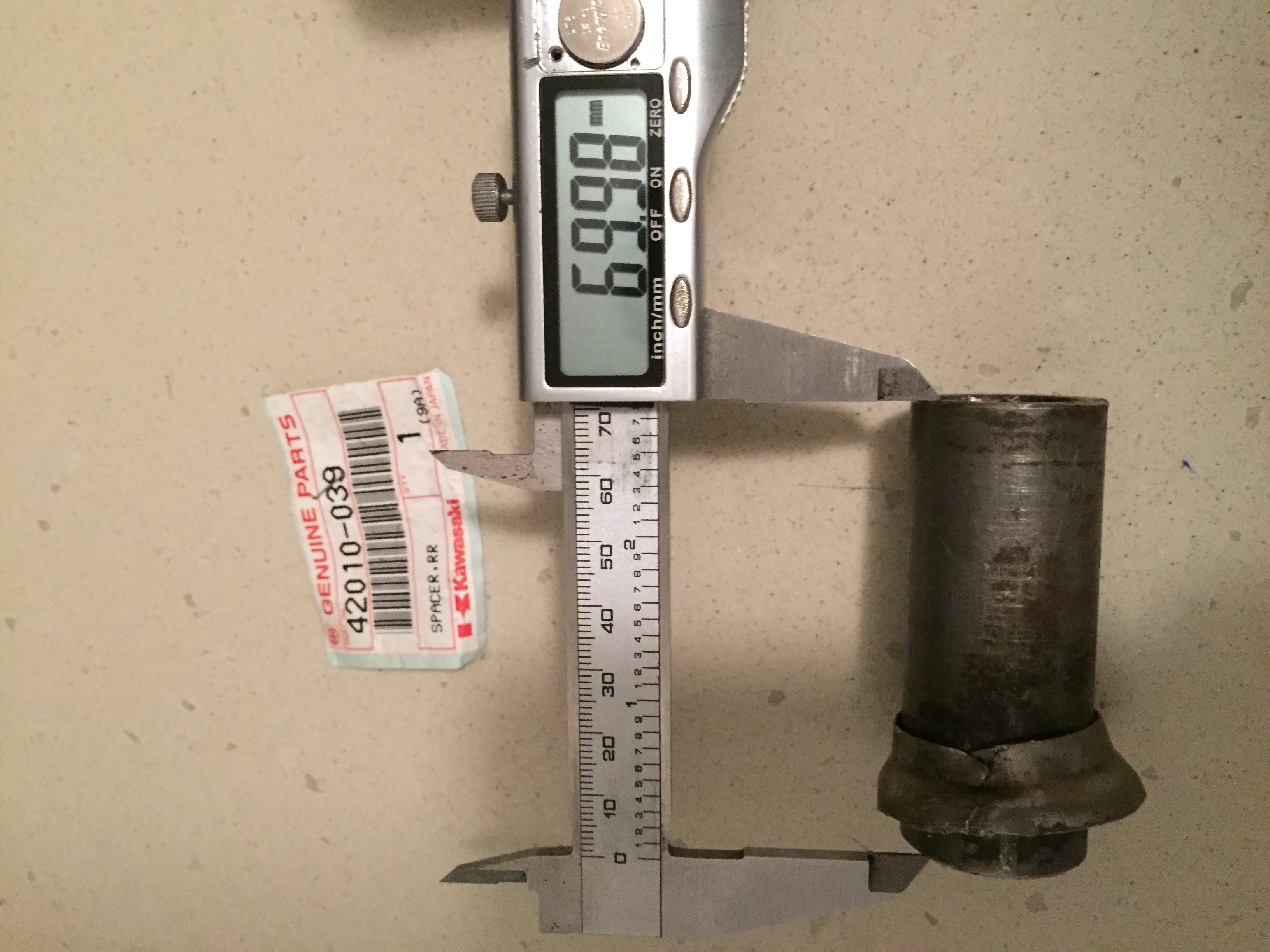

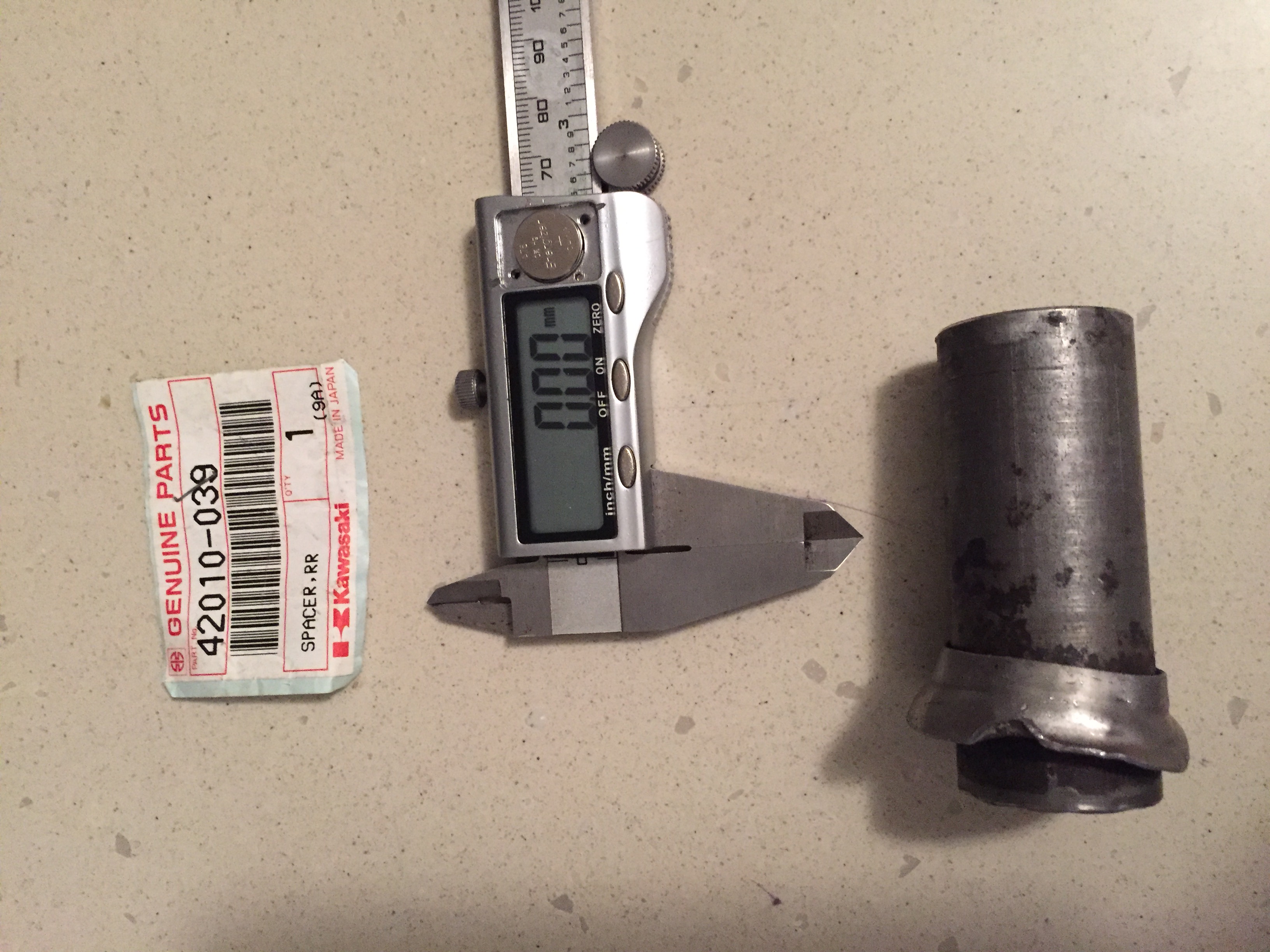

I'm having similar issues with going from spoke to cast. Looking at the centre spacer ( # 42010-039 ) the space looks to be around 70mm. Hard to see with a rule and shoddy eyes, The spacer I have is 86mm. I know the main reason of the spacer is to stop the bearings being crushed so would like to mill it down as accurate as possible.
Has anyone got the correct measurement for that part ??
Nico

did my spoke to cast 18 months ago, the thin tin steady'er was mankeled when bearings removed from Z1000H cast, , cost me over $100 for NOS spacer, it needs too be in good nick Nic otherwize you'll never get your axle thru. (alignment)

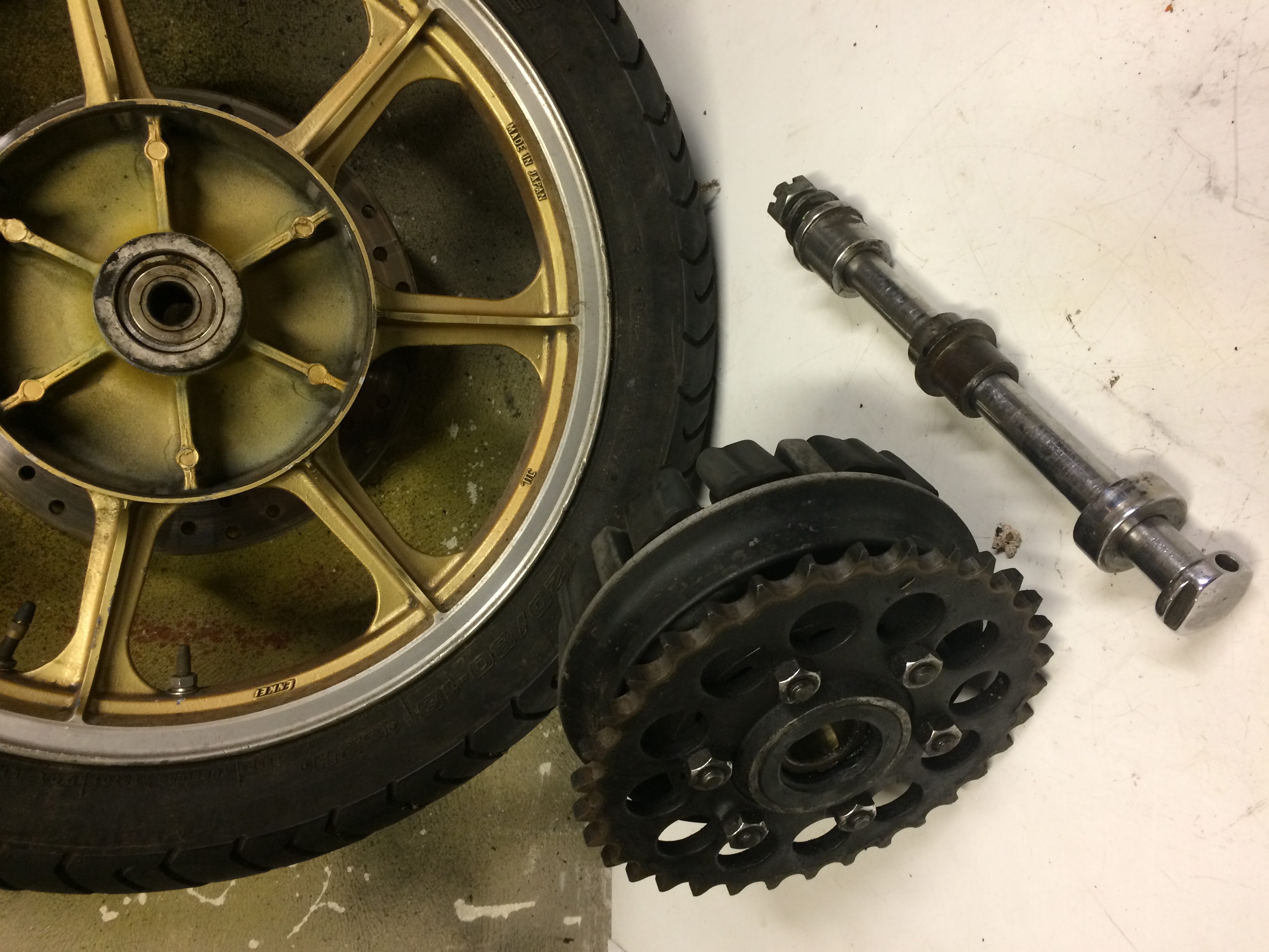

This is the wheel that used to be in my A1 and all the relevant spacers in the order they fitted - axle nut could be either end probably wrong way round here but spacers are right caliper went outside last chrome spacer

That’s the one pictured in the middle of the axle - goes inside the sprocket carrier but it’s 42036-024 on the parts diagram for the A1 - to the best of my knowledge the spacers on mine are the same ones that came out of the spoked wheels.

I put alloy wheels onto my A1, the only spacer that was different was the one in the picture that’s nearest the nut, it’s a bit smaller, also needed a different sprocket carrier for alloy wheels. I can’t give you the measurements at the moment I can’t get access to my bike at the moment. Sean.

+1 the only one that is different is the sleeve / coupler - Sproket side.
