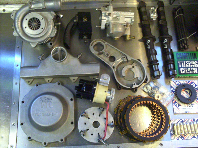

In the parts stash so far for the Z1R there's the spare rebuilt and balanced Rajay turbo from the Orient express drag bike, a Wastegate ( but no exhaust to join it all together as yet ), ATP plenum, Super B carb that I first had on the Drouin, GPZ1100 Unitrack cams, Ape 32t slotted cam sprockets ,MTC lockup clutch, Barnett extra plate clutch pack, Titanium valve spring retainers, HD cylinder studs, bronze guides and the remains of a Bill Hahn Boost retard distributer ignition that's missing the cover, GM hei module, belt, crank pulley and coil.

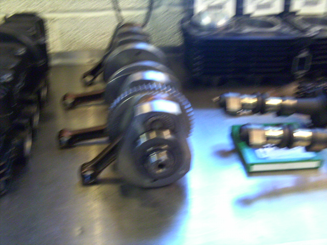

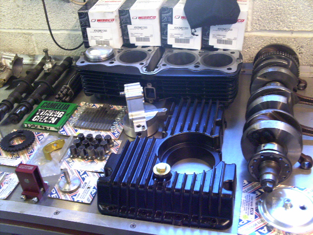

And here a fresh welded MK2 crank (by Roger Upperton), assorted APE nuts, case studs, top idler bracket, needle clutch pusher etc, a Deep sump with Turbomaxx billet 40% extra flow oil pump and a freshly bored 1075cc block with 10.25 comp Wiseco pistons.

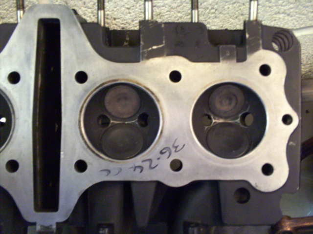

The head will be either a J or GPZ1100 Unitrack who's larger 40cc combustion chambers will drop the comp down to a turbo friendly 8 to 1.

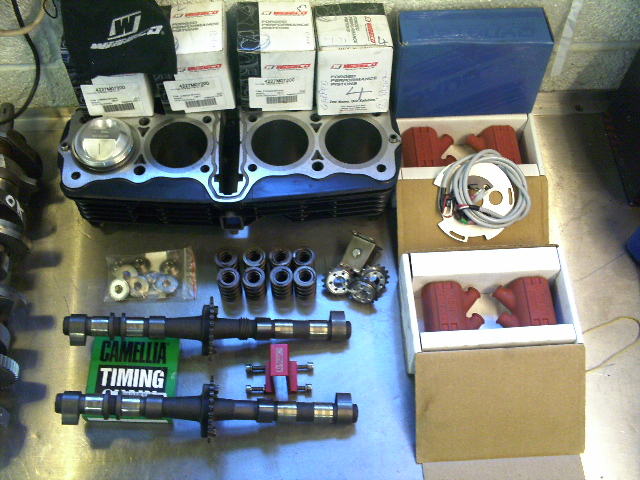

For the "B" based bike which will have "A" bodywork there's another fresh 1075cc block with 12 to 1 comp Wiseco's ( again dropping to around 10 -1 with a 'J' head ), a set of fast road Kent cams 'w' slotted sprockets , Ti retainers, HD valve springs, my own billet idler wheels, HD cam chain etc and two pairs of 1.5 ohm dyna coils and Dyna S' ignition for the 8 plug head.

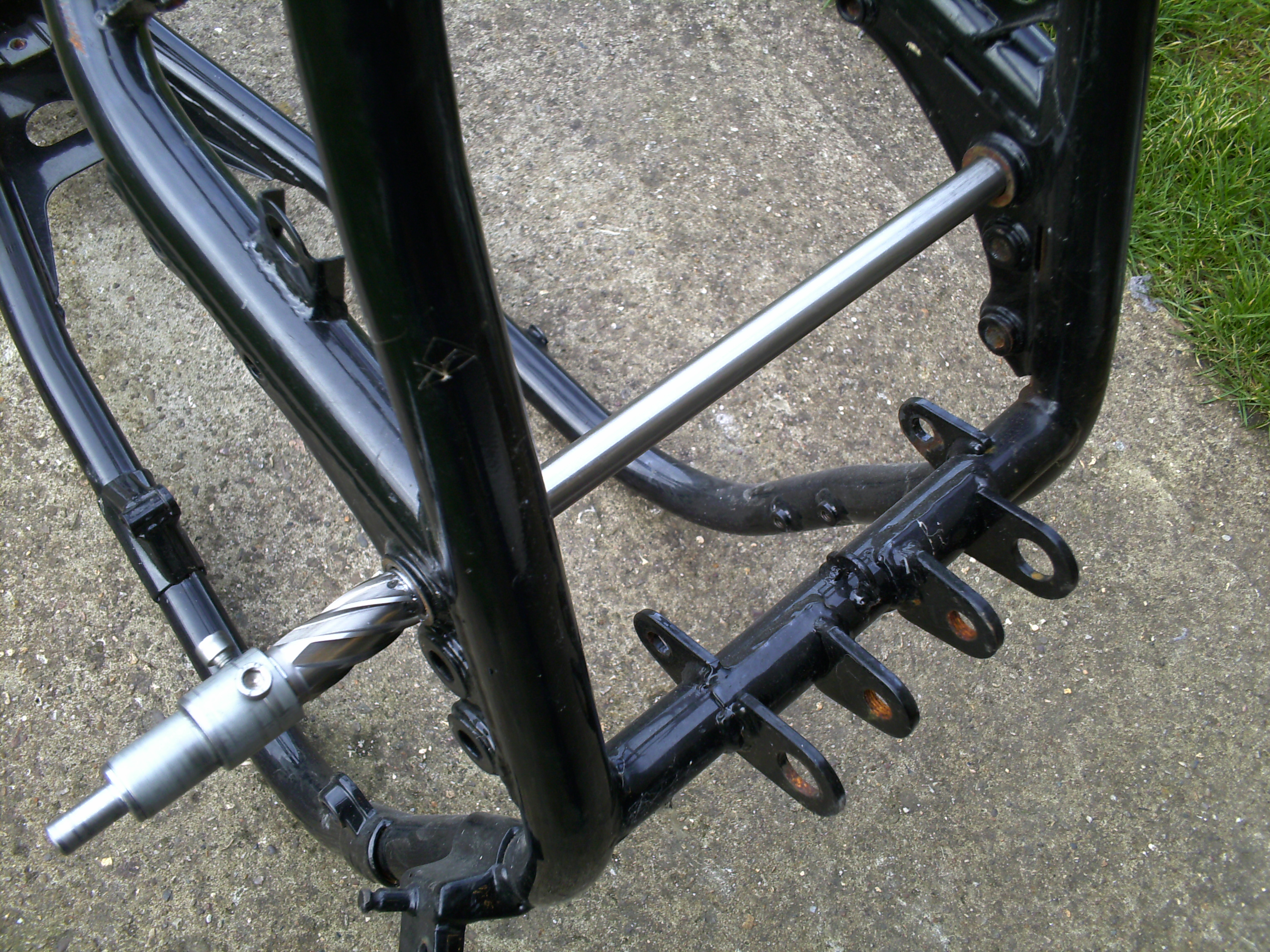

First job on the long list is to get the Yamaha XJR1300 swingarms in.
The original Zed spindle and pivot hole should ideally be 16mm but in actual fact the hole is 16.2mm and the spindle is 15.8mm so a massive 0.4mm slack fit that translates to much more at the rear wheel end which doesn't do the bikes handling much good.
The idea is to tighten all the clearances in the running gear, engine mounts and brace the frames to eliminate as much flex as possible especially for the turbo bikes 200hp + potential.

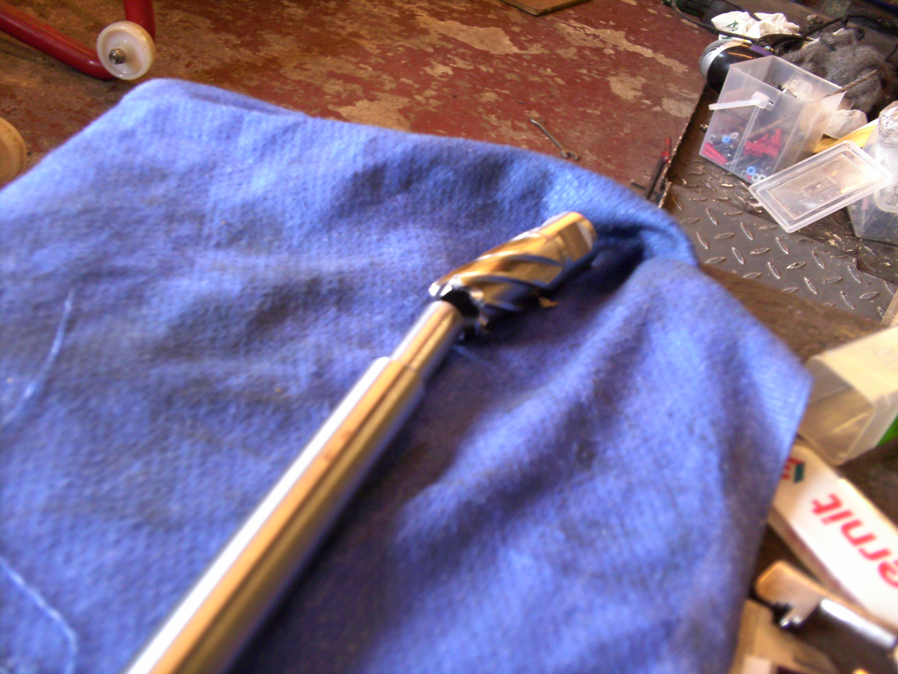

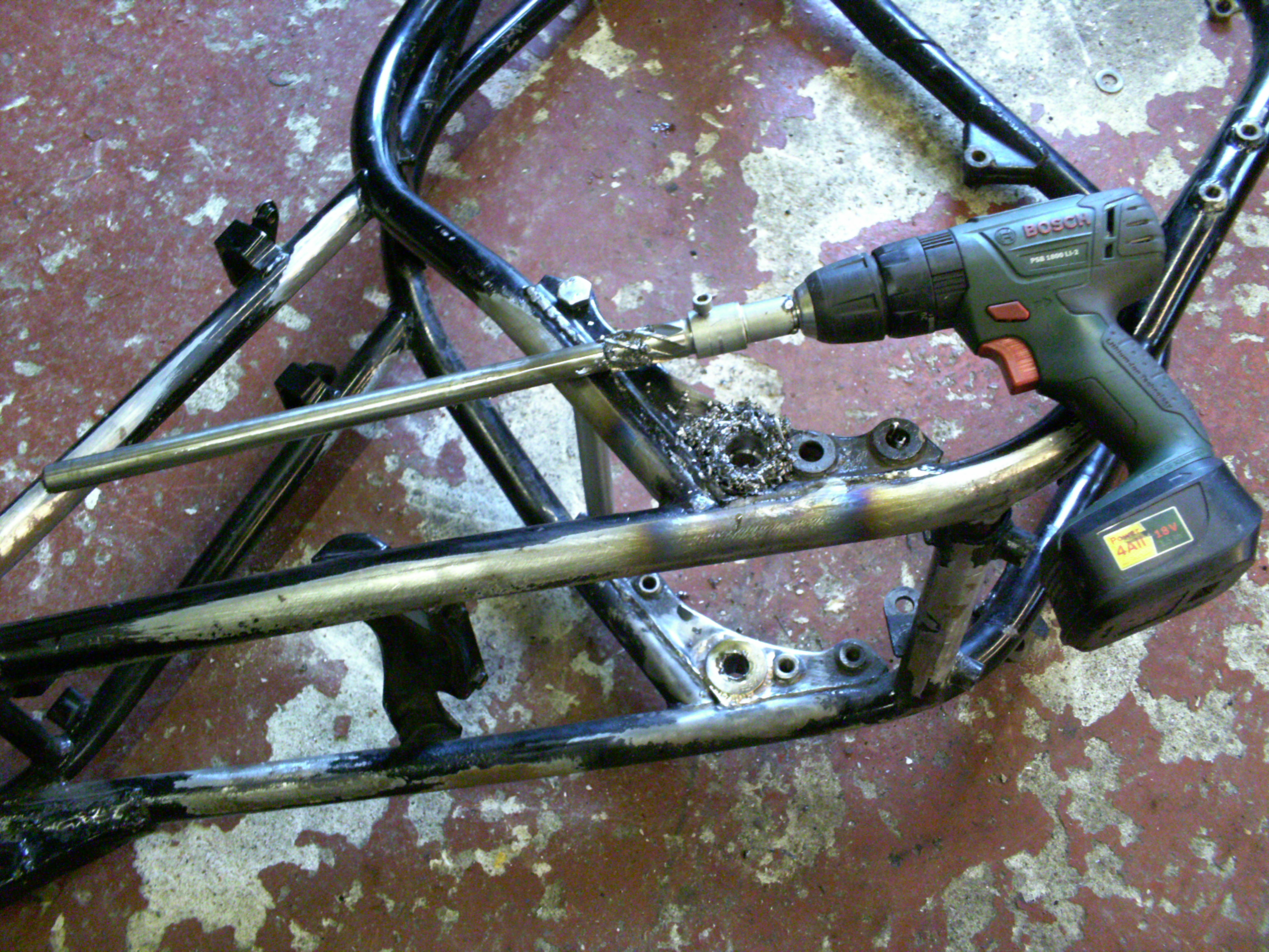

The XJR s/a spindle is 20mm and rather than sleeve the arms bearing tube down to fit the original zed spindle and still have the play there's just enough meat on the zeds frame pivot to go out to this, so a line boring tool was made for the job.
This consists of a length of ground bar and a 20mm rotabroach cutter.
The end of the bar turned down to be a tight snug fit inside the cutter.
And the end tapped M6 to secure the cutter and a drill arbour made to drive it from the battery drill.
Then with some cutting fluid, work evenly from both sides
And job done.
Spindle slips in with a slight drag, zero play and no room for paint..
But not quite finished yet..

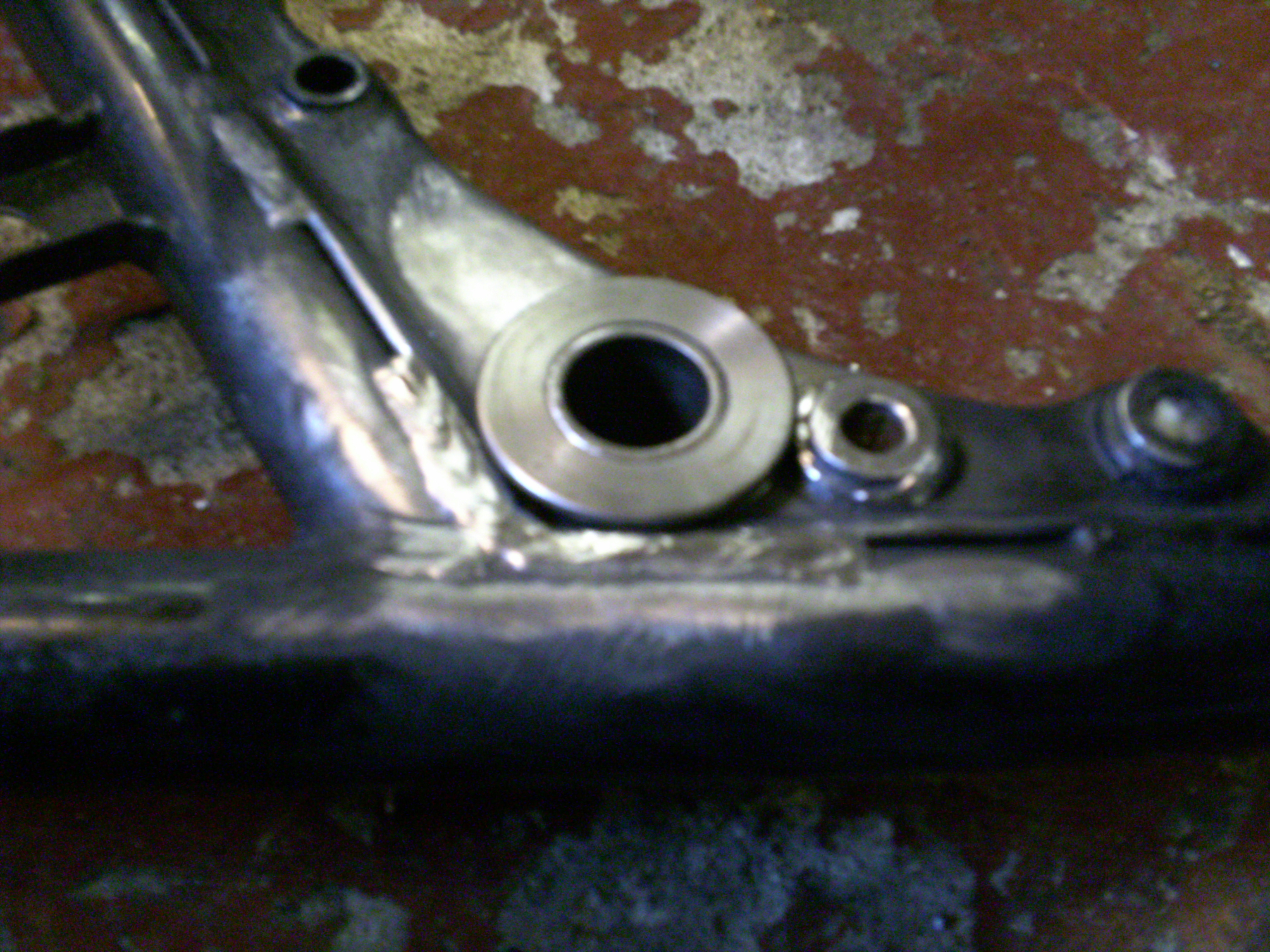

The next job is to eliminate any lateral movement of the swingarm at the pivot.
This is something often overlooked when fitting modern arms which then still allows the arm to float against the thin flexible steel end caps especially when cornering.
The caps need a larger support area to at least the inner diameter of the arms pivot tube so a steel disc was machined with a light press fit on the frame boss.
And then Bronze welded on.
The disc sits very slightly proud of the frame boss and once done i very lightly spot face the support area with my home made in line cutter to true up the face and ensure that everything is square, parallel and level with the original boss and that the internal width is unchanged
An alternative to this when not modifying the frame is to either make some beefier end caps or insert some 3mm minimum thick shims in the original caps and trim the arms pivot width to compensate.
