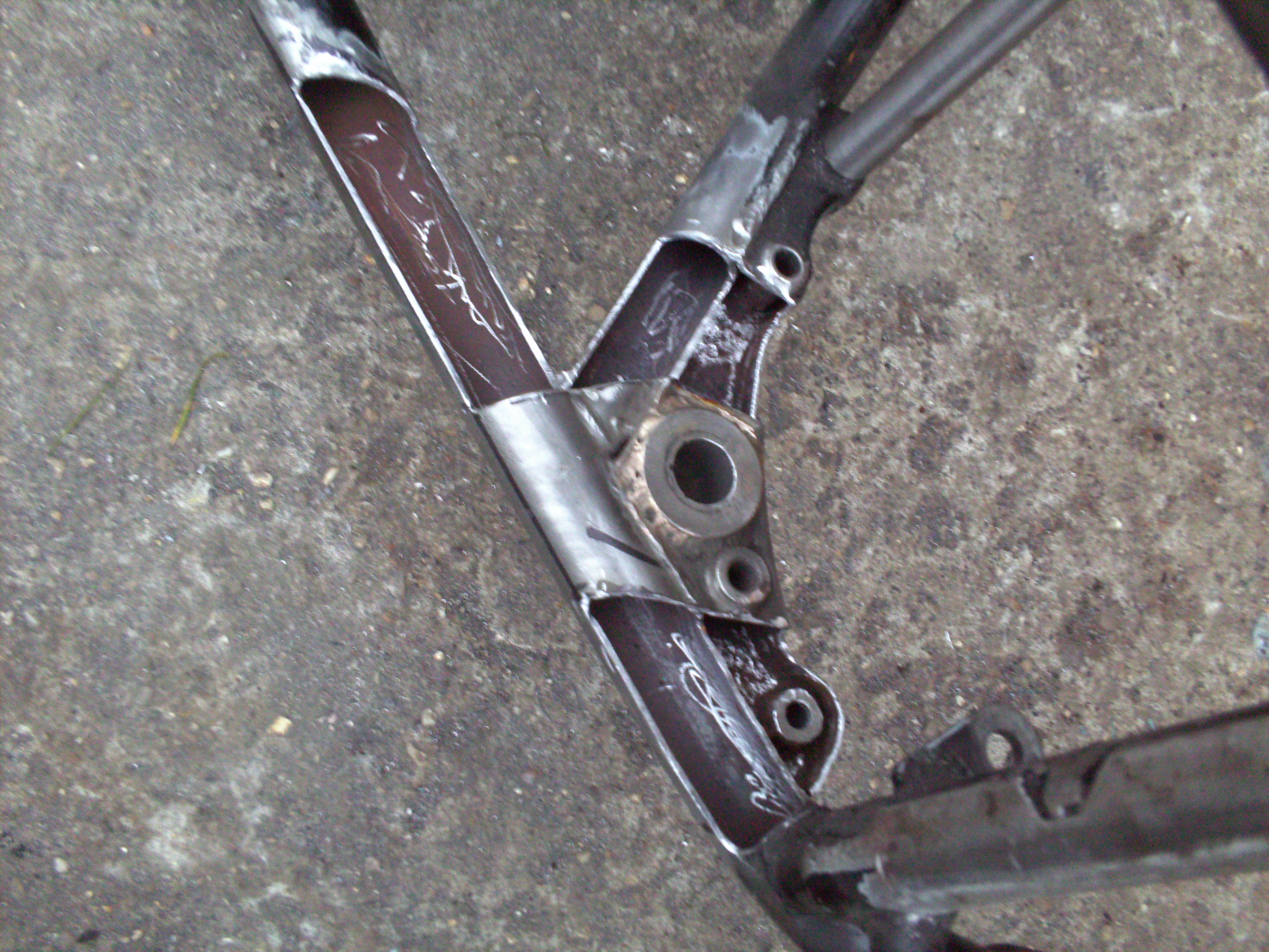

Had a little session with hacksaw and welding torch.
With the 6 inch rim and a 190 or 200 section tyre the front sprocket on the Z1R is going to need around 7/8ths (21mm) offset.
This will result in the chain arguing with the frame so a little adjustment around the swingarm pivot area is needed..
After a bit of measuring the frame was sectioned width wise by around 10mm
Then plated back up
And the weld beads blended in
Plenty of clearance up and down and side to side now

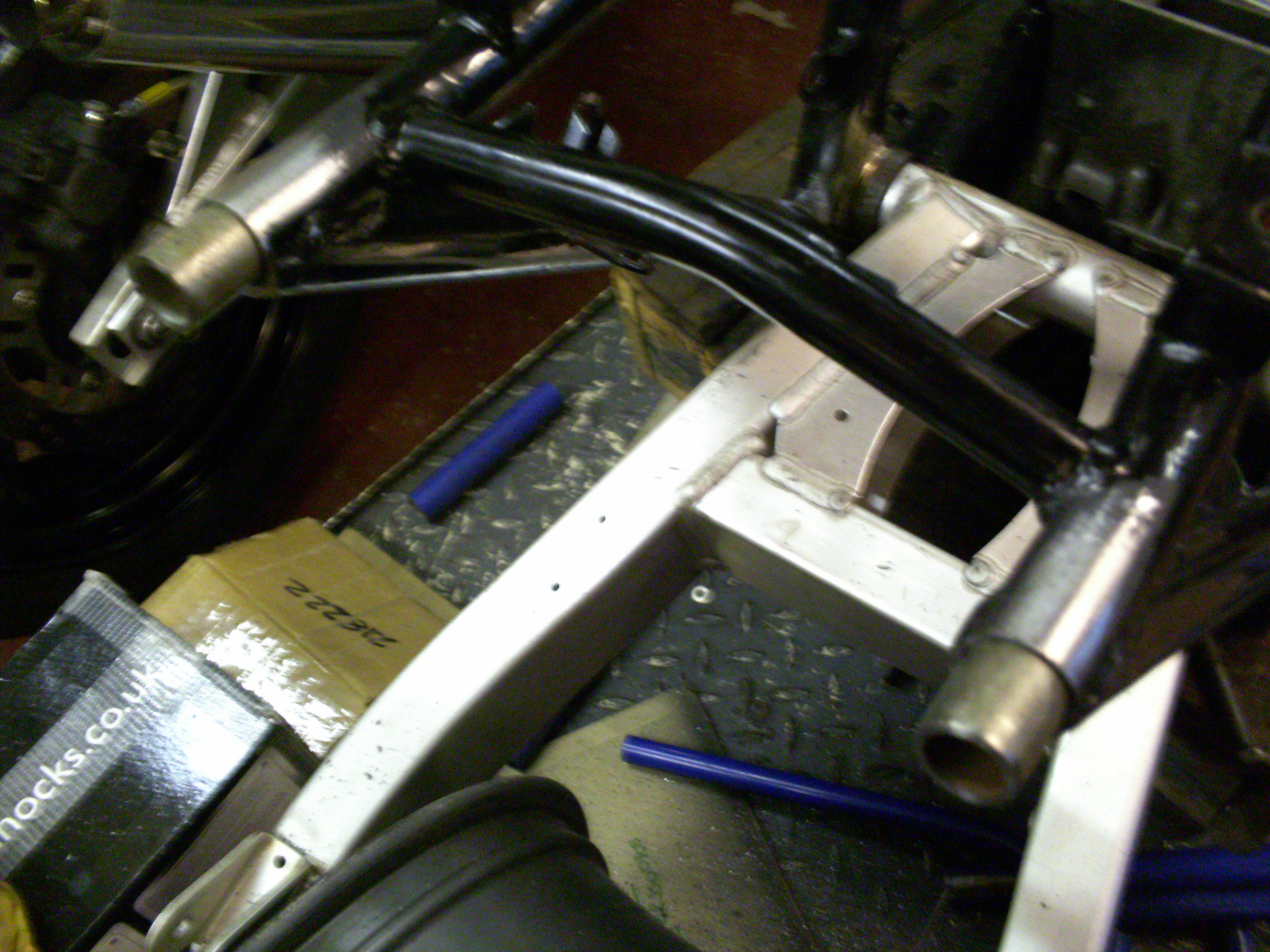

After the chain clearance mods I started on some of the frame bracing .
In all the excitement I forgot to take progress pics but this is about 80% of what the finished frame is getting..
Down tube "Z" bracing
Side corner bracing
Under seat cross brace
And the beginnings of the top tube mods
Hopefully that should help to keep it running straight.
Seat tail/rear light mount has also been re-angled and moved forward 70mm
Then threw in the engine cases with the turbo mocked up somewhere in the correct position.
There's a bit more frame loop, headstock and downtube bracing to go in but that has to wait until I've got the exhaust run sorted where i want it :wink:
