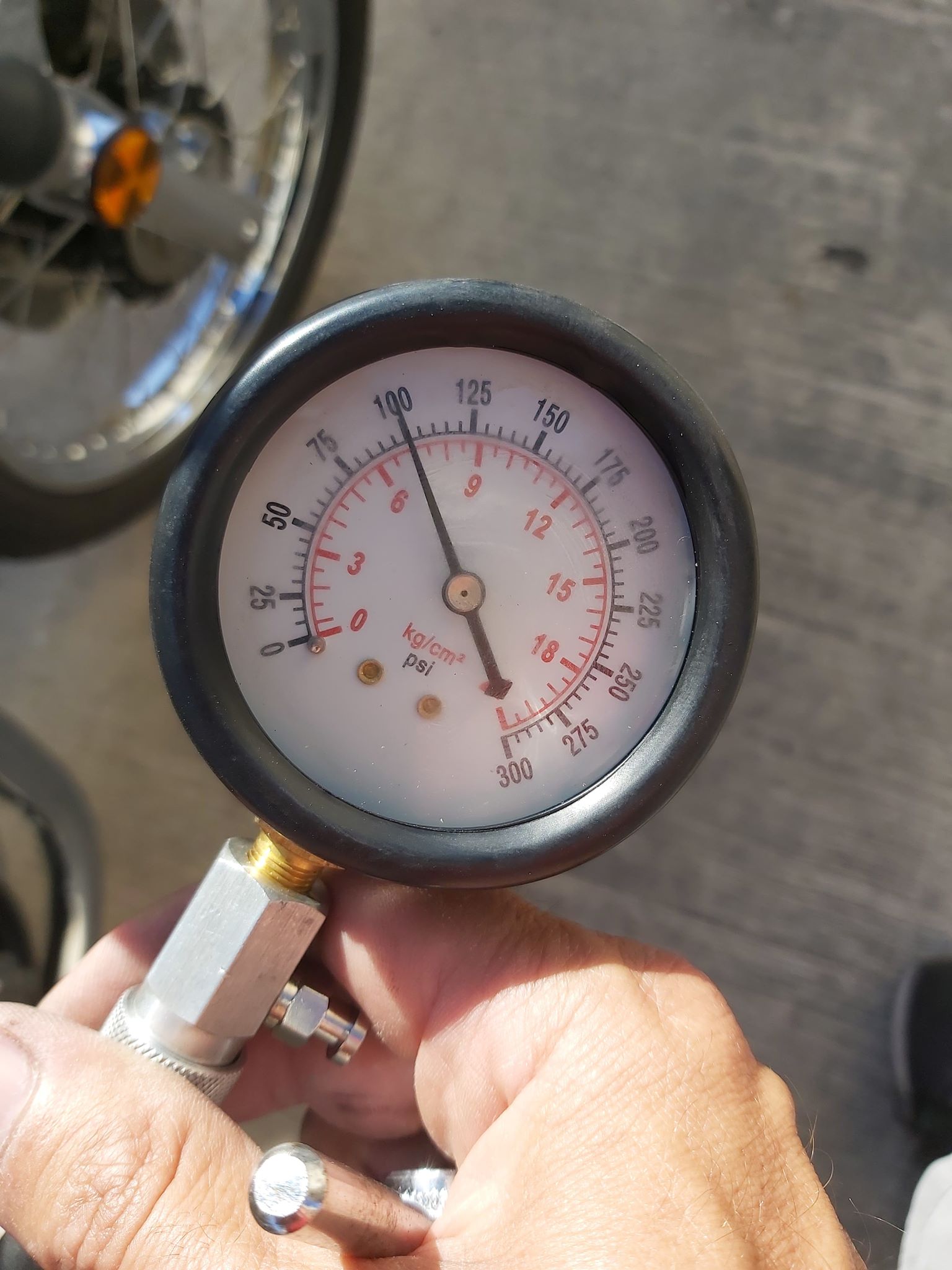

Also this time I was able to do a compression test , since engine was warm . All are around 105/110 psi except for number 2 which was 100 psi . What do you think about compression test results ?

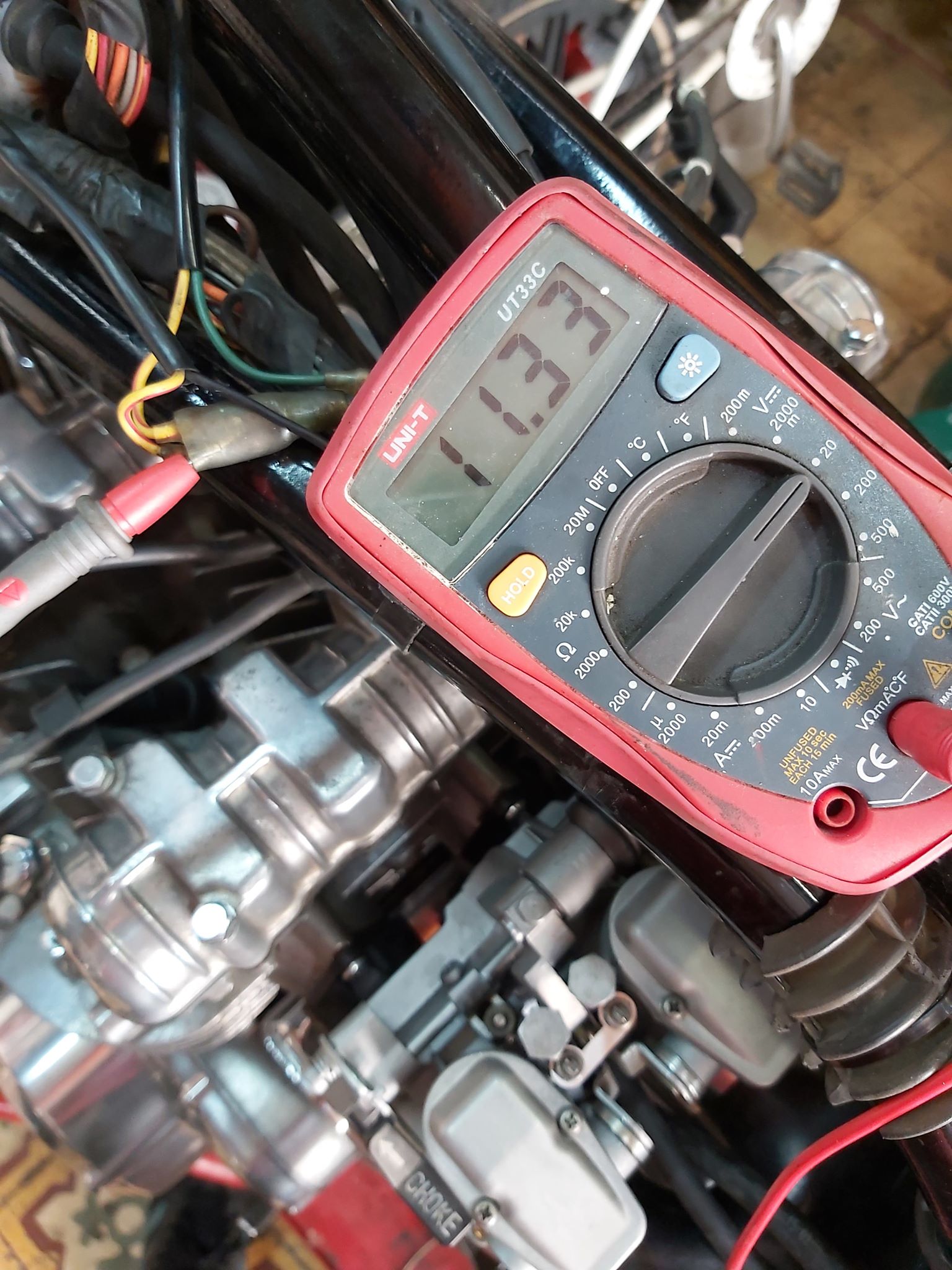

I also checked voltage at coils and this is showing 11.33 V , at the coil connector , at the battrey its 12.42 V so along the way its losing 1 volt , Would this make that much of an effect on coils ? Also bike is with Dyna S ignition .
