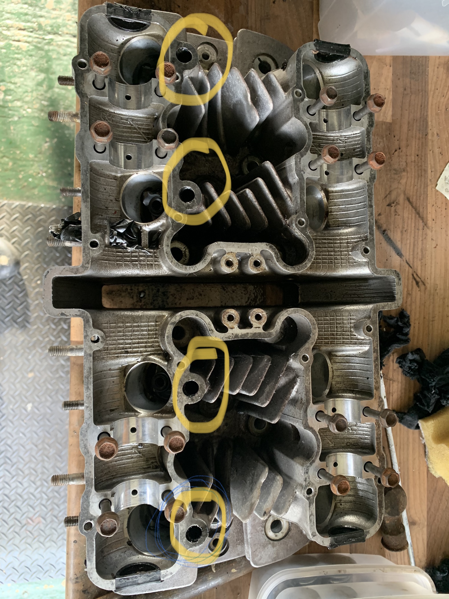

Hi,
I have this head with some extra bits on (see ringed features in pic), is it from an ST? Wondering what they do and if I can fit it to an A1? Assuming I will need a matching cam cover if so?
Cheers Russ

That will fit any 903/1015 motor.
Those four holes are for US emissions and simply need tapping M10 and plugging with grub screws .
Any round or square style cover will fit once they are plugged or find a matching emissions cover that has the tabs to cover those holes.

I have a cover with the tabs if you need to buy one, square ends.

possibly came from a police bike as both mk2 and St heads were black. :Oo
