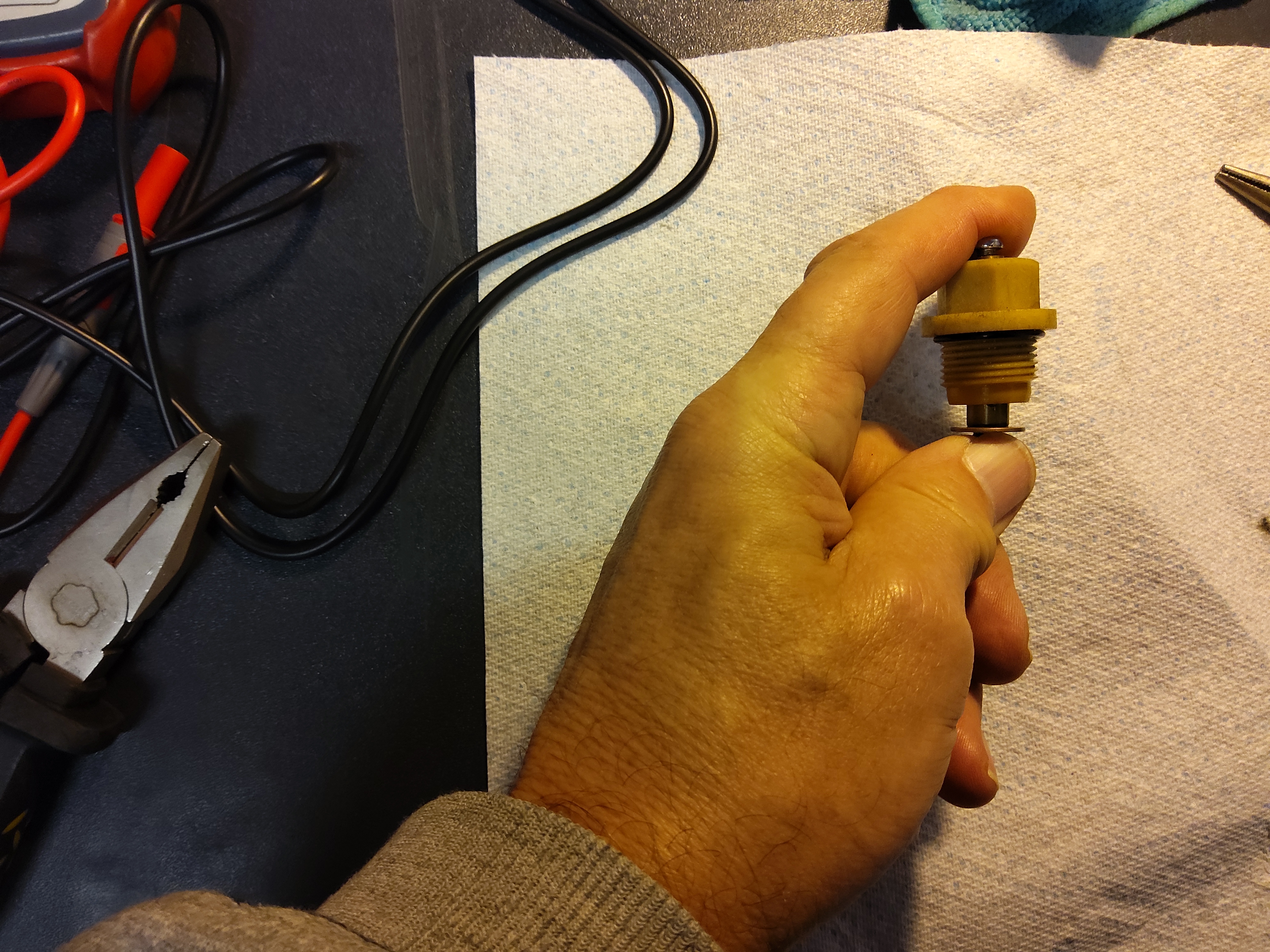

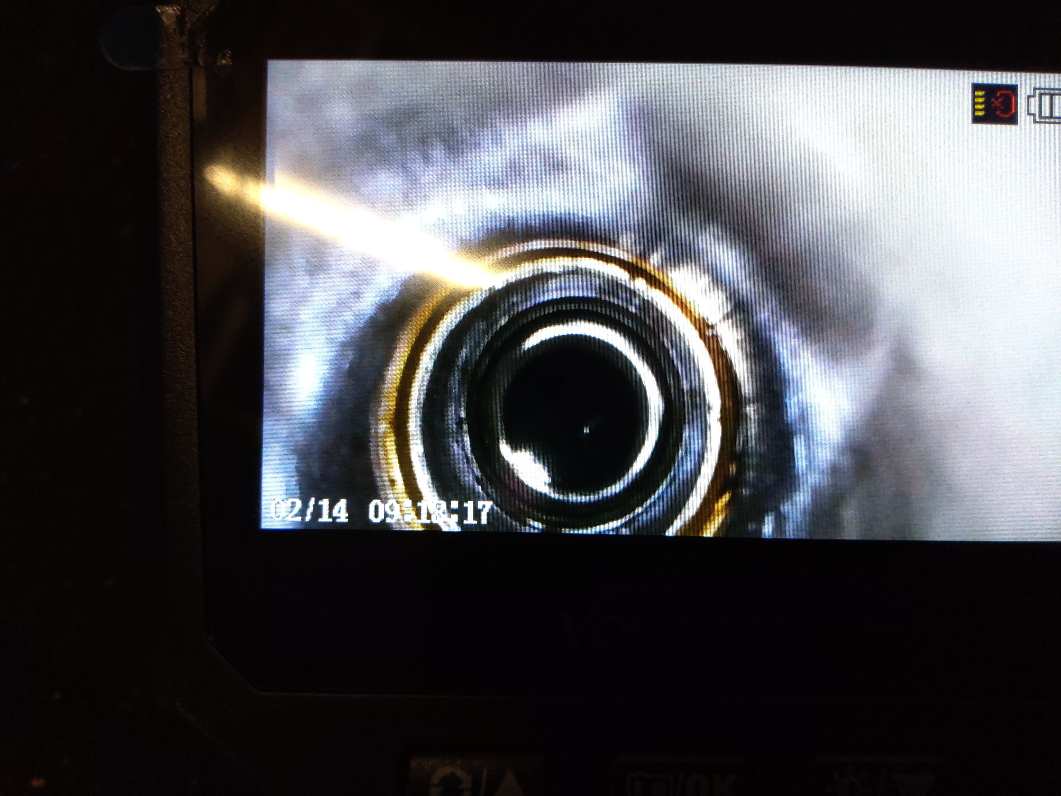

As I didn't fancy disturbing the oil filter housing again I bought an Oil Transfer Syringe from Allfrauds which successfully sucked out the 300ml excess oil. I then investigated the oil warning light not going out. I tried shorting the switch wire to earth which didn't seem to make any difference. After farting about for 10 minutes trying to fit a #2 JIS driver in between the carbs I finally managed to unscrew the switch wire. After removing the switch I realised why shorting to earth didn't work. The circuit to the warning light is live (ie light is on) when the sprung switch plunger is relaxed and the base plate is touching the crankcase (see pic) , ie earthed! Duh! I tested the switch plunger was moving OK, which it was, and then tested the circuit by switching the ignition on and earthing the switch on the crankcase. When it was touching the cc the light came on and went out as soon as I moved the switch away. So at least I've managed to confirm that the circuit is working OK.
Unfortunately this still doesn't prove that the switch is actually working under the pressures prevalent in the crankcase with the engine running. Does anyone know of any way of testing the switch for this?
Also does anyone know of an oil pressure gauge that will measure the very low crankcase pressures in a Z1? I can only find gauges measuring cars and Hodnas etc which are all running around 25psi up.
Base of the switch housing (earthing point ?) seen through the endoscope
Switch itself in relaxed position
Switch compressed as if engine running (hopefully!)
Z1-B, 360bhp ZX1000NGF

Bike looks fantastic Steve, a great job done. A cold engine with brand new fresh oil will register something of the order of 15 PSI. from start up at around say 1500 RPM, give or take quite a bit under different circumstances. Pressure will fall rapidly with temperature and a hot engine with fresh oil on tickover may be only vaguely around 2 PSI or a little better if lucky.
A 25 PSI gauge will work but will be more or less immediately redundant.
Does the baseplate for the switch have a teeny weeny hole drilled in it? Similarly; does the oil pump body have a similarly wee hole in it. Both are occasionally subject to air lock and the solution was to relieve the air blockage via an escape route. If you suspect its air locked you may be able to turn the engine over with the switch out ~ on the kickstart ~ with the ignition off.
There was a time when everybody was fitting these things and riding around with them on. https://www.ebay.co.uk/itm/Kawasaki-mot ... SwYhdbJoj3
I bought one a bit like it and use it periodically for testing as i dont have any wiring for an oil pressure light.
Ray Debben used to sell them but i cant say if he still does.
These type of things were or are still popular as well. https://www.ebay.co.uk/itm/Kawasaki-Z-1 ... SwUdlWdYUe
