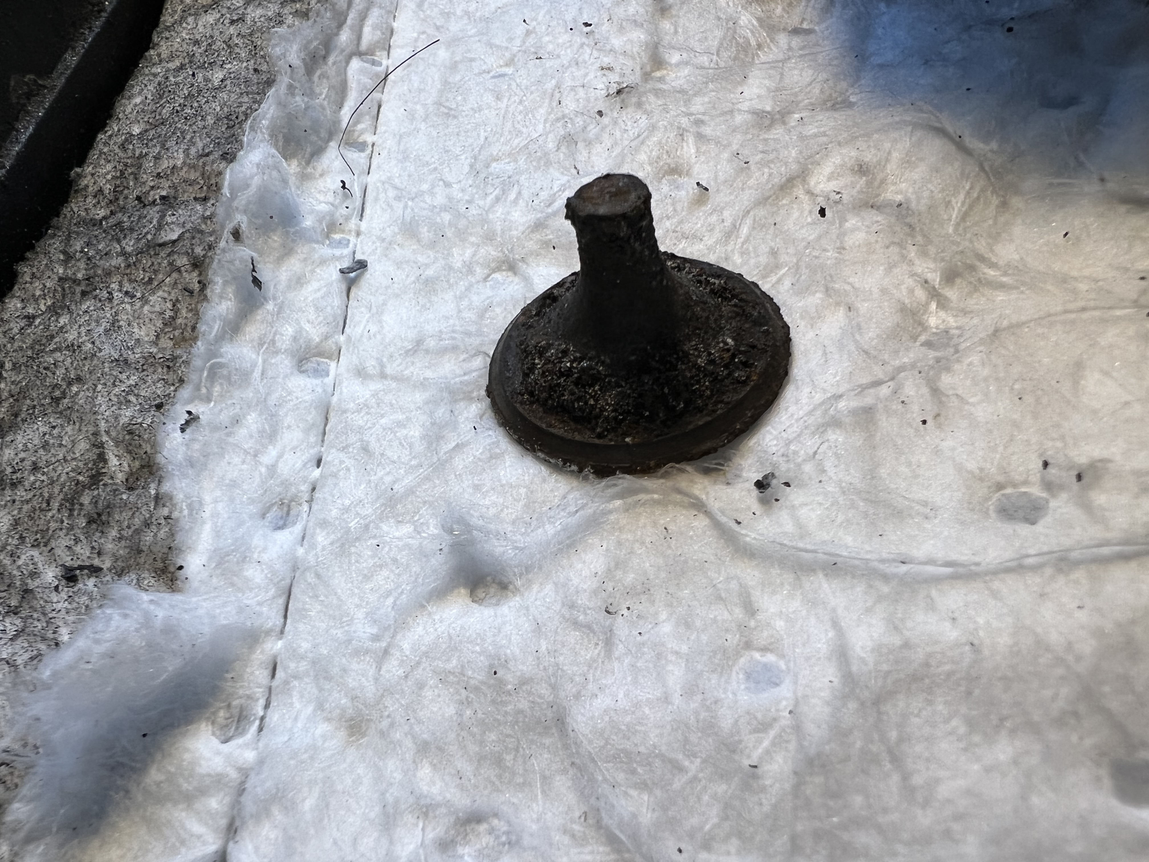

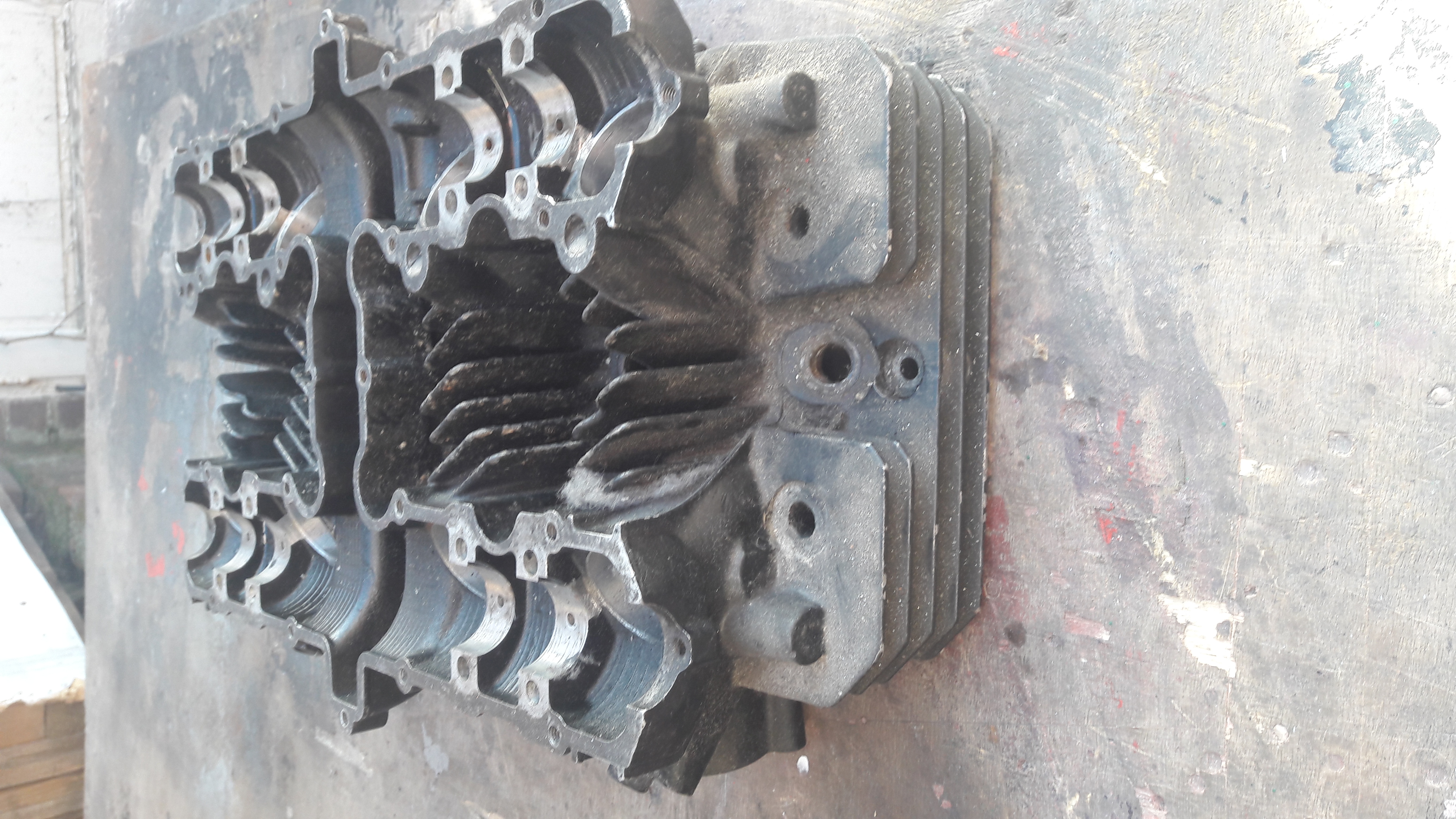

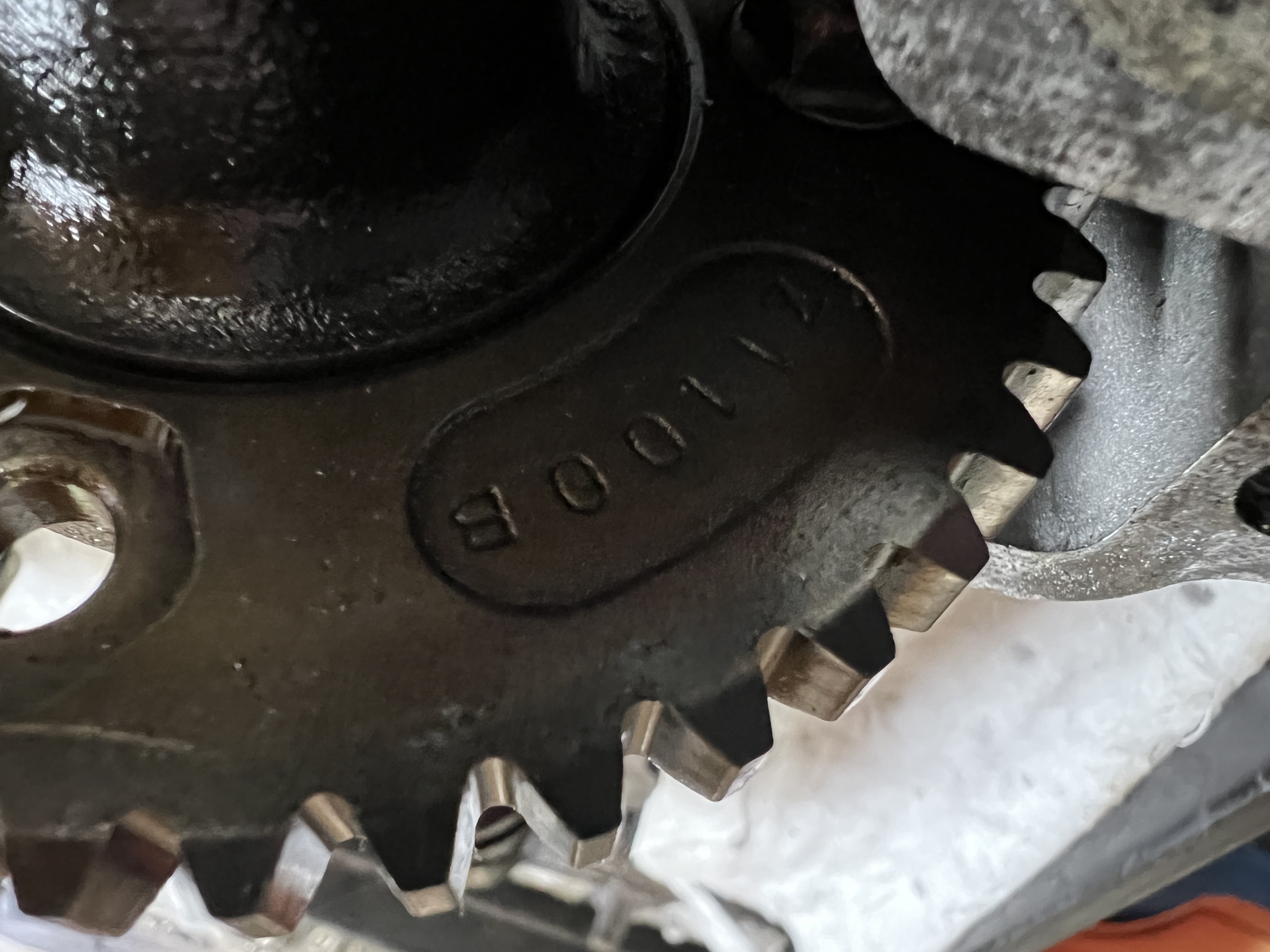

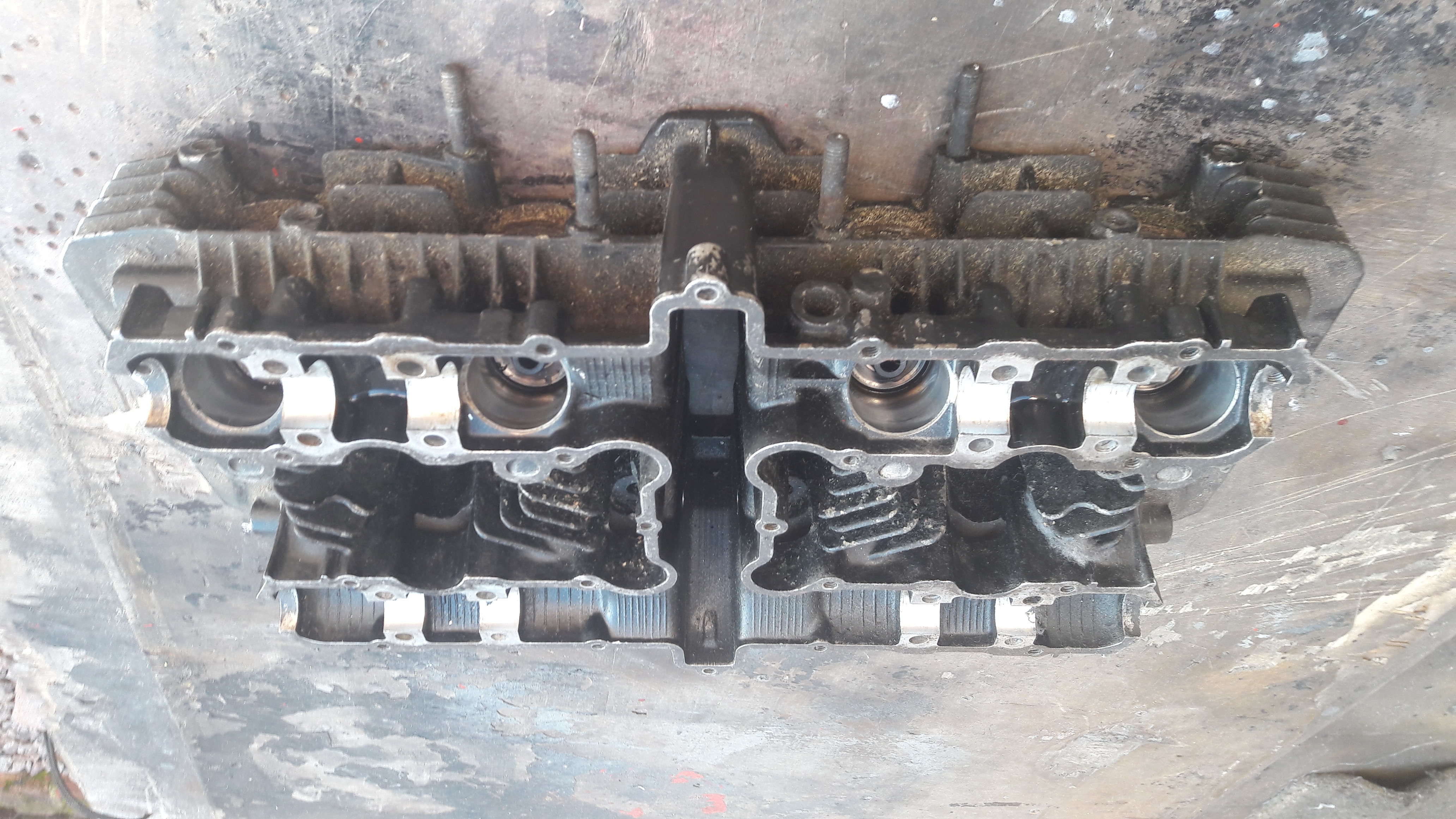

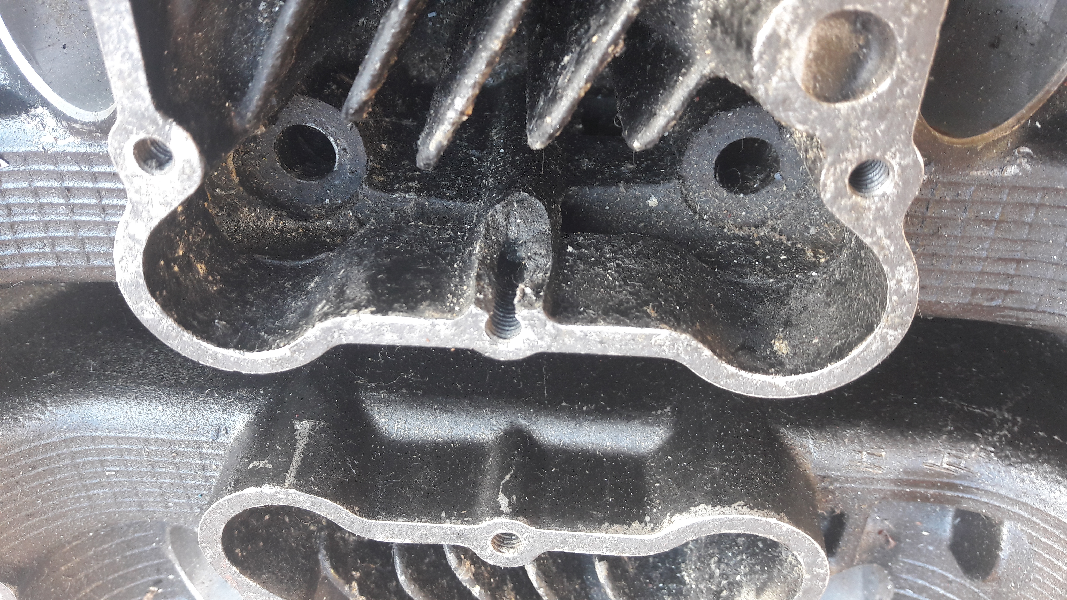

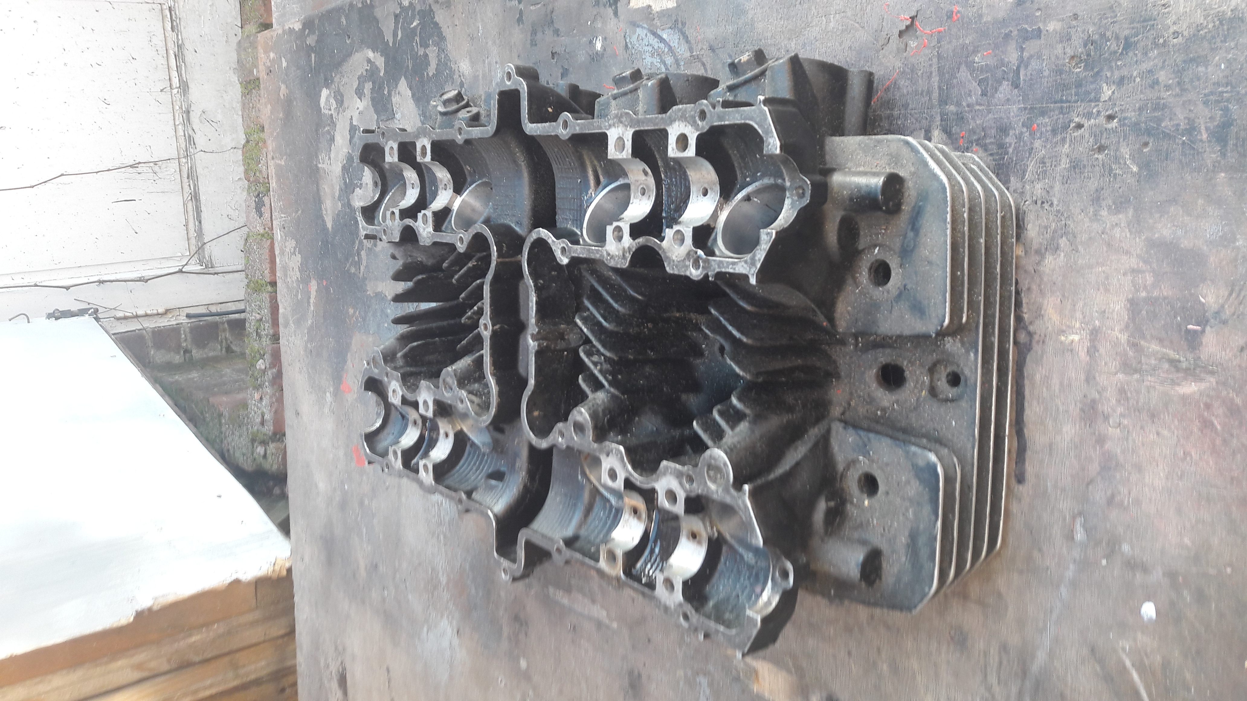

Hi all, i am back again with some photos of my damaged head. Hopefully someone can identify my head for me. As always all advice is appreciated. Neil.

#11 PostAuthor: Al » Sun Feb 06, 2022 1:14 pm
Its a Unitrak 1100 or Z1100R1 head.

Posts: 4040
Re: Gpz 1100 or Z1000J head wanted
#14 PostAuthor: zed1015 » Sun Feb 06, 2022 2:26 pm
Yep! Unitrack head.
Doesn't look to be that bad at all.
Combustion chamber where the valve head detached isn't touched and the seat looks ok.
Should come up well once the remains of the plugs are out and it's had a blast clean.
