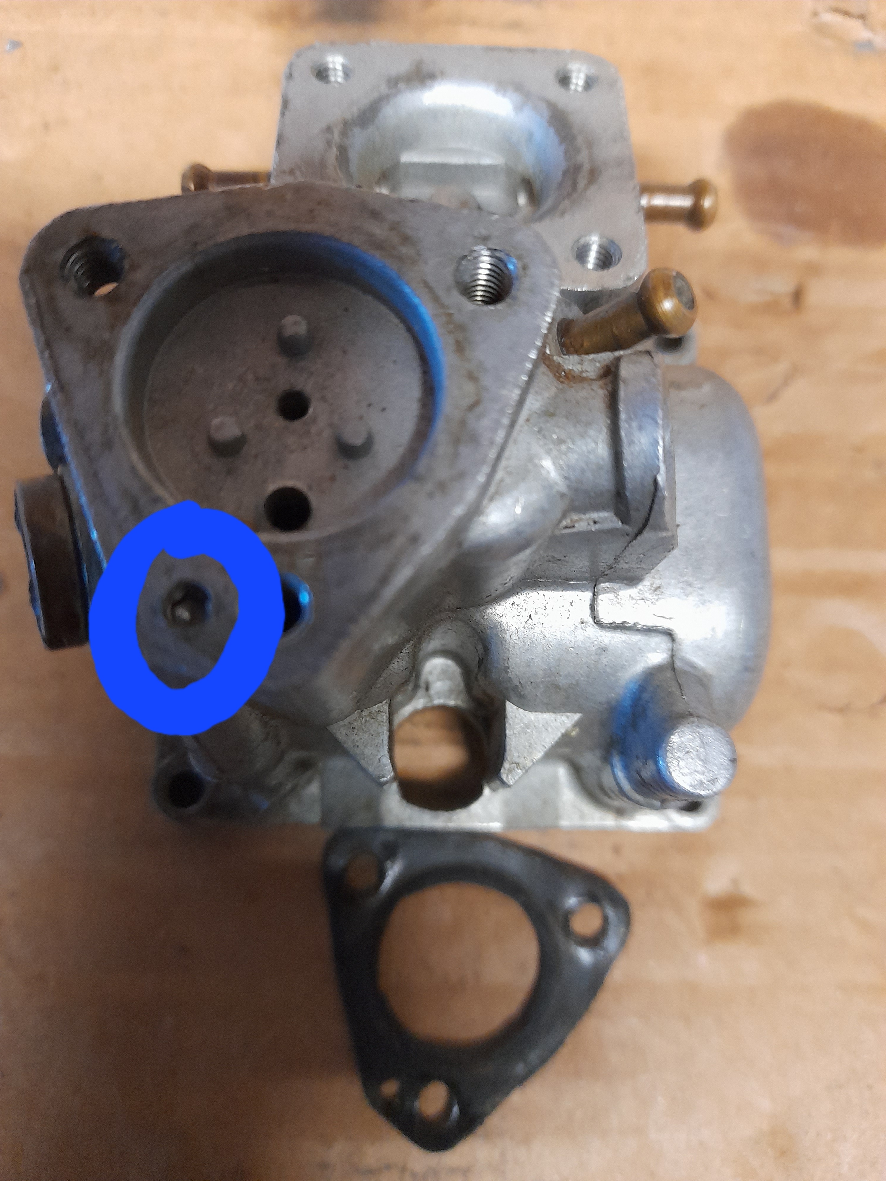

So Oz At Z parts has had a look at the carbs and has noticed on the no2 carb with the pumper on there is a bit missing inside the float bowl !
This is the no two float bowl
Where you can see the hole
This should have a black off to stop fuel blow back from the pump diaphragm , il post a pic but I don’t know how to do it ? Any help please from any one who knows these pumper carbs

It’s the check valve in the lower section of no 2 float bowl
It’s a blank off to stop the fuel from the pump running back to the float bowl
It’s not available as a separate item it comes complete with the float bowl
This is the reply from the guy sorting the carbs , any ideas??

This is the reply from the guy doing the carbs
That is for the top part of the float bowls
Their are 4 one on each float bowl
You have these that is not a problem
The forum is not understanding you
It’s the part that is built Ito the float bowl where the fuel is sucked up by the diaphragm
Not where it is pushed out to the injector nozzle

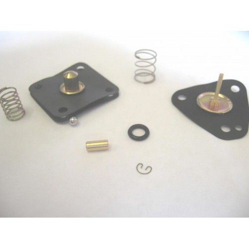

Is it any of these bits?

#26 PostAuthor: zed1015 » Sat Jul 23, 2022 4:32 pm
Regarding the above pic.
On your 28's only the square diaphragm is used.
The casting for the triangular sensor one is blank and undrilled.
From inside the bowl the ball bearing goes first followed by the brass weight and then the circlip to keep them in situ.
This forms a one way valve .

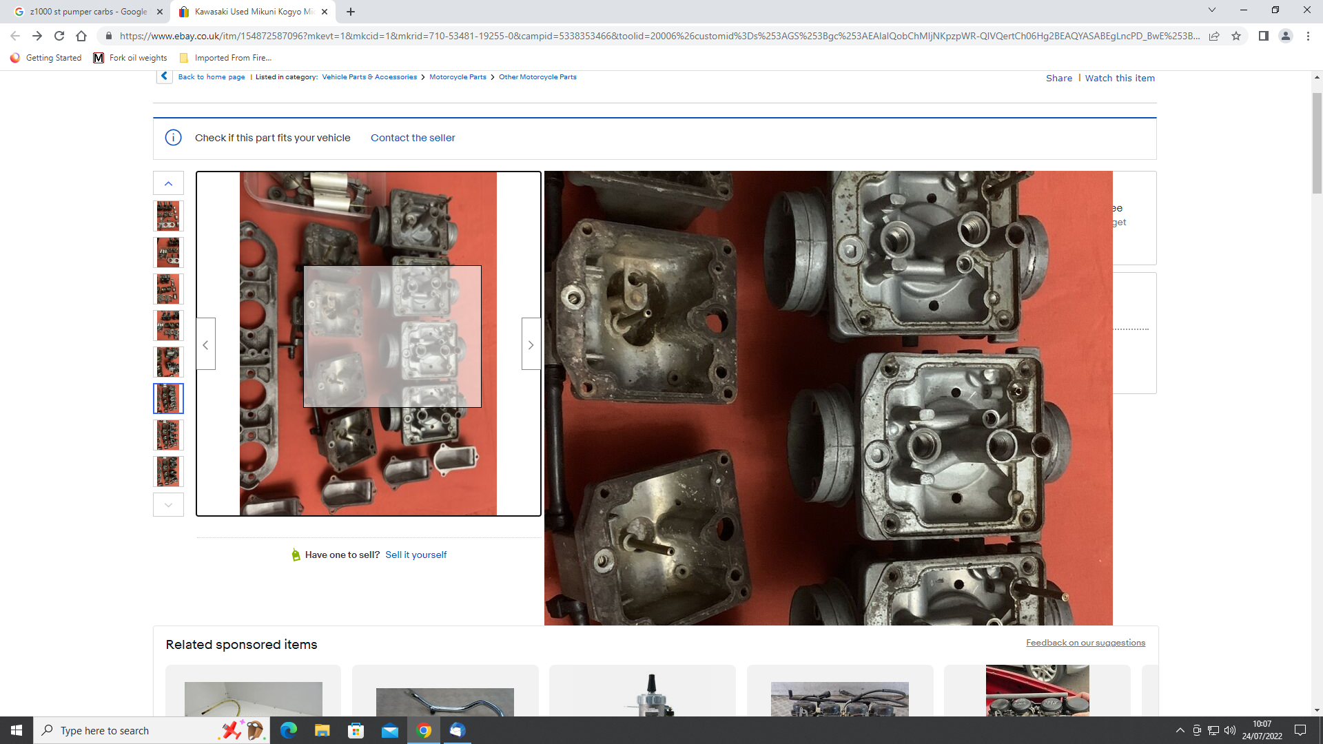

Float bowls 2 and 3 from an advert lifted from EBAY today

#29 PostAuthor: zed1015 » Sun Jul 24, 2022 11:29 am
Al wrote:Float bowls 2 and 3 from an advert lifted from EBAY today
https://www.ebay.co.uk/itm/154872587096 ... gLncPD_BwE
Very mismatched set of parts there.
VM26 non pumper bodies with vm28 pumper bowls.
The hole on the 28mm bowls doesn't require plugging.
On the 26 pumpers there's a check valve there for the sensor diaphragm which is redundant on the 28's.
