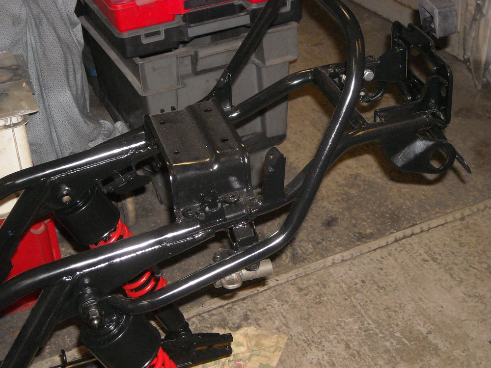

The frame is painted!
the freshly painted frame
The majority of the frame parts is painted too.

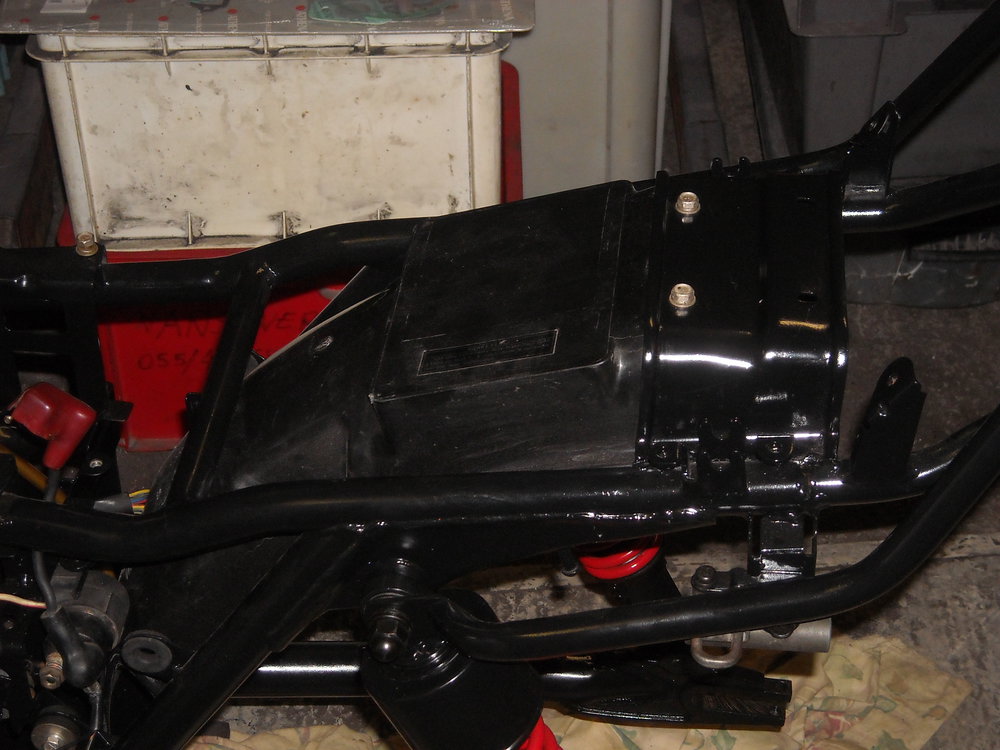

I couldn't resist to mount a few interior frame parts and started with the battery box and a few electrical components.
The rear part of the frame, where the taillight is attached, was also mounted.

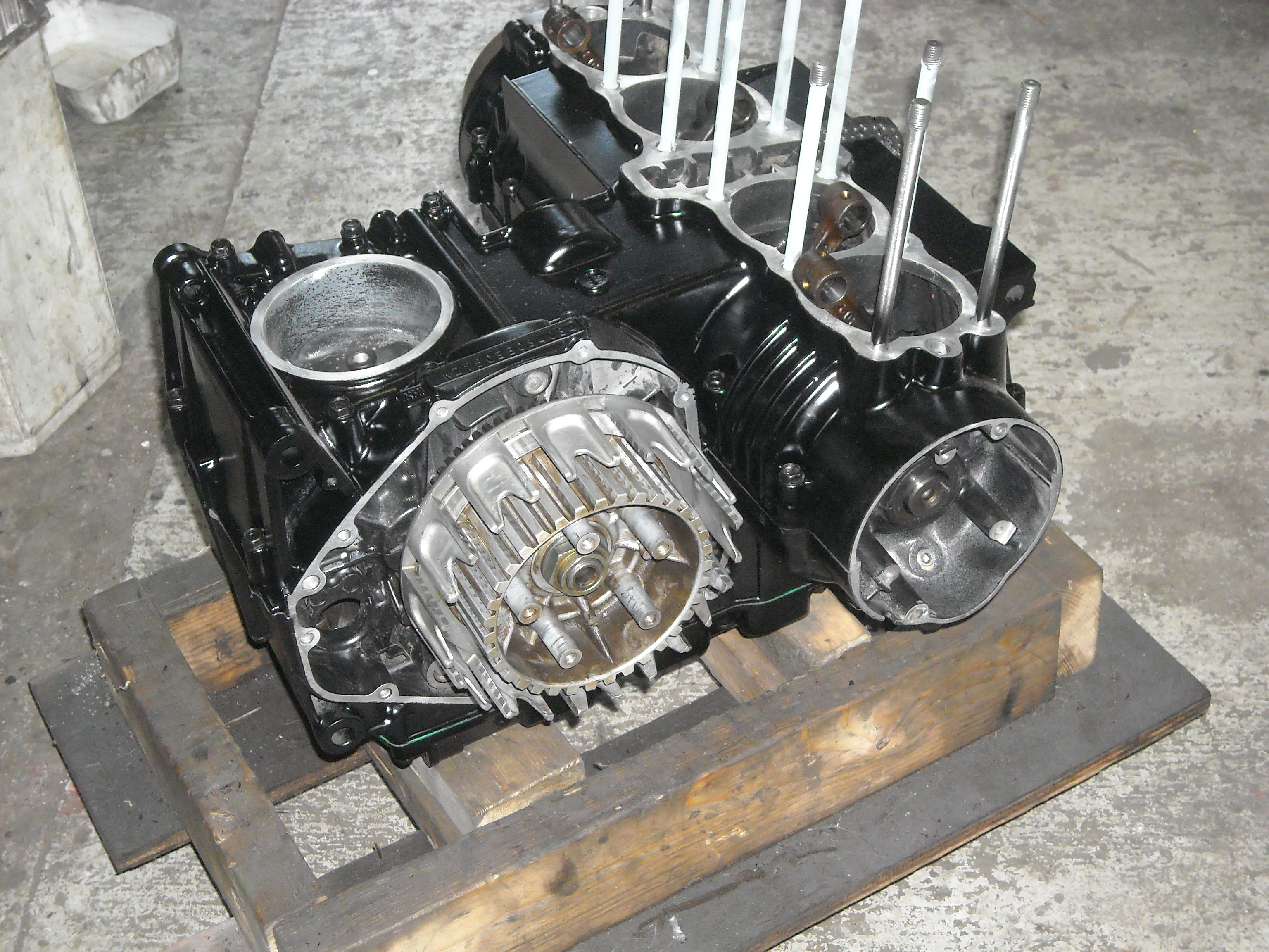

So, this morning I started the assembly of the engine.
A few weeks ago I ordered a new camshaft chain and a new primary chain. New oil seals were ordered too.
the new chains
I started by putting the new chains and new oil seals on the cranckshaft.
The assembly was placed in the upper part of the cranckcase.
the first step
The gear box was also placed in the upper cranckcase
the gear box
The gear selector with the three forks was secured in the lower cranckcase.
the gear selector
After that it was time to join the two halves together.
the joined cranckcase halves
Then I had to put the primairy axle in the cranckcase.
In that axle is the starter clutch embedded so I replaced the starter clutch to make sure it worked as it is supposed to. The eight rubber dampers of the primairy axle were replaced too.
Guys, putting the primairy axle in place is a pain in the ... for me. I'm not used to it but after some trial and error I succeeded and the oil pump could be mounted too. After that it was time to mount the oil pan and the new oil filter.
The clutch basket was installed, the engine was put upright...
and this was the result of a morning of assembling engine parts

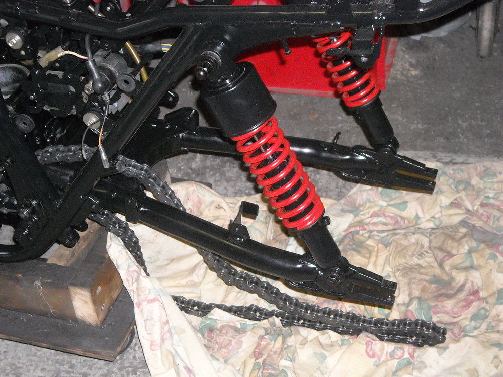

I started with mounting the swingarm in the frame. Before I could do that I had to connect the drive chain because I always use "endless" drive chains.
The drive chain was placed over the swingarm and then both were mounted.

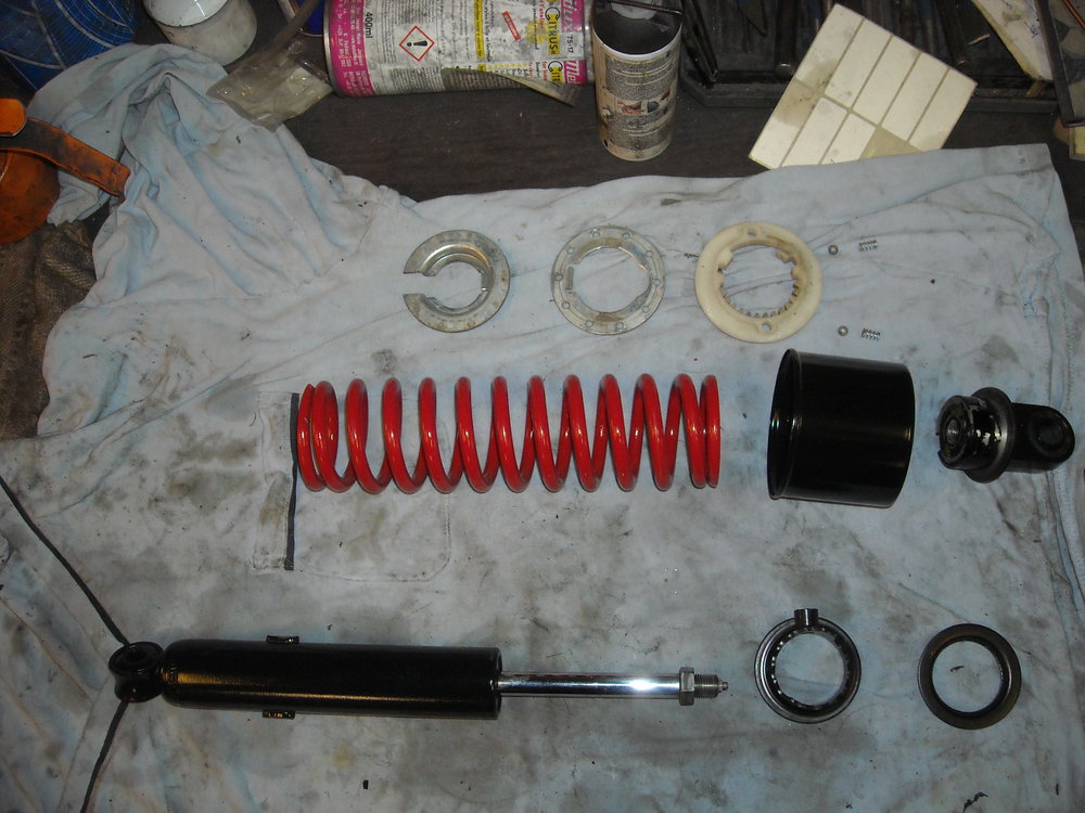

Now I had to assemble the rear shocks. they were taken apart, painted and some parts were zingued black. They consist of quite a lot of parts, see for yourselves.
the parts of the rear shock
I managed to assemble them by pressing the springs together and then mount the rest of the parts. If you do this yourself and it's the first time ever, take care! NEVER put your fingers between the upper parts of the shocks and the spring, always use a tool! If, for one reason or another, the tool you use to compress the spring would fail, you can only loose a tool, not a finger...
Anyway, this is the result.

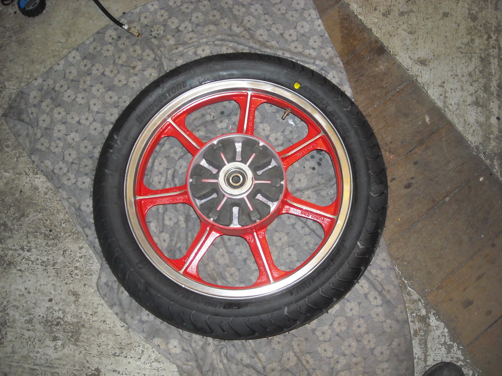

And then it was time to mount the grab handle. Now it would become clear if the measurements I took when welding the frame were correct. And yes, they were correct, the grab handle mounted without any problem!
the mounted grab handle
I decided to mount the rear wheel too. Before that I had to put a tyre on it. It went smooth and after 15 minutes the tubeless tyre was mounted.
the rear wheel with a new BT46 tyre

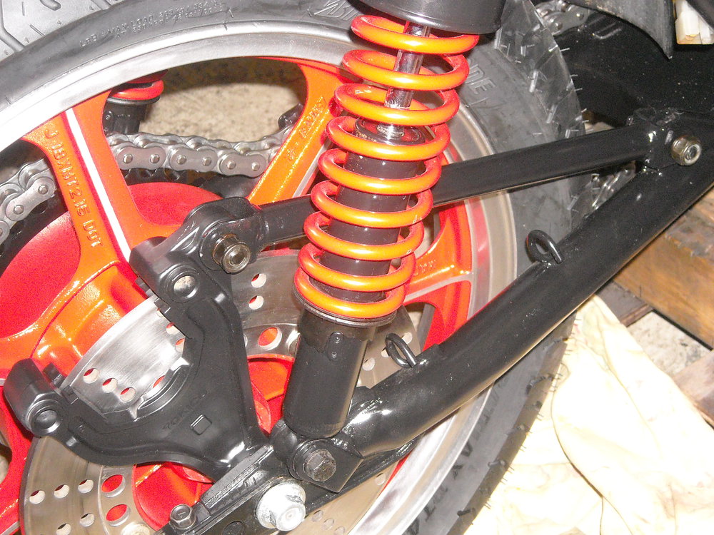

The rear disc brake rotor was mounted afterwards. If you do it before you put a tyre on the wheel, there's a chance that you cause damage to the brake rotor.
Before mounting the rear wheel, I mounted the inner rear mudguard, it's easier to do it before the wheel is in place.
A new sprocket was mounted on the sprocket carrier and then the rear wheel spindle was mounted with all the nescessary parts (drive chain adjusters, rear brake caliper holder and spacers).
the rear caliper holder
