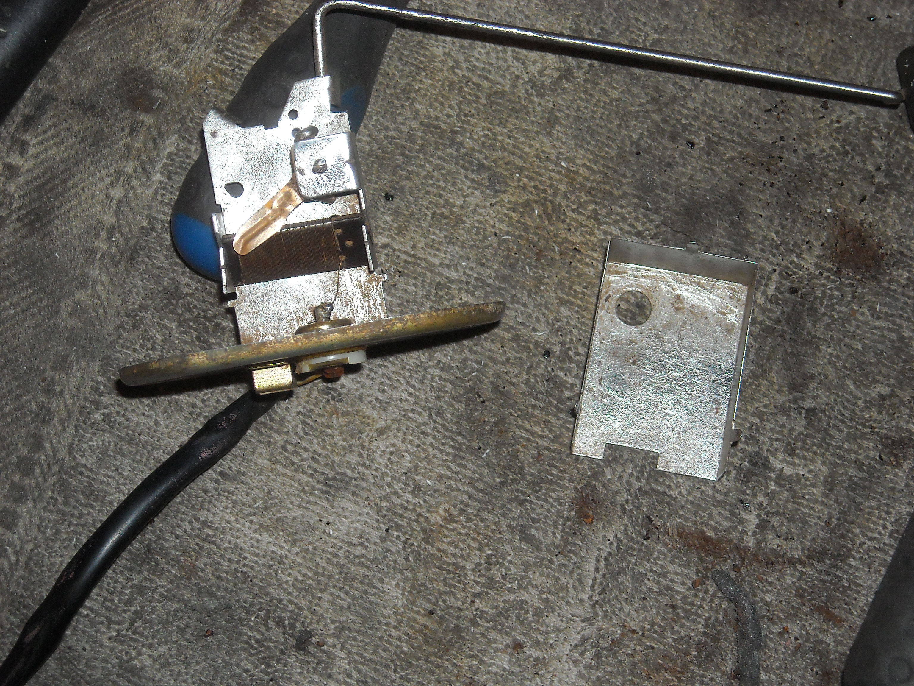

In addition to the main loom, I started to clean the fuel level sender...
This is how it looks on the inside. Rust, rust, rust...let's hope I can repair it.
That looks promising for the inside of the fuel tank...wait and see what that'll be.

The fuel level gauge is cleaned and repaired and it's working!

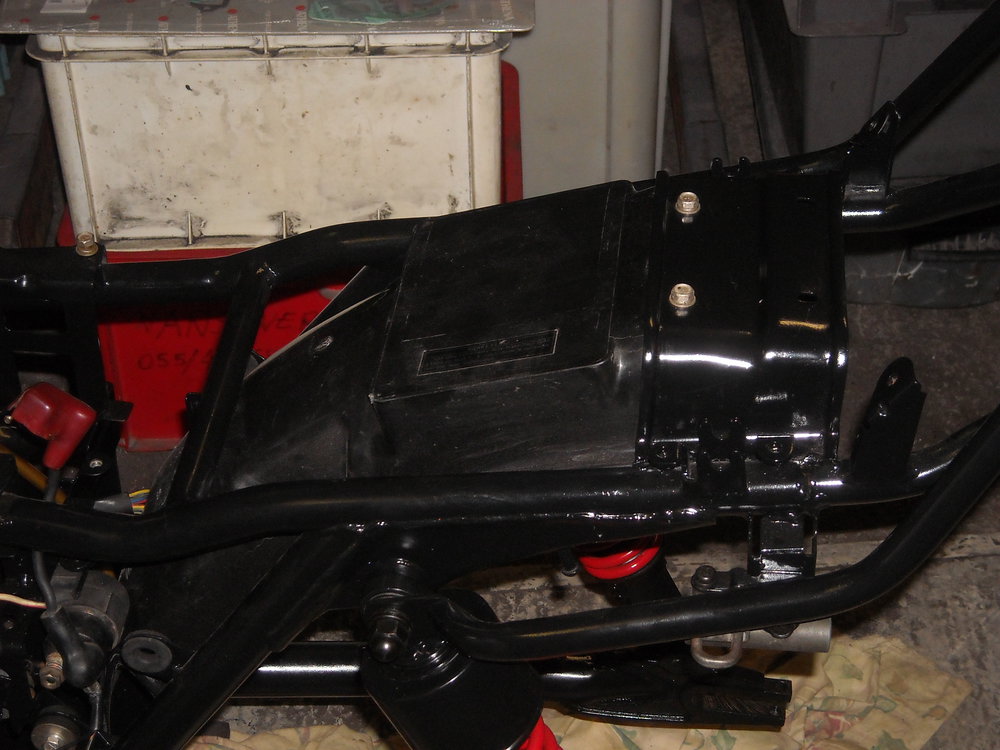

The beginning of the assembly of the frame parts has started.
New conical bearings are installed in the headstock and the lower triple tree is in place.

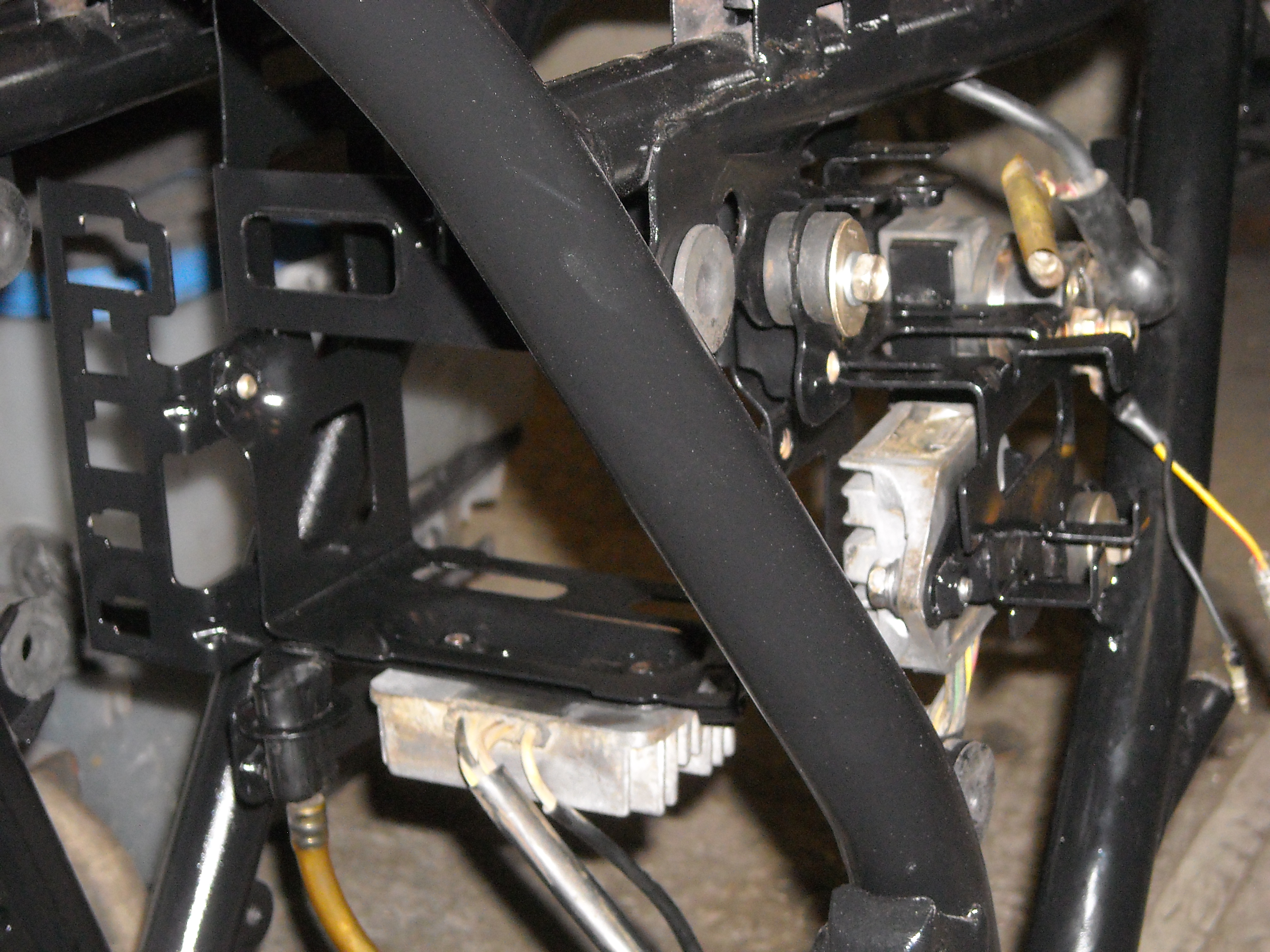

I couldn't resist to mount a few interior frame parts and started with the battery box and a few electrical components.

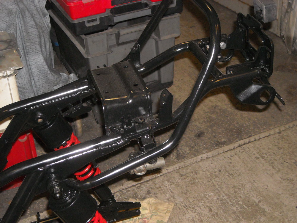

The rear part of the frame, where the taillight is attached, was also mounted.

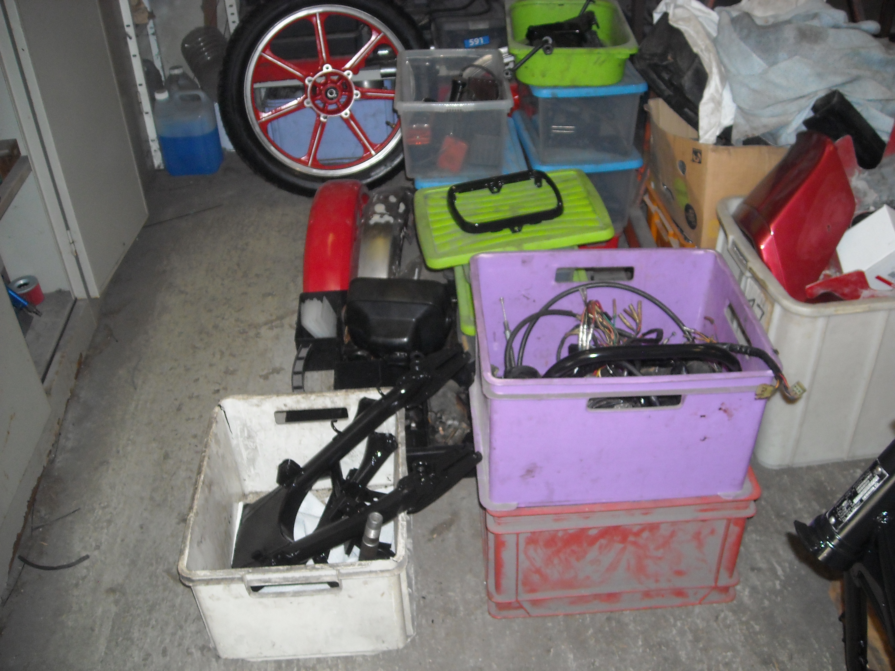

I couldn't continue because I had to wait for a lot of bolts, nuts and frame parts to be rezingued black and gray.
On tuesday I received a phone call to get the good news: the parts would be ready on wednesday and as promised, they were ready!
This is the result of the good work!
As you can see there are a lot of parts I don't need for the bike, those will be used for a next project ( a Z1000A2 during the autumn)

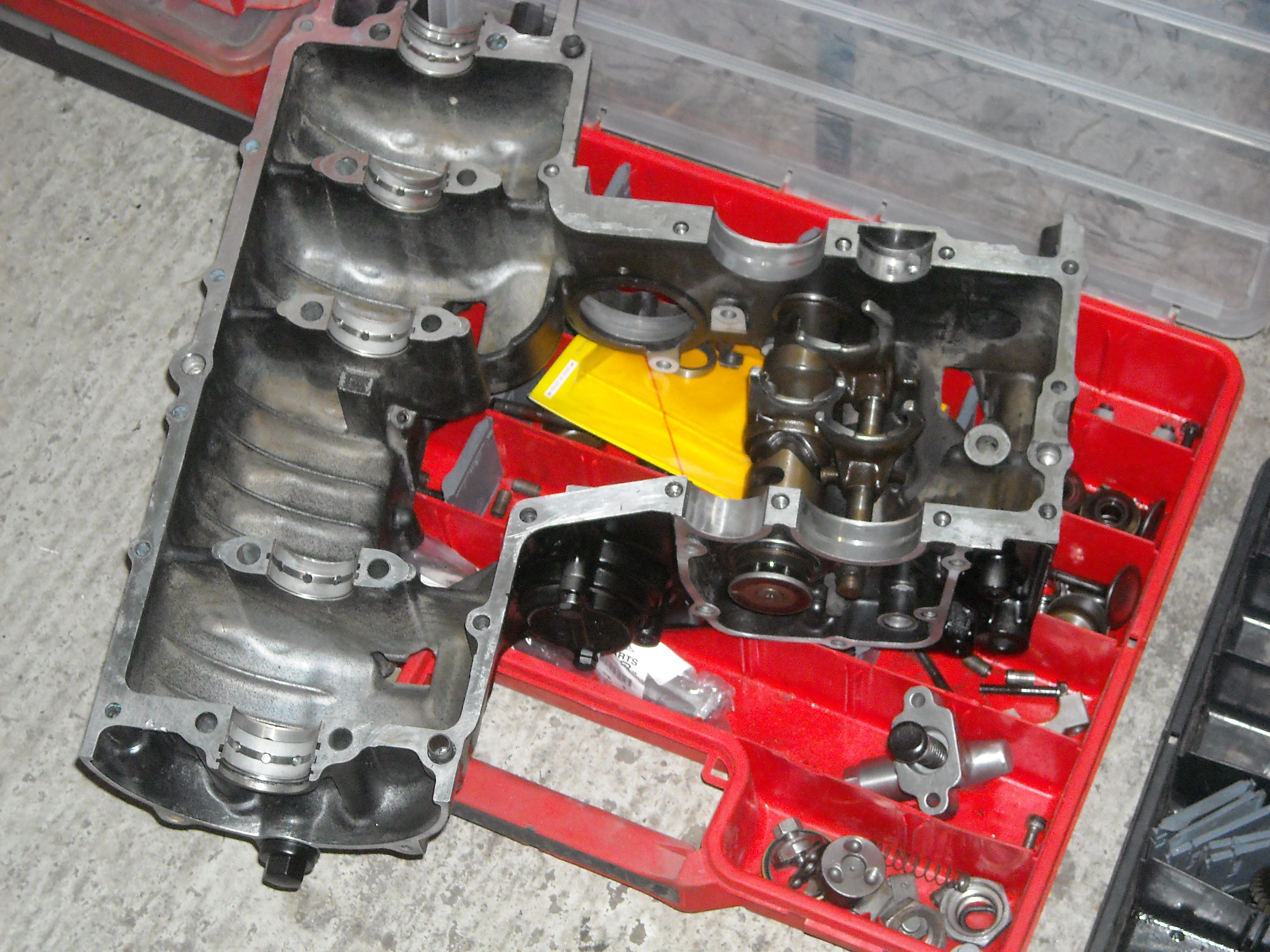

So, this morning I started the assembly of the engine.
A few weeks ago I ordered a new camshaft chain and a new primary chain. New oil seals were ordered too.
the new chains
I started by putting the new chains and new oil seals on the cranckshaft.
The assembly was placed in the upper part of the cranckcase.
the first step
The gear box was also placed in the upper cranckcase
the gear box
The gear selector with the three forks was secured in the lower cranckcase.
the gear selector
After that it was time to join the two halves together.
the joined cranckcase halves

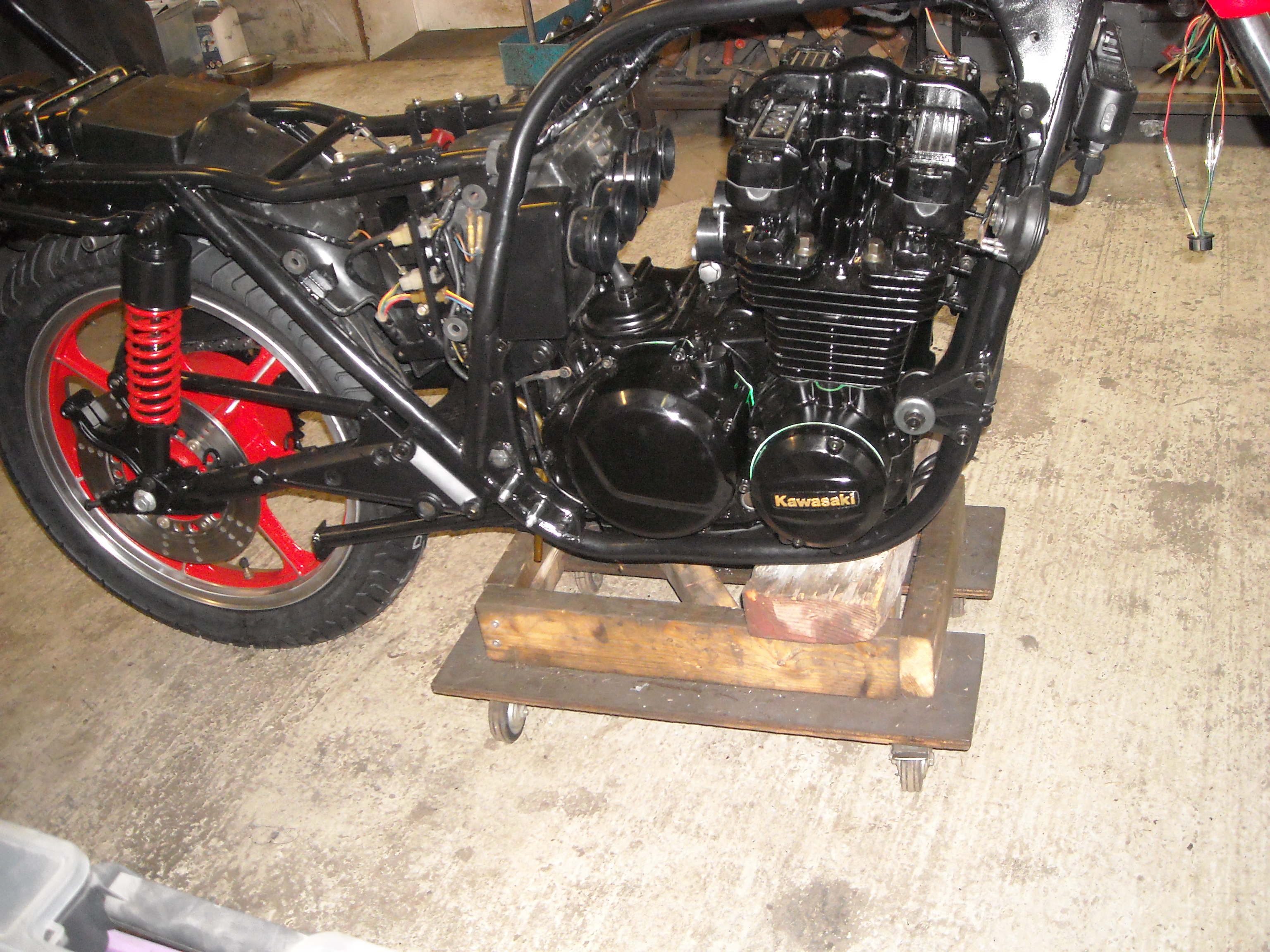

At 4 P.M. I mounted the engine in the frame and the hardest job was done.
So far, so good.

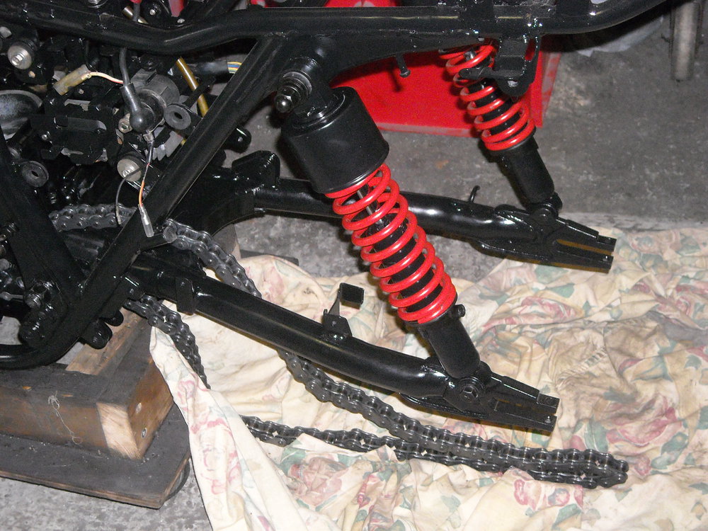

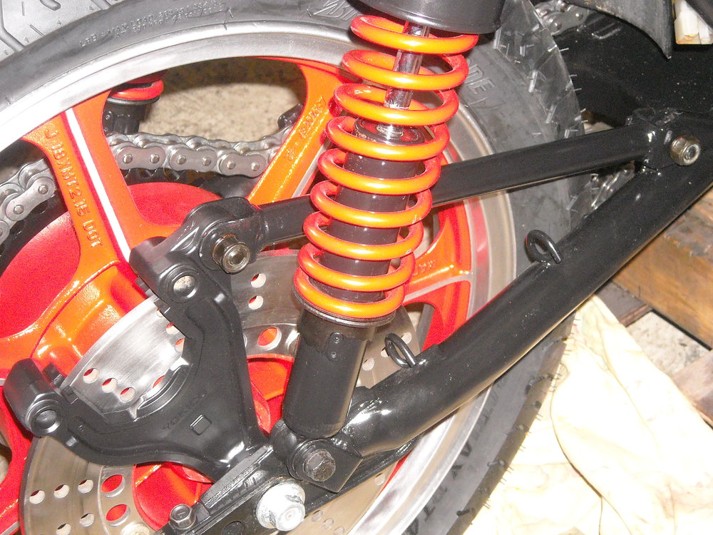

I started with mounting the swingarm in the frame. Before I could do that I had to connect the drive chain because I always use "endless" drive chains.
The drive chain was placed over the swingarm and then both were mounted.

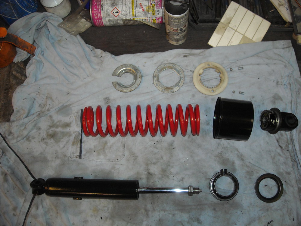

Now I had to assemble the rear shocks. they were taken apart, painted and some parts were zingued black. They consist of quite a lot of parts, see for yourselves.
the parts of the rear shock
I managed to assemble them by pressing the springs together and then mount the rest of the parts. If you do this yourself and it's the first time ever, take care! NEVER put your fingers between the upper parts of the shocks and the spring, always use a tool! If, for one reason or another, the tool you use to compress the spring would fail, you can only loose a tool, not a finger...
Anyway, this is the result.
the mounted rear shocks

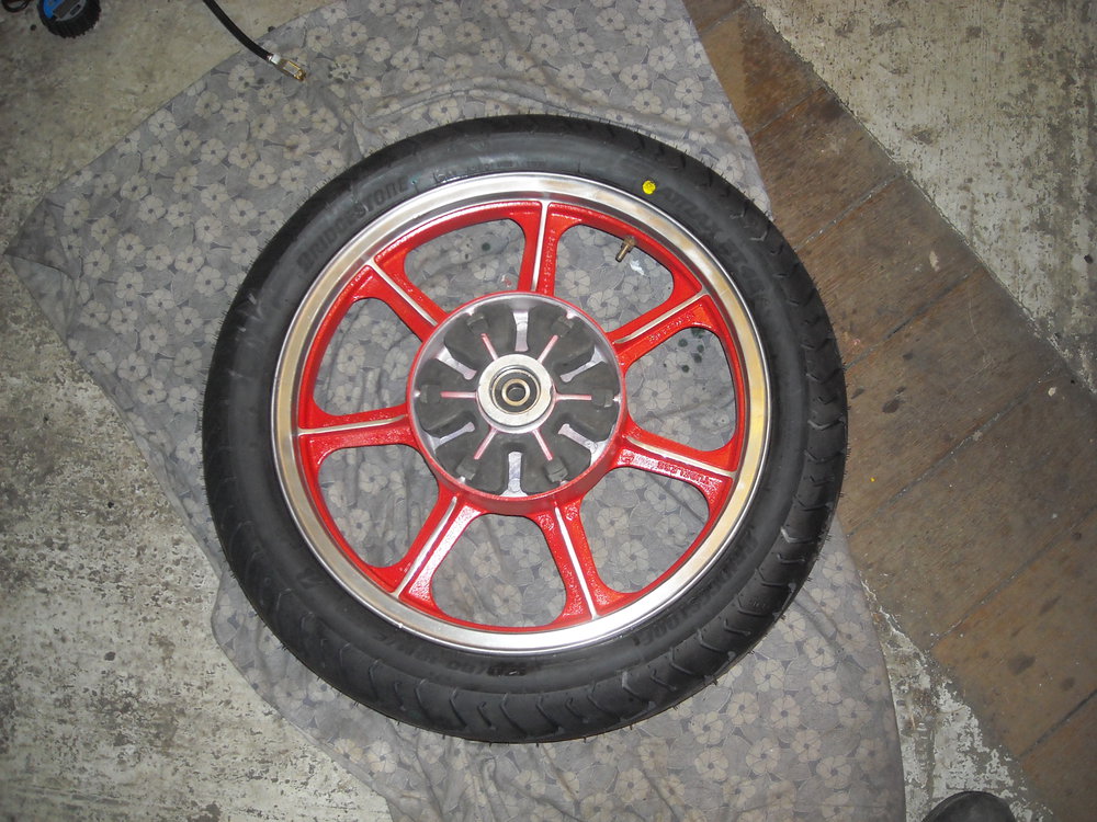

I decided to mount the rear wheel too. Before that I had to put a tyre on it. It went smooth and after 15 minutes the tubeless tyre was mounted.
the rear wheel with a new BT46 tyre
The rear disc brake rotor was mounted afterwards. If you do it before you put a tyre on the wheel, there's a chance that you cause damage to the brake rotor.
