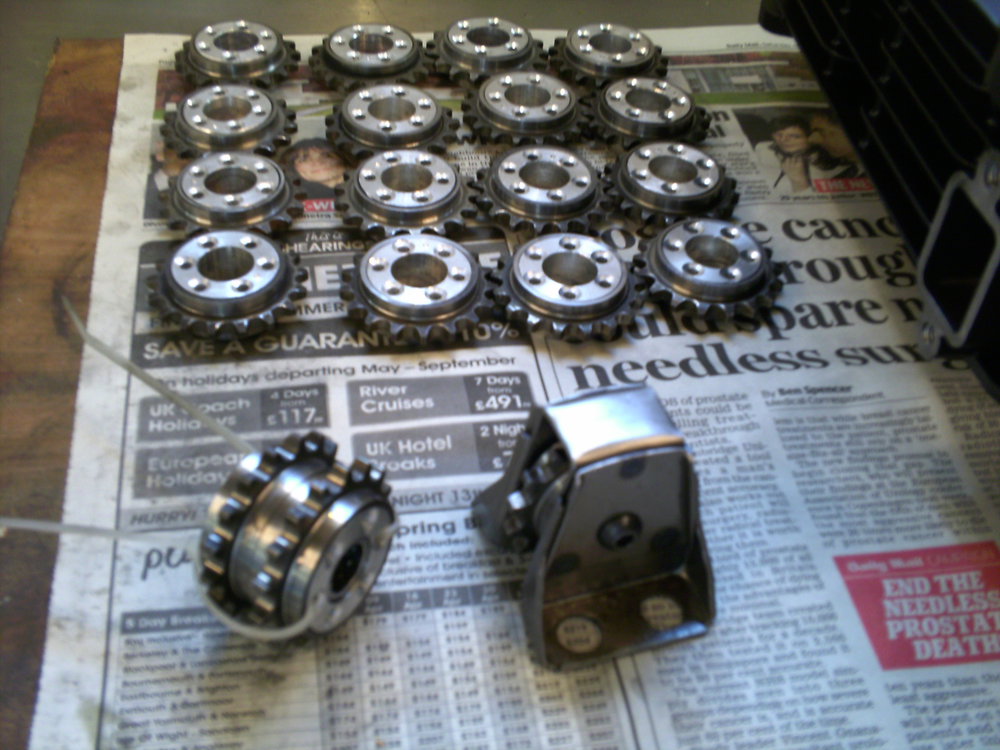

No offence intended but from a mechanical and visual standpoint that looks fairly horrific and i'm not sure if this is a joke post but i've made tons of these and unless that metal "sleeve" is a tight press fit with no peening needed in an attempt to secure it and no runout i advise against using it .
This version retains the original inner steel bearing sleeve.
And the latest just the sprocket ring on all billet alloy centers.
Neither are any noisier that stock which yours may be if it destroys itself

Hi yes the differences between yours and my solutions are the same as chalk and cheese.
Yours is a well engineered solution that will probably outlast the machine, probably designed with racing or dragging in mind where the engines are run at max on a daily basis and will easily stand these stresses.
Mine is merely a repair of an existing design, which to be fair has lasted for nearly 50 years before breaking up. The sleeve was indeed a snug fit and was made from steel seamless tube, stainless may be better but didnt have any handy. there is no appreciable run out i can detect or vibration and it has been bench run at high speed using an airline to test. Aesthetically its burried in an engine and cant be seen and looks virtually identical to original. So personally dont see that as an issue. But agree yours look far better.
My idea merely takes Kawasakis initial 95% design and replaces the 5% hard rubber centre with a metal replacement that wont break up. The peening was done to ensure the sleeve didnt move, probably not needed as it was a tight fit, also its encased in the U bracket so cannot move far. Mine will never replace yours or the originals, its merely a cost effective alternative.
From my prospective if money was no object then obviously you'd buy the better engineered solution, but in some cases the parts prices have become ludicrously expensive and far outweigh the engineering and material thats gone into them. Supply, demand and in some cases purely greed. £500 for a camchain kit, £4 for a rubber block which probably costs pence to make.
Yes i know thats why the bikes now command such high prices and as a collector thats great. But for someone who just wants to ride it, its not Why?

I made enough for my own engines i'm building .
Making them for myself is obviously a lot cheaper in materials than buying APE or Liska etc but for the time it takes on a manual lathe there wouldn't be much in it trying to undercut the mass produced stuff.

Thanks Mick, incidentally i did look for new roller bearings just in case. However i measured the shaft as 11mm therefore int diameter should be the same no one seems to do them you can get 10mm or 12mm but not 11mm have phoned up 3 local bearing places they all say the same which is strange where do you get yours from? They are 14mm wide, the outside size depends whether you go to the start of black plastic part or all the way to the cog part? There is no numbers or wording stamped on the bearing either
Posts: 4040
Re: Kawasaki Z1/Z900 top cam roller DIY repair guide
#14 PostAuthor: zed1015 » Mon Feb 27, 2023 11:37 pm
Gray17 wrote: I measured the shaft as 11mm therefore int diameter should be the same no one seems to do them
The bearings they used are not metric but imperial.
They are 7 /16" id (11.113mm ) x 5/8" od (15.875mm) x 1/2" w (12.7mm )
Here's a link to some on ebay.
https://www.ebay.co.uk/itm/273088939663
