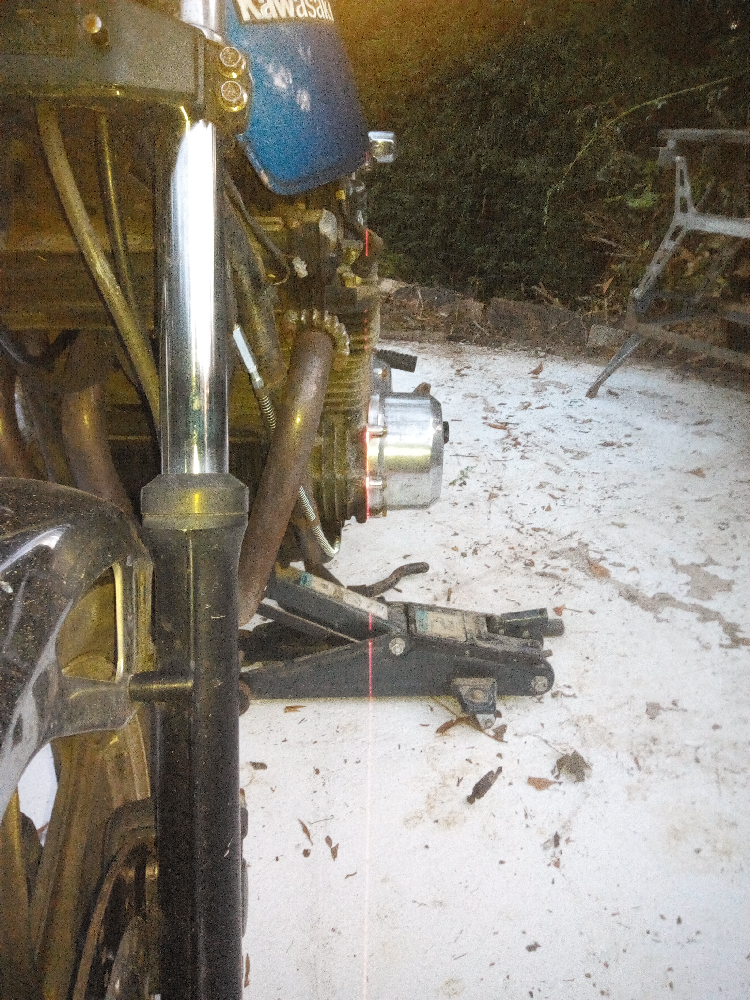

Yeah, to ensure the engine is veticle I just hang a plumb line off the middle front cam cover bolt and you will see if its veticle or not as the line should be equidistant left and right from multiple points on the barrels and top and bottom crank case cooling fins.
Re: Twisted but where?

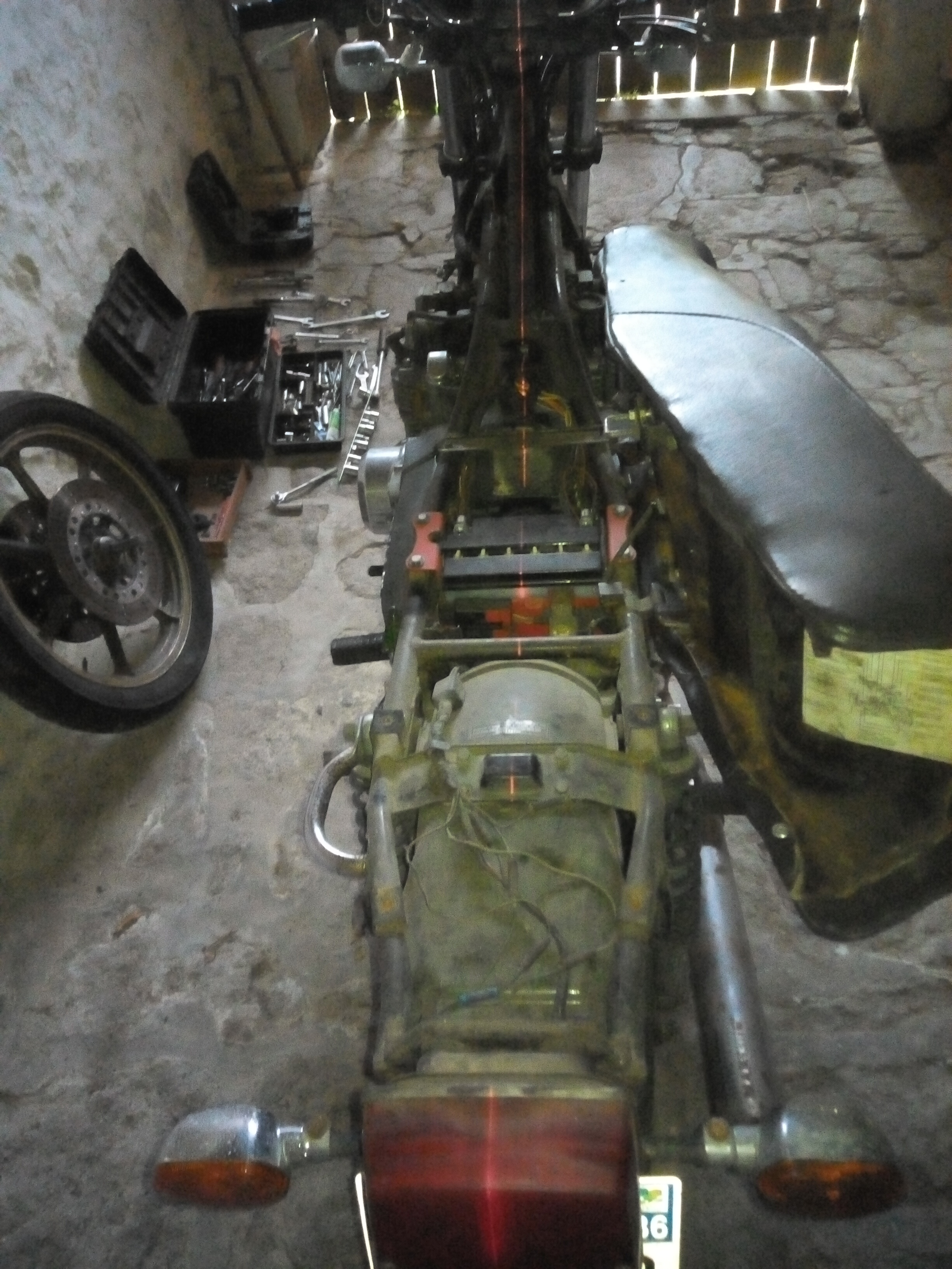

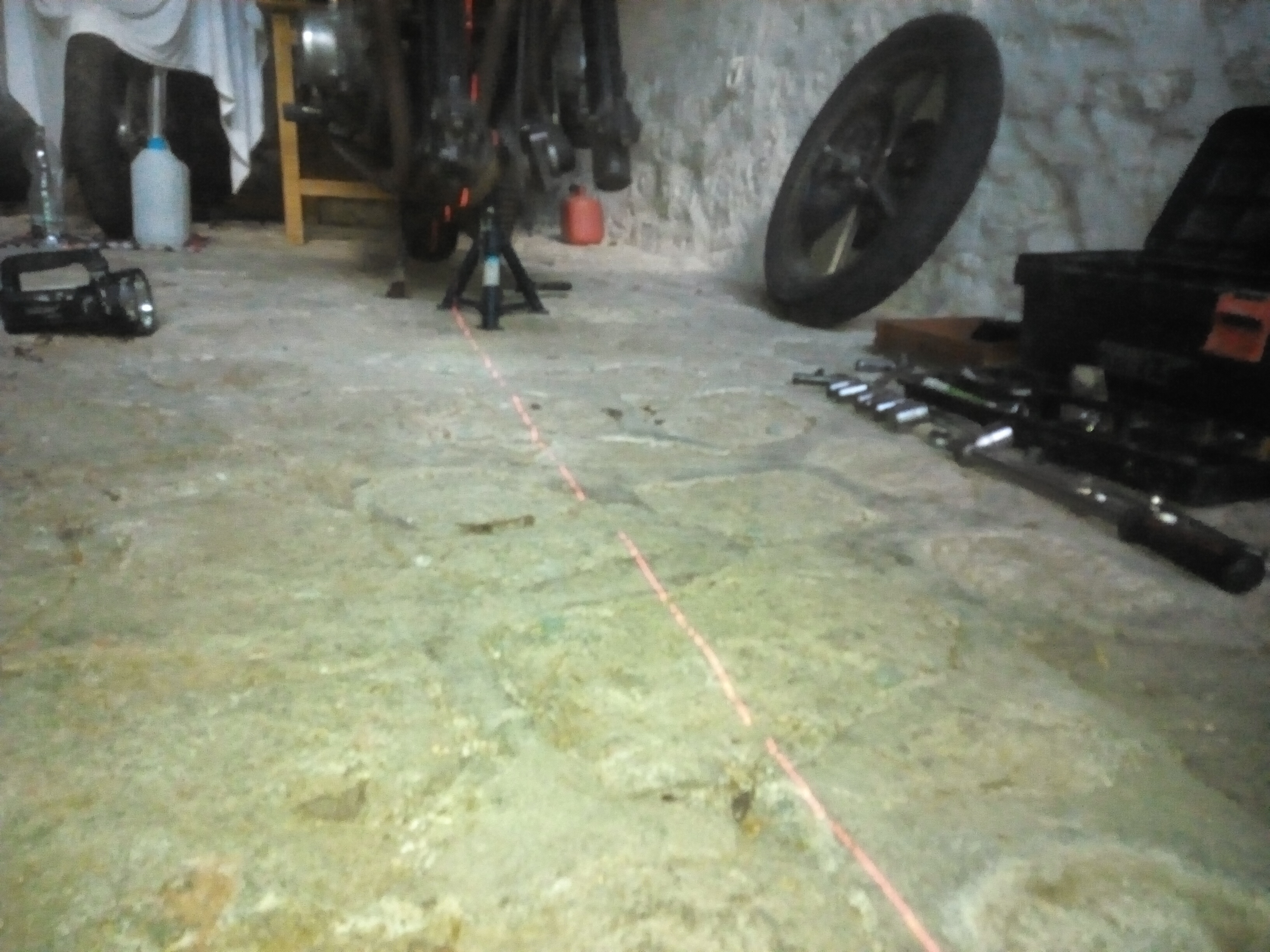

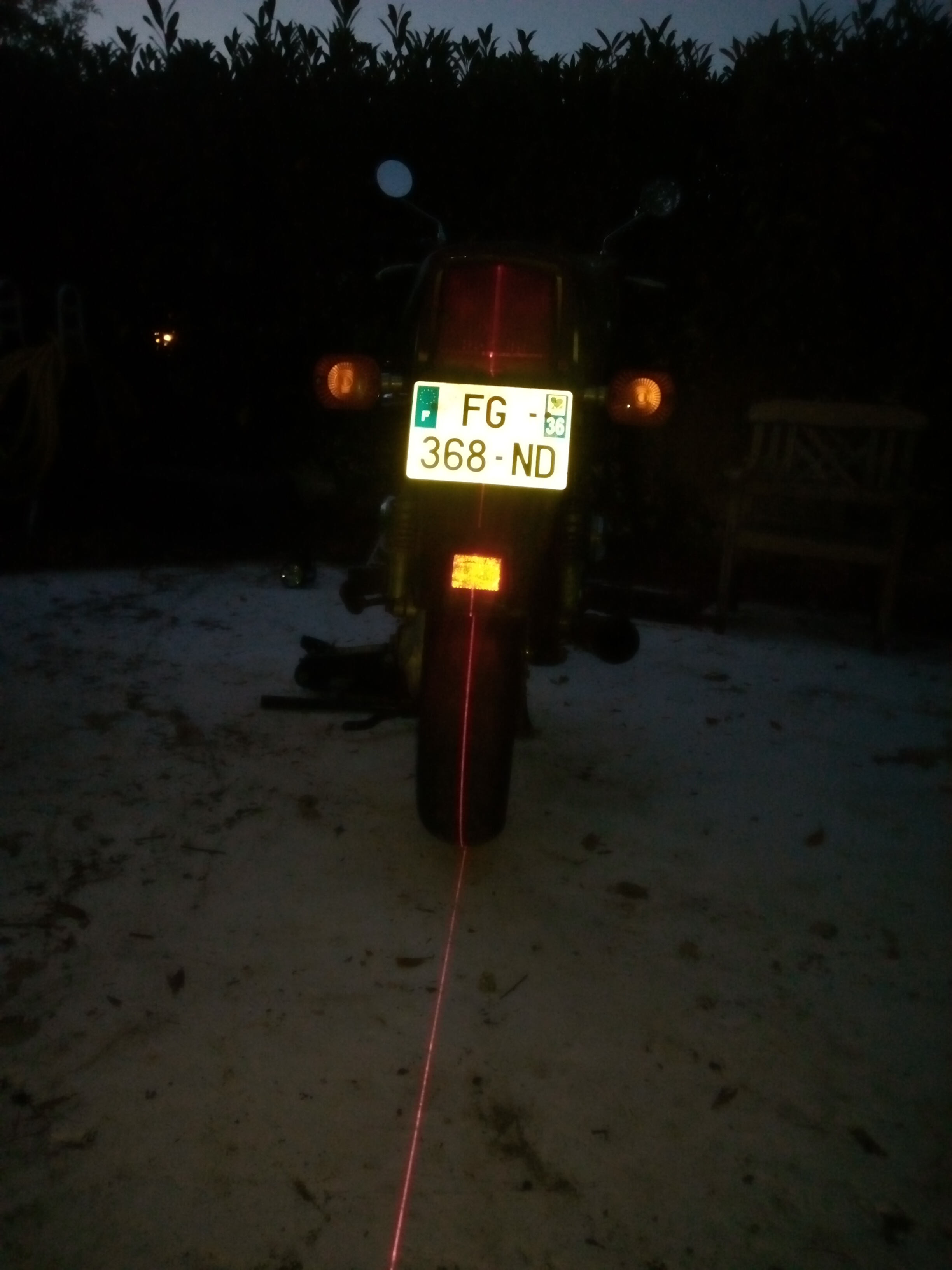

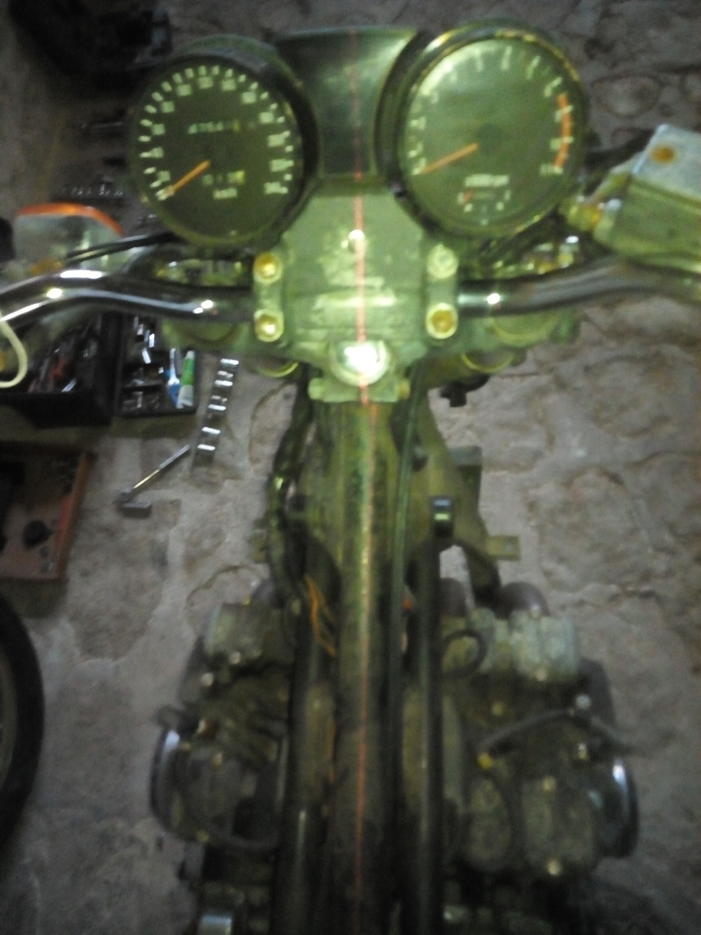

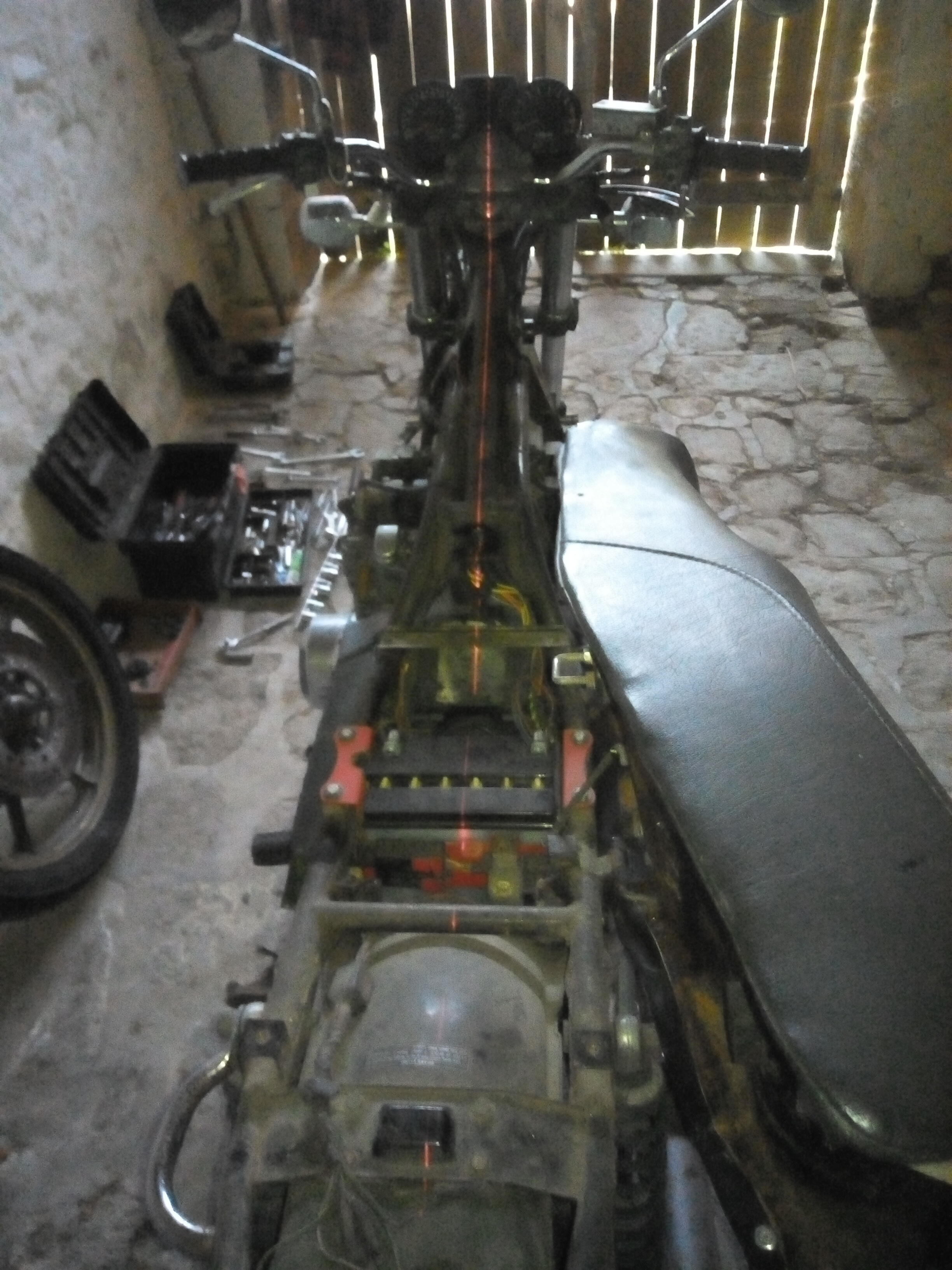

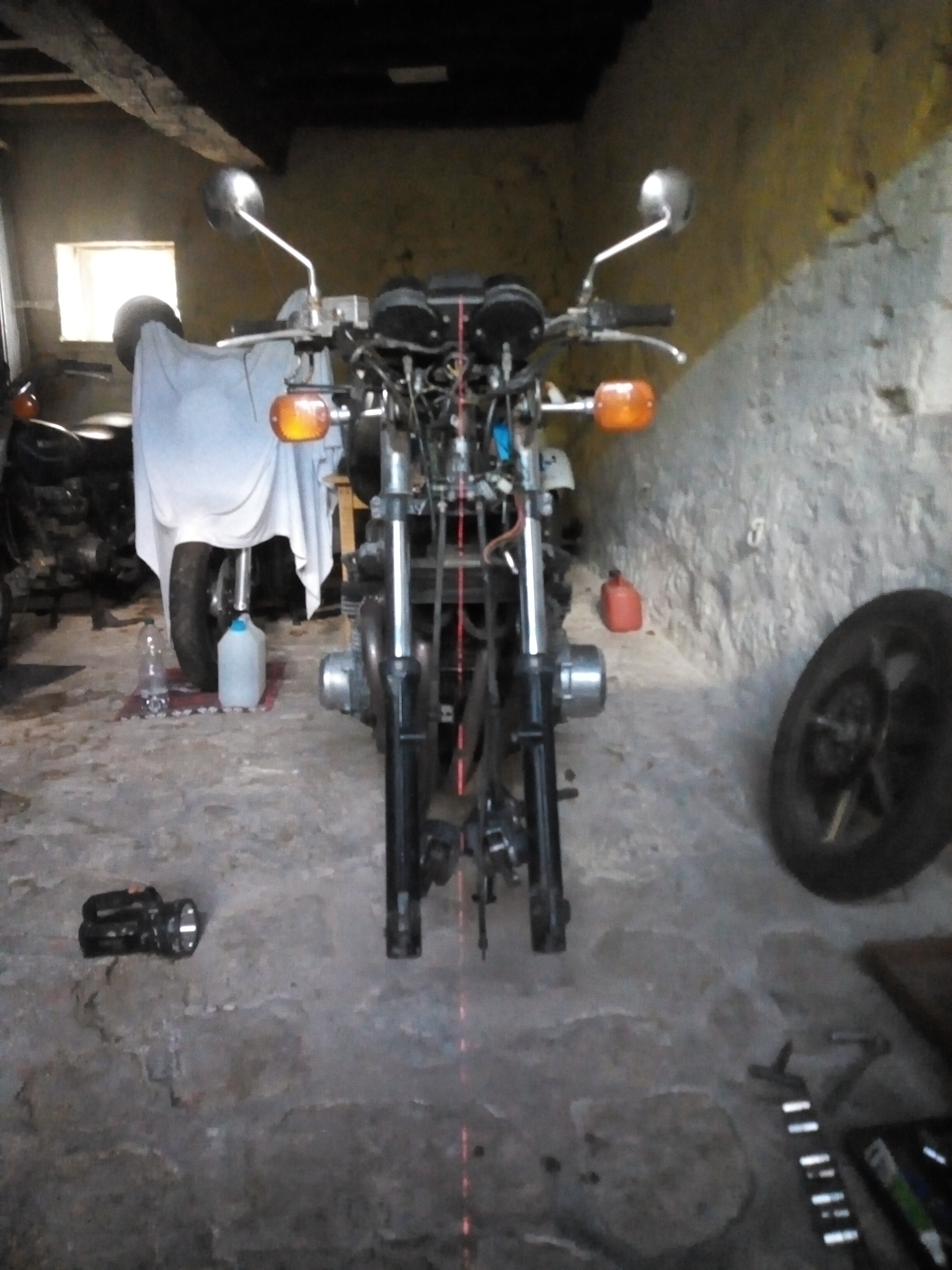

Did an initial check in the garden on a concrete pad. confirmed verticalness of engine.
Then checked the rear wheel
Needed to check the front end, partially stripped to moved it into the garage
Check on the rear wheel from the front
Than ran the laser down the spine using the headstock and front tube as a datum looking at the
rear
Then the reverse using the rear of the frame to the petrol tank rear mount/bolted on cross brace as a datum
Close up of the headstock from th e last test
So it's fooked.

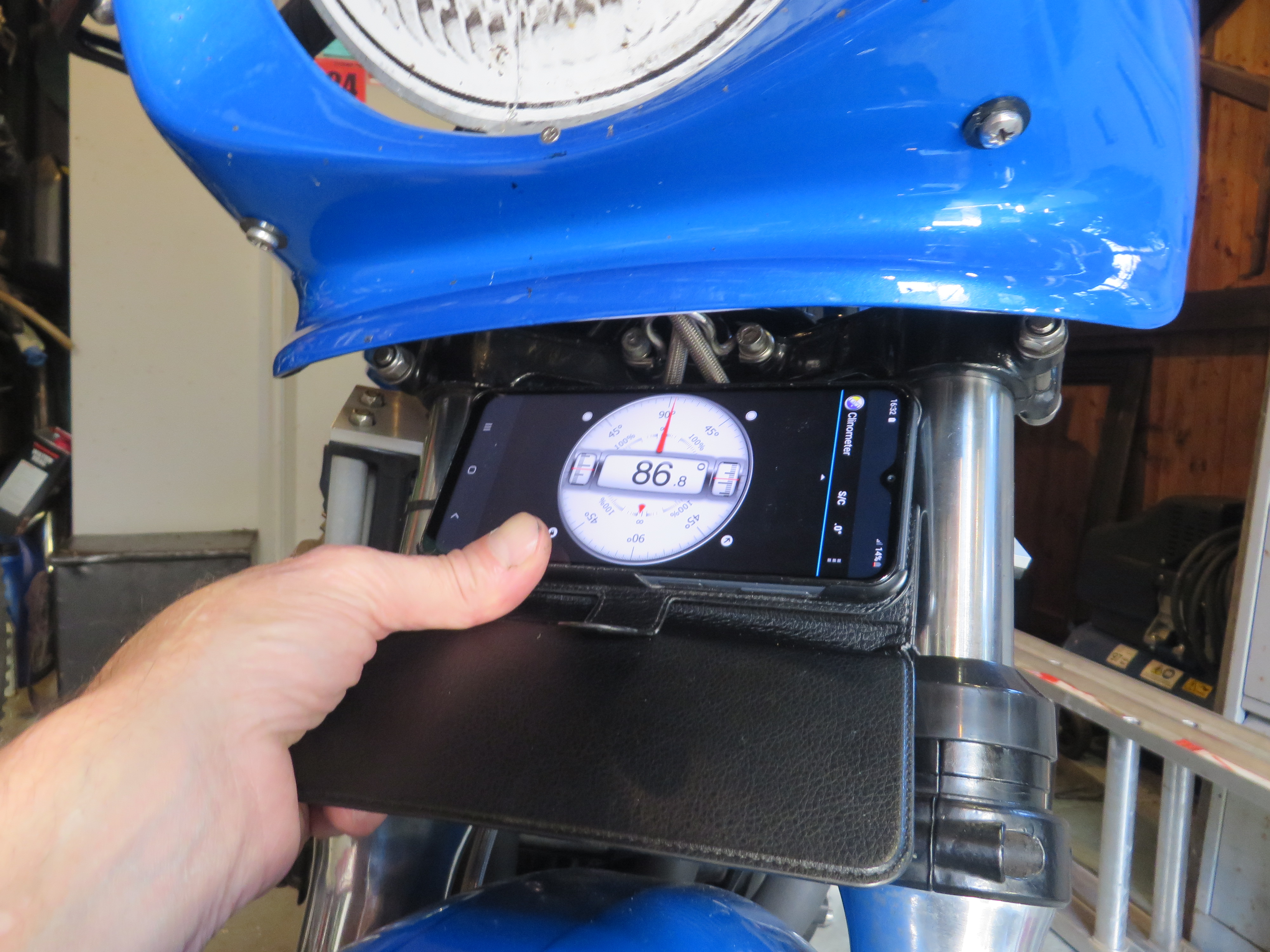

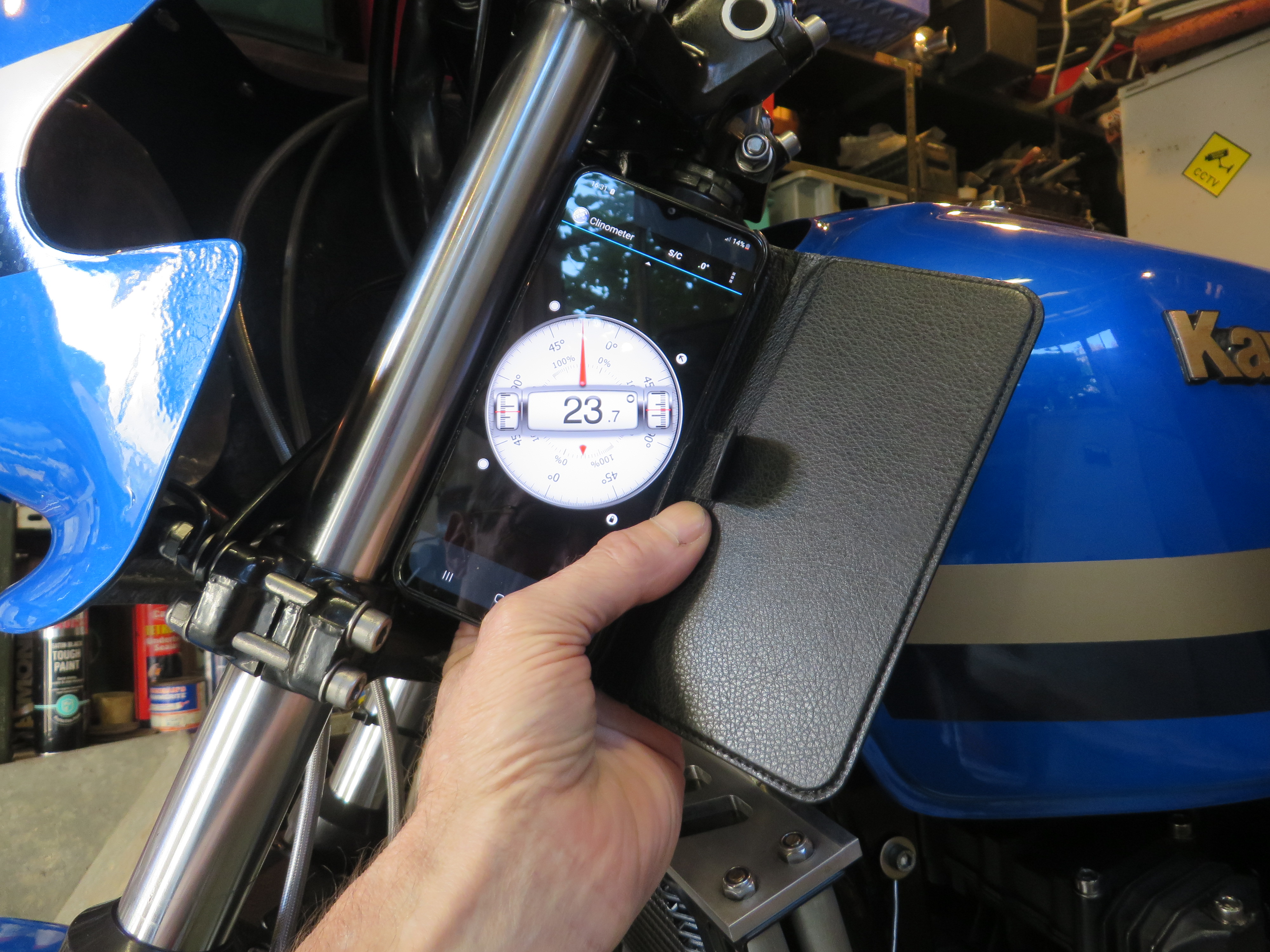

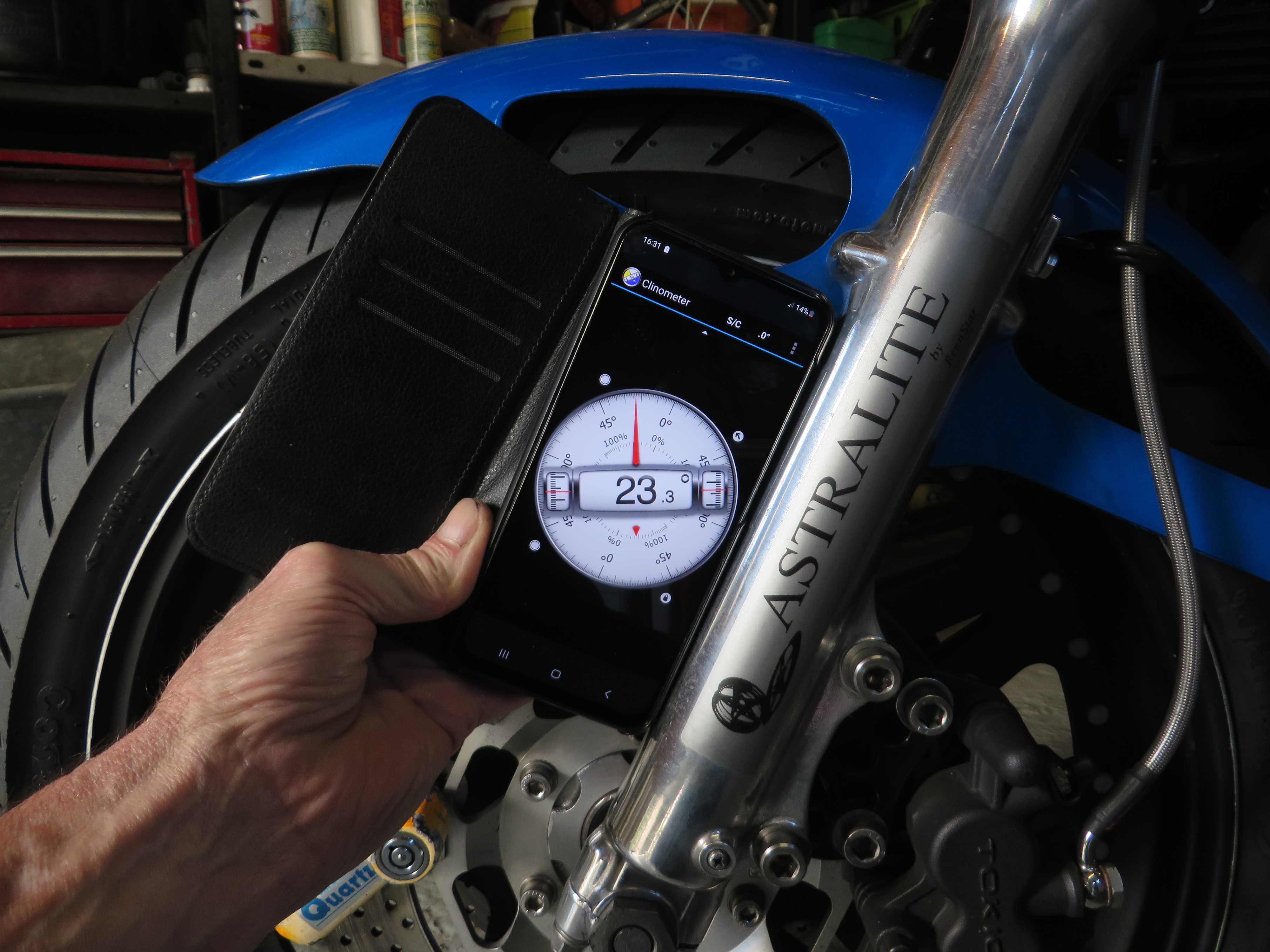

Hi, Pete i have straightened out two at home. Mine and an 1100R. I would offer caution when using the engine position as a datum for any measurements as neither of the two i mentioned where anywhere near correct when first measured.
Dont know if it helps by i use the free clinometer app on my phone for both bikes and for building car bodies. Its very good and very versatile.
Ignore the readings its sitting on its side stand.
I use a short spirit level just because its a convenient straight edge; horizontally off the front engine mounting structure, sticking out the side and again on the side of the wheels. Put the phone up against this to read whats what.
You should be able to detect a discrepency between the front and back wheels if all not well.
I have straightened a big bend in the back of mine once with a massive piece of 4x3 and another with the portapower at work!
