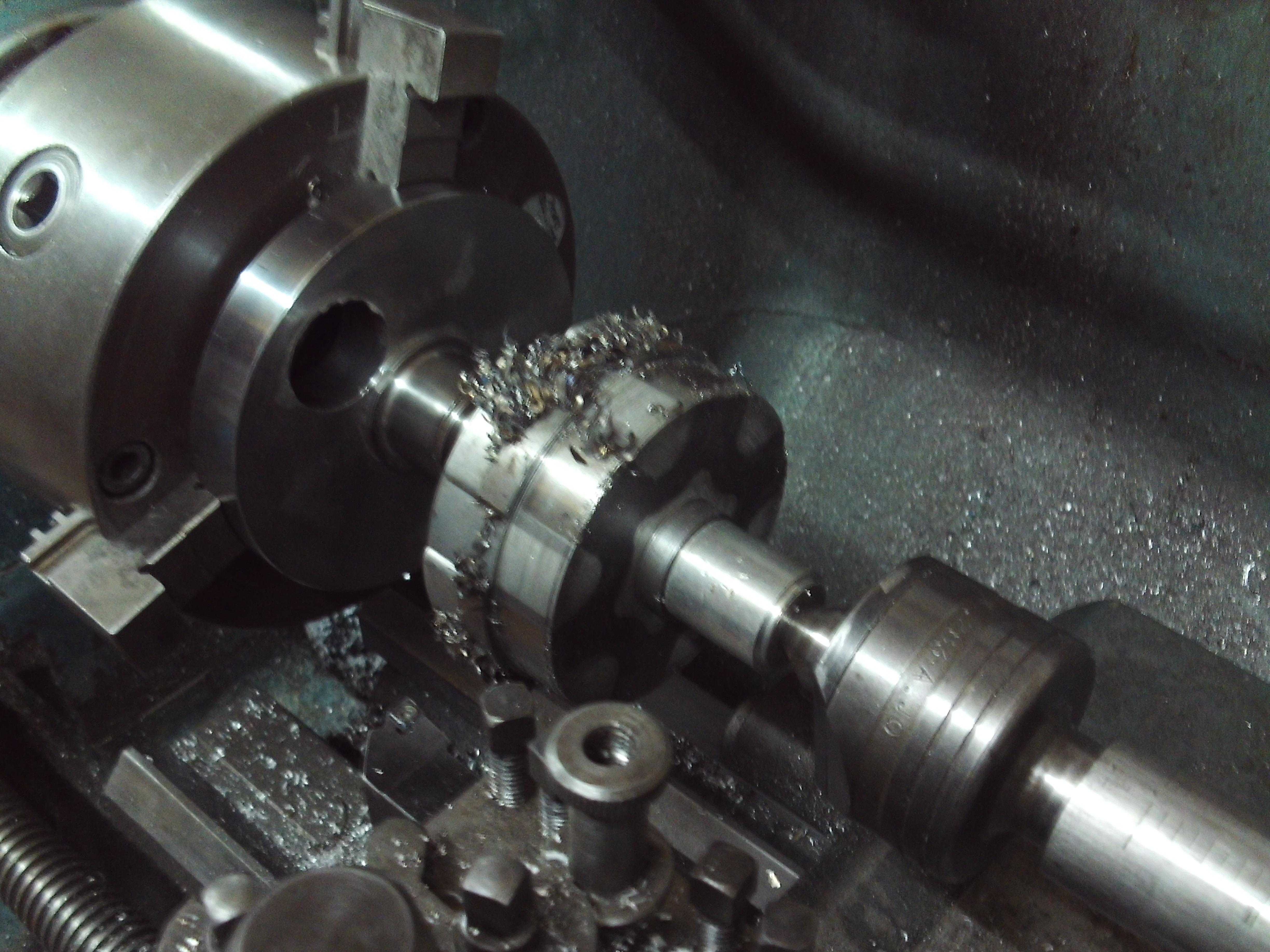

I'd bought this Electrex race alt for the turbo build which allows the use of a starter motor and decided i wanted to use it on the Racecrafters if my plan works out (and if it does i'll get another one for the turbo).
Unfortunately they only do a version with a rotor that fits the later MK2 and J/GPZ large taper keyless cranks which is fine for the MK2 item in the turbo but not for the early 900 crank which i'm using in the Racecrafters that also has a woodruff key.
I had the idea that i may be able to extract the key slotted steel hub from a duff 900 rotor and devise something that will take the electrex rotor and original starter clutch to convert it for use with the small taper crank .
I started by using a worn rotor that had rattled its core loose.
And used the end web from a damaged small taper 1000 crank clocked up in the lathe to mount it.
Which enabled me to machine off enough unwanted material until i could expose the magnetic core and remove it.
Once the magnet was removed it just needed the remaining cast aluminium that encased it machining off so i could see if there was enough left of it to work with.
Luckily the gamble paid off and there was just enough meat left on the irregular shaped steel hub to allow it to be squared it up straight and leave plenty of wall thickness to the internal taper and key slot.
This left a 26mm diameter shaft that needed enlarging to 36mm with the addition of a tight fitting steel sleeve.
Which was fitted courtesy of a few tons of force in the hydraulic press so no chance of anything moving at high rpms.
And then once clocked back up in the lathe was turned down to the correct size.
Job done for now and very pleased that it went more or less as planned and is begining to resemble the Electrex rotor mount on the right.
Fits like a glove.
I've left the original hub full length for now and the rotor is sitting around 10 to 15mm further out than where it will end up as i need to correctly align the rotor and windings for maximum output when it comes to the final fit
( Which is more than Electrex manage to do with them :roll: ).
I'm also hoping i can retain some if not all of the internal threads for the extractor bolt once i've worked out how much clearance there is to the outer case and if there's any scope to gain a little more if needed .

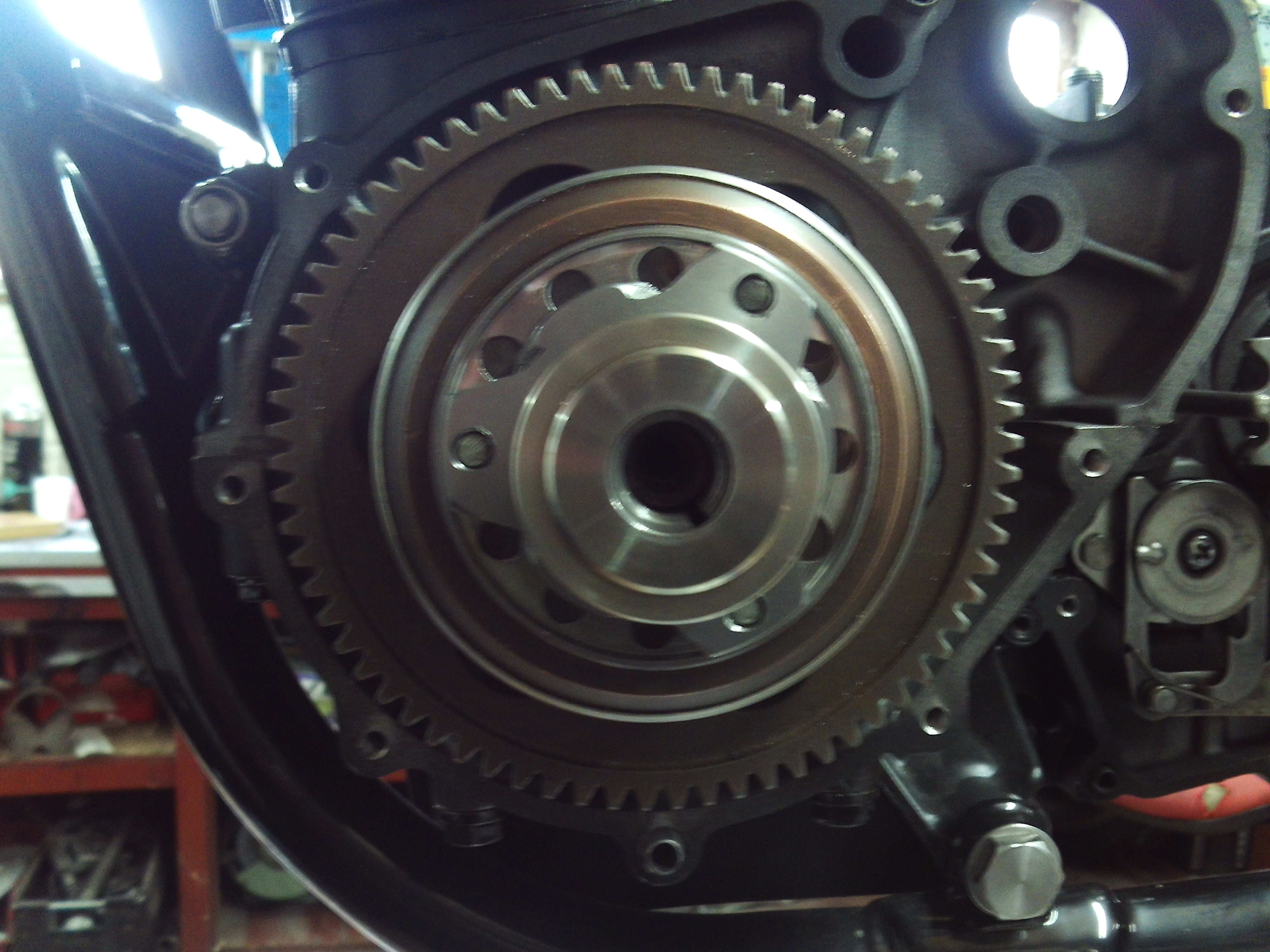

Now that the rotor hub has had all the cast aluminium removed it's diameter is a few mill too small to accurately center the starter clutch so i've had to come up with this steel spacer cup to make up the difference.
It's a very snug fit and is securely sandwiched between the hub and clutch when the three bolts are fitted.
And once test fitted i've also managed to do some measuring and retain the extractor threads which just needed 2 millimeters trimming off the end .
For the retaining nut to just clear the inside of the alternator case.
With no gasket fitted.
The next job is to work out how far inboard the rotor needs to sit for it to centralise its magnetic field to the windings .
The only fly in the ointment is that the hole in the rotor is just over 6mm smaller than the 26mm portion of the hub that contains the extractor threads and is preventing it from sliding on any further.
I didn't plan on modifying the rotor and i really don't want to loose the extractor threads but one or the other will have to give when the time comes.
Depending on how far the rotor needs moving and if there's enough clearance between the back of the windings and the starter clutch it may be possibly devise an alternative extractor mounting that uses three extended bolts for the starter clutch or something similar. :fou .

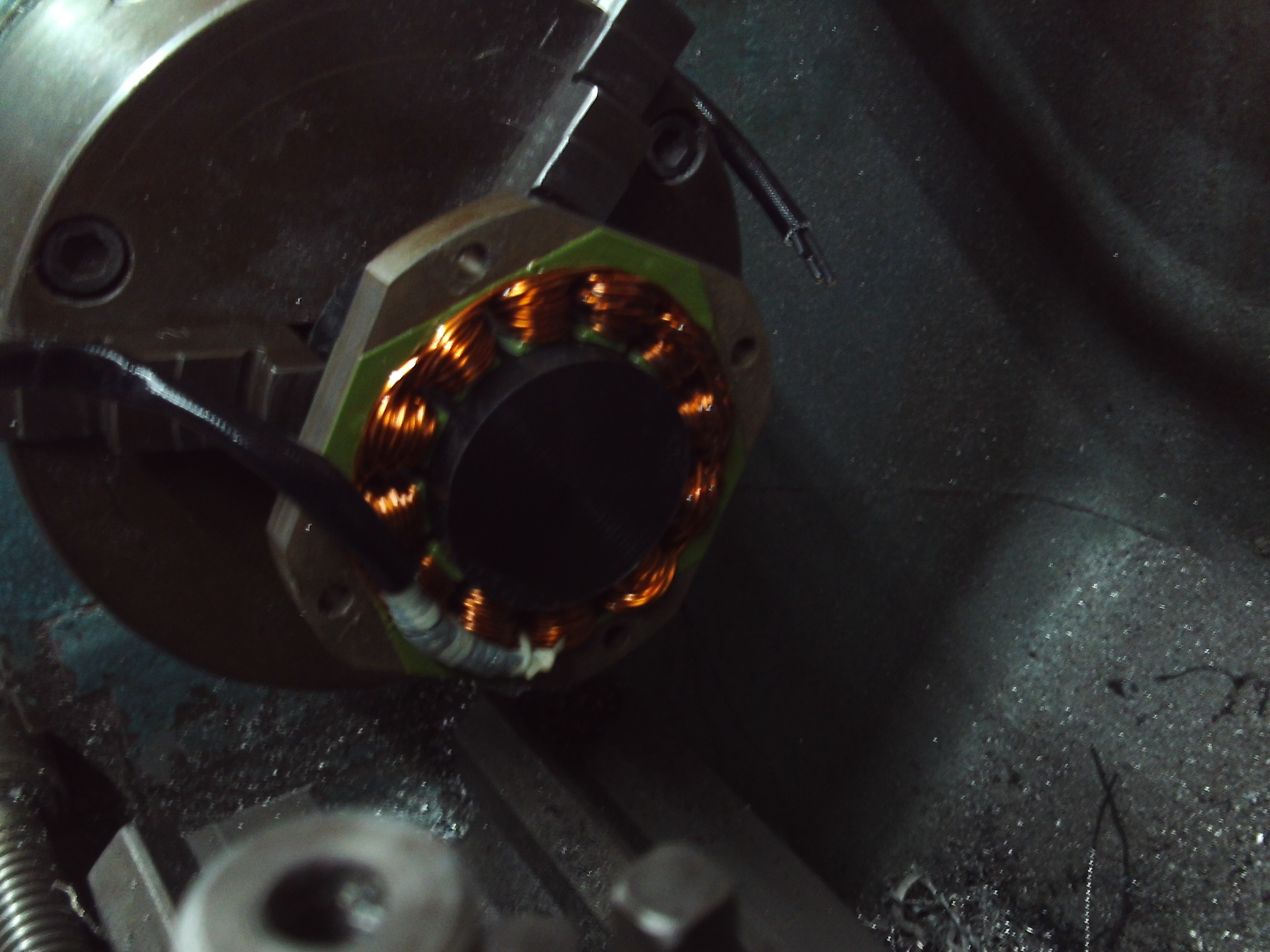

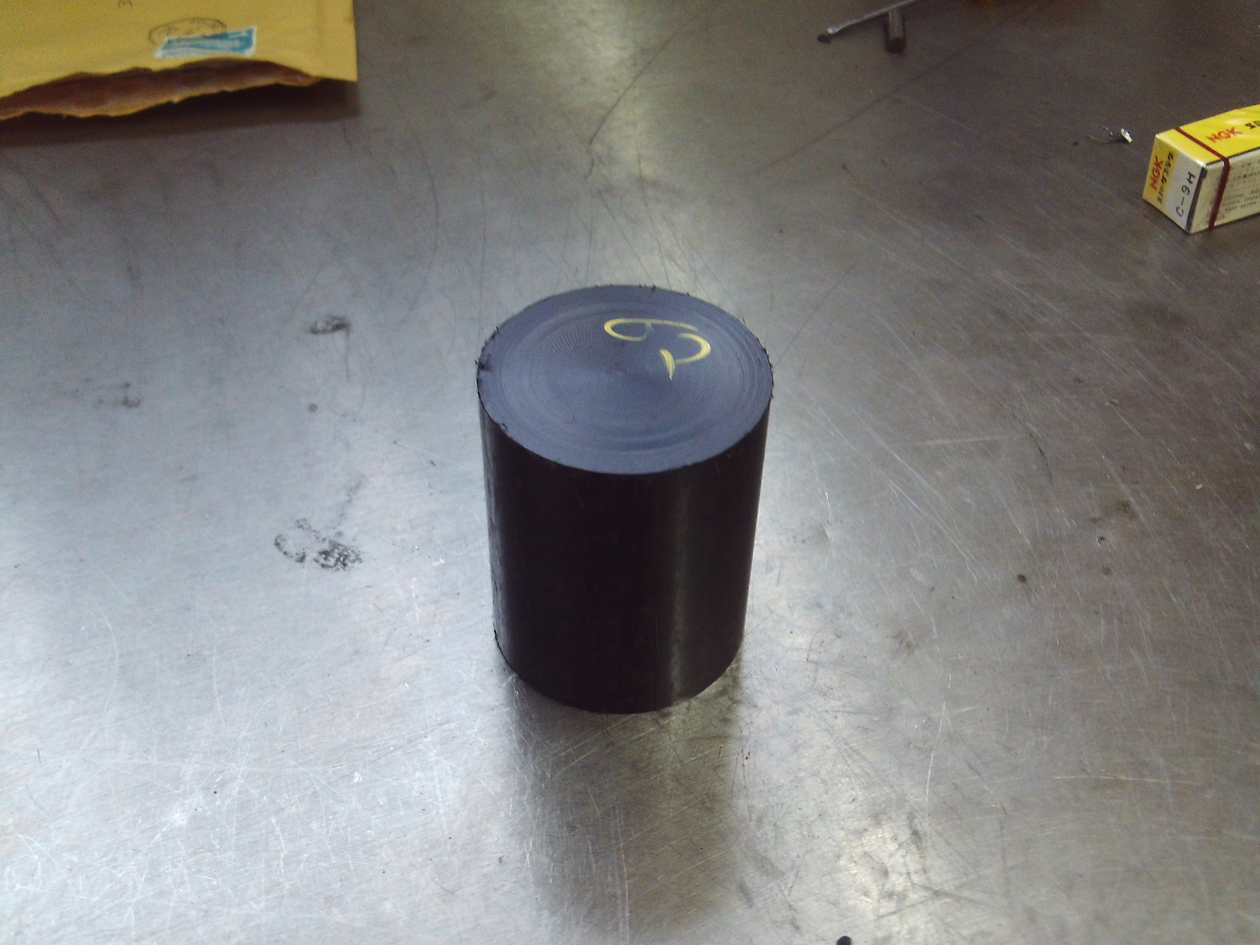

The postie delivered this piece of 50mm dia Acetal bar yesterday so set about working out the rotor and winding alignment measurments this morning.
Started by machining the outer so the windings just slip on.
And then bored the inner to take the rotor which has left a wafer thin shadow of its former self.
This takes up the small 0.46mm running clearance and allows the magnetic rotor to slide in square but prevents it canting over and sticking to the windings .
Which then enables the rotor to float freely and centralise the magnetic field.

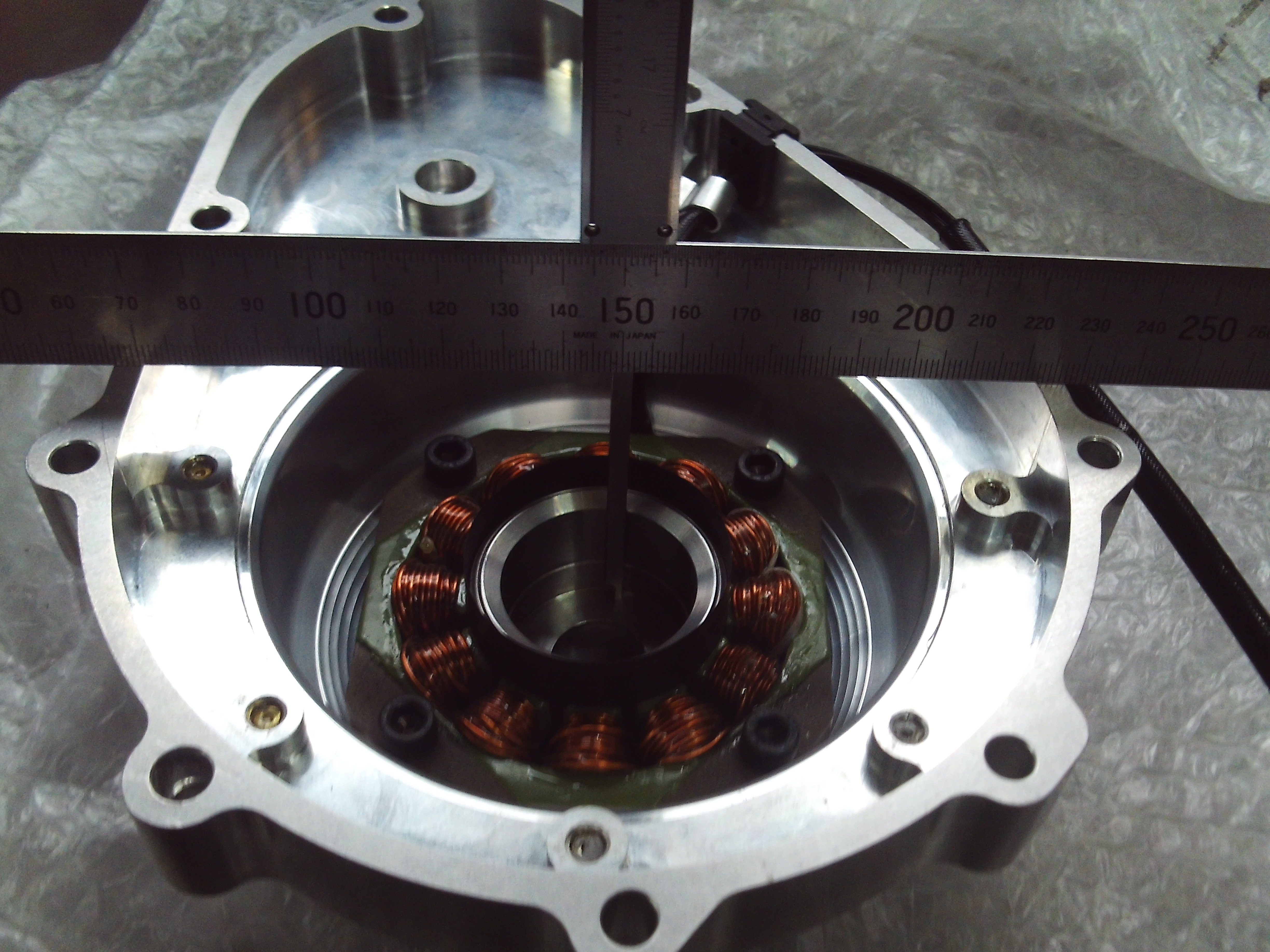

So that i can measure from the face of the cover to the inner face of the rotor which is 63.60mm once the 25mm width of the steel rule was subtracted..
A measure from the face of the wide portion of the rotor hub to the engine case came up with exactly 65mm and accounting for the 0.5mm gasket means that there's just 0.9mm i need to skim off the hub for perfect alignment at the next workshop session..
Out of curiostity i set up the rotor on the turbos large taper crank which this alt is originally for and now knowing the distance of the rotor in the case i could work out how accurate this kit is if it's just bolted on as intended.
No big surprise now knowing electrex's attention to detail and accuracy from the previous alt i fitted to the alloy cafe ( which was 6mm out and killed the battery ) that this one is a good 4mm and a bit out of line inboard and would require a spacer under the rotor to achieve maximum output so something certainly worth checking before fitting one.
