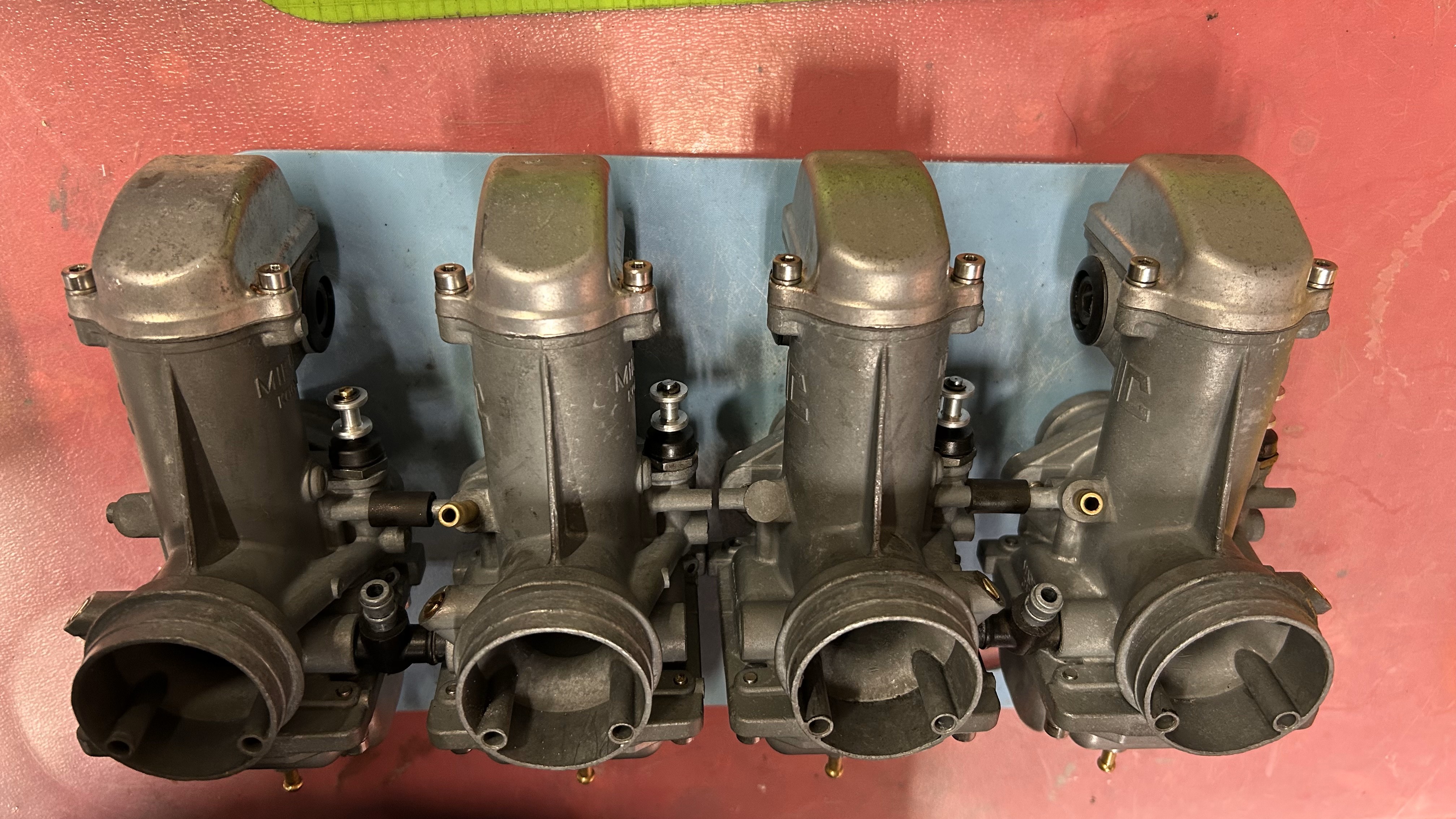

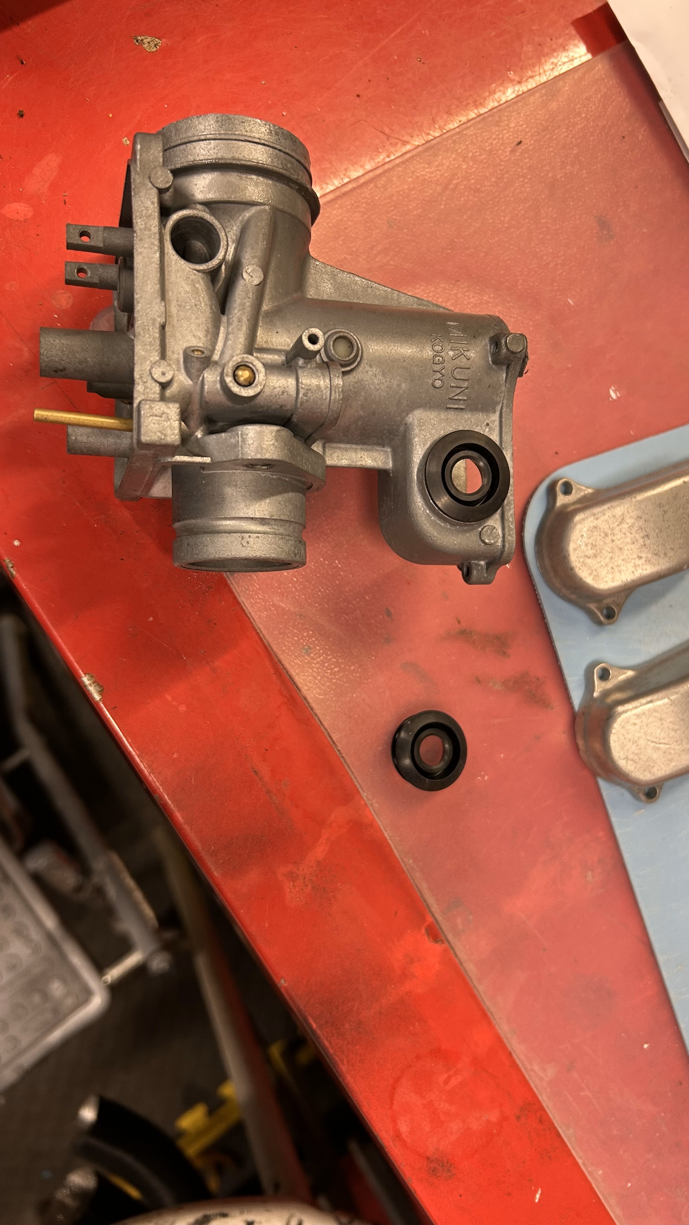

Rebuilt the carbs on my Z900 A4 , just need to assemble onto the linkage plate.
Any recommendations on how to clean the carb bodies, don't want to go to expense of vapour blasting more so I've now re assembled them.
Been through the ultrasonic cleaner a couple of times and blown through with compressor. will Solvol the float bowls and tops but main bodies are in need of a clean, I did flash them with carb cleaner once they came out the ultrasonic cleaner to stop them getting that white film you always get on alloy parts.
One other thing the black rubber breather link pipe between 1/2 and 3/4 , should they have clips to secure on them ? Cant say I remember them having them.

Re: A4 carbs help
Looking good with all the right parts.
I never use any clips on the breather link pipes and apart from maybe polishing the bowls and caps i leave the bodies natural .
Re: A4 carbs help
Cheers Rob , was thinking maybe some alloy wheel cleaner as they are a bit dirty looking , but yeah agree, don't want them super shiny.
Plungers top job as usual , ta. Work a treat on my RD too. Thanks for pointing me in the direction of the EBay parts from Centurion.
Thanks for confirming the link pipe info, was sure they didn't have clips but memory isn't as good as it used to be.
