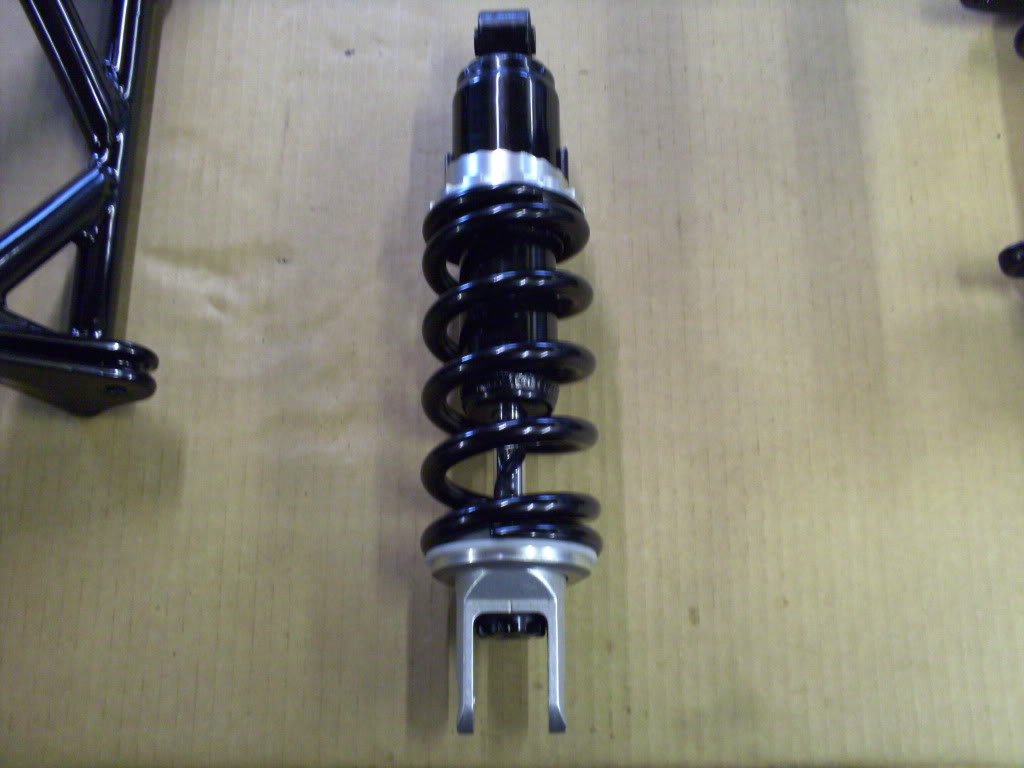

Trying to get a little bit done each day.
Rear shock, Bandit 600 item.
Original spring which was too hard and steel preload and collet on left.
Replaced on right by softer Yam R6 spring that is slightly larger diameter so used much nicer alloy R1 preload etc to suit which also needed some Lathe adjustment to fit the fatter bandit damper.
Got that sort of classic Hagon look i think ?

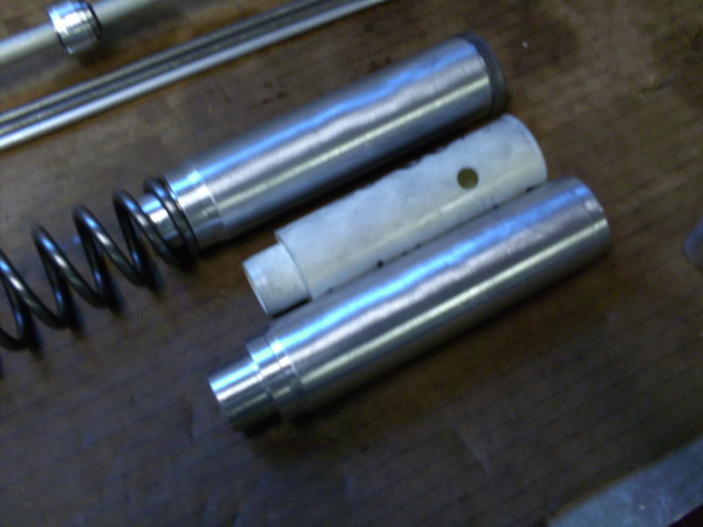

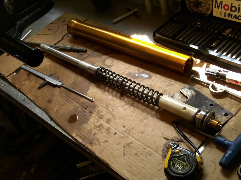

A cunning plan.
Decided i could use a bit of extra length on the front end .
So had a bit of a measure and discovered that the ZX10's forks fixed top bush is 160mm from the top of the fork outer leg .
And the fork slider has a full 34 mm of unused surface above this in an uncompressed state . So i figured there's a safe 32mm of extra length i can gain without too much trouble and even less expense
Just a matter of extending the damper assembly (which controls fork travel) by 32mm.
A bit of a rummage turned up some old ally ZXR fork tops
And a couple of gixer srad swingarm bearing spacers which were perfect donor material for the job
A combination of turned down zxr adjuster pressed into a srad spacer
Produced the extended spring preload spacers
Next turn up the threaded damper rod extensions
On which i milled some flats
To take a spanner
