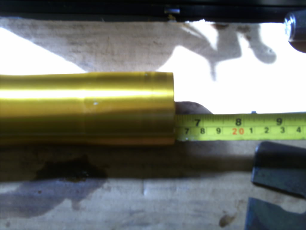

Decided i could use a bit of extra length on the front end .
So had a bit of a measure and discovered that the ZX10's forks fixed top bush is 160mm from the top of the fork outer leg .
And the fork slider has a full 34 mm of unused surface above this in an uncompressed state . So i figured there's a safe 32mm of extra length i can gain without too much trouble and even less expense :D
Just a matter of extending the damper assembly (which controls fork travel) by 32mm.

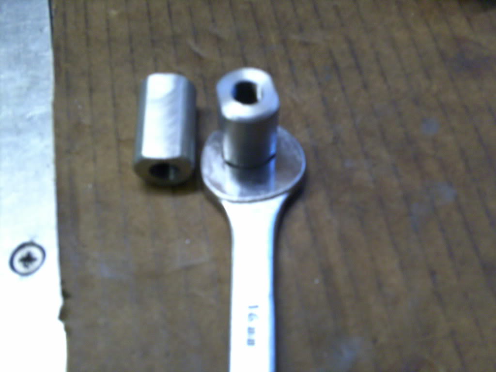

A bit of a rummage turned up some old ally ZXR fork tops
And a couple of gixer srad swingarm bearing spacers which were perfect donor material for the job
A combination of turned down zxr adjuster pressed into a srad spacer
Produced the extended spring preload spacers

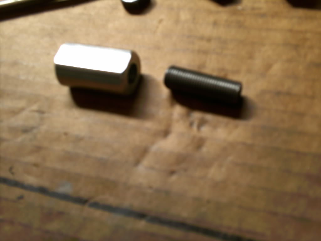

Next turn up the threaded damper rod extensions
On which i milled some flats
To take a spanner
