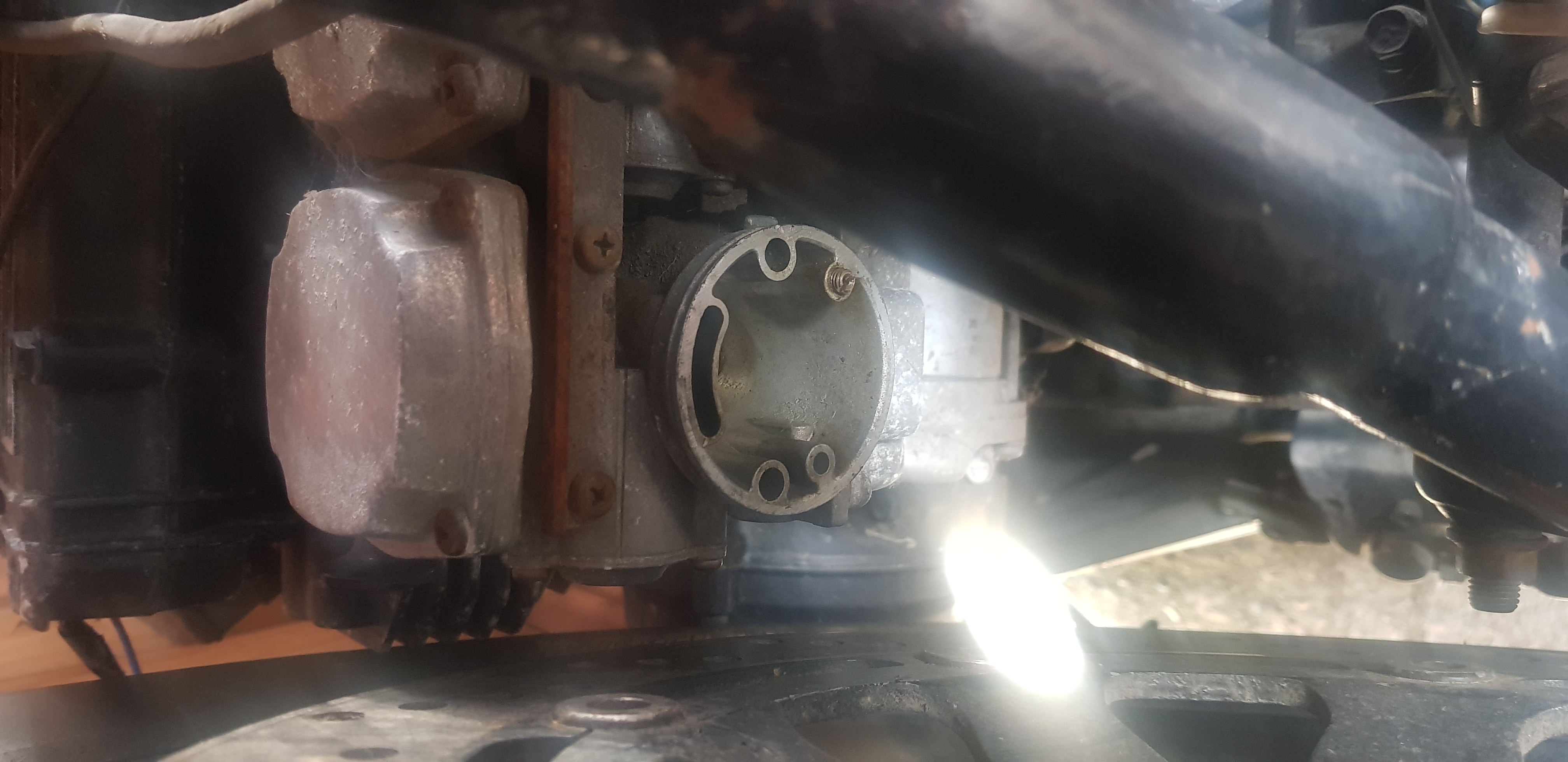

On a bike Im Breaking I've stumbled across a set of z1000j carbs, would these be good on my 1045cc high compression engine, 71mm forged pistons Andrew's cams etc, I've asked a couple of times and was told by a couple of members to go with z1000 28mm carbs which I had but sold when I needed some quick cash, I had a couple of sets of Vm29 flatslides which ive sold on as 29mm smoothbores were mentioned, ive now stumbled on these which I already have, I think they are bst34's, so thoughts on the the 3 different sets of carbs, 28mm Z1000, 29mm smoothbores, z1000j carbs, comparisons if you can, value/performance cheers Swirl
