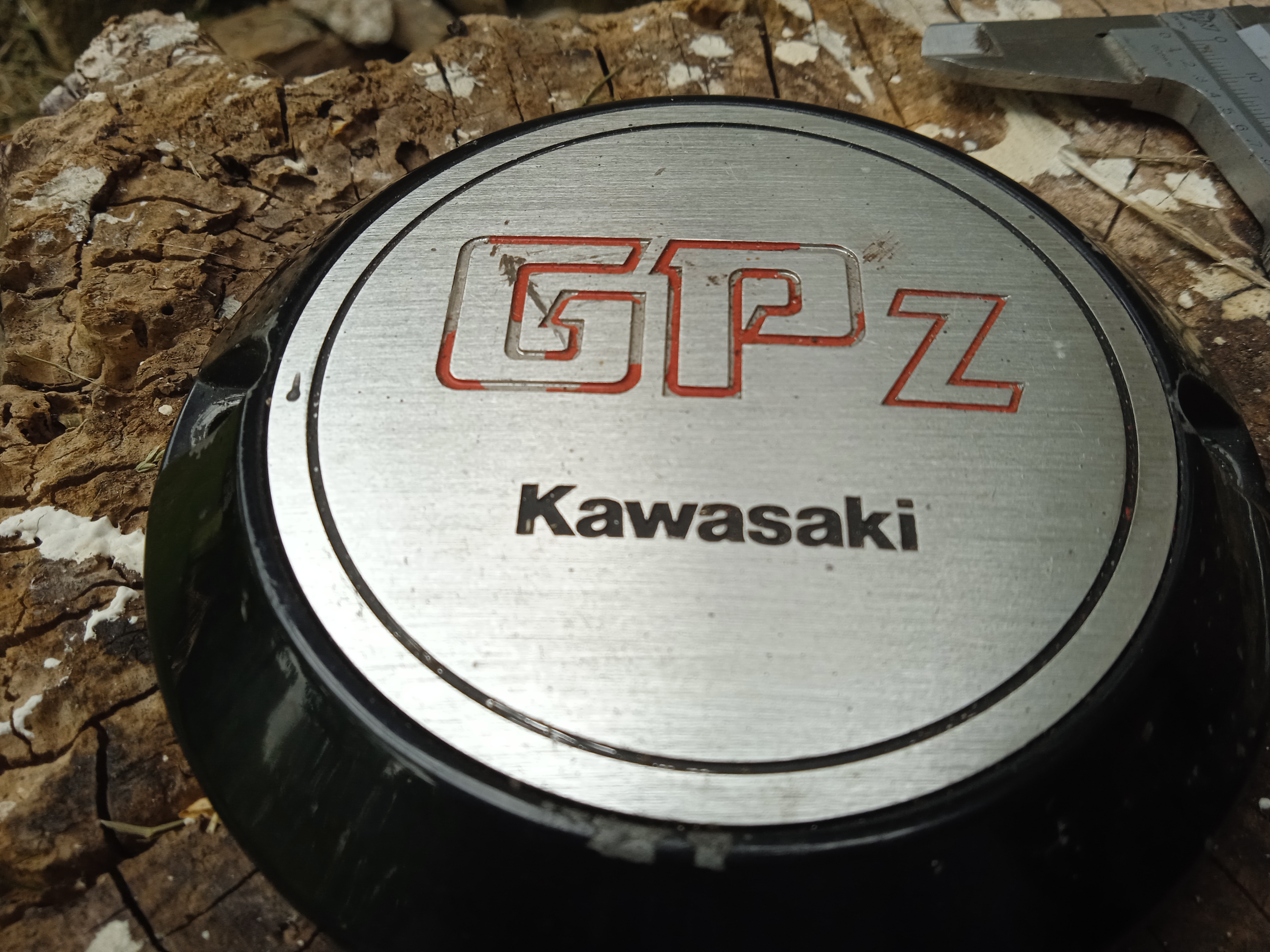

As we are talking colours what colour is the red in the gpz on the side casings?
Re: GPz11 - which black?
The emblems on the engine casings look like the firecracker red to me the same as the body work they are still available from zpower
How do they come off ? Mine look permanent. And sixty quid each is a bit steep
It looks like a double sided sticky pad that cover the whole diameter of the badge to hold them on i can send you a couple of photo's if you like.
Go on that would be great
I've seen the stickers and presumed they must have been for certain variants as mine really looks not like a sticker. If it is I'm guessing they are ally and reasonably thick as the recess is 0.25mm deep. I'm glad this has been mentioned because I was about to blast it back to bare metal.
I did blast mine ,ive buffed it up i think ill just repaint it as i cant see it coming off without damaging the case
